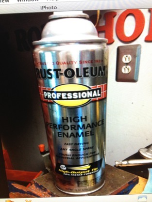

  4. Porknbeaner is right powder coat is the best , if your low on funds I forgot about this paint also. A friend used it on a set of wheels. I was impressed with it also
