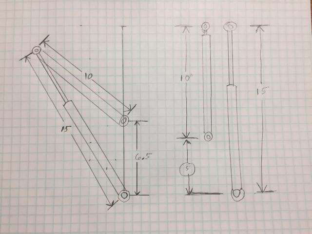

    I believe that to be incorrect, shock travel remains the same, but suspension travel increases the more the shock is mounted off vertical....
  25. BJR
    Joined: Mar 11, 2005
    Posts: 11,283
    BJR
    Are you serious? Draw it out on a piece of paper and report back.

  27. Vic Walter
    Joined: Jan 21, 2018
    Posts: 172
    Vic Walter
    One picture is worth so many words....

  29. BJR
    Posts: 11,283
    BJR
    So you are saying that if you angle a shock from vertical, it moves less than a shock mounted straight up and down if the axle moves the same vertical distance. Correct?
    This is what I said in post #2.
    I believe we are saying the same thing, just differently. :)
  30. Joe H
    Joined: Feb 10, 2008
    Posts: 1,858
    Joe H
    Not only do they move less, they are less efficient. You fine tune a shock just by leaning them over or standing them up.
