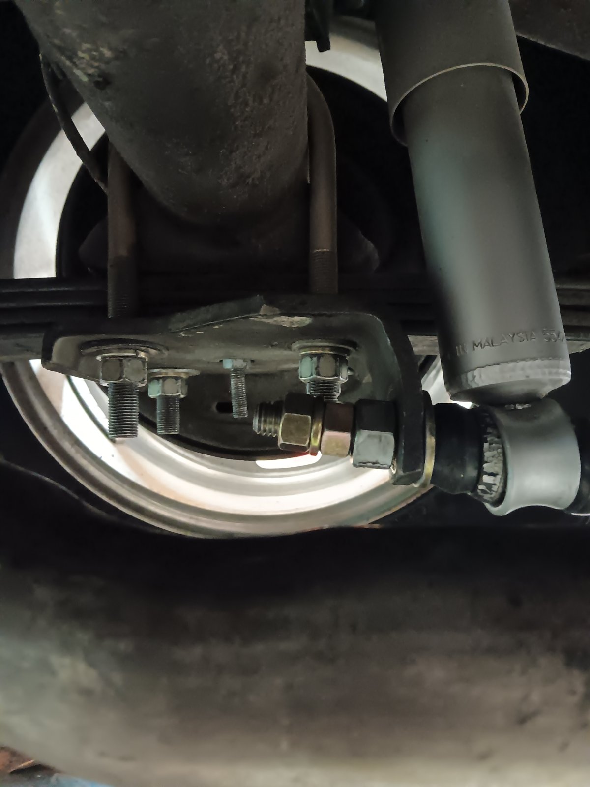

    Removed rear spring leaf to soften ride.
    It worked, but now a bit to low in the rear. 20240913_135821.jpg 20240913_135821.jpg
    The springs are under the axle. I would like to raise the rear about 1/2 inch. Any suggestions, cheap and easy.

    1" longer shackle

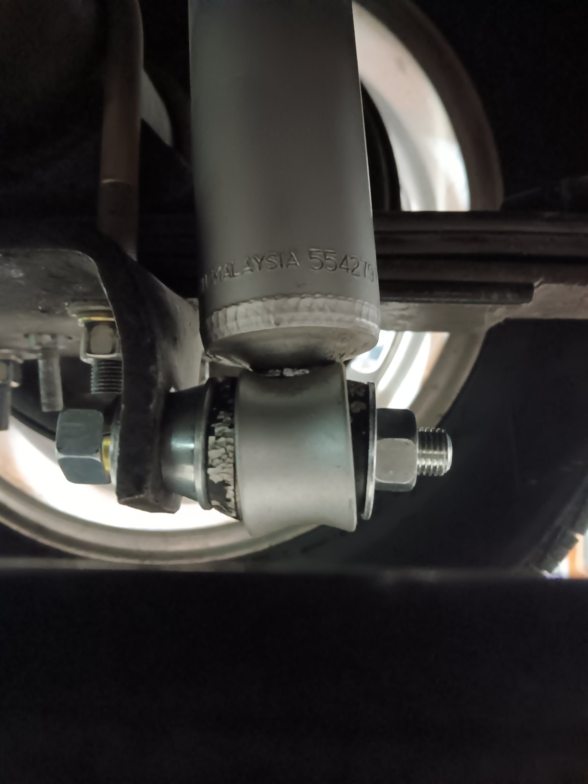

    You might want to tidy up that shock mount, too.

    Fix the shock mount and install air shocks. Cheap, easy, and will do what you need.

    To fix it right you need to put the missing spring leaf back in, get longer "U" bolts and proper lowering blocks. Also, you need to use a proper shock stud on that rear shock instead of a common bolt.

    what model car/truck? which spring did you remove? sure that shocks were correct length before you removed spring? yes, when a spring is removed it will usually lower the vehicle.

    48 DeSoto, removed middle leaf, shocks correct length.
    When removing the leaf, I stripped threads on shock mount, the grade 8 20240830_102703.jpg bolt was all I had. Going to parts store for correct shock mount.

    You could try putting the middle leaf back in and remove the one below it, see if that raises it back up the 1/2 inch.

    Agree, put in the biggest spring you took out and remove the smallest spring still in the pack.
    Personally I'd just re-arch the springs to the height I want but then again I've done that for over 40 yrs so it's a piece of cake to me...

    As far as the car going lower when you "removed a spring to soften the ride". Lowering the car the cheap way is the normal reason for removing a leaf.
    When you remove a leaf you weaken the spring and it begins to sag and will keep on sagging.
    The "longer shackles" nonsense will just increase the rate of sag after a period of time if you are old enough to remember all of the jacked up leaf spring cars in the 70's with the ends of the springs bending backwards.
    A spacer leaf on top of the main leaf ( short piece of the middle of a leaf spring, should raise it back up for a while but will not be a permanent fix as the weakened spring will keep sagging.

    That will lower the car the amount of the thickness of the short leaf. Just like lowering blocks.

    Due to the springs already being settled, could you flip the main leaf reversing the spring eyes and re***emble to lower it?

    This better?
    Should have seen car parts guy when I took the one I had stripped the threads and showed him what I wanted. Had to find it myself, he could not find this on his computer.
    I told it just as plain as day, " it's for a 48 DeSoto Hot Rod".

    The bracket should be parallel to the shock. Then, space the shock just enough to clear everything.

    I'm finding it hard to believe a 48 DeSoto only had 3 leafs in the spring pack to begin with. I suspect it originally came with 6 or 7 leafs in each spring pack. The spring capacity has already been cut in 1/2 and then you removed the longest leaf that could be removed. My suspension says that main leaf is probably trash now, I'd be concerned that it may already be cracked.
    Maybe you can get by with adding both leafs back into the spring pack (making it a 3 leaf spring pack again) That may get you back up where you want to be, and may buy you some time before you have to replace the springs.
    Longer U bolts and a 1" or 2" lowering block between the leaf spring and the rear axle would have been a better option to begin with.

    It had 6 now 5.
    I removed the middle leaf from advice from the company (Thurston Springs/Richmond VA) that made the custom leaf pack.
    I did not remove the leaf to lower the car, I removed it to improve the ride. It worked, I knew that would lower the car, but about 1/2 more than I like.

    That's why you should replace the spring you took out and remove the lowest/smallest leaf.
    In most cases the lowest spring is too small to do much flexing, it's more of a support for the leaves above it. So by removing that spring it allows the springs above it to flex more thus a smoother ride.
    Cool thing is it's not a complicated operation to perform to see if it works !!
