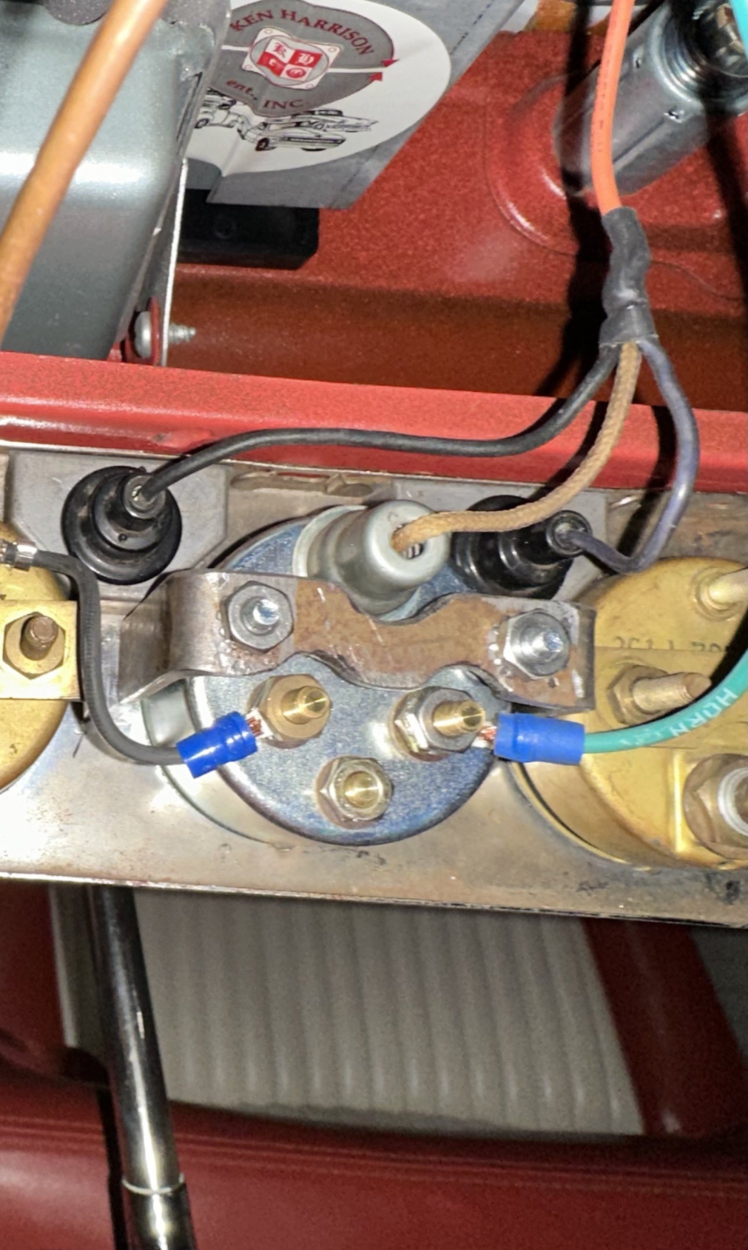

    I installed a Stewart Warner voltage gauge in my 56 T-Bird. The problem is it reads low. I have checked it with 3 different test gauges pulling power and ground from the back of the low reading gauge. The 3 test gauges all read the same 12.6 volts, while the SW gauge reads just under 12 volts. On the back of the gauge near the bottom and centered is a nut, 8970E6C2-FBEA-474D-AADA-2ABC740C7611.JPG F3236443-B943-4B33-969E-F55B041BAAC8.JPG I was wondering if it is used to calibrate the gauge.

    This may help, the guy got a defective gauge and he's checking the one that replaced it.

    Thanks, but that is basically how I tested mine. Bought it on eBay over a year ago so no returning it. Hoping to be able to fix it or re calibrate it as it just reads low.

    Contact S-W , I was able send to,
    4 different gauges I Believe, S-W checked & calibrated and returned, Now I cannot remember if they paid /sent a return back to check (S-W) shipping label or not. it was about five years ago.
    This way # I used
    1 (800) 676-1837
    just asking have you tried to check
    12, 13& so to 16 V to see if reading was .6 volts low @ each volts scale ?
