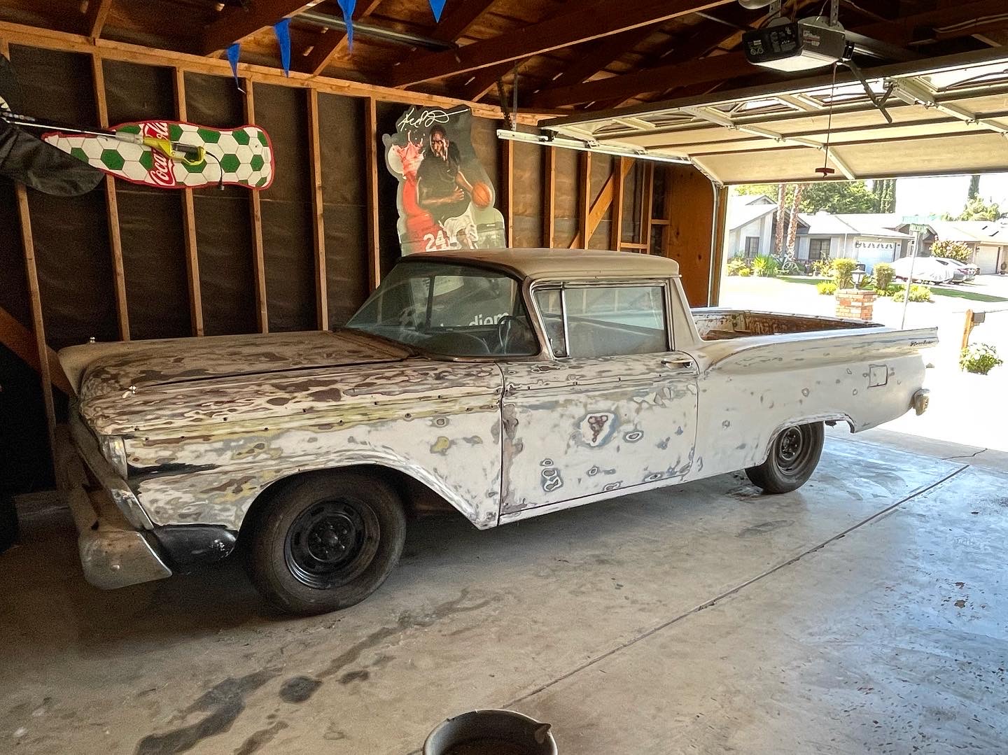

    So as the ***le states, I’ll be doing this swap, and soon. My late dad left behind his 390 that was in his old truck. He planned on rebuilding it, but p***ed away in 2021 before getting a chance to do anything.
    I got a 1959 ford ranchero last summer and it has a 352 fe with what I believe a cruise-o-matic? It’s a good engine it seems. But it had been sitting for 16 years in a garage. There is some bad oil build up on it, which I mean.. I should guess that’s expected. But this 390 is a beaut. There was a c6 ****** my dad had to go with it, but it’s missing a chunk of the bell housing.
    I guess my main question in regards to this swap, is can I KEEP my existing transmission from the 352? I’ve read that I might have to use the flywheel and starter from the 390, but that’s it.
    also possibly using a remote oil filter? How about the oil pan, would I need a front or rear sump?
