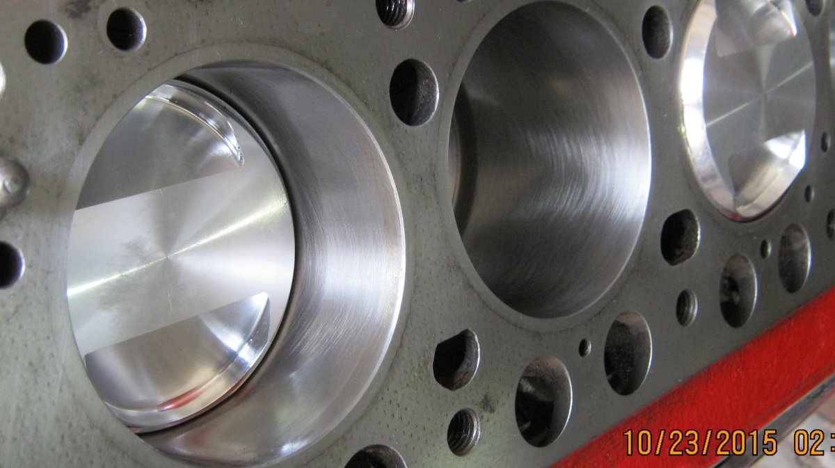

    worked on the 241 hemi today .. my brother and I ***embled the hemi . here are a few pics of pistons.. I'll load up some pics of it all together tomorrow.

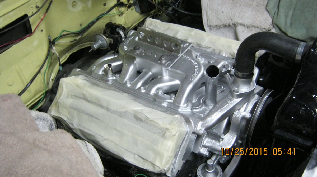

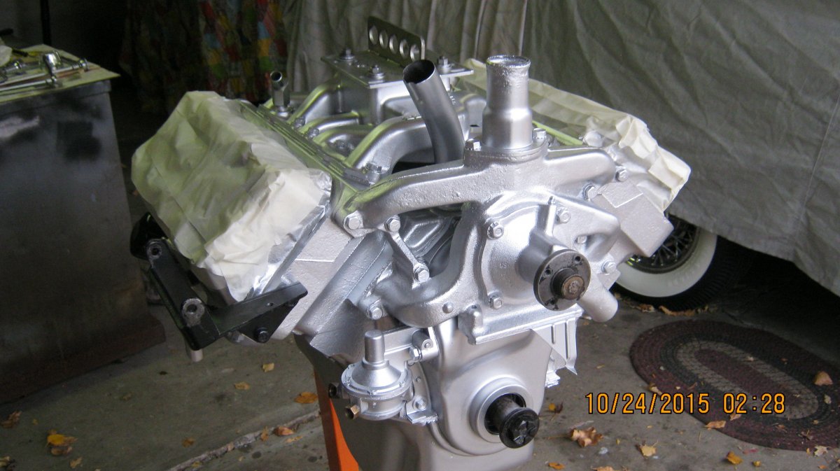

    241 hemi with 10.1 pistons all ***embled and ready to be installed .

  3. hotcoupe
    Joined: Oct 3, 2007
    Posts: 639
    hotcoupe
    motor looks great, what is the paint? looks like the correct color and sheen. going to put a 270 dodge in my `40 coupe.
    tom
  4. dodge59
    Joined: Dec 21, 2006
    Posts: 183
    dodge59
    Thanks Tom...
    the paint is Krylon ..."bright silver". Great match for oem.

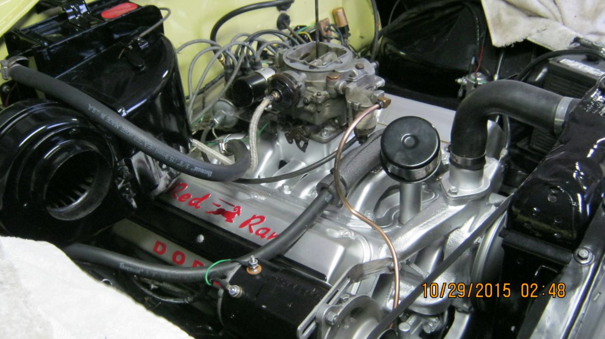

    hemi's in the hole .
