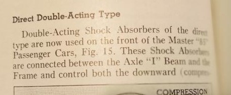

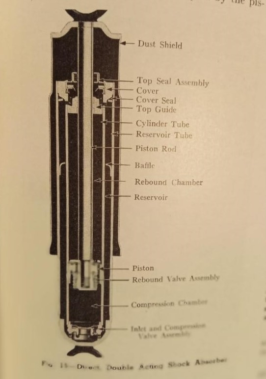

    Never saw stock 39 front axle and such . It’s different than 37-38s I have tinkered with . No tube shocks on earlier or sway bar , the reminder looks dead on

    1939 Chev didn't have tube shocks, they had knee action shocks. The axle shown is modified to add tube shocks.

    Sorry but Chevrolet and I respectfully disagree, every beam axle 39 I've been around had them.
    From the 39 service manual and other literature-
    1939 Chevrolet Manual.jpg Resized952025052795194442=1.jpg Resized952025052795194520-1.jpg
