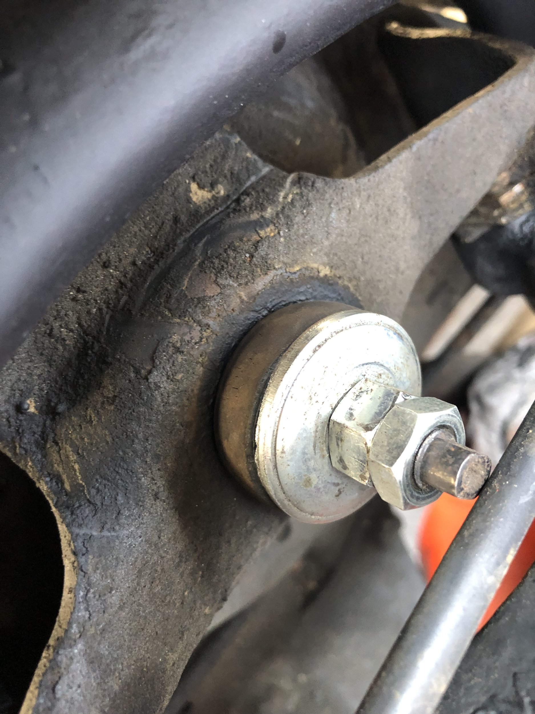

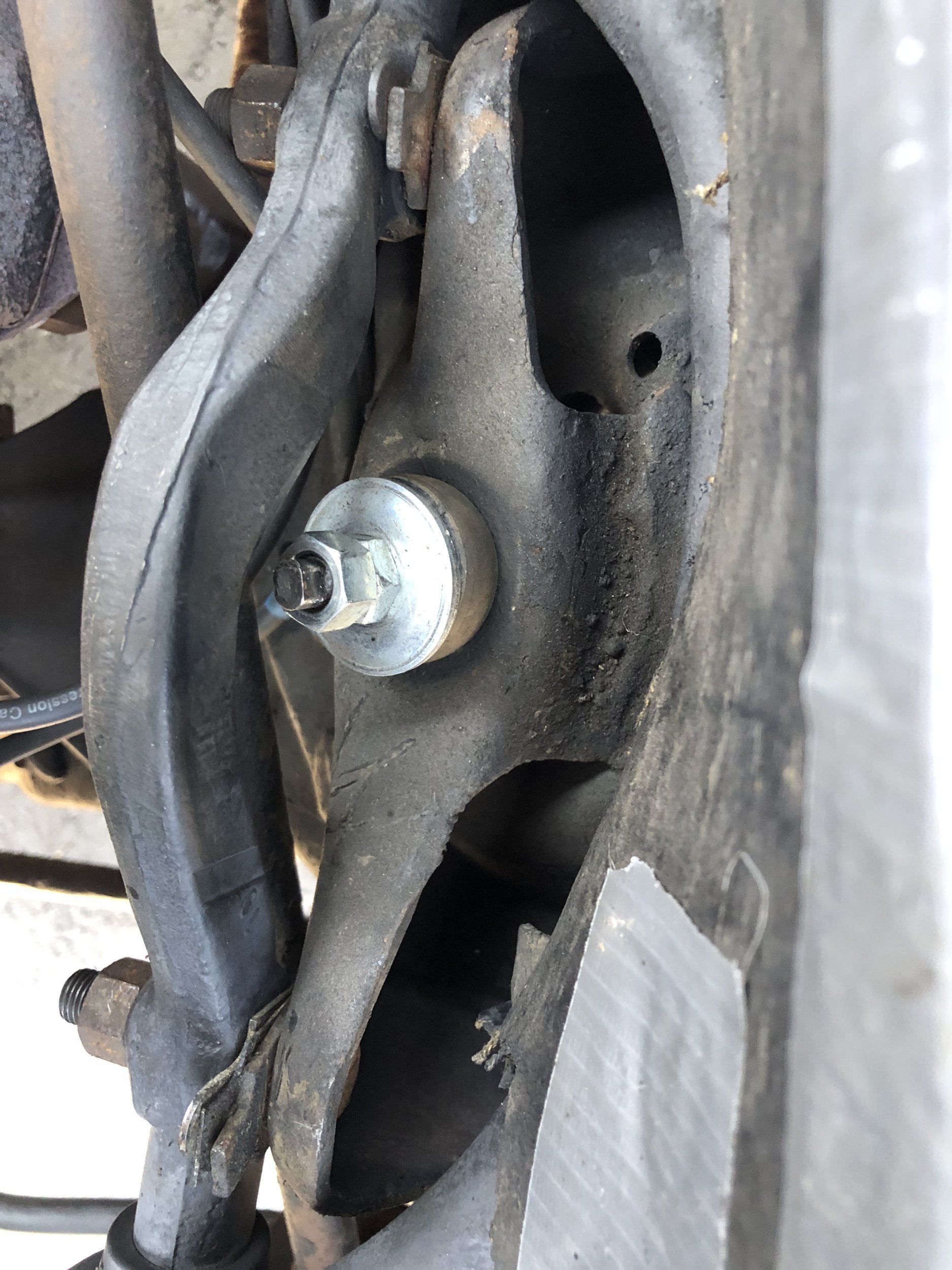

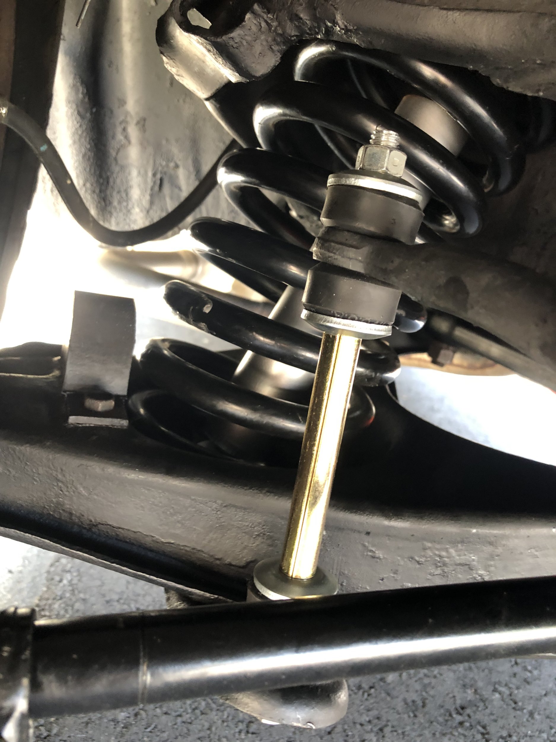

    IMG_8293.jpeg IMG_8294.jpeg IMG_8295.jpeg Hey so i installed all new front suspension on my 63 impala. It feels bouncy. It has new springs & shocks. How tight are the nuts on the sway bar end links and shocks supposed to be?

    You have to tighten the sway bar links at least enought to compress the rubbers. I don't see any compression in you photo, but lose sway bar links will not make the car feel bouncy.
    Is the picture of the shock taken with the car on the ground or in the air? If it's on the ground, you need to compress the rubber more by tightening. Shocks are the thing that will make the car feel bouncy.

    Yeah that was on the ground. The shocks are KYB gas adjust. So I guess the tighter I make the nuts the less travel the shock will have?

    The rule of thumb for most of those type bushings especially on shocks has been to to tighten until the bushings are the same diameter as the washer.

    Rubber bushings should be compressed to washer size + a little more, they should bulge out slightly past the washers with no gaps between.
    A-arm bushings should be tightened with the weight of the car setting on the tires in " as driven position " to minimize twist in the bushings.
    Yours are not tight enough.
