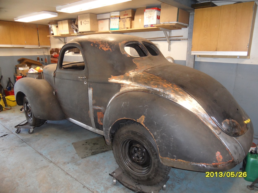

    The next things I wanted to improve was the shape of the right front fender, and the widened rear fenders. The shelf behind the seat is missing so I will make a new one. And the car has been checked, the idenity , weight and meashurements. I now have a clear ***le and license plates.:)

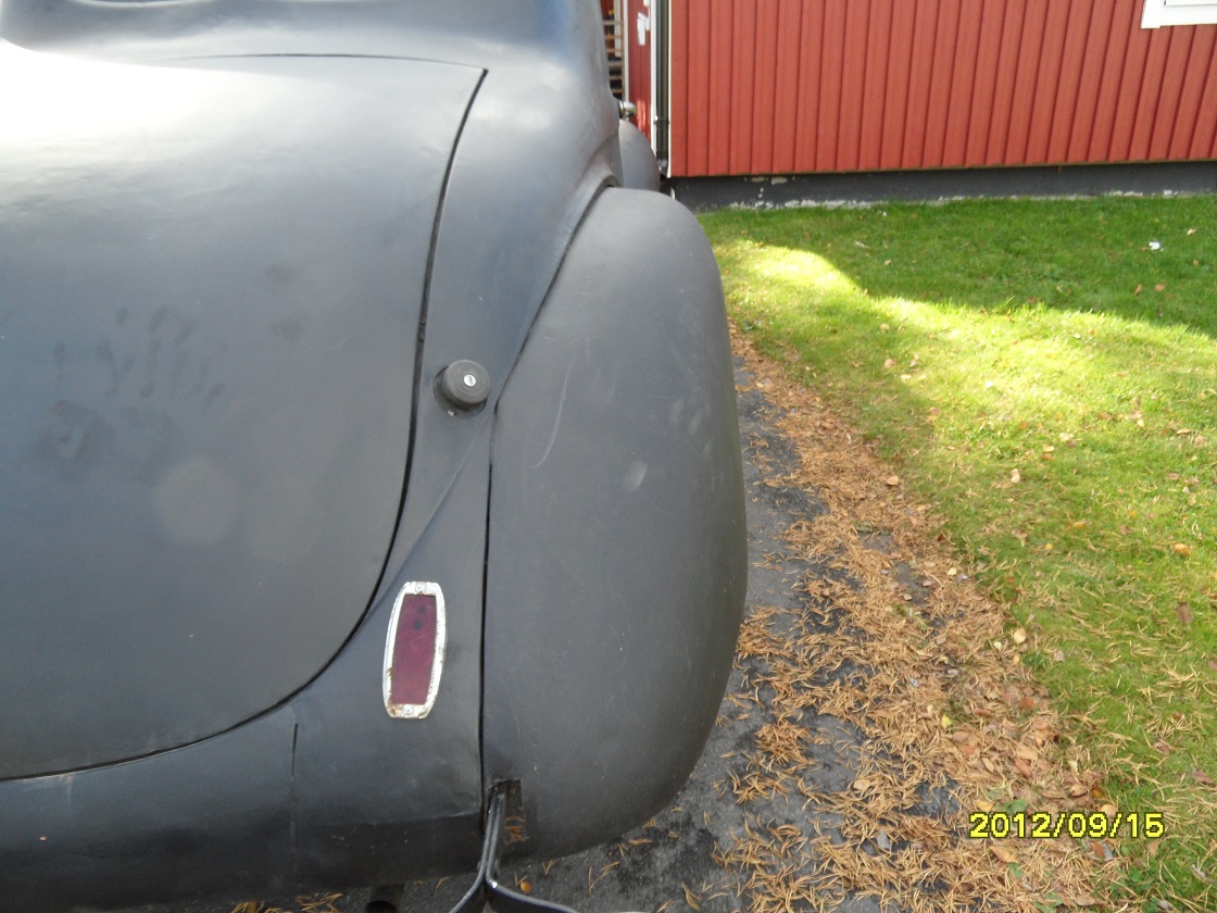

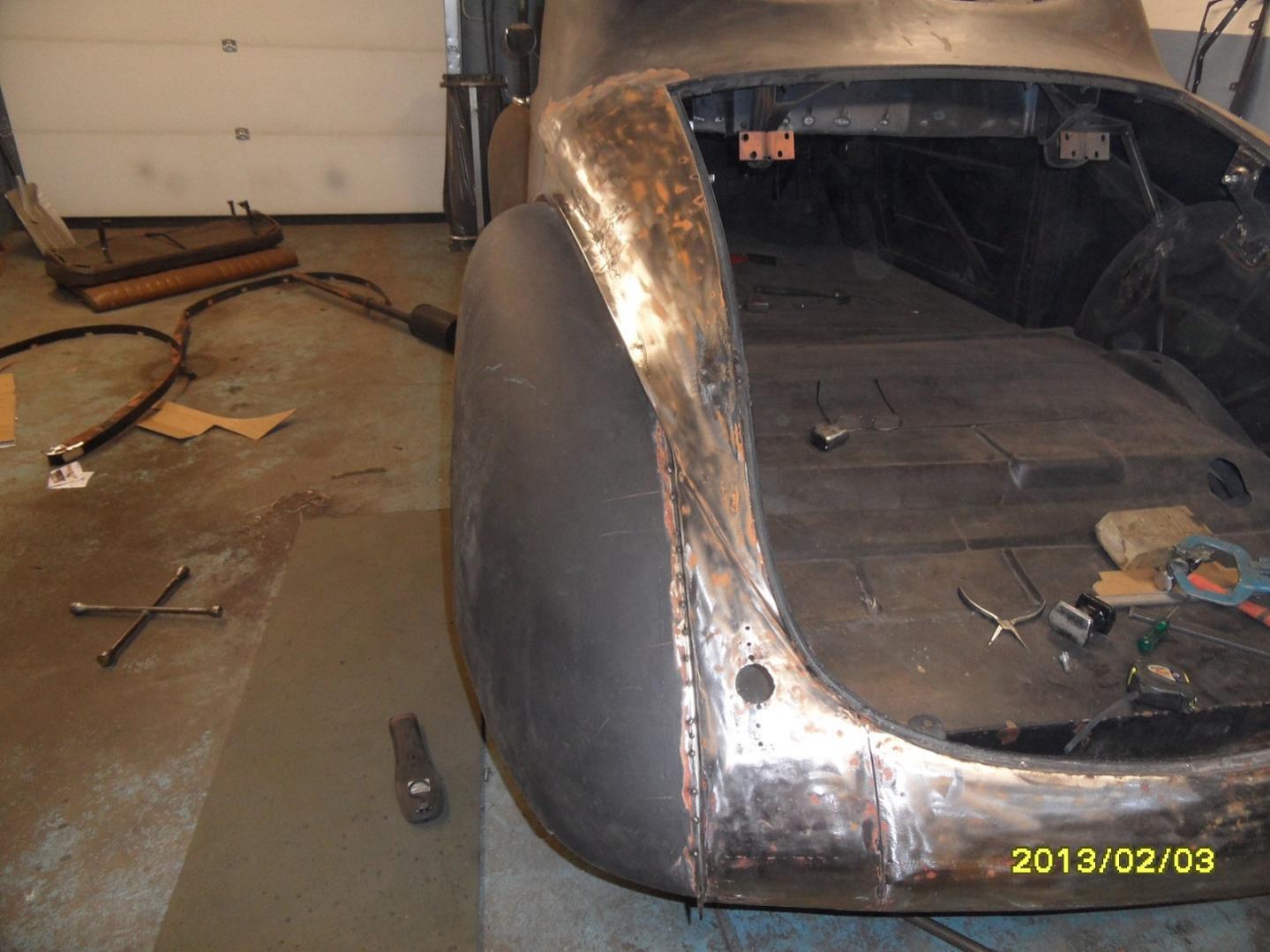

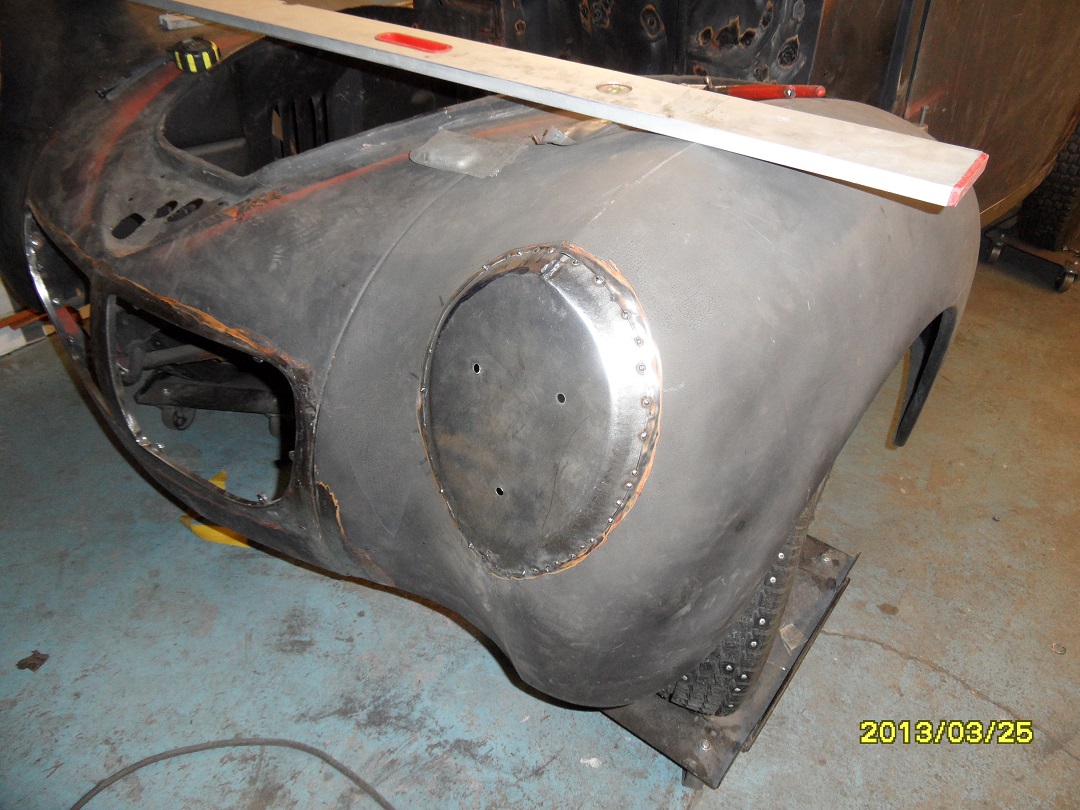

    When I had modified the rear fenders I focused on the tailpan it was pretty bad, hammered, welded and not the correct shape. Therfore I called Lee Kay, Kayskustommetalworks. And ordered a new tailpan, much better,Thanks Lee. Then I made my own panels on each side. The headlights where pointing in every direction so I made new panels around the headlights.

    Some new pics, when I changed the tailpan the trunk lid didnt fit, had to modify it a little. I have also made a new floor obove the rearend.

    The modifications around the headlights are also finished I think most of the welding on the outside of the body is done.

    This Willys is confusing the hell out of me. Bumpers and front sheetmetal are 1942. Floorpan appears to be 1941/42 type with drop down section at rear to accommodate 1941/42 104" wheelbase ch***is with 2" flare from just ahead of rear wheels. Rear bumper brackets exiting through rear fenders say wider 1941/42 ch***is (1937-40 bumpers exit through notch in tailpan). Top mount wipers say 1937-40 body, as do the doors with one piece gl*** and the gas filler neck exiting through the body - 1941/42 gas filler necks exit through the RH rear fender. I am suspecting that this is a 1939-40 body that has been welded on to a 1942 floorpan and mounted on the 1942 ch***is. If the oblong serial no tag is still on the front crossmember that will give the answer as will measuring the wheelbase - 104" makes it a 1941/42 and 102" makes it a 1939 Overland or 1940.

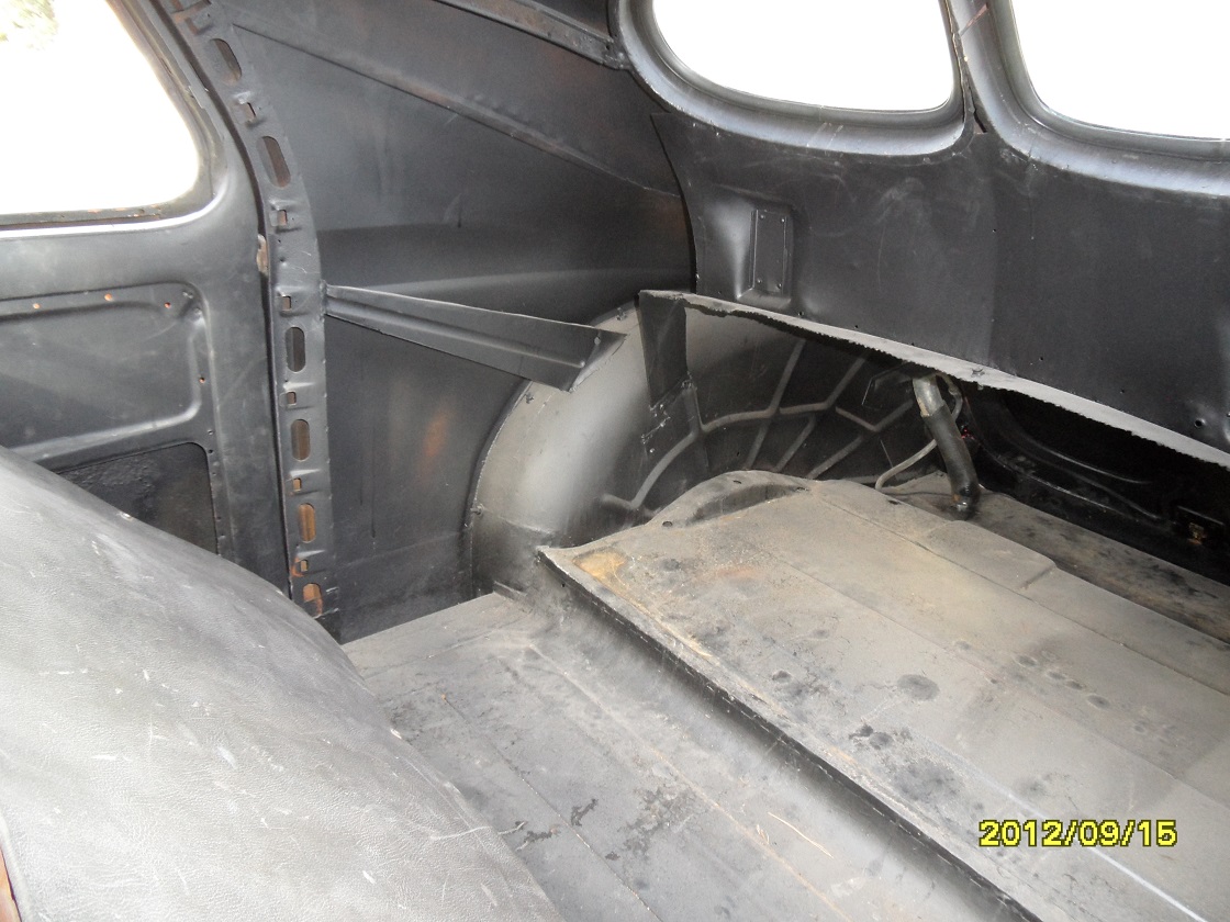

    Hi you are correct about most things but I think the fllorpan is 39 or 40 because its to narrow for the ch***is in the trunk area. It was modified for a home made gas tank therefore it looks like a 41-42 trunk floor.
    Iam not sure if the body is a 40 because there are no holes for side trim on the doors and quarterpanels, did Willys sell 40s without sidetrim?
    But the dash looks like a 40 to me.

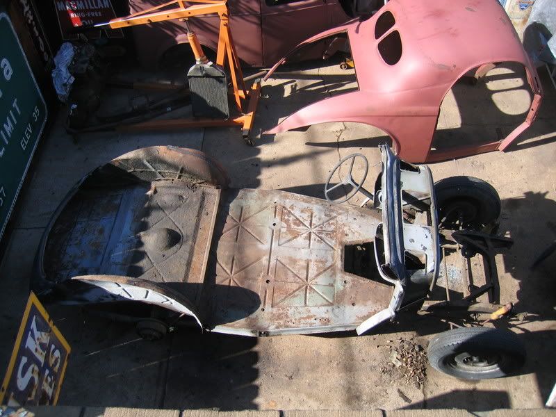

  16. Weasel
    Joined: Dec 30, 2007
    Posts: 6,696
    Weasel
    Just to confirm the floorpan comment I made earlier, here is a shot of a stock, never molested, never repainted original 1941 Willys coupe which shows how the floorpan steps down at the rear. This was done to clear the new style gas tank on the 1941/42 - very different from the earlier cylindrical gas tank used from 1933-1940. Bottom photos show Kiwi Kev's 1940 coupe with earlier type floor pan - note also hole in floor for gas tank filler neck to p*** through on earlier floor....
  17. I have never seen a 40 without the side trim, but there were '39's with the same dash as the 40's...I had one. Still have the guage trim that fits the opening in your picture. More proof that with the Willys, you can expect almost anything.
    g-willys
  18. Weasel
    Posts: 6,696
    Weasel

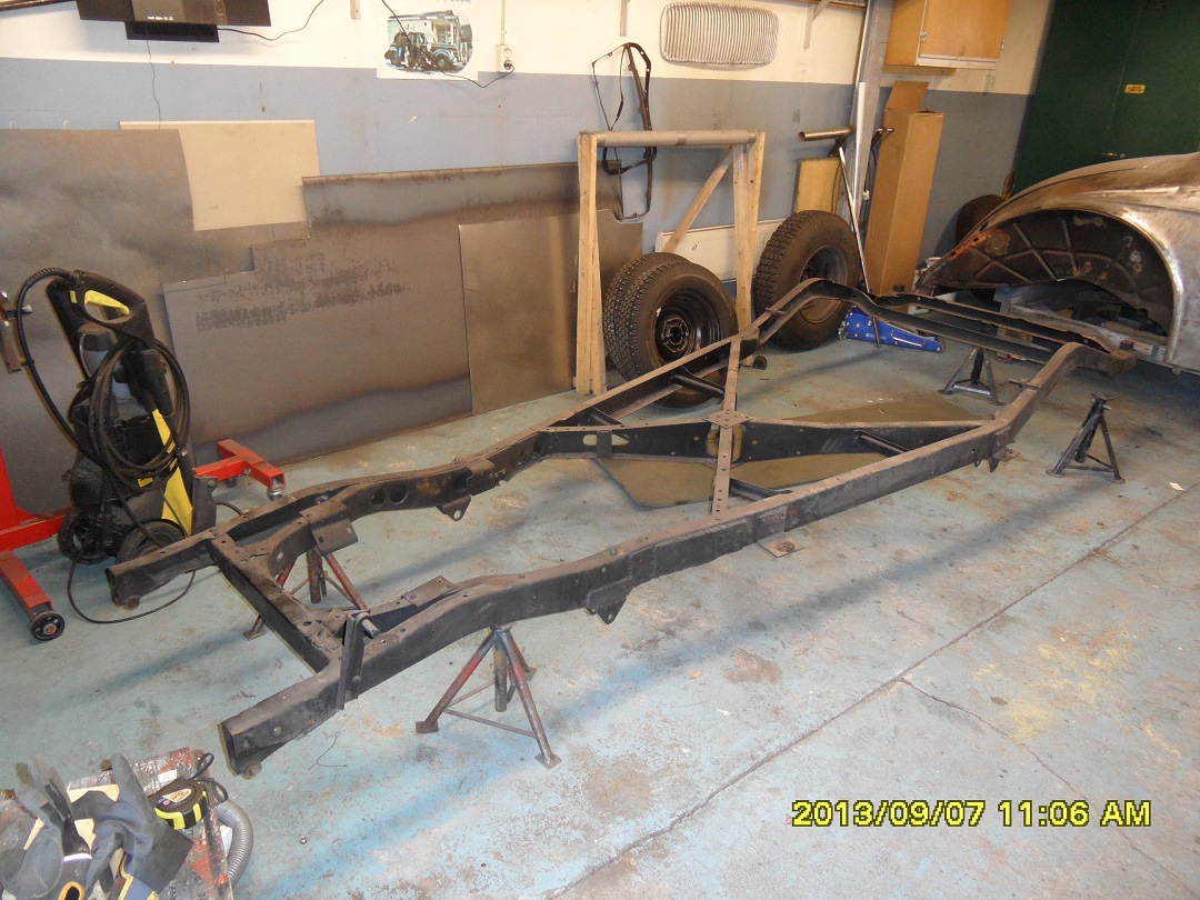

    Tomas, I have looked again at the photo of your rear floorpan and it seems as if the rear section has been home made to approximate the 1941/42 type step down floorpan. You still have the filler neck hole in your floor so that would suggest that part of the floor is indeed 1940. Your dash is 1940 for sure. But the notched fenders and the 1942 bumpers still suggest that the Willys may be sitting on a 1941/42 ch***is. Do you have any photos of the X member and rear of your ch***is. You can also measure the width between the frame rails where it kicks up over the rear axle - it will be 2" wider than the 1937-40 frame at that point - 43.5" or 1105 mm between the inside of the frame rails and 47"/1195 mm outside to outside. Your rear fenders appear to be modified 1939 Overland/1940. Although 1939 Overland/1940 rear fenders appear to be almost identical to 1941/42 rear fenders (except for the gas filler hole in the 1941/42 RH rear fender and bumper notches), the wheel opening in the 1941/42 fender is actually set about 1" further back, to accommodate the longer wheelbase of the 1941/42 ch***is....

    I know the ch***is is a 41-42 as you can see
