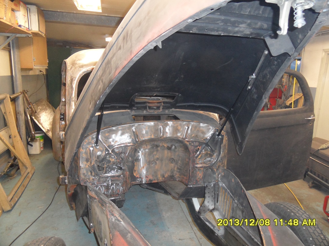

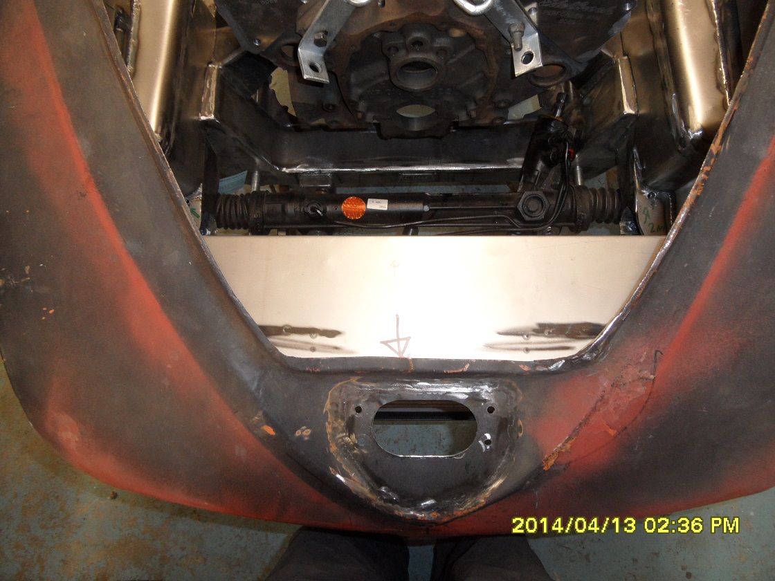

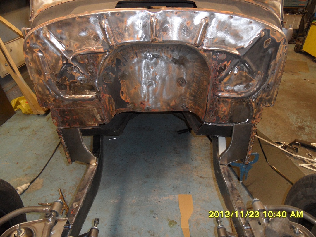

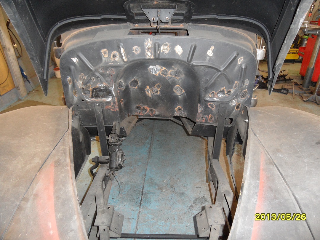

    Except for the transmission I have done it just like you, A small dent in the firewall to clear the right valvecover and I had to modify the X member so I can pull trans without removing the engine. More pics will come

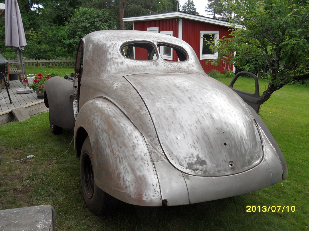

    I have made a shelf behind the seat and taken out the car for some paint removing, much nicer to do this messy business outside.

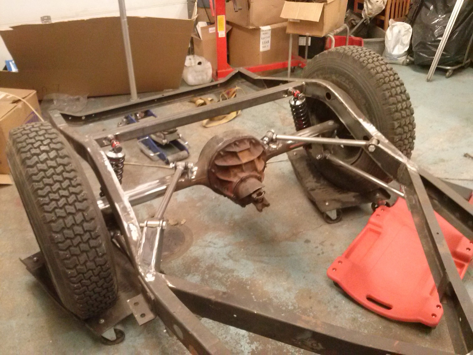

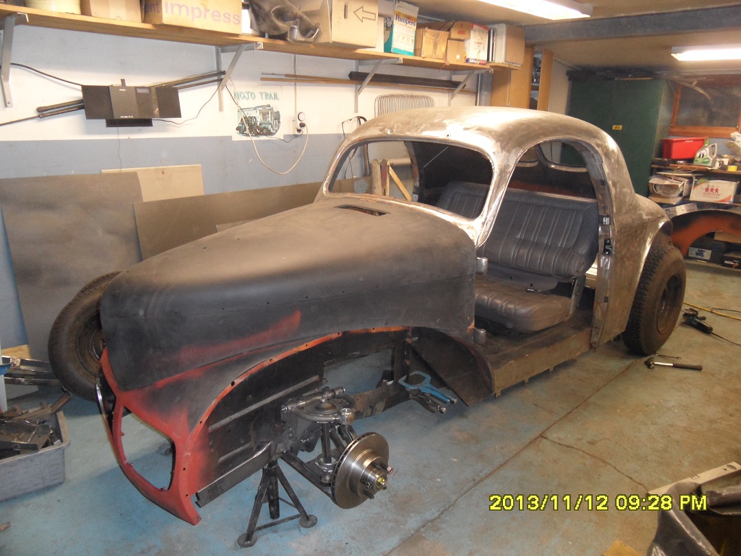

    Have started working on the ch***is but I have forgotten to take pics of it, but here are a few. Thew ch***is when I started , boxed the front of x-member,made cutuots for exhaust pipes, installed the rear suspension and the Mustang II front suspension.

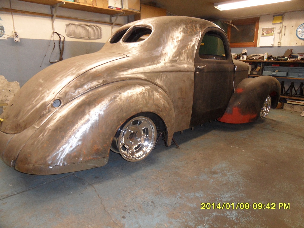

    I have mounted the body back on the Willys ch***is for a check of the rideheight, I think it looks a lot better now.

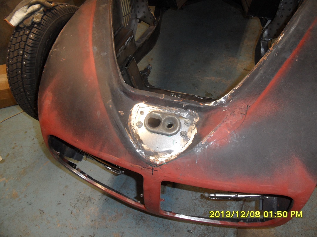

    Thew old bodymounts at the firewall looked very weak so I made new ones

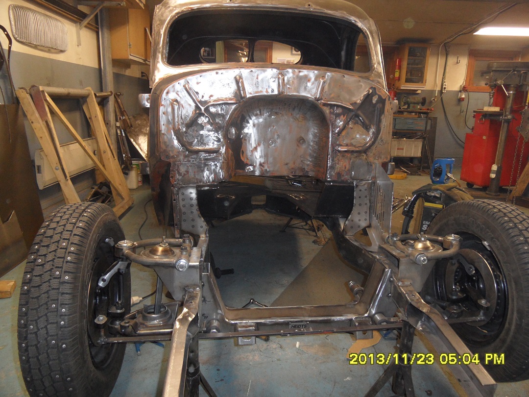

  6. Tomastudor
    Joined: Dec 15, 2009
    Posts: 311
    Tomastudor
    The old bodymounts
  7. Tomastudor
    Posts: 311
    Tomastudor

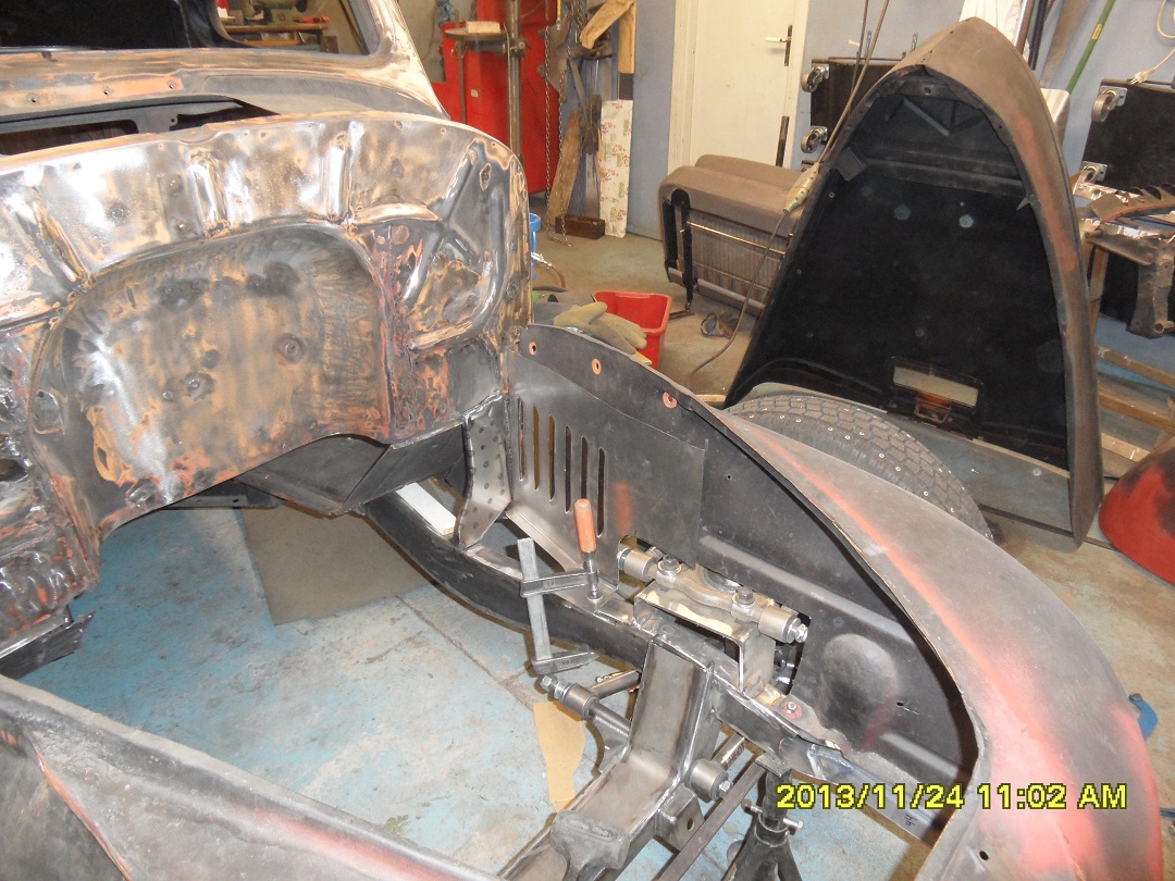

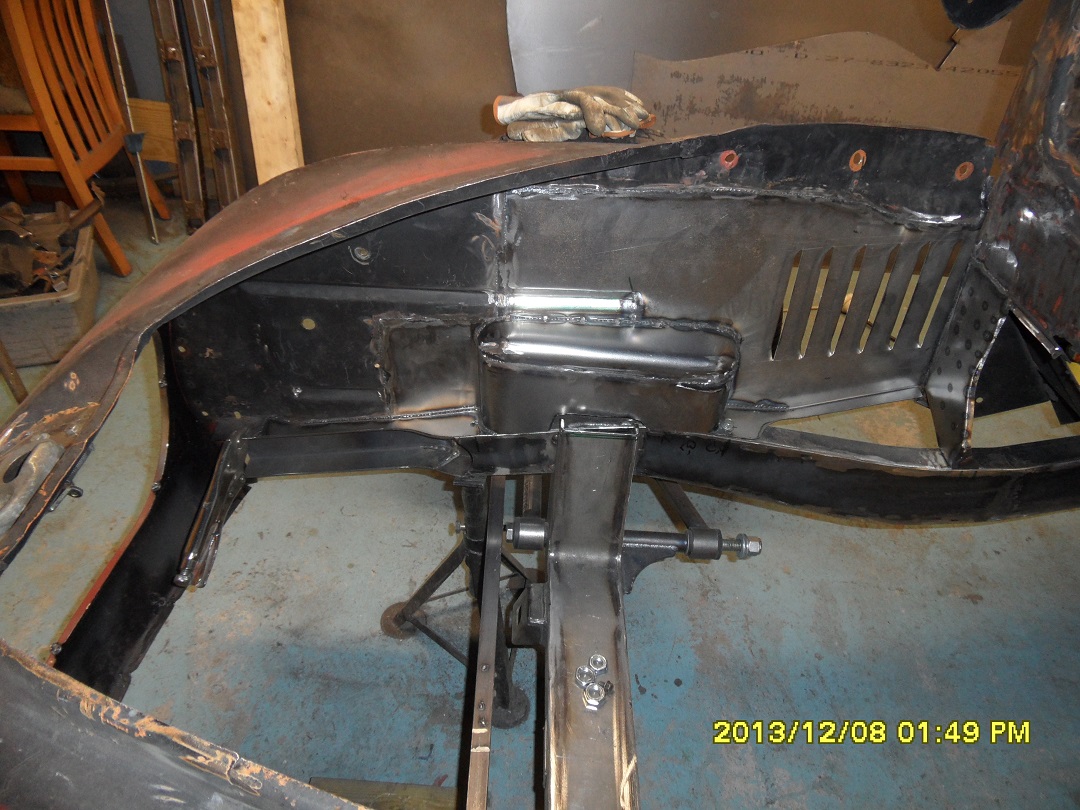

    Next to do was to modify the centersection to fit with the Mustang II suspension. I also wanted some louvers to aid cooling, many Thanks hotrod--willys for showing how to do them. I am pretty satisfied with the look.

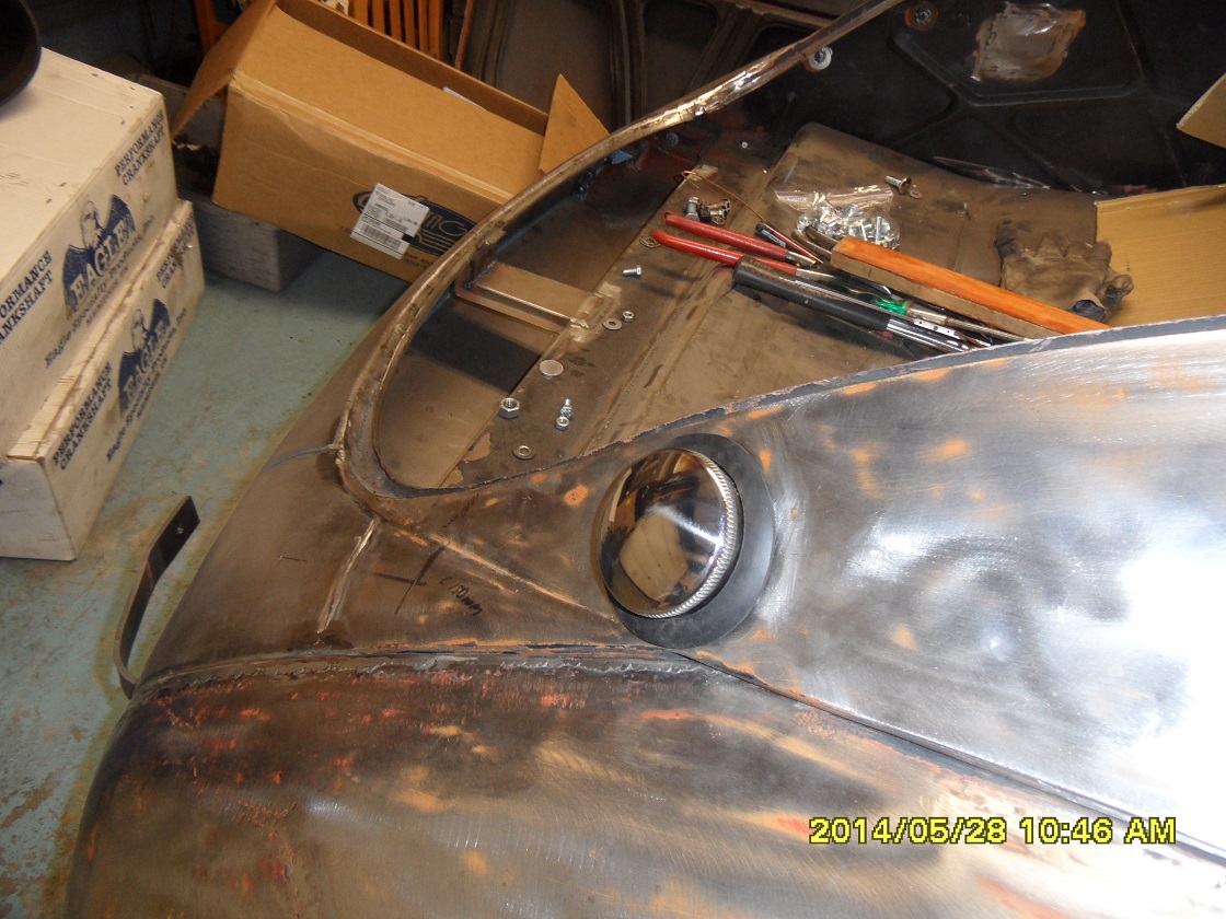

    Next thing to do was the hood, installing gas struts and hood latch,the gas struts are VW and the latch is from a Volvo.

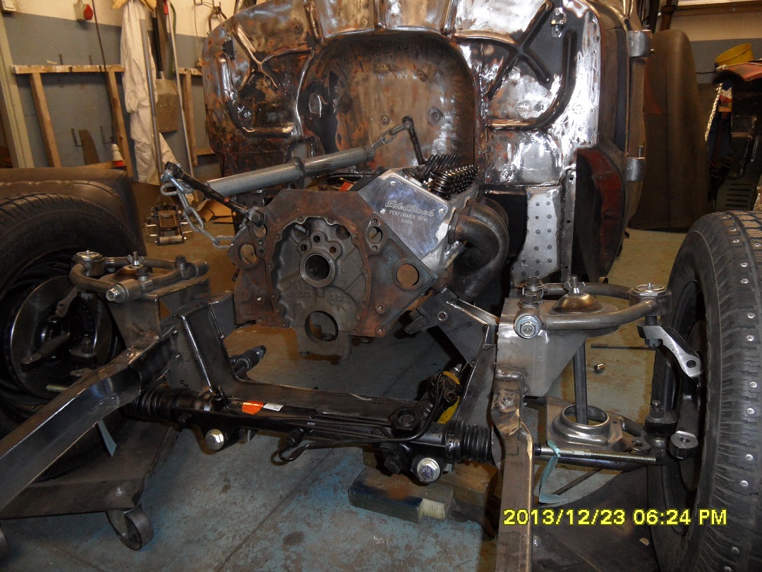

    I have made the motor mounts and transmission mount. And it looks like the steering shaft will p*** the engine without problems.

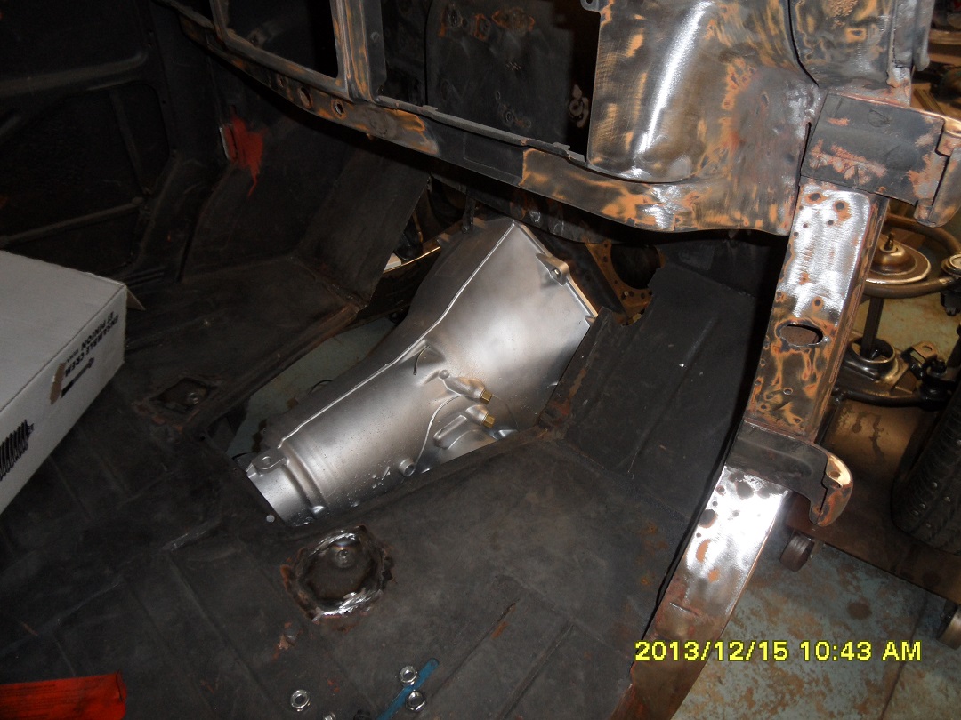

    After mounting the engine and transmission I could do the floor over the transmission and the small modification of the firewall for the right valvecover.

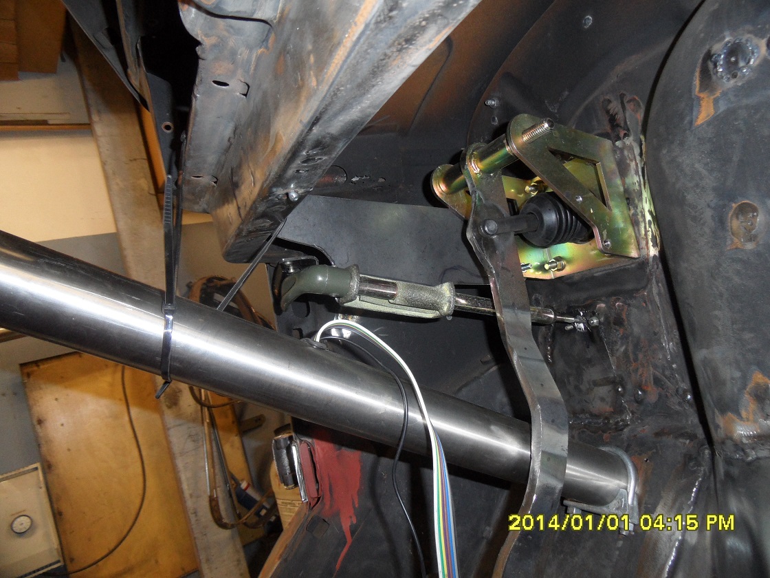

    I have also installed the master cylinder and brake pedal

    After the steering column I made a new column drop from an old aluminium rod
    And a parking brake handle from a Willys jeep, I think they are the same as my 40 coupe should have.

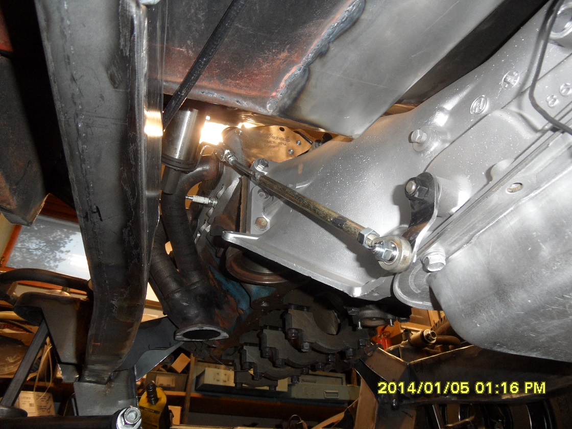

    I have made the gear shift linkage I did before I realised that the steering column was ****. I have also made the parts for the parking brake under the floor. And some pics of transmission and the rear suspension. American Rebel 023.JPG American Rebel 024.JPG American Rebel 022.JPG American Rebel 020.JPG American Rebel 025.JPG

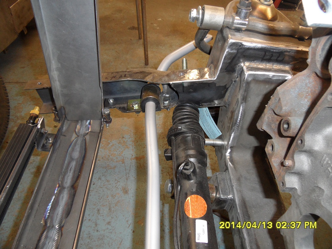

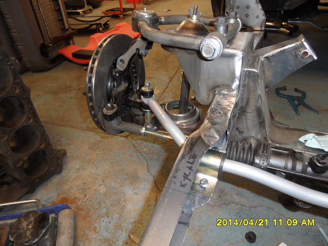

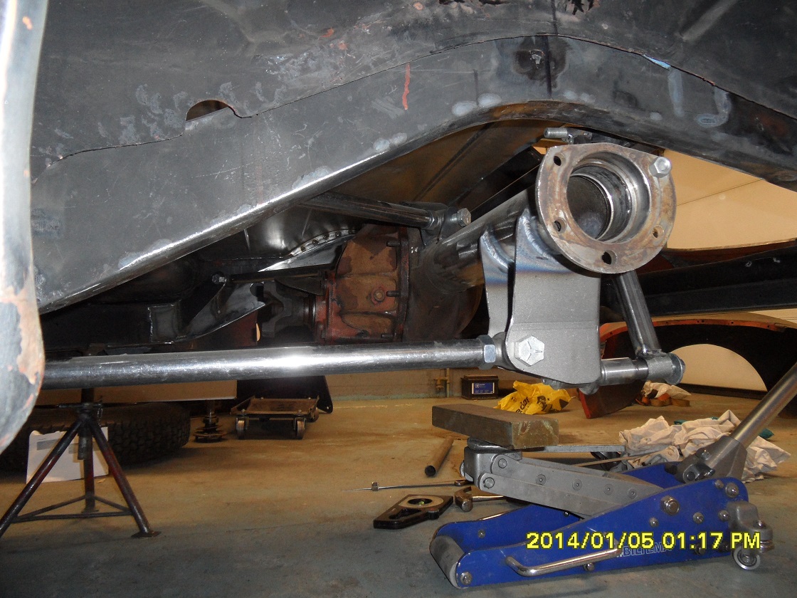

    As I wanted my Willys to handle well I have installed a swaybar.
    After moving it back, forward and down I realised thet the only way I could make it fit was running it through the ch***is.

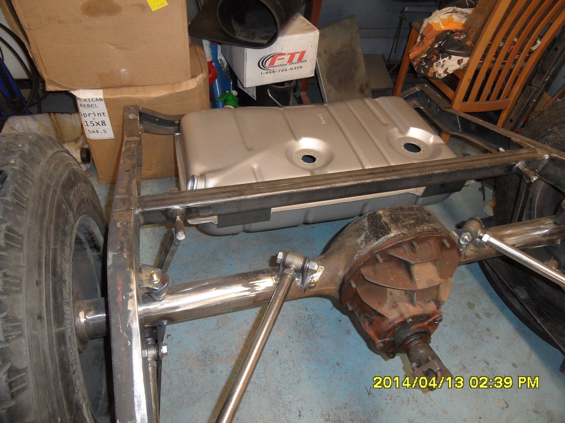

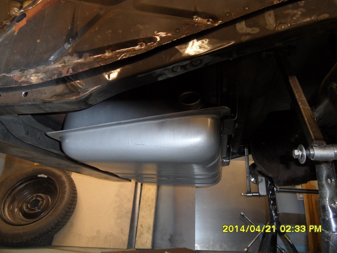

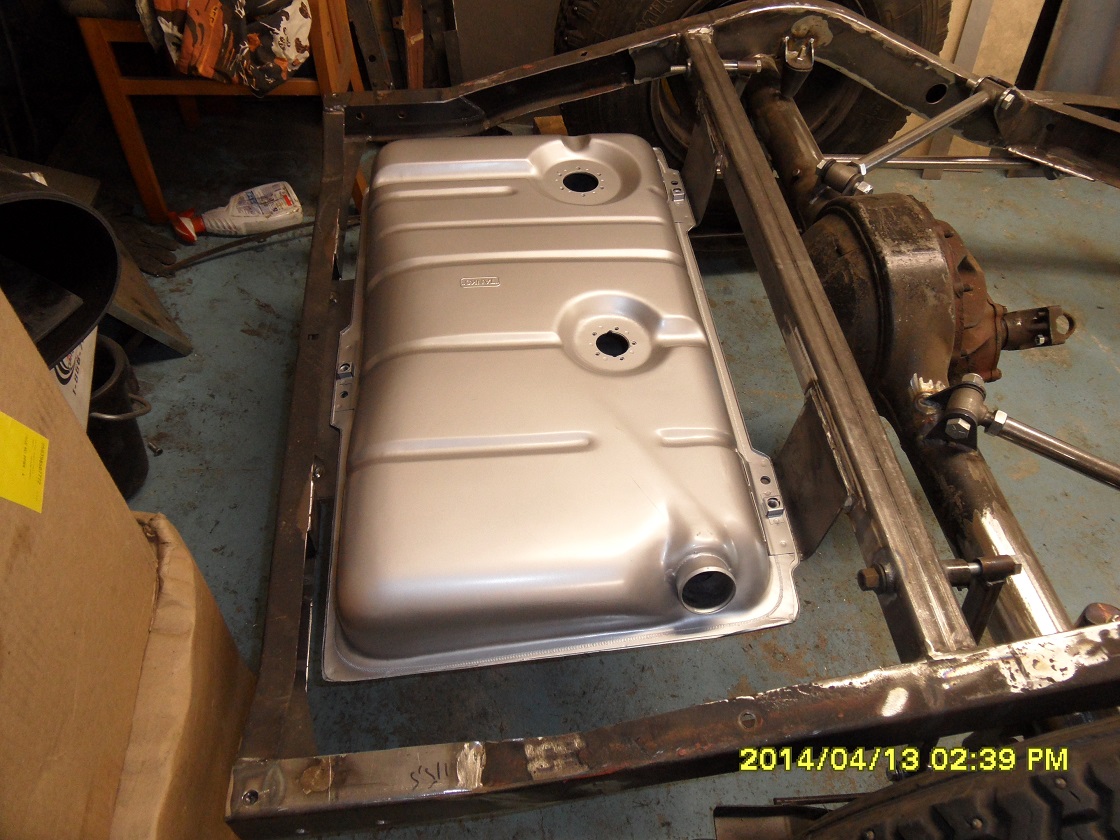

    My Willys came with a very small homemade gas tank, but I wanted a pretty big one for better cruising range.
    I have bought a 42-48 Ford gas tank and mounted it backwards so the filler neck would come in the right place.
    I have also modified the trunk floor because I dont want the tank to be seen from the back.

    38Chevy454
    Very slick on that sway bar through the frame. I always have them under the frame, but that idea is one to keep for future use.

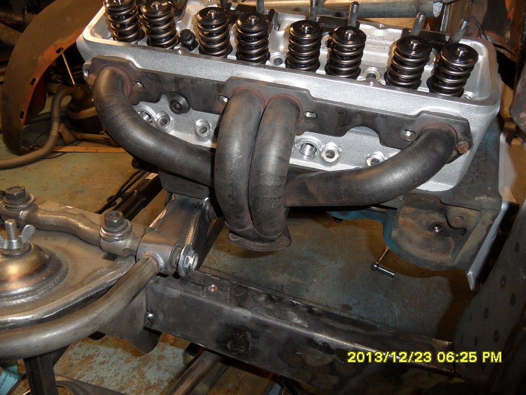

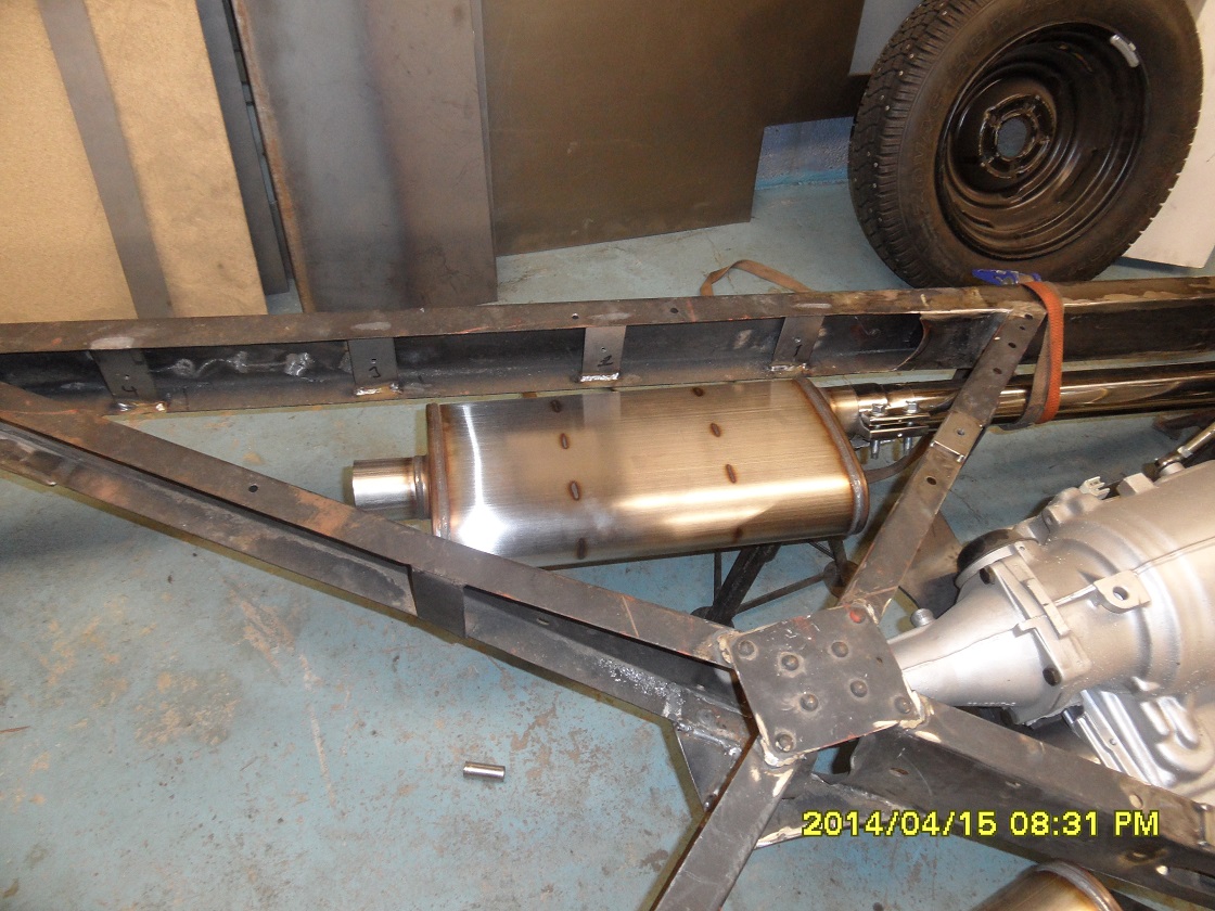

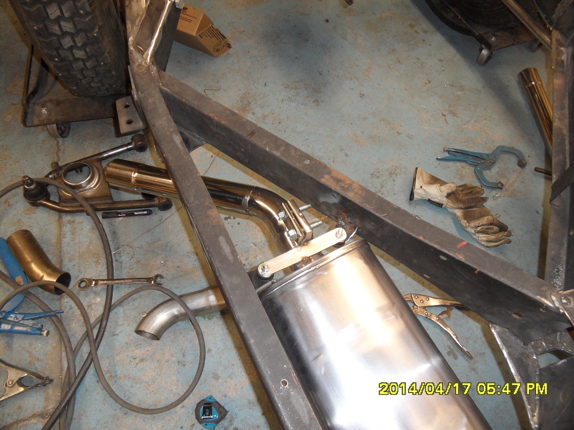

    I have tackwelded the exhaust system, a 2.5" stainless system with Magnaflow mufflers.
    Then a friend at work do the final tigwelding.
    I have also removed the flange on the headers and installed v-band clamps, I like them, they are easy to connect and dont leak.

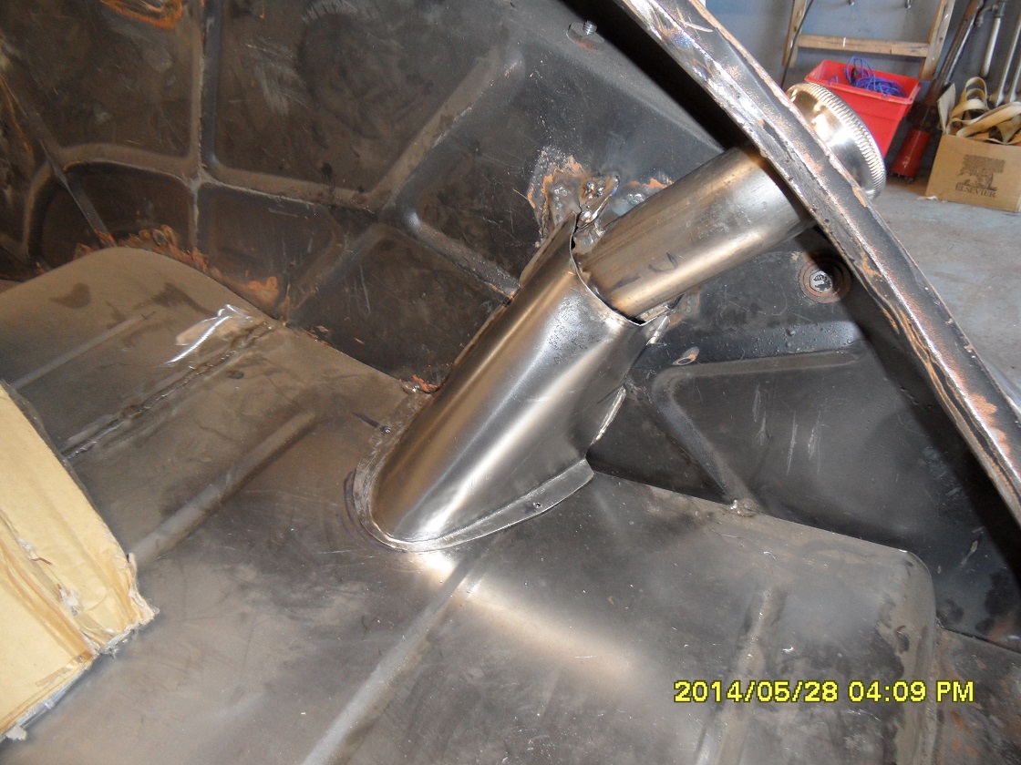

    I have made a fuel filler neck from a ****** 2 1/4" header tube for my Ford gas tank.And for gas cap I have bought one for a Volvo PV 444 .
    And made a cover for it.
