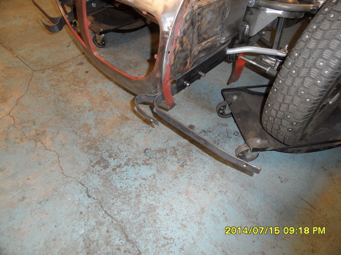

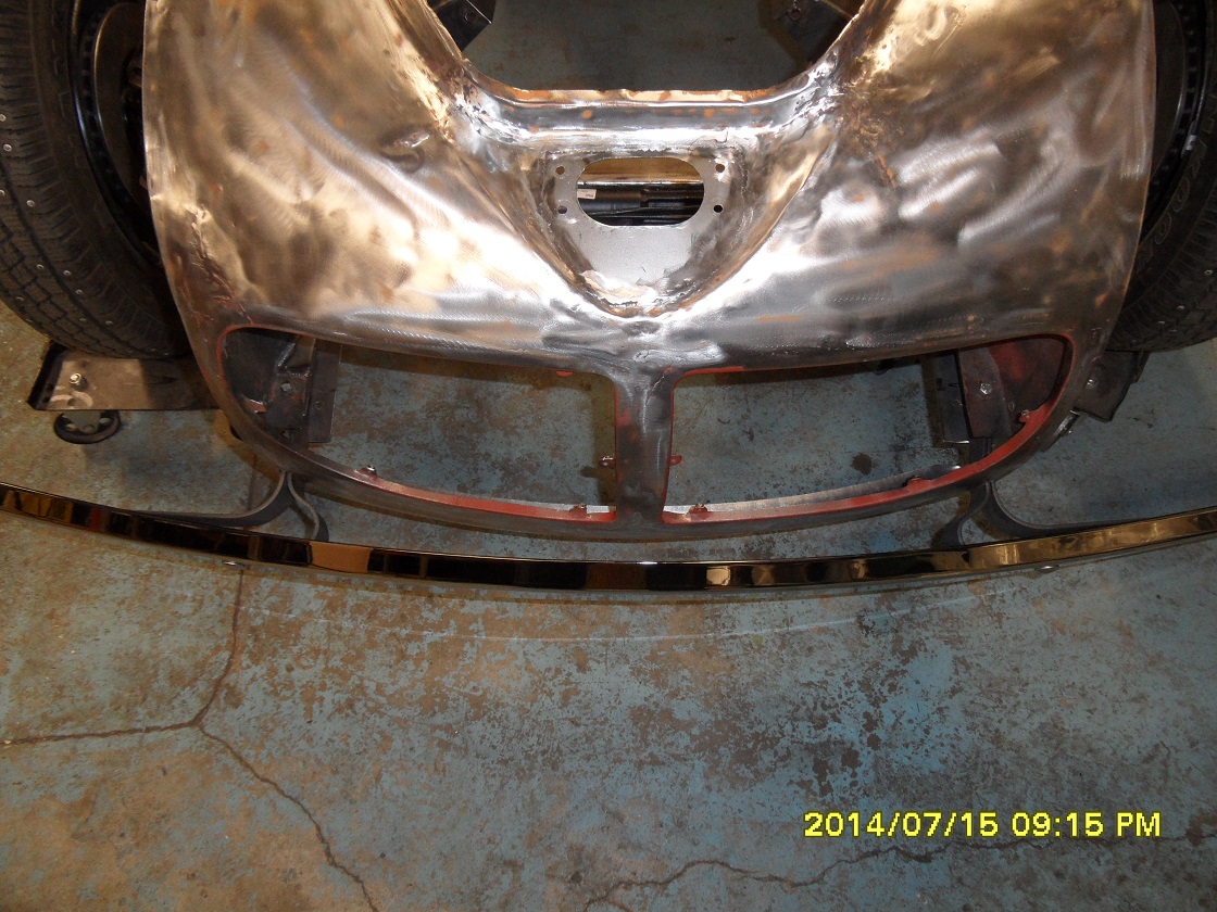

    Tomastudor
    Now I have made the bumper brackets and installed the bumper.
    Yes its a 41 Willys bumper but thats what I could find to buy.

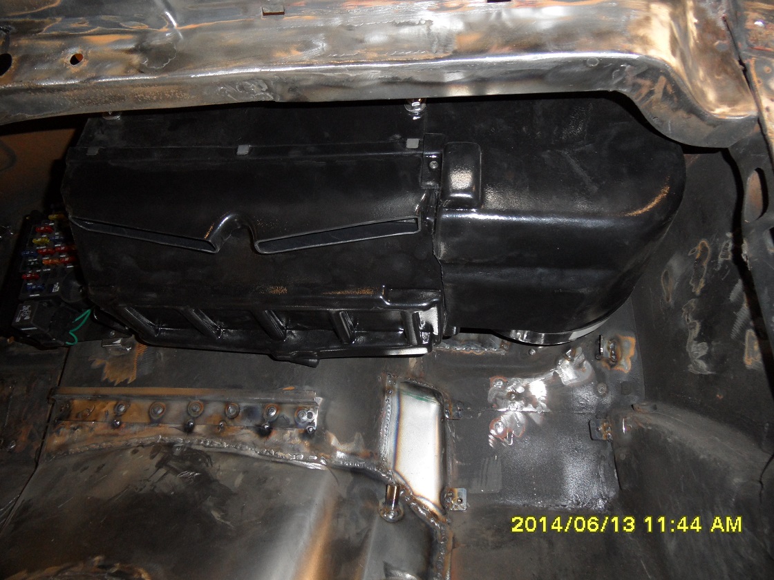

    Benn working under the dash for a while, I have made brackets for fuse box, air conditioning and relays.
    Have also made tabs for tying electric wiring.
    Its really tight fit to mount an aircondition evaporator behind a Willys dash:cool:.

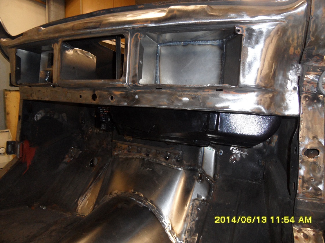

  3. Tomastudor
    Joined: Dec 15, 2009
    Posts: 311
    Tomastudor

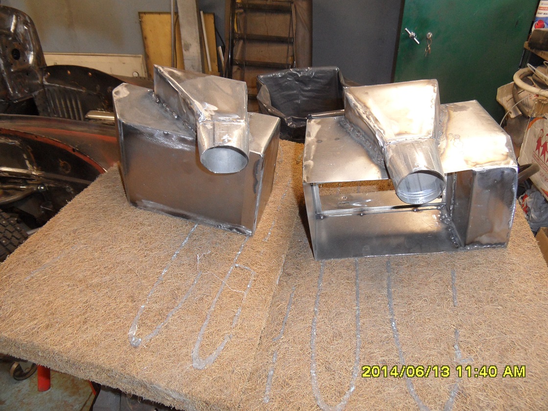

    Have made glove boxes combined with defroster vents for my Willys, the driver side will hold the AC control panel and radio-USB player.

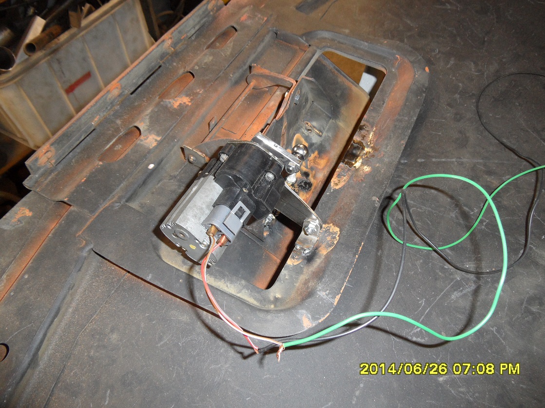

  4. Tomastudor
    Posts: 311
    Tomastudor
    There is so much things behind the dash of my Willys I discovered there no room for the vent handle.
    But I wanted to keep the vent therefore I have mounted an electric motor to drive the vent.
    The motor is from a a AC vent door that recykles the air from a 90,s SAAB 9000.

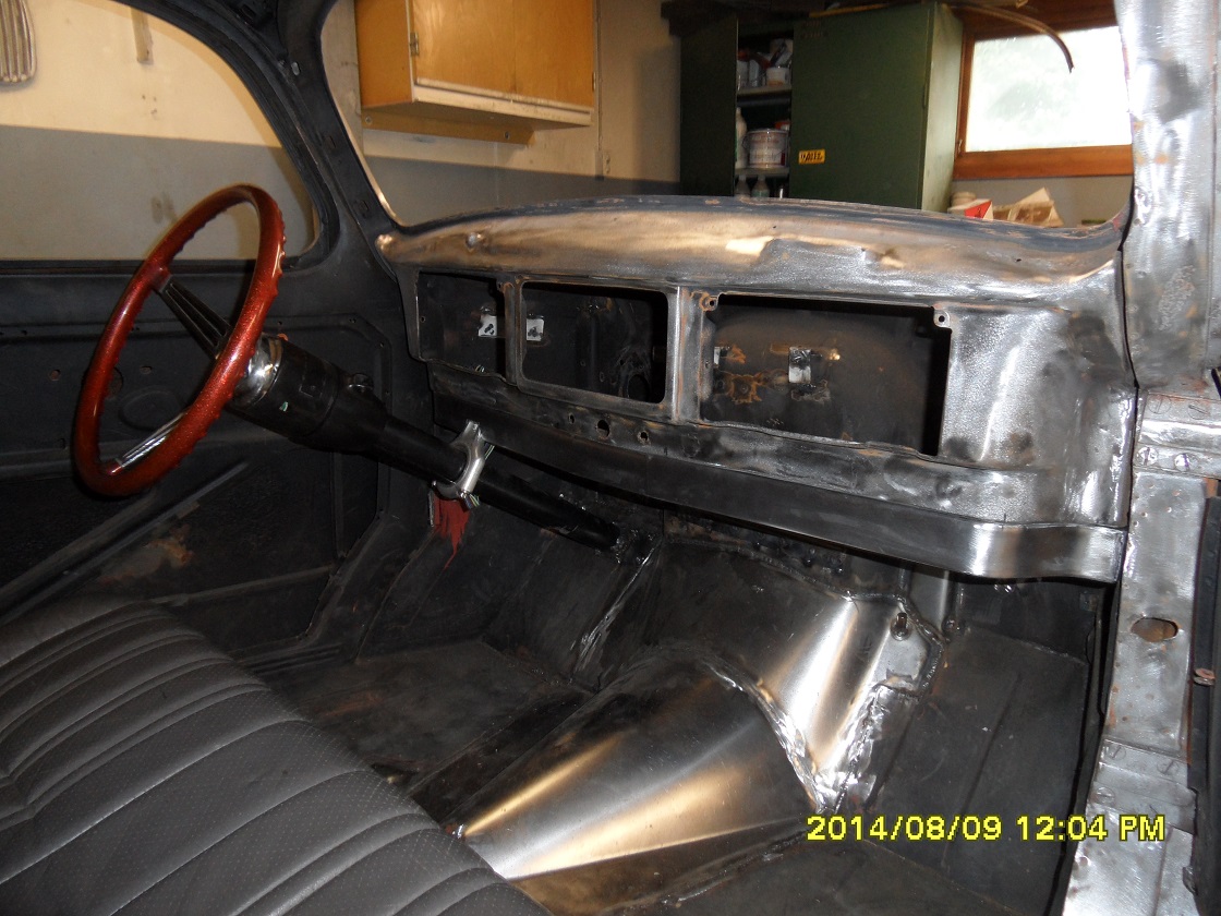

  5. Tomastudor
    Posts: 311

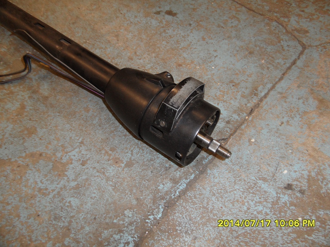

    Tomastudor

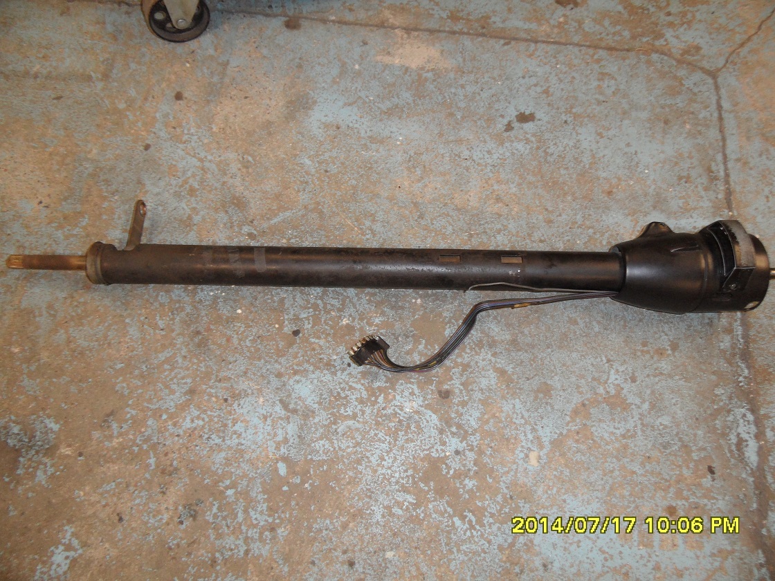

    My Willys project is steering back to safer highway with the help of a 70,s Chevy van steering column.
    The chinese junk will soon be run over by a fork lift or similar vehicle.
    Thanks Weasel and all others for your concern.:)

    Tomastudor

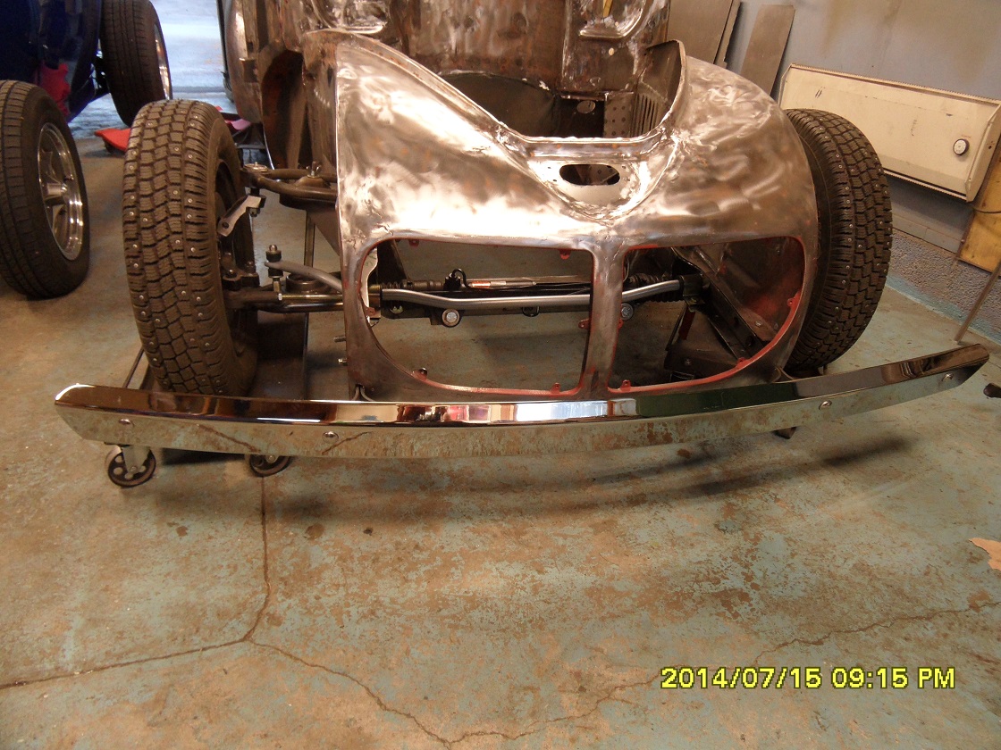

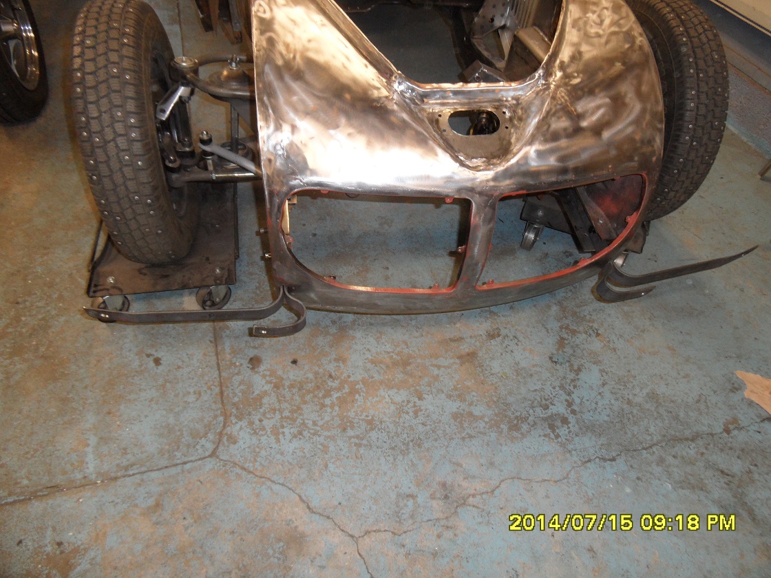

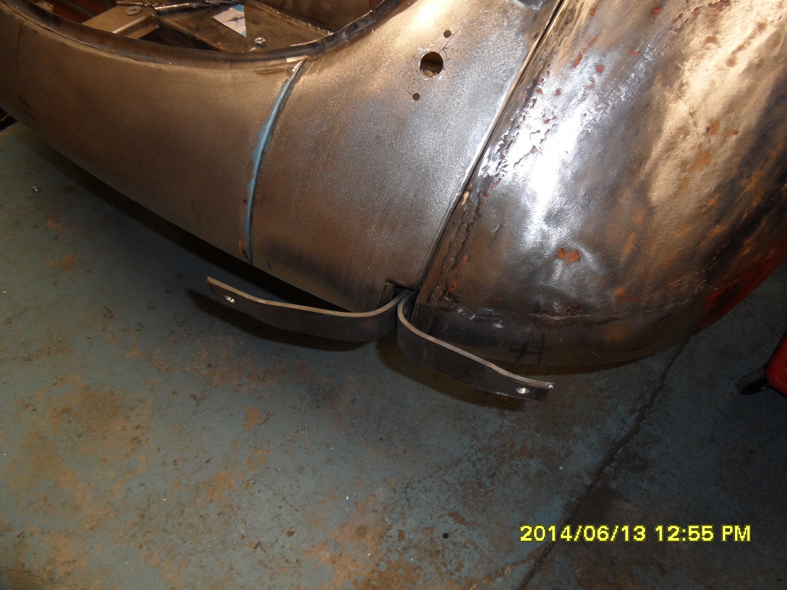

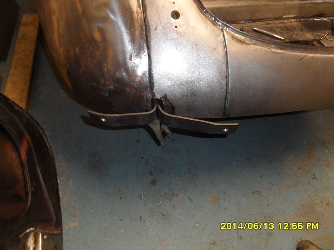

    I have not been doing so much because of the very warm wheather, but I have managed to do the front bumper brackets.

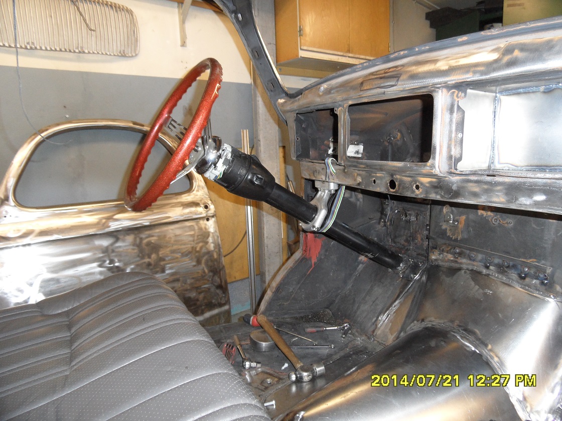

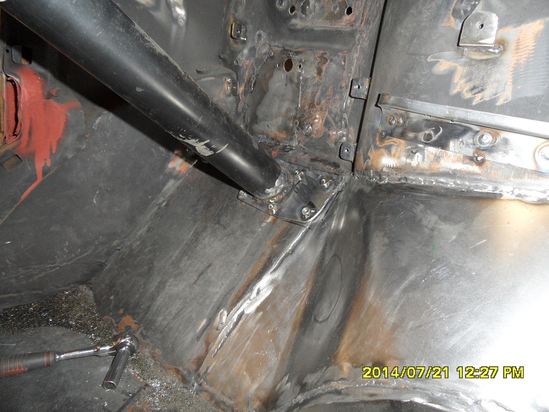

    Tomastudor

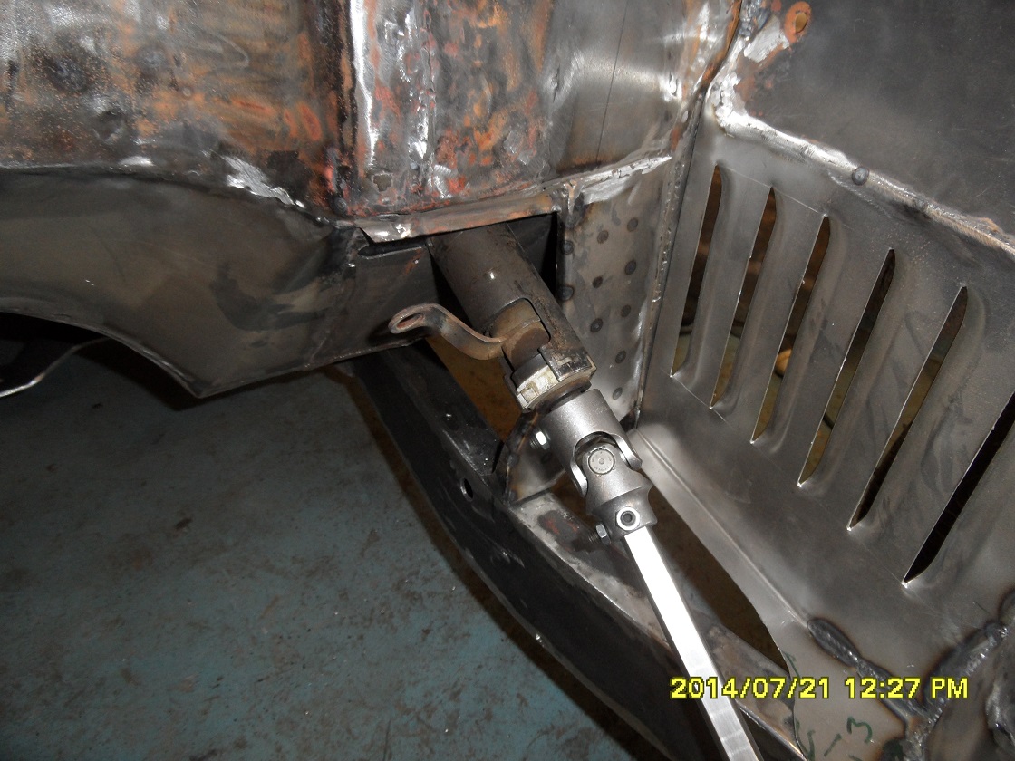

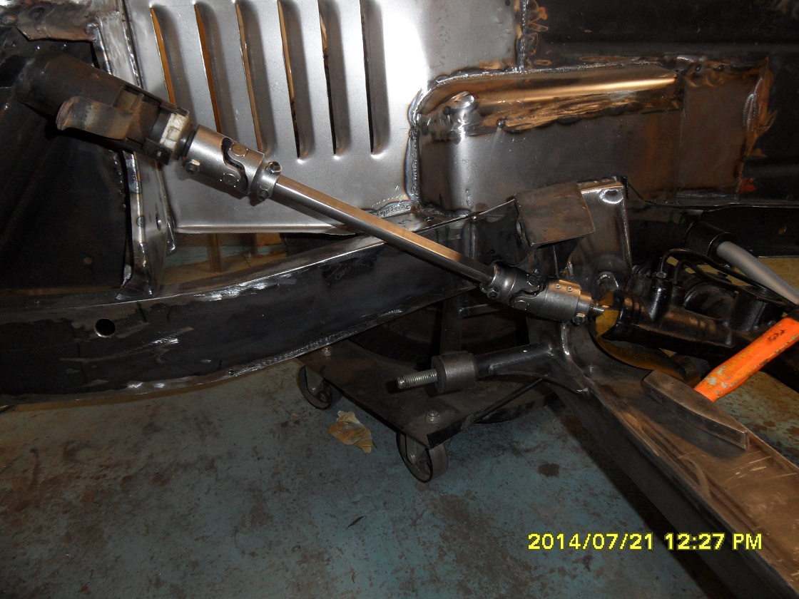

    I have installed the Chevy steering column in my Willys and the Borgeson u-joints and the intermidiate shaft.'
    Only need to do some t******* on the motor mount for some clearence.

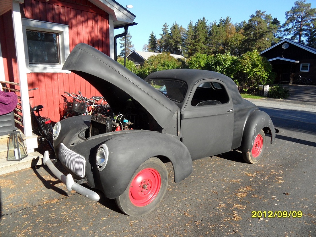

    Thanks both of you, and here is almost 2 years ago I had just bought it.

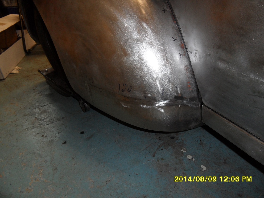

    I have not been satisfied with the shape of the lower rear part of the left front fender so I made a new piece.

  22. Tomastudor
    Posts: 311
    Tomastudor

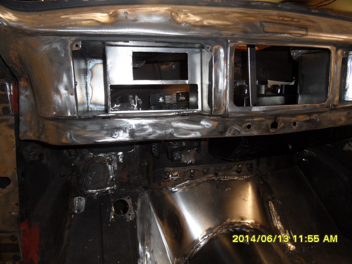

    I have made an extension to the dash where the airconditioning vents will be installed.
    It will also make the evaporator less visible.

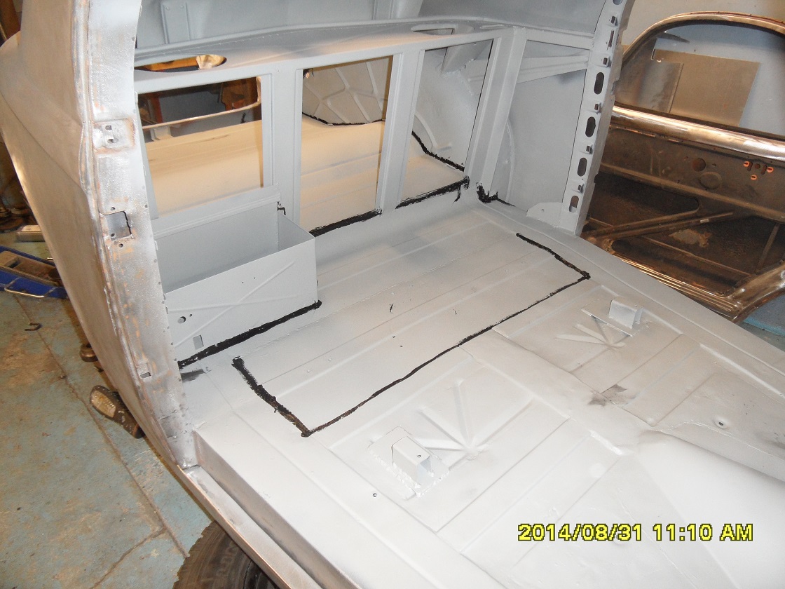

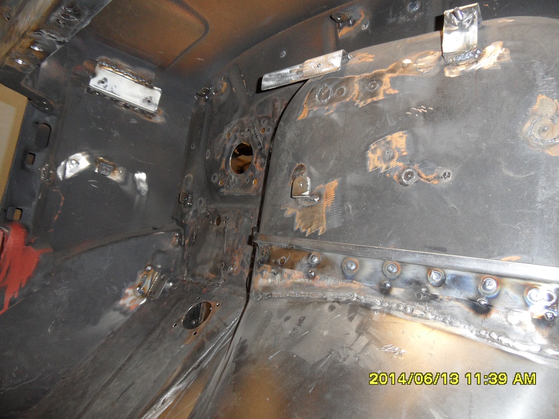

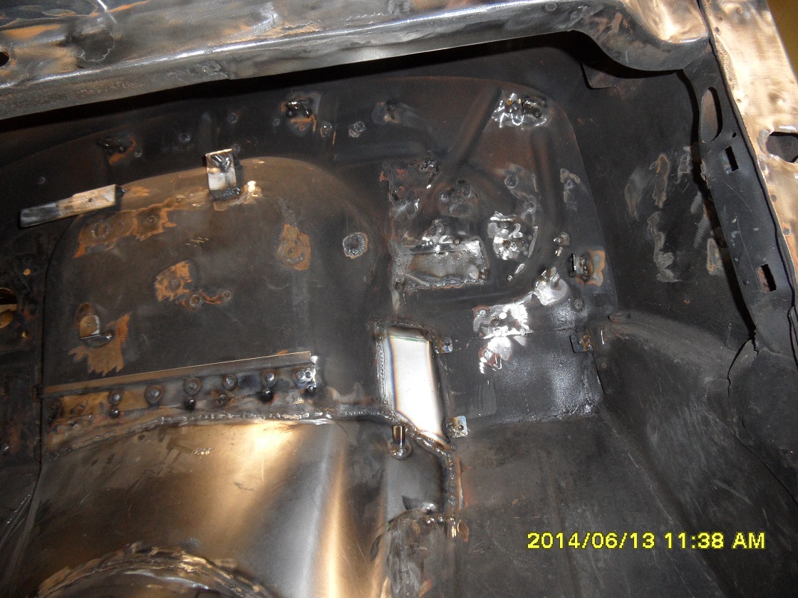

    I have put primer, sealed and painted topcoat on the inside of my Willys, it looks much better when its the same color on the inside.

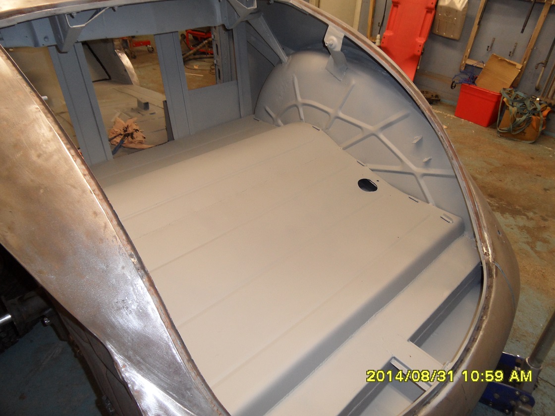

  27. Tomastudor
    Posts: 311
    Tomastudor

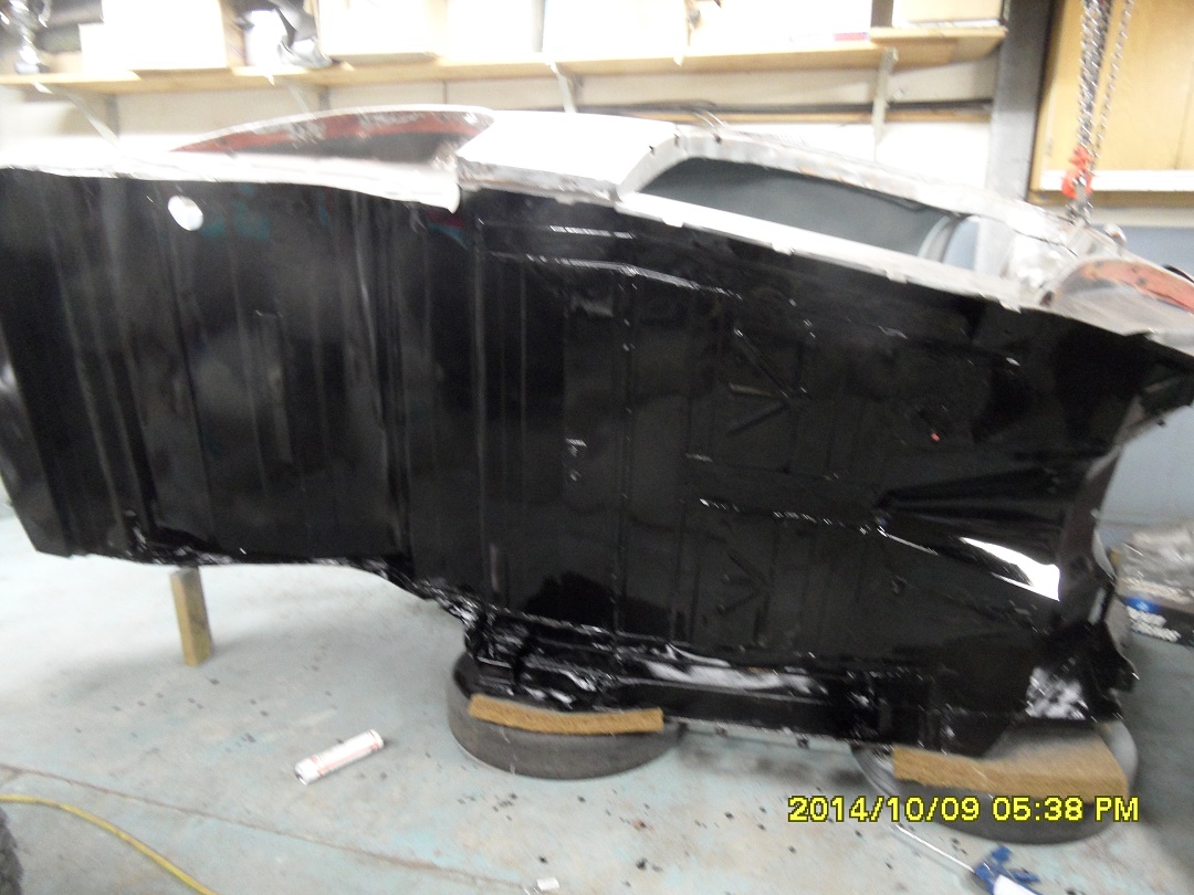

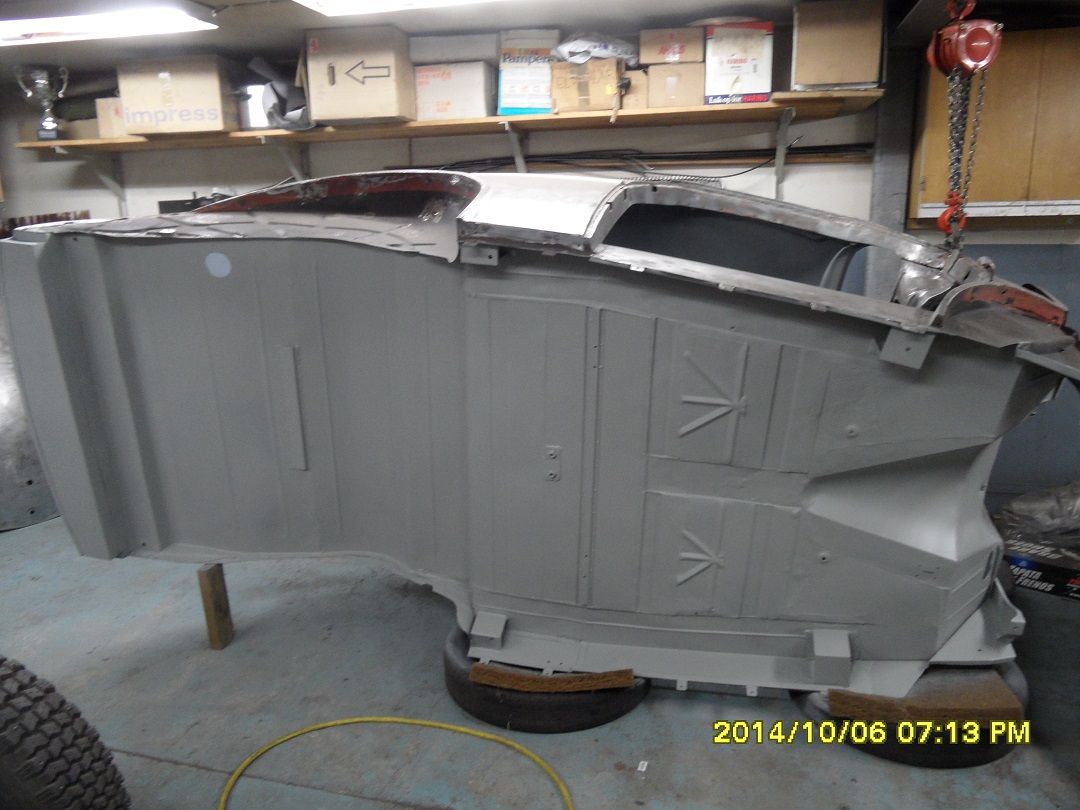

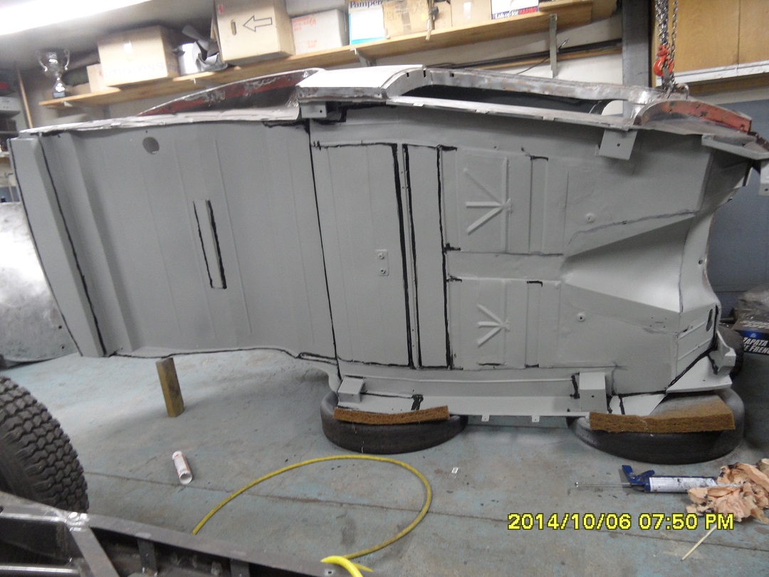

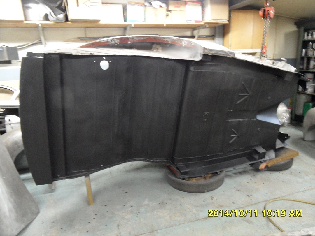

    I have removed the body from the ch***is and put primer, sealant, paint and body coating under my Willys body.

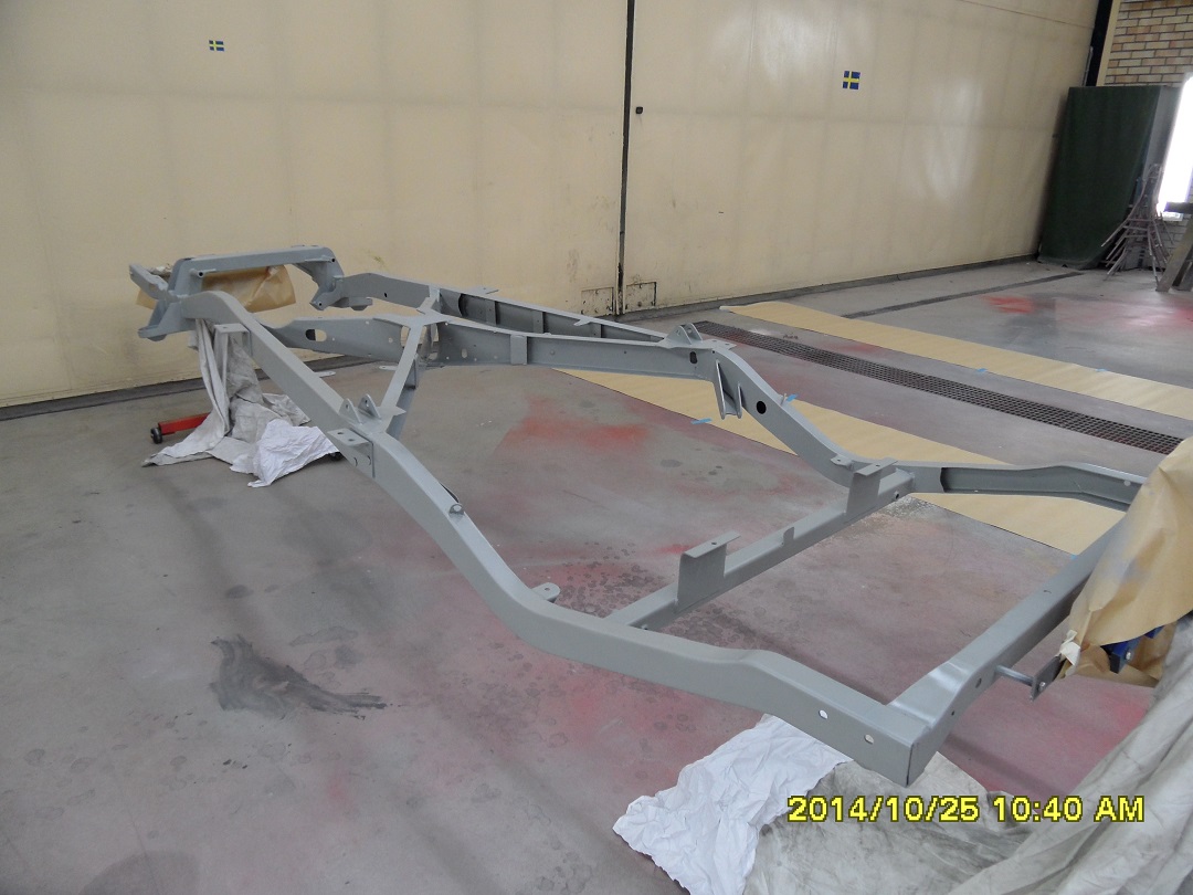

  29. Tomastudor
    Posts: 311
    Tomastudor

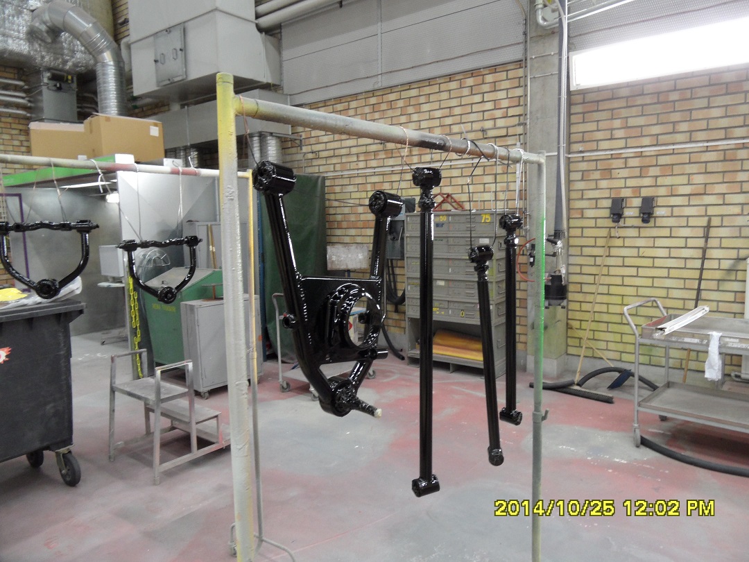

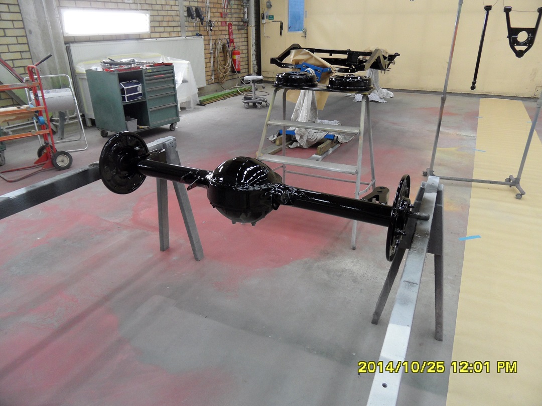

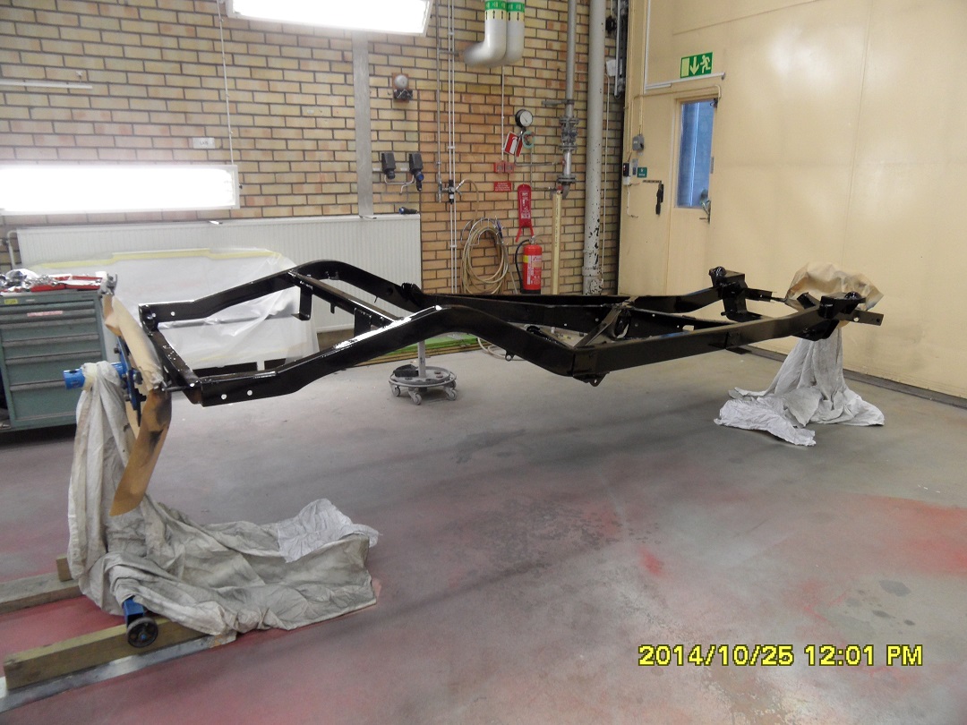

    The ch***is, rearend and suspension parts have been primered and painted
    kiwijeff likes this.

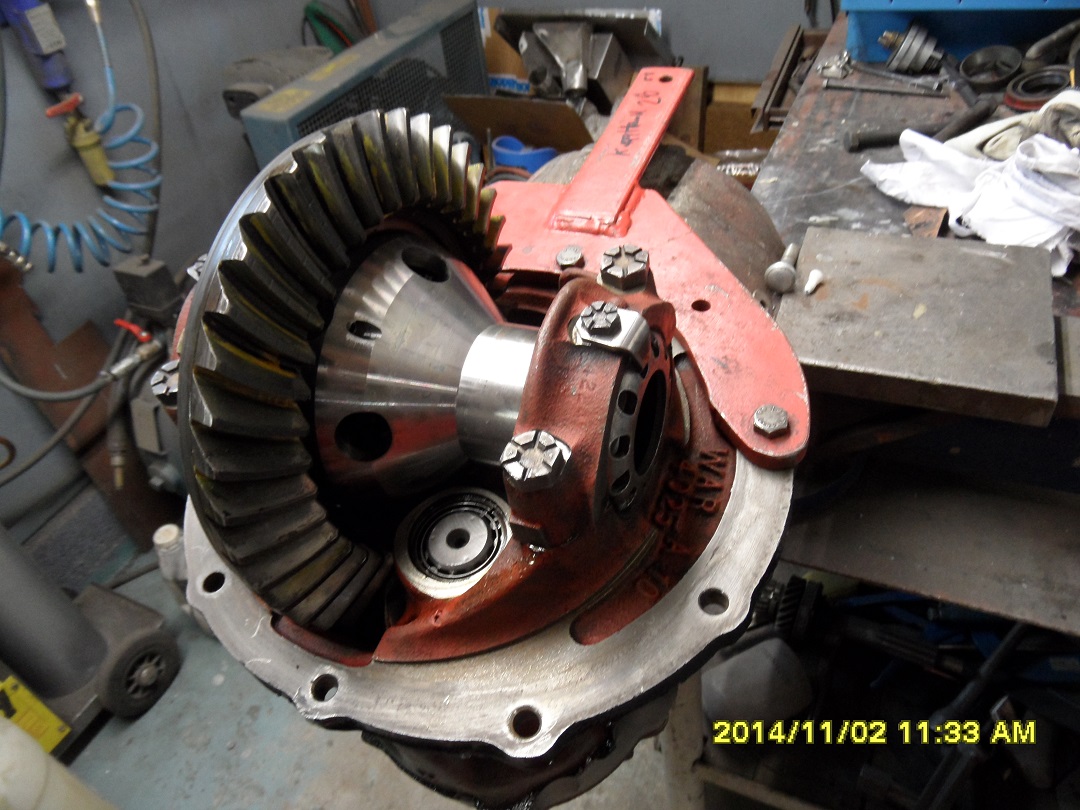

    This weekend I have rebuilt the third member on my Willys, I have installed a Summit Racing trac-loc differential and a set of 3.25 gears
