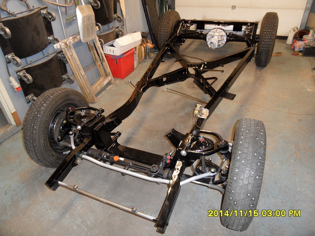

    Have started the final ***embly of my Willys ch***is :). And thanks Tumbleweeds for your comment.

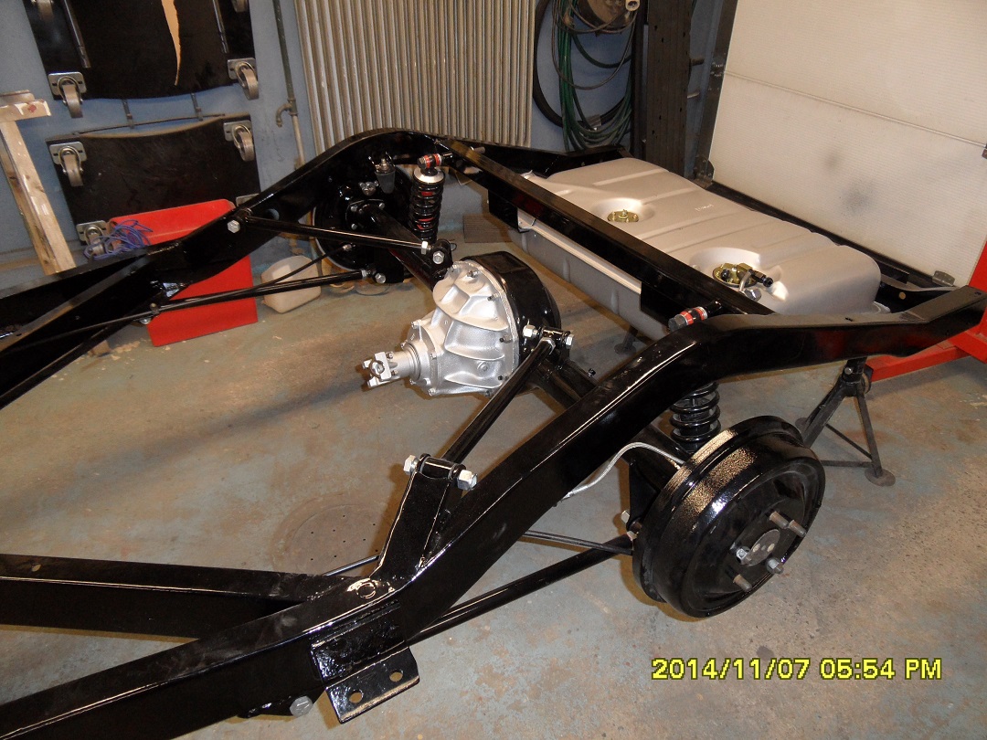

  5. Tomastudor
    Joined: Dec 15, 2009
    Posts: 311
    Tomastudor

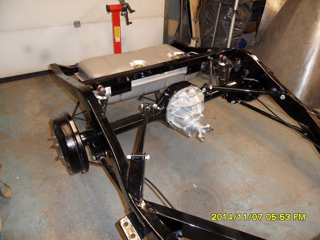

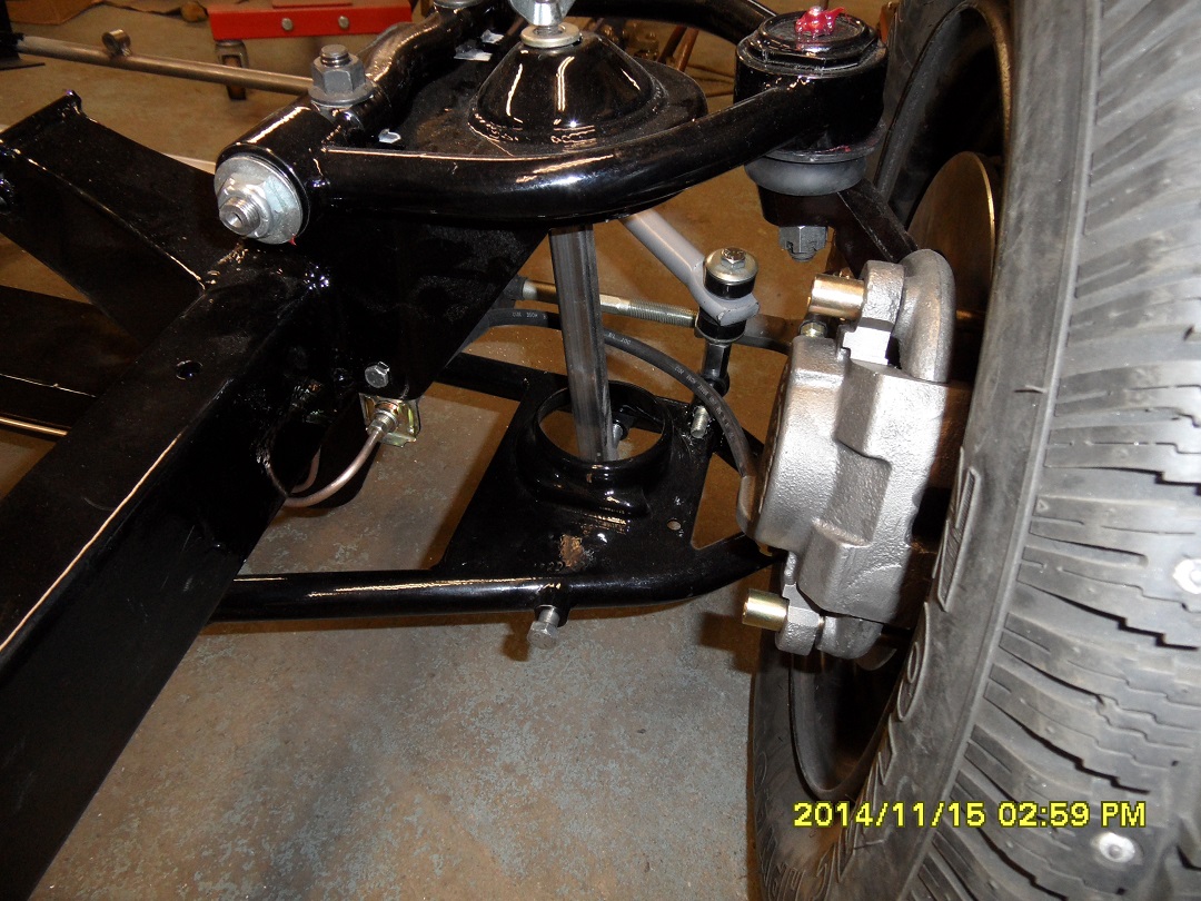

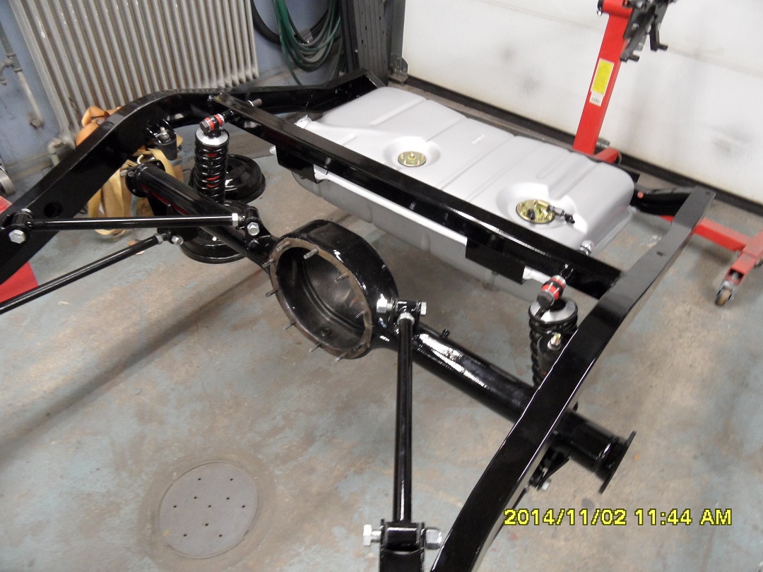

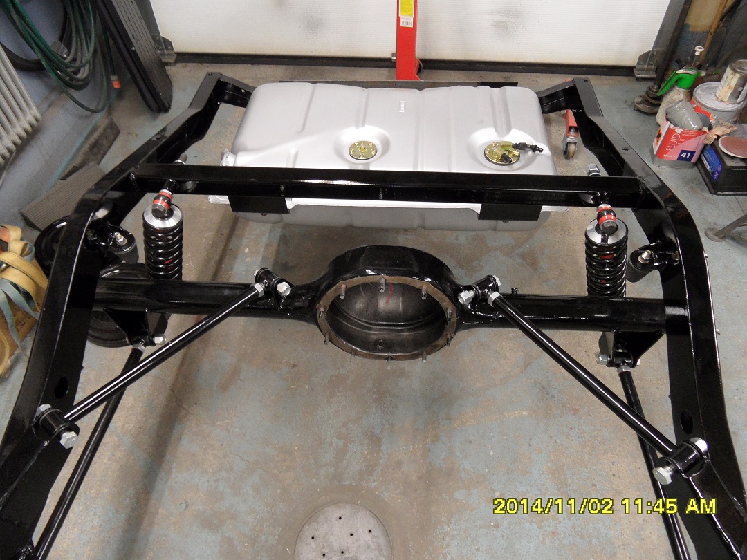

    I have ***embled the rearend, the centersection feels much lighter with the aluminium paint.
    Have also mounted the parking brake cables.

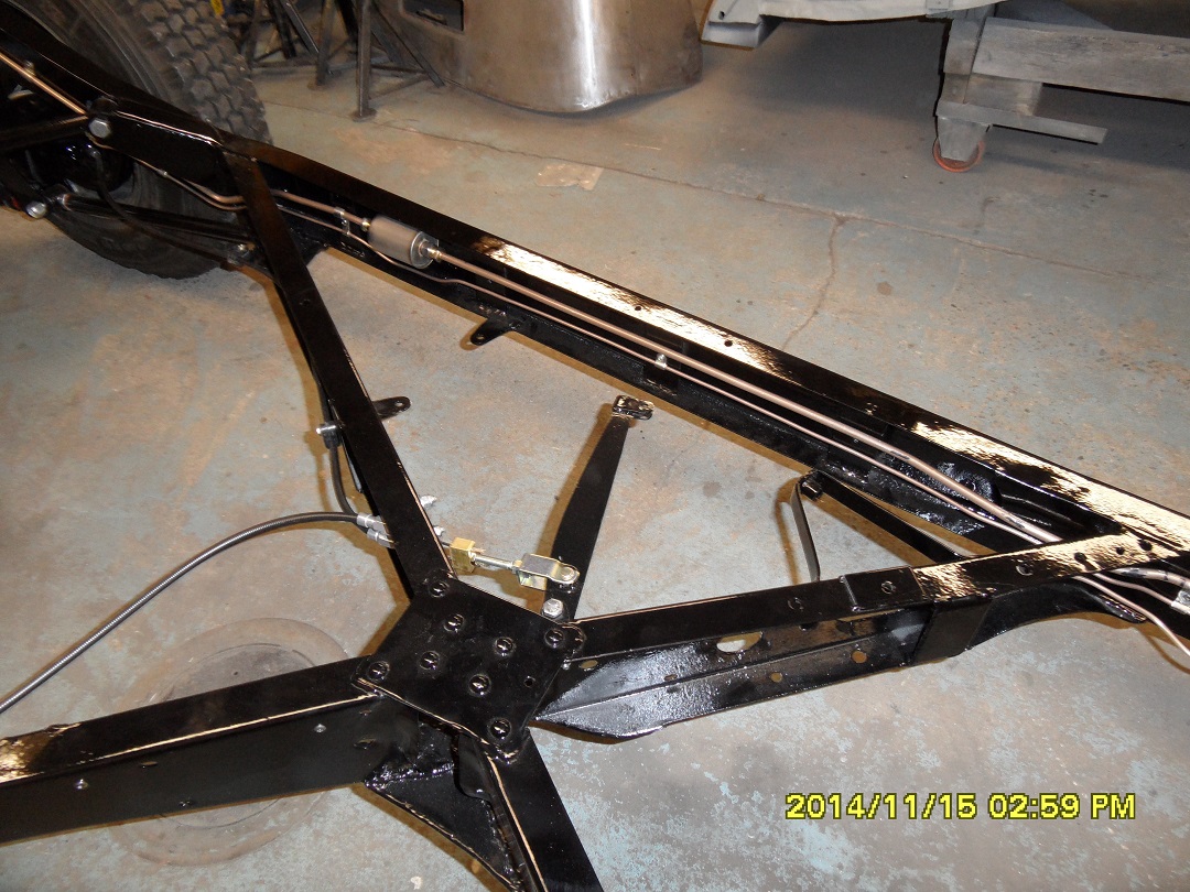

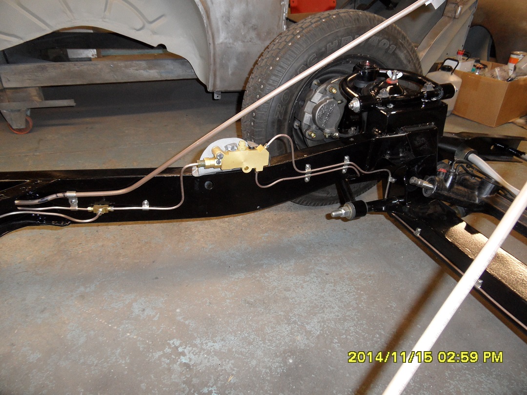

    This week I have made the fuel and brake lines for my Willys.
    The fuel lines will be finished when I put the body on to the ch***is.

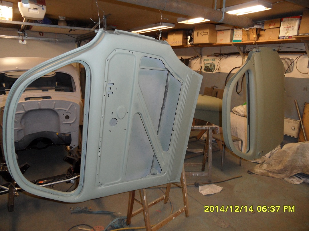

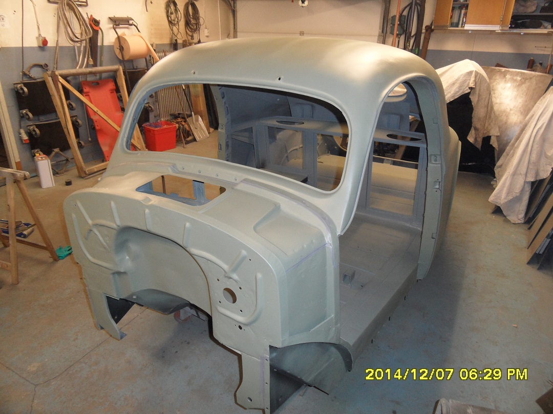

    Now I have started the bodywork on my Willys, I have painted the body with epoxy primer
    kiwijeff and loudbang like this.

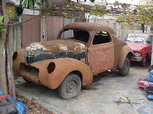

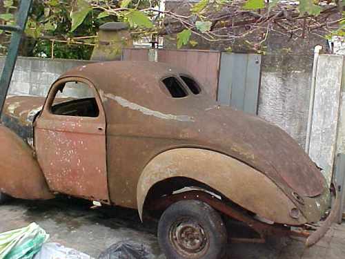

    This 3w in pics it's for sale in Argentina in 2008 approximately, for 15.000$ and if I remember the seller's name was Francisco Ansoain..........
  9. elgringo71
    Joined: Oct 2, 2010
    Posts: 3,868
    elgringo71
    I don't think that this is the same car, I believe that this one was in Rafaela Santa Fe. There have been a few for sale down there. On page 1 he mentions that it had orange paint underneath like one that is shown in a post by 3 day.

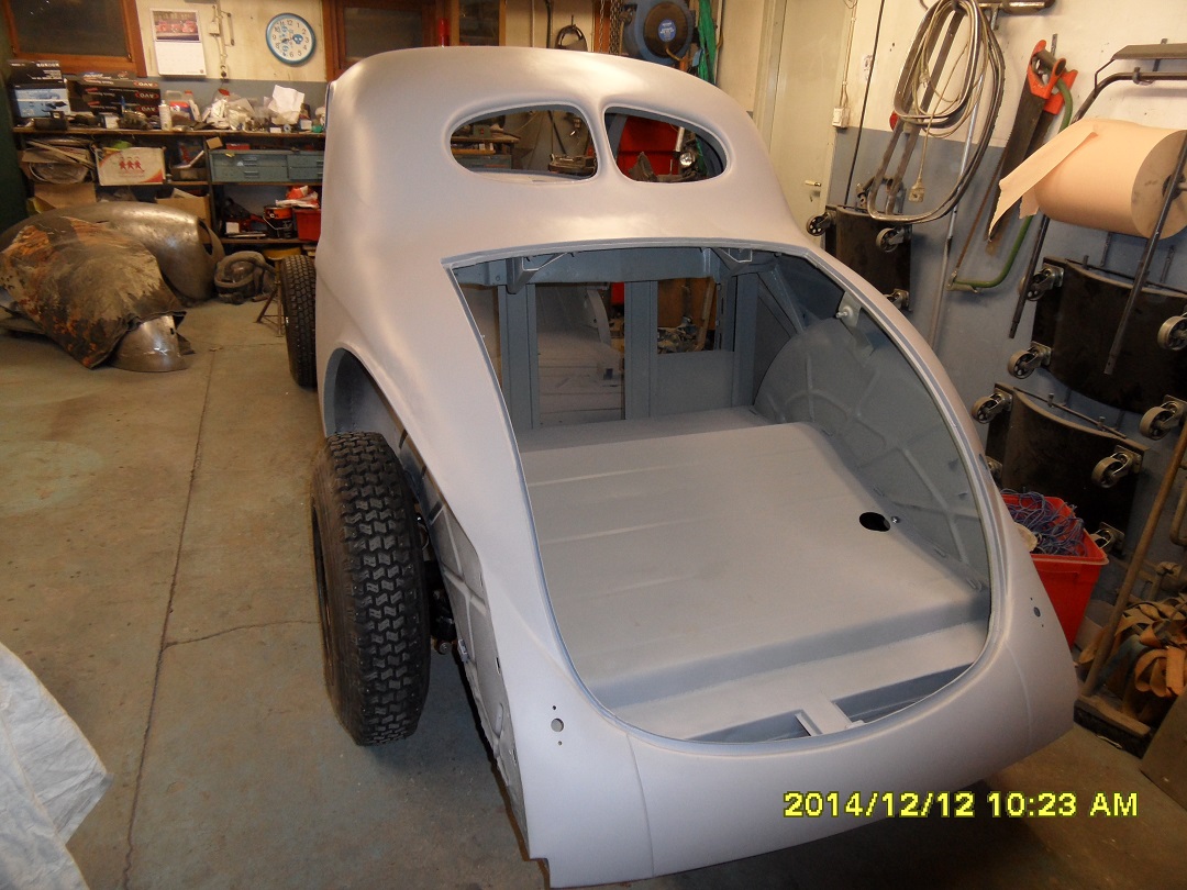

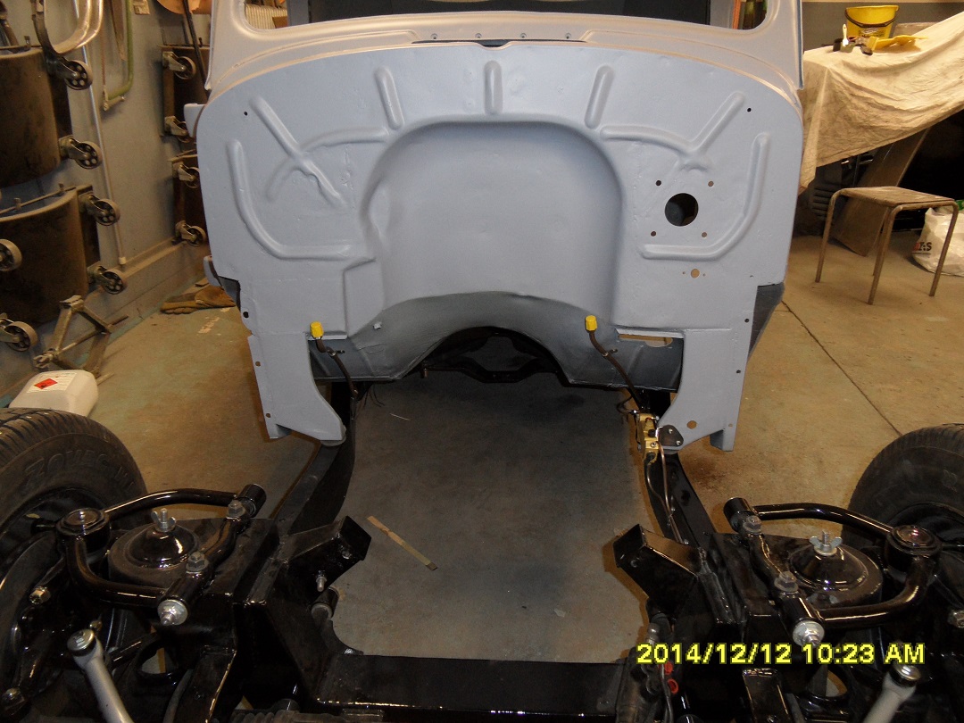

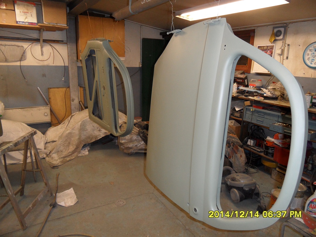

    Most of the parts are now primered, doors, hood and fenders, its bondotime.

    So you are one of the guys that likes to put bondo over primer and not bare metal?
  19. Tomastudor
    Posts: 311
    Tomastudor
    I have never done it this way before but the paint system i am using Glasurit, says you should do it this way.

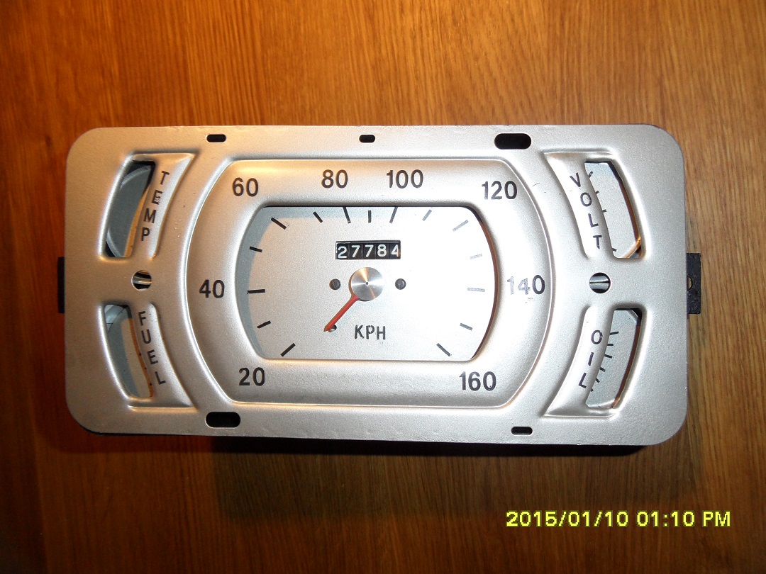

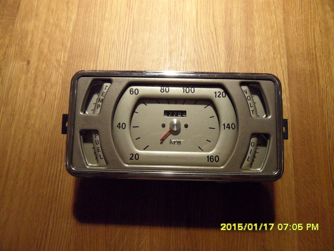

    The last weeks I have been applying filler and sanding, Its still boring even on a Willys. A while ago i modified the instrument cluster . I removed the original gauges and replaced them with more modern. Three VDO gauges, one Autometer and a SAAB speedometer.

  23. Tomastudor
    Posts: 311
    Tomastudor
    The Willys gauges ***embled, I think it looks very nice.

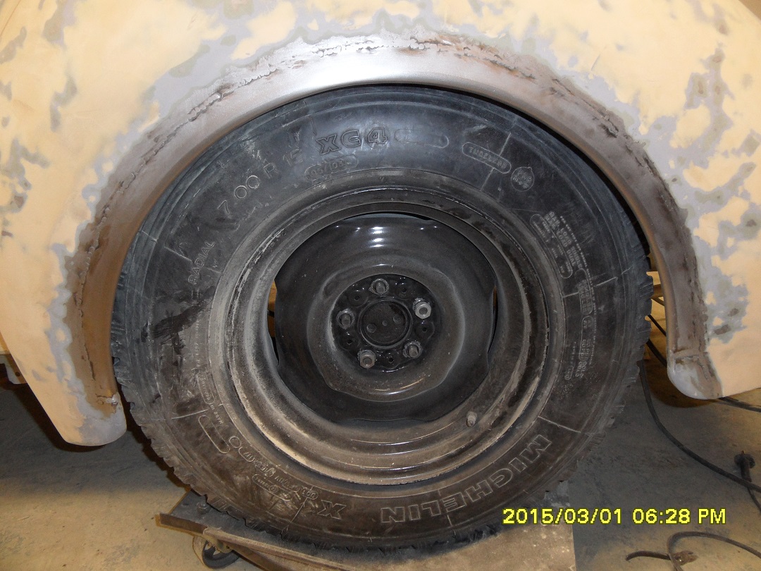

    I have not been satisfied with the wheel openings on the rear fenders on my Willys. the left one was longer and more forward than the right one, therefore I made new ones just like ME.G***ER did on his Beside the barn find Willys.
    I made a wood buck and hammered the patch panels.Thanks for showing how its done.

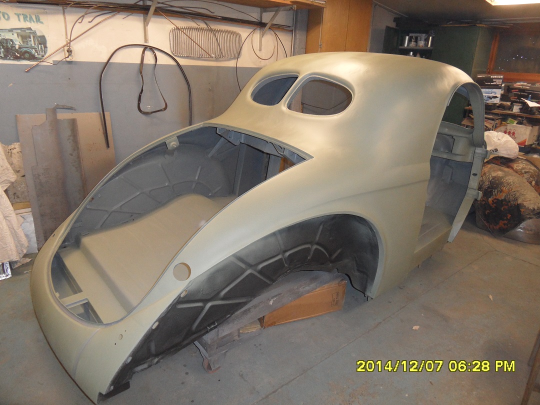

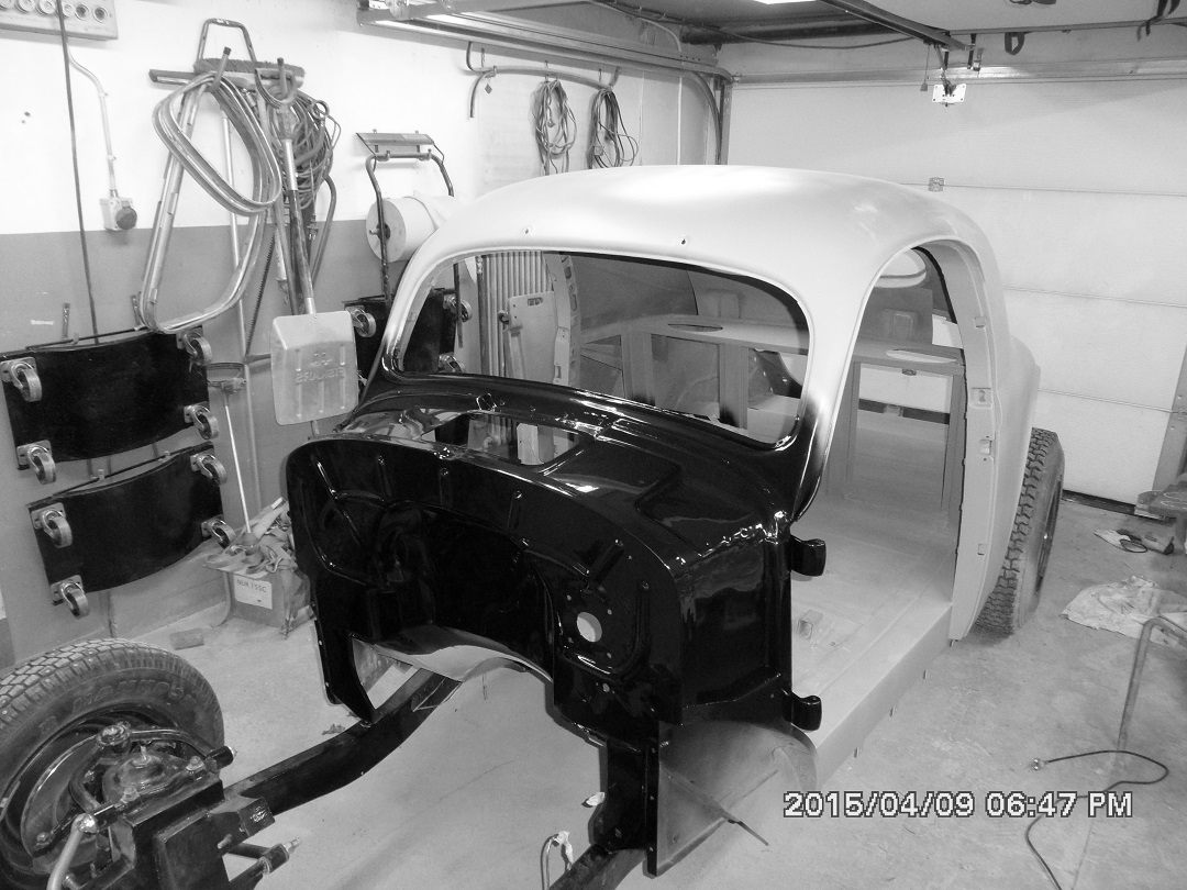

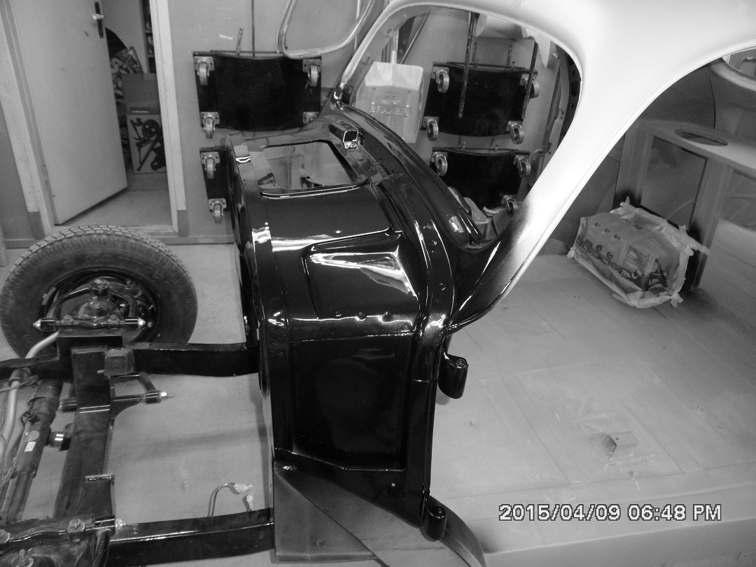

    Long weeks of sanding and applying filler on my Willys but now the body is primered and the paint shop has painted the dash and firewall. Now I will continue with the insulation of the body, do the wiring and installing everything under the dash.
