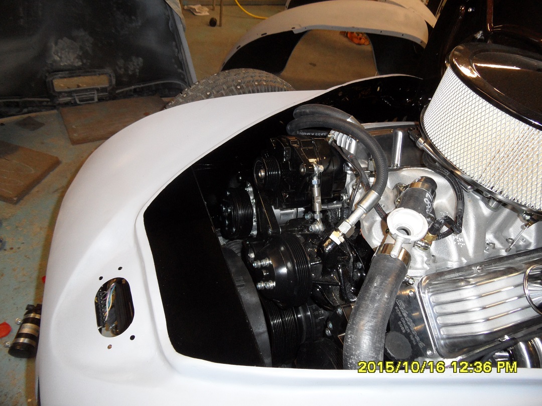

    The March Performance serpentine kit installed in my Willys SAM_3427.JPG SAM_3428.JPG SAM_3429.JPG

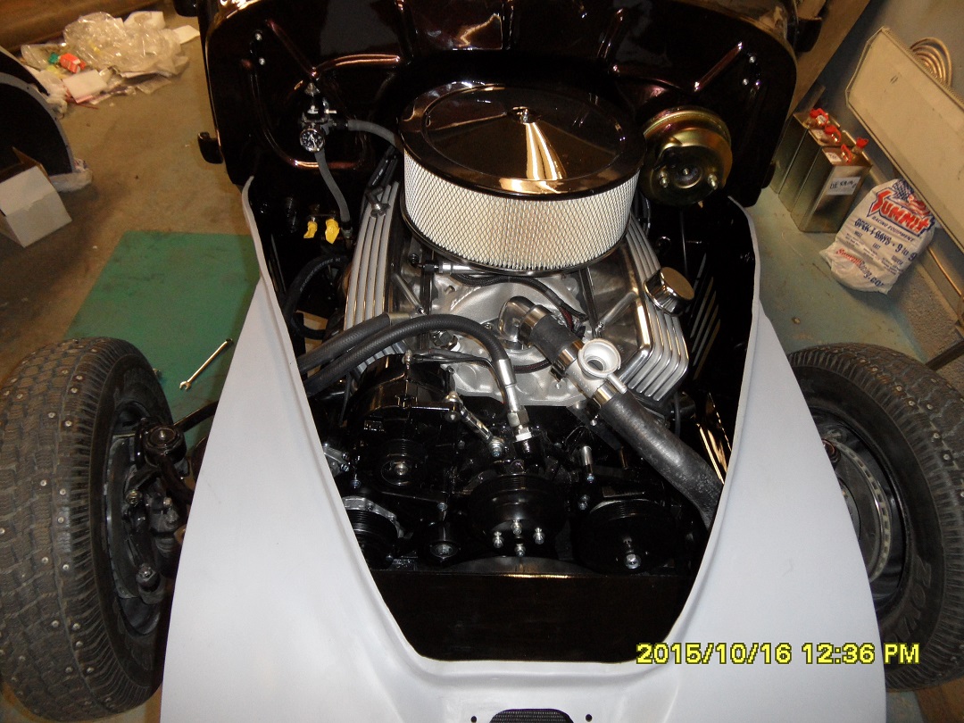

    And the centersection testfitted on my Willys. Its tight but there is room for everything.

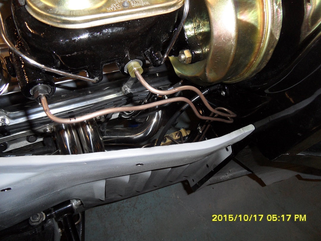

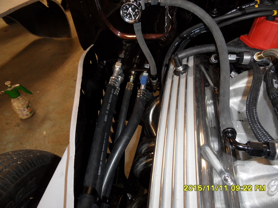

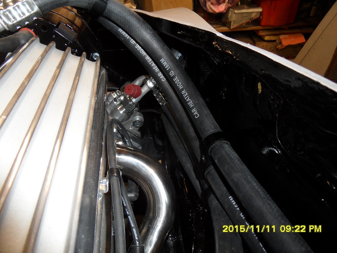

    The brakelines to the mastercylinder done

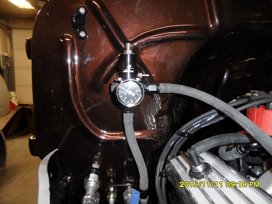

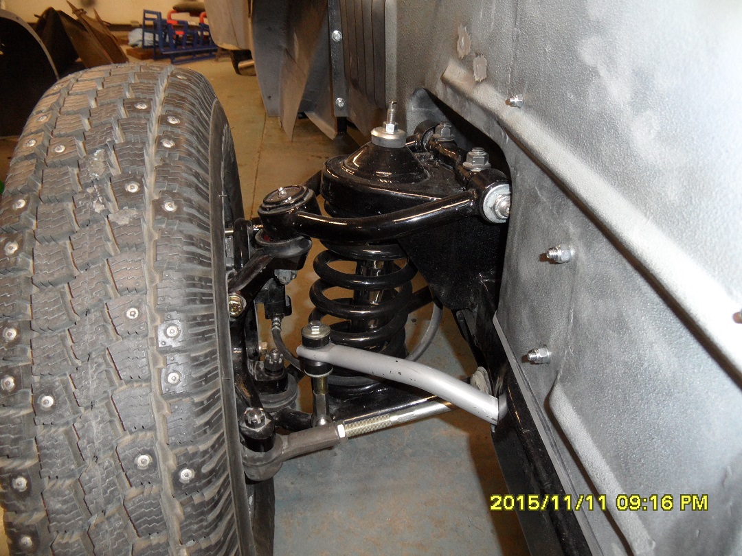

    Installed the front springs, at 375 lb/inch I guess they are a little to stiff but I will not shorten them before everything is on the car.All hoses are there and all the fluids are filled. I have adjusted the fuelpressure and installed a mech oilpressure gauge because the plan is to start up the engine on my Willys this weekend.

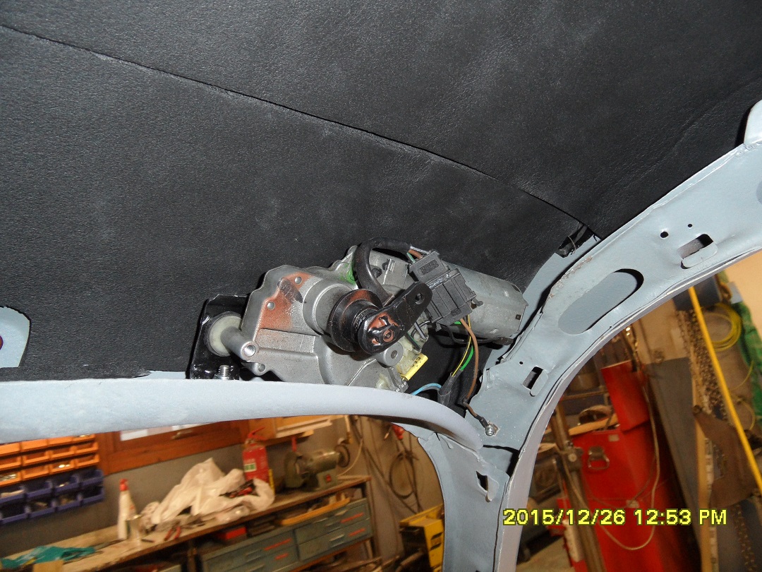

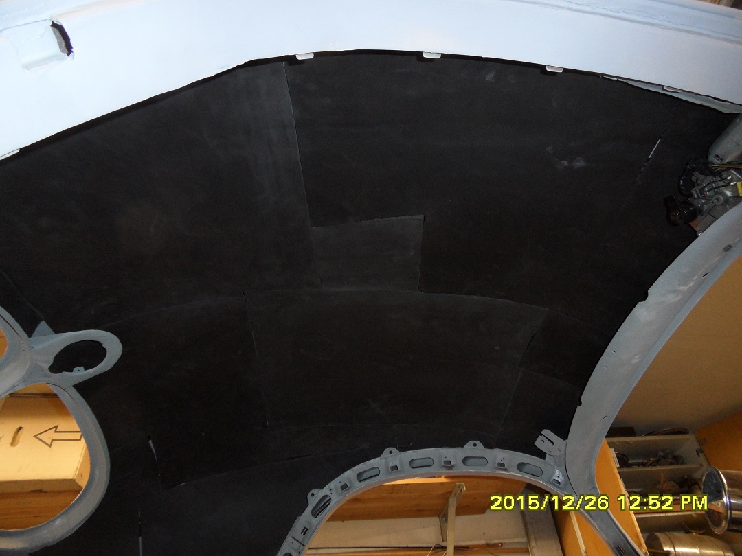

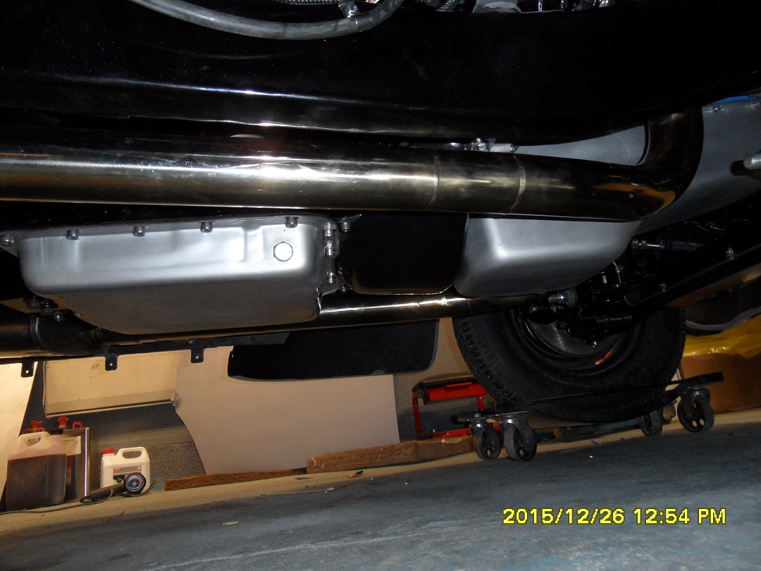

    I am waiting to get the Willys painted, they are really busy. Somethings have been done the exhaust system is there, the insulation on the roof and a VW rear wiper motor installed

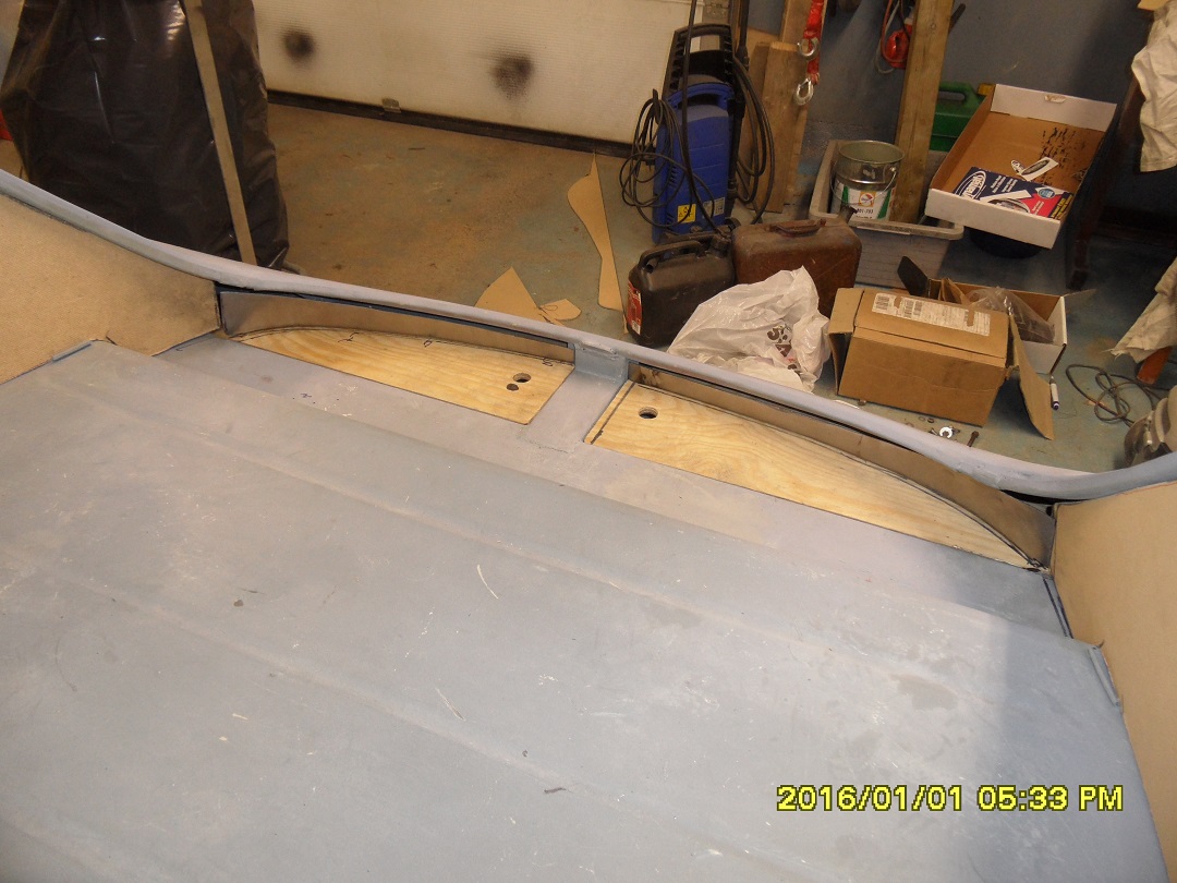

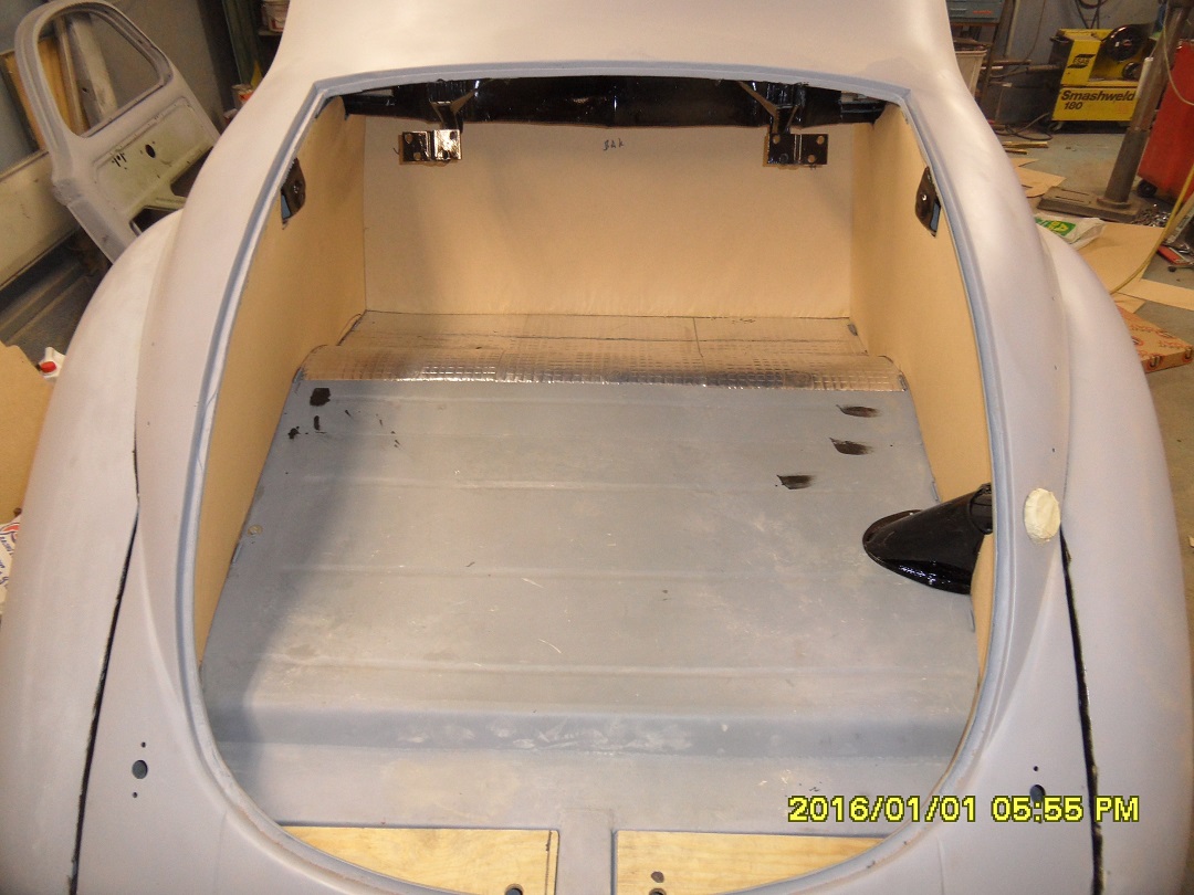

    The cardboard, masonite panels for the trunk is done ready for upholstery.

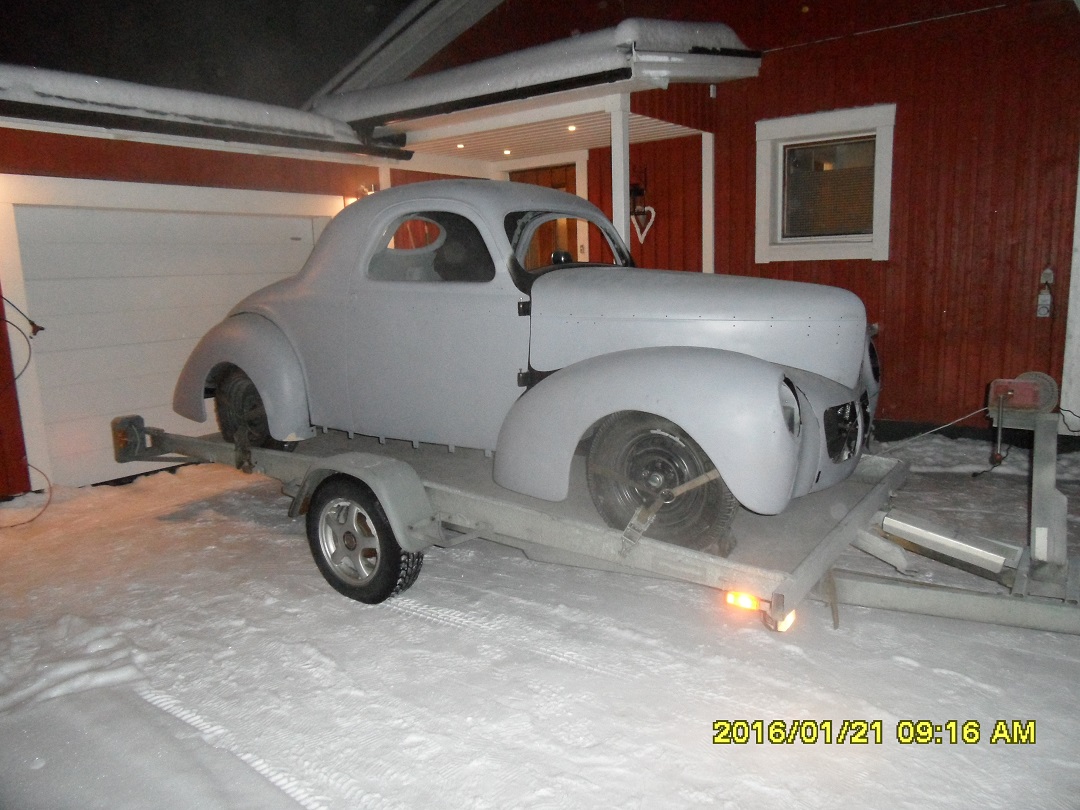

    Towing the Willys to the paintshop on the coldest day this winter, -31 degrees Celsius thats -24 Fahrenheit.

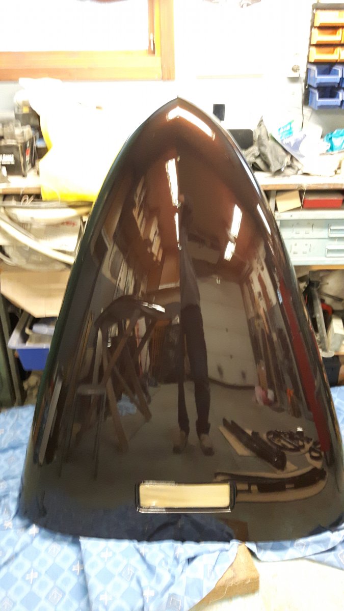

  23. Tomastudor
    Joined: Dec 15, 2009
    Posts: 311
    Tomastudor
    Some parts for my Willys back from the paintshop :) 20160219_132544.jpg
