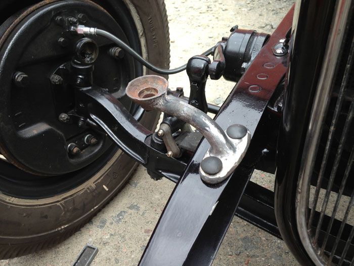

    Been lots of catching up with other things after the intense garage sessions before the car show. But now it is time to try get the little roadster rolling. Started on the headlight stands. I want them to be easy to take off and drive without in daytime. Sweden has a " daytime low beam law", but some old vehicles can get an exemption from this due to the bad charging of old generators. I am hoping to get that. :) We'll see.
    We took the original Model A headlight bar and cut it off. Left a piece on the other side of the "bowl" to grab when bending
    Then checked out the angle and height
    Let's bend some more
    Notice! No water on the ground!
    After cutting, checking and welding for some time, one is done. The other will be done tonight!

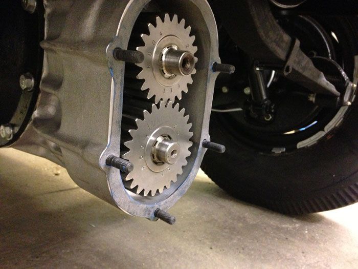

    I couldn't find anywhere to buy gaskets for the Quickchange, so I did my own. Do they sell that anywhere?

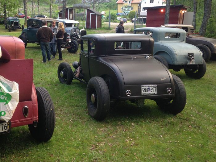

    The meeting was great this weekend and it was no sleep, only party. We took the cars for a run during Saturday and the new roadster worked great. But I have problems with radiator water pumping out while driving. I might have too soft radiator cap pressure. The engine is pretty souped up and I have a Walker radiator, so i might use some higher pressure. What should it be for a bit hotter engine and that radiator? 7 lbs? 15 lbs? 4 lbs?
    Some nice cars showed up

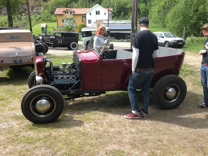

    A nice new built Phaeton showed up
    Finally on the road for a little longer rtip. Felt great! :)
    We drove to Trollhattan on small roads (about 30 miles one way) and their very nice cafe by the river sluice system. 27 cars, all 1934 and older hot rods.
    The roadster by the river boat
    Early morning shot back at the site... Erik's nice genuine 1932 roadster
