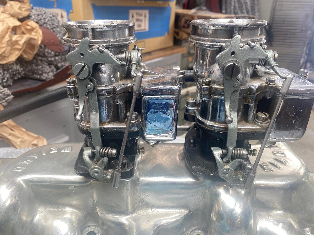

    hi, working on a 1951 8BA. it had a single ford 94 carb and i have two stromberg 97 and a dual carb manifold that i bought from speedway that i'm switching to.
    trouble is that i had a vacuum line from the single carb to the distributor but there are no such ports on the 97s.
    so my question is what do i need to do to make this work.
    i've attached pics of the carbs. the manifold pictured is different from the one i'm using. i'm using speedway's generic one.
    thanks

    Did you look at the pics? They sure look like some old chrome real Strombergs to me. You can see the large 97 on the rear carb even.

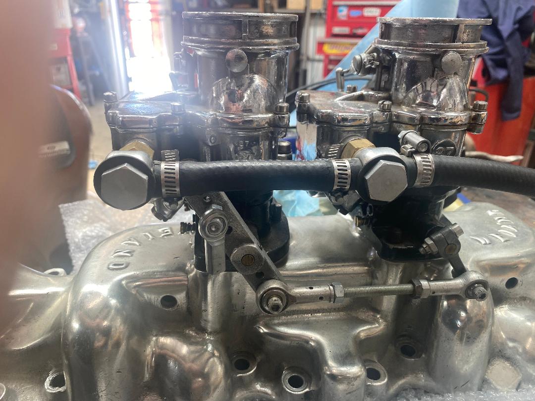

    2nd pic didn't load for me, so all I was going off of was the OP saying he got 2 carbs and a manifold from Speedway... Guess I must be a total idiot....

    I enlarged the pics in the first post. always select "full image" when posting pics
