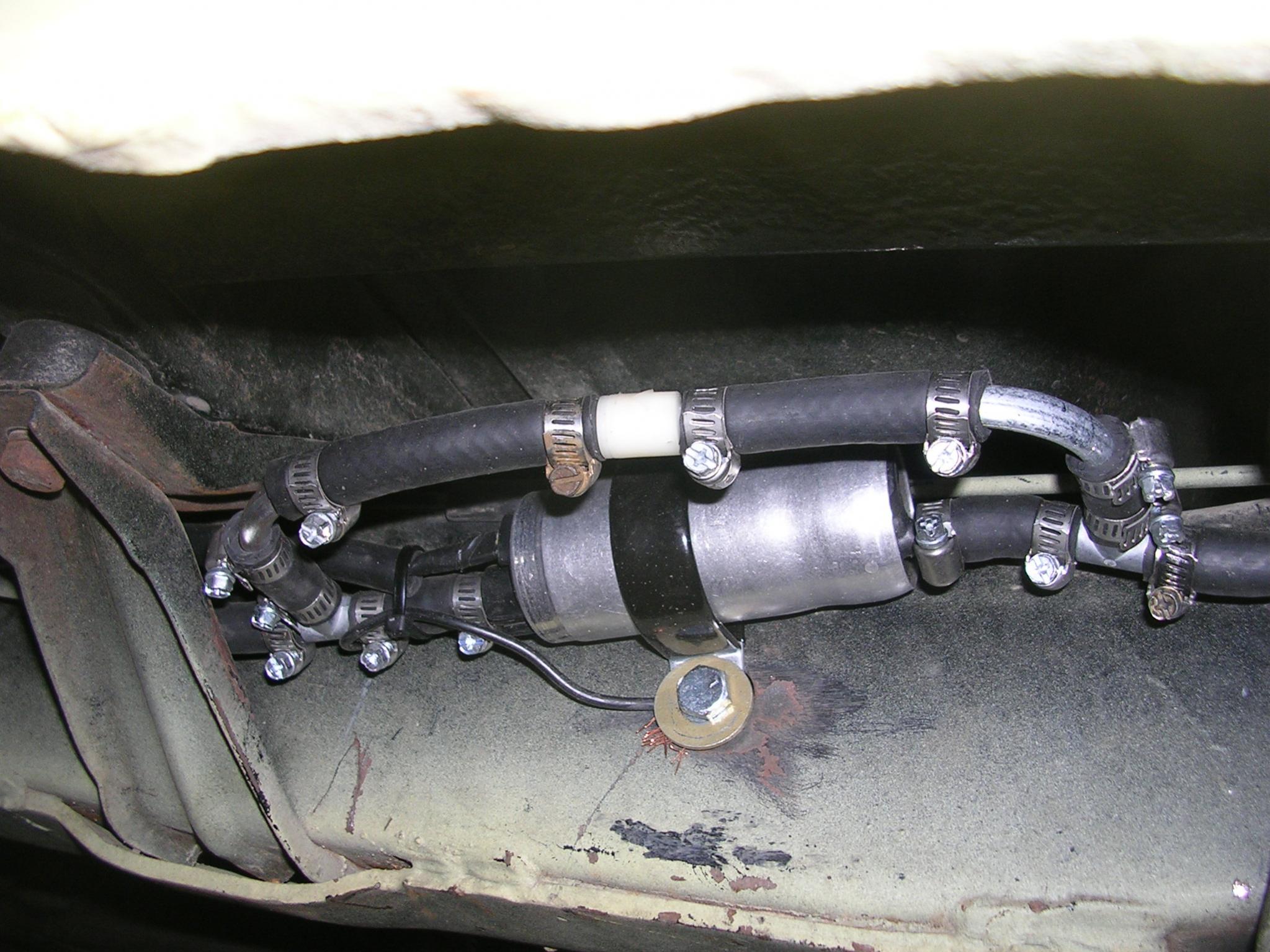

  16. Merc cruzer
    Joined: Feb 26, 2009
    Posts: 286
    Merc cruzer
    from Colorado
    Not pretty but it has worked for over 2 1/2 years...bypass with check valve

  19. oldsjoe
    Joined: May 2, 2011
    Posts: 2,642
    oldsjoe
    I have had issues with my dual Carter carbed 455 the last two years. After sitting a couple days you have to crank and pump till your leg is numb before it starts. Just installed a Carter electric with mechanical still in place starts way easier. But mechanical can't pull through the electric. So I'll either have to do like Merc cruzer or carry an extra electric pump or a section of fuel hose. I blame the fuel we are being forced to use as the culprit ran it with race fuel it starts fine every time no matter how long it sits! But that's a little expensive at least $8.00 a gallon!
