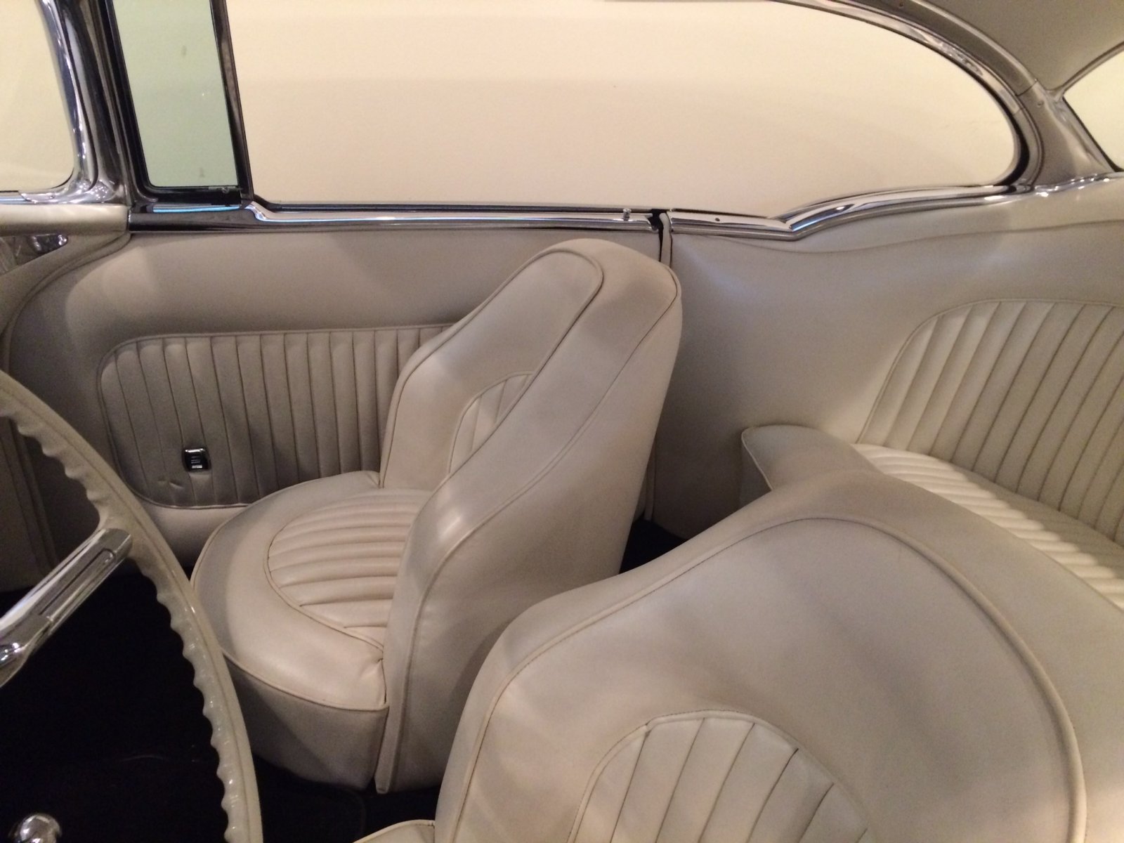

    The swivel buckets in the Astorian 55 Chevy are made from Chromecraft sculpta kitchen chairs. There is no locking mechanism and they really don’t seem to need it. The swivel point is forward of the centerline of the seat so it naturally wants to stay straight. The p***enger seat will turn around and face the rear seat. Some of my wise guy buddies sit facing the rear just to be funny
