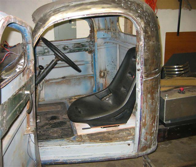

    anyone have pictures or some ideas on how I can build seat swivels? I am putting some cheap lo-back racing buckets in my truck and it would be great if they swivelled 60 degrees or so. I know some Buicks and Lo-rider type cars had them but I've never seen them up close to see how they worked.

    dang thanks for the fast replys! I think I found some I can use. Once AssDragger said "Lowes" I was all over google and found that tons of boat places sell them cheap! hey link are you serious about the trash can? that is too funny.
    check these out...

  12. 41ChevyTrucker
    Joined: Nov 4, 2003
    Posts: 453
    41ChevyTrucker
    points well taken 40Stude, I have no space to spare in my cab as it is.
    Donzie, I ordered them from that link I posted. The ones in that pic have the swivels with the lock down bar. I should have them this weekend and will let you know if they are any good.

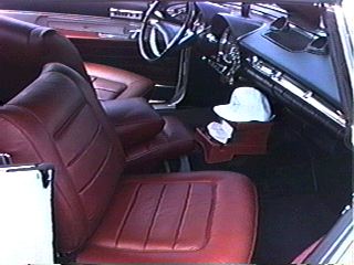

    Here's a photo of the '75 Olds buckets in my rad '57 Chev...note the stock headrests were removed...note how slim the seat now appears...note how much room there is between the seats--enuff for a console and to let them swing without touching...note the mounting on the floor.

  18. 41ChevyTrucker
    Joined: Nov 4, 2003
    Posts: 453
    41ChevyTrucker
    Yeah I got them and mocked them up using some plywood. They are pretty solid and work great. I am going to make some real mounts and use them.
    Here are some more pics on my website

    I am curious to see if they will swivel when they are both in there or if the seat backs will hit each other when you spin them. There ain't much room in there. I hope it works for you.
