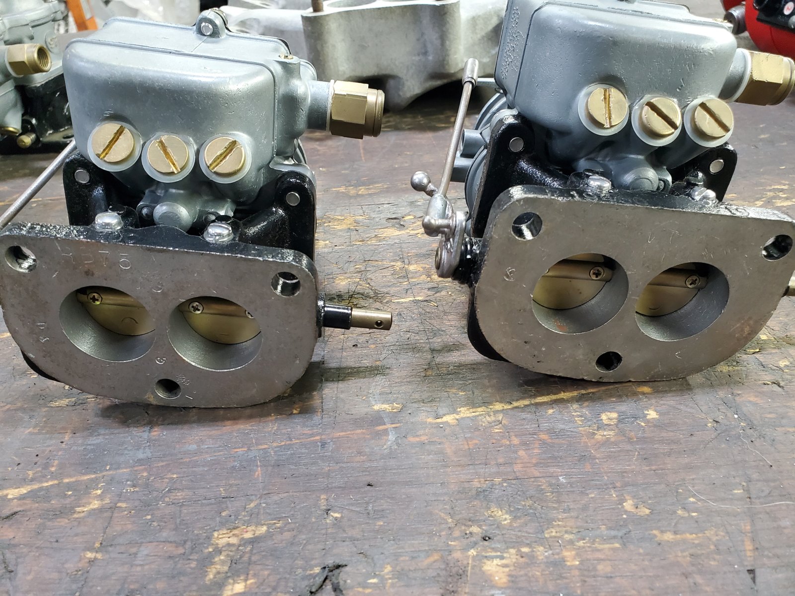

    is it necessary to sync all the carbs on a log style 6x2 intake?

    and if we have true secondary carbs with blocked off idle circuits?
