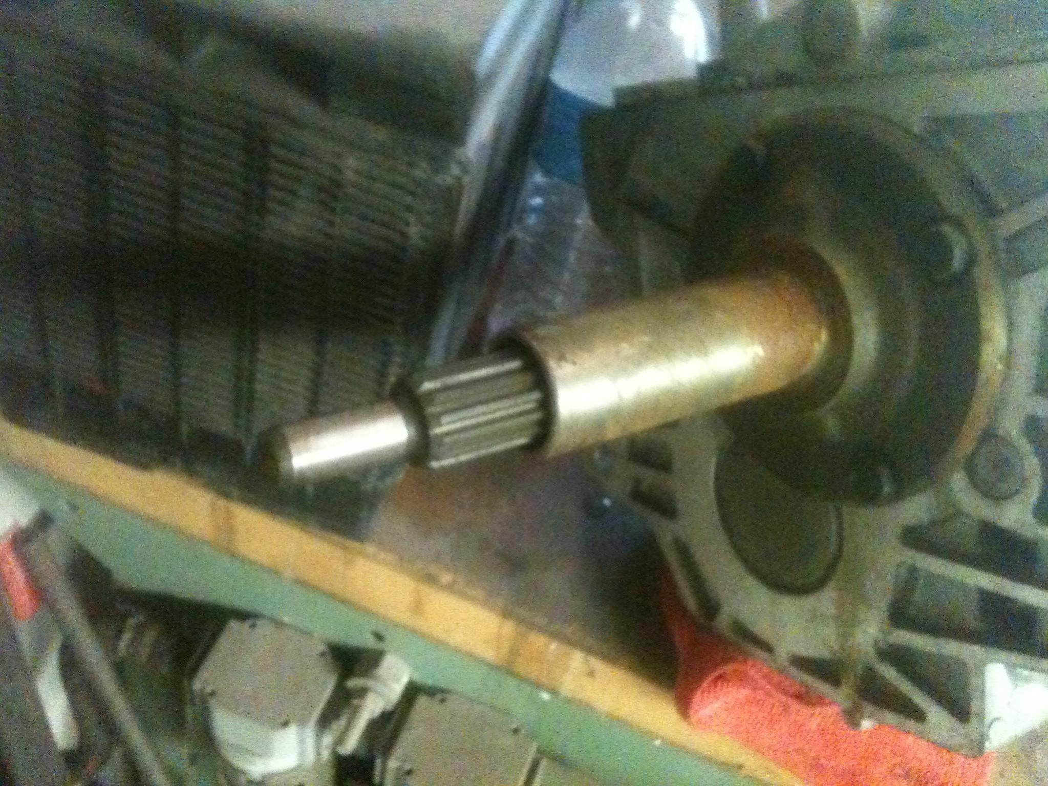

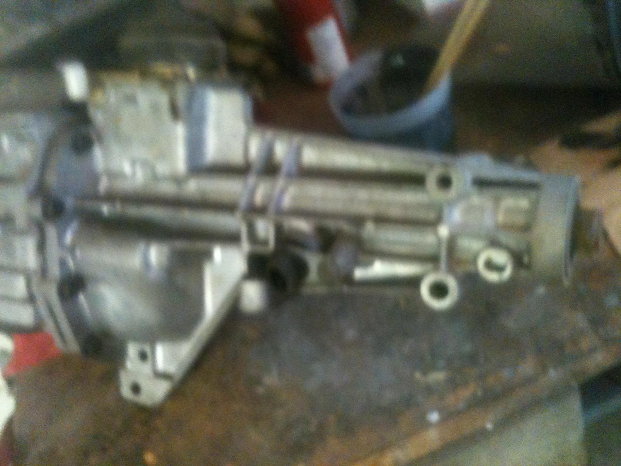

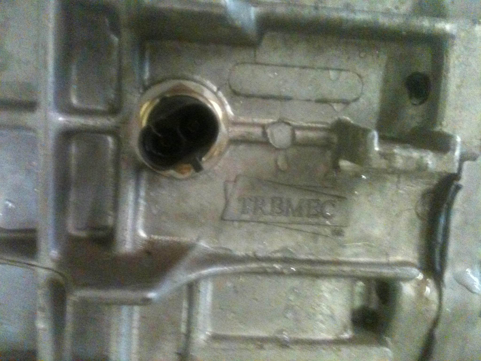

    Hey guys,want to see if you can help me figure out what trans i have?I'm sure it's a s 10 but that all I know.trans is brand new never been installed in a veh.it has elec speedo,says tremec on side and borg warner on top cover and tail shaft.it has 14 spline input.there was no tag on trans has cat # on it which read 13-52-066-033 13-52-191 and 61gbyu031015 starting to gather for my next project and want to run 5spd.
    Jratz
  25. Flat Ernie
    Joined: Jun 5, 2002
    Posts: 8,406
    Flat Ernie
    Tech Editor
    The -066 is just a casting number and meaningless. The 191, however, decodes to a '89 T-Truck (Tahoe) and has the 3.76 ge****t.
