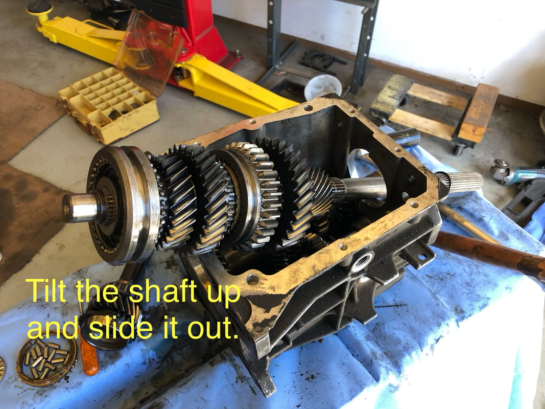

  5. A creative drop on a block of wood sometimes helps
    427 sleeper, Deuces, Woogeroo and 4 others like this.
  6. 50chevytx
    Joined: Feb 4, 2018
    Posts: 111
    50chevytx
    IMG_2725.jpeg You can remove the main shaft ***embly without removing that gear
    pic is from lugnutz’s page

  9. Paul from t5.com has a youtube video the might help.

    I changed the 5th ge****t for different ratio. I don't remember having to take the main shaft out of case or needing a puller/press. You have a non World Cl***?
    winduptoy likes this.
  15. flthd31
    Joined: Aug 5, 2007
    Posts: 602
    flthd31
    You can remove the main shaft ***embly without removing that gear. Much easier to remove and press back on.

    I *think* if the 5th gear is ~.80 then it does require removal as it is too large to allow removal where the smaller ~.70 gears allow you to angle it out of the case.

    The aftermarket 0.8/0.81 5th driven gear has to be pressed on and off in the case because the diameter is too large to p*** through the case.
    Any factory BW/Tremec gear can p*** through, meaning you can pull the mainshaft out. It can be a little tricky finding the exact path needed to get the mainshaft out though!

    Those videos have some great tips in them. Thanks for the help guys, you are much better than the simple manual I was using before. I’ll try swinging the mainshaft ***embly out this weekend when I get back to the project. I’ll definitely be adding some notes to the manual.

    It worked. The ***embly wiggled out the top just fine. Thanks for the help guys.
