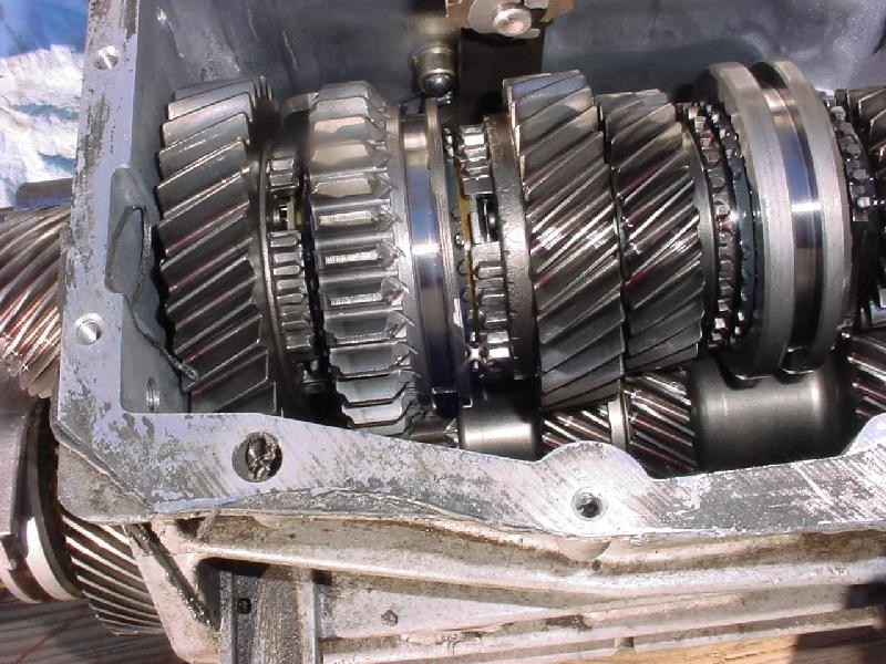

    Y'all here is my problem. My T5 jammmed in 4th gear and wouldn't come out with out a fight after a run at the drag strip, then it would go in and out of first gear fine if you didn't let the clutch out but would hang and have to be wrestled out of first if you let the clutch out and tried for second on a roll. 2,3,4,5 shifts worked fine. I have the trans apart but do not see any dammage to my untrained eye, Pictures attached. Anybody have an idea what could be wrong?

    I'd pull the input gear out of te front and check the needle bearings and the front bearing. Sound like you are getting some misalignment between the input and main shafts. Look up an exploded diagram of the trans if you are unsure of how to do this.

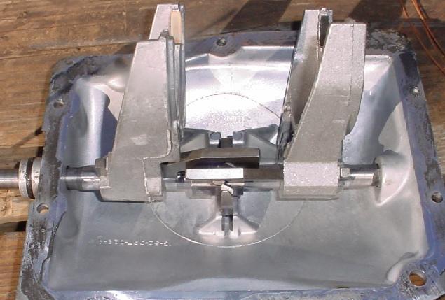

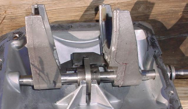

    Take a good look at the shift forks. They are aluminum and if you have a stock shifter, every time you bang a shift, its the forks that take the impact. Sometimes it is very hard to see the cracks, but almost every one of these I've rebuilt had cracked shift forks.

    Thanks for the help so far! I have the Hurst shifter with shift stops adjusted per Hurst instructions. I didn't notice any cracks but I'll take a closer look.

    remove the plastic clips from the shift fork when you check for cracks. what do those plastic fork pads look like? some times if they are really worn it can cause problems like that

    I chacked for cracks with magnavisor and didn't see any forks seem ok. The front input shaft had 1/8" play at front so I removed the input shaft retainer front roller bearing race seems smooth it came out of retainer by hand but wasn't sloppy. How much front to back play should the input shaft have?

    Clutch is ok. I removed the clips and didn't see any cracks but the pads are worn, see attachment.

    I don't see any dammage or slack on the parts in the top cover. I think I will replace the nylon bushings on the shift forks and try to adjust the play on the input shaft and see what it acts like.
