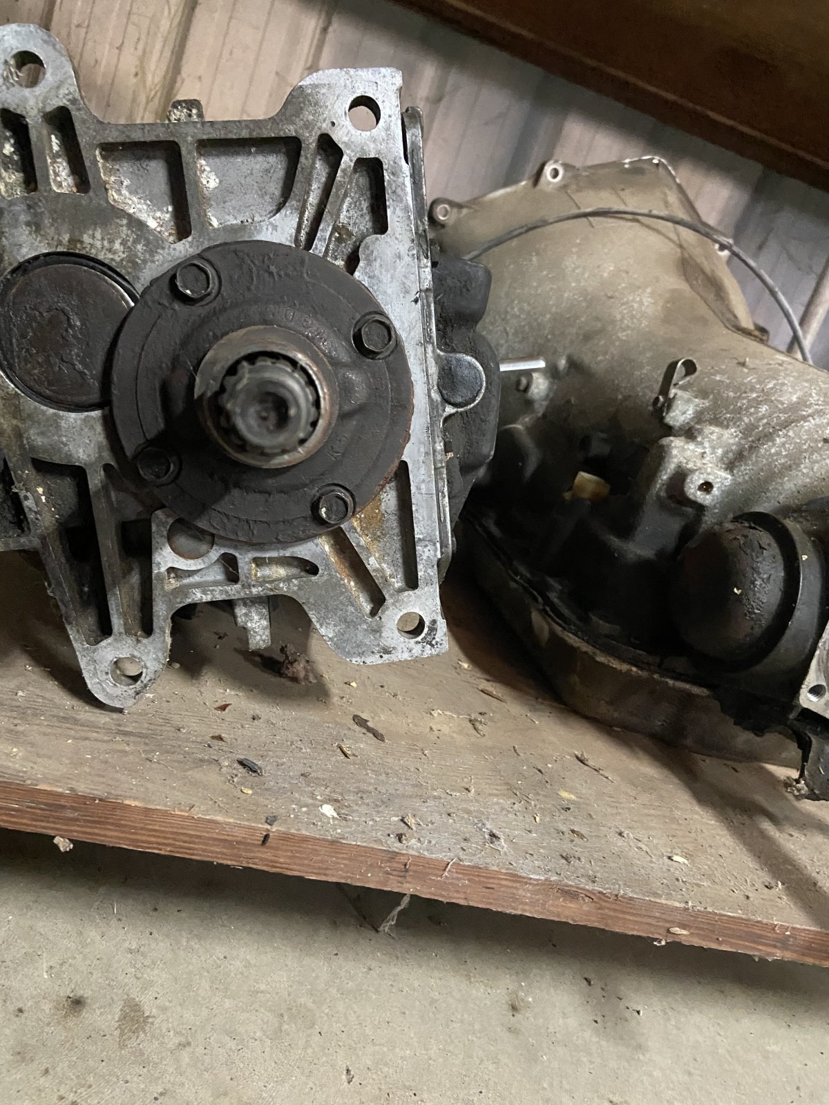

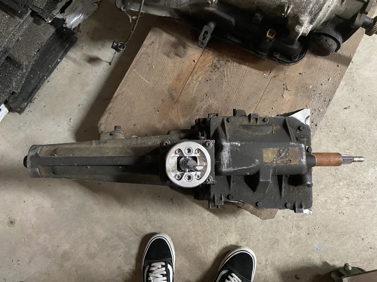

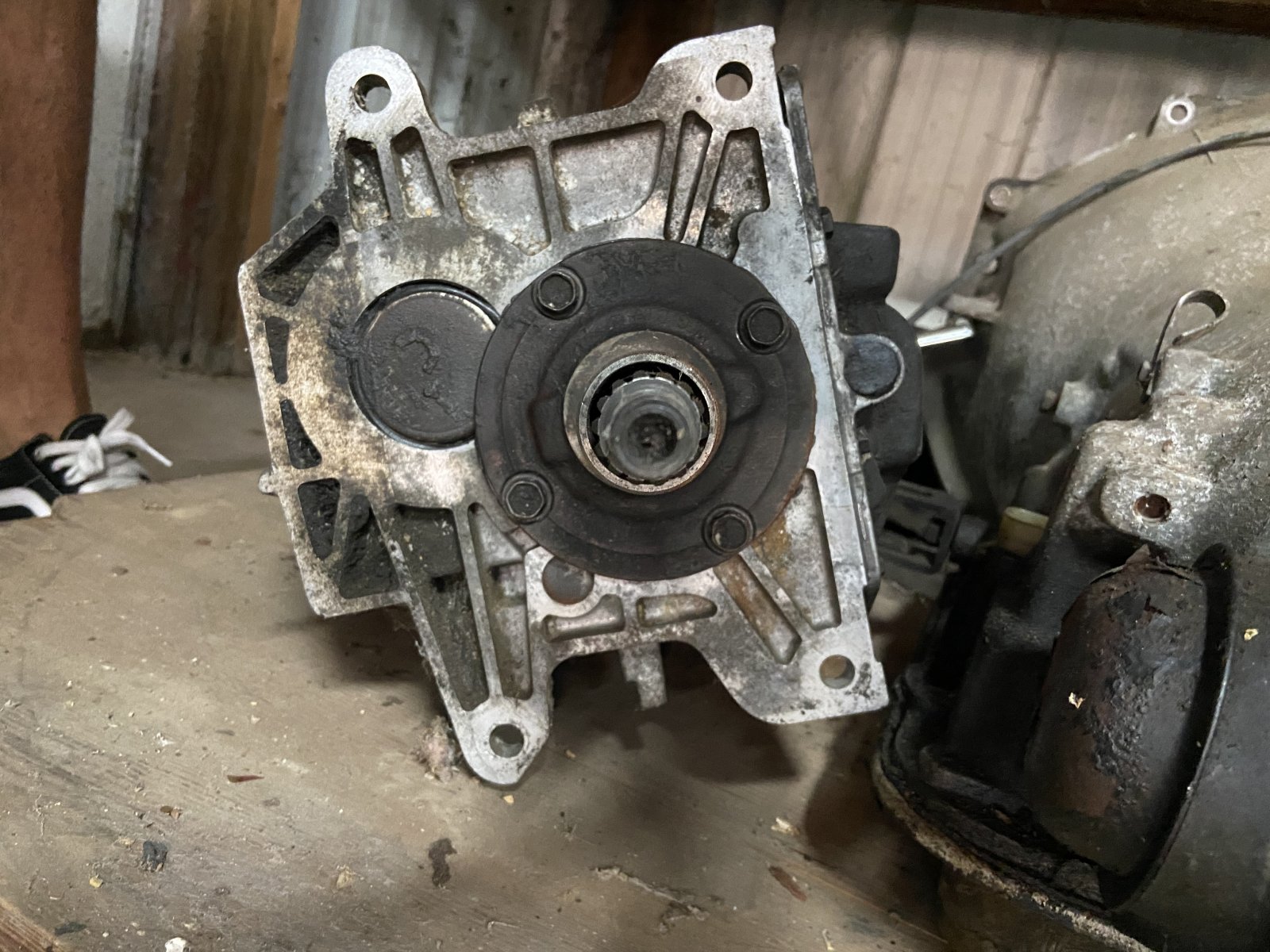

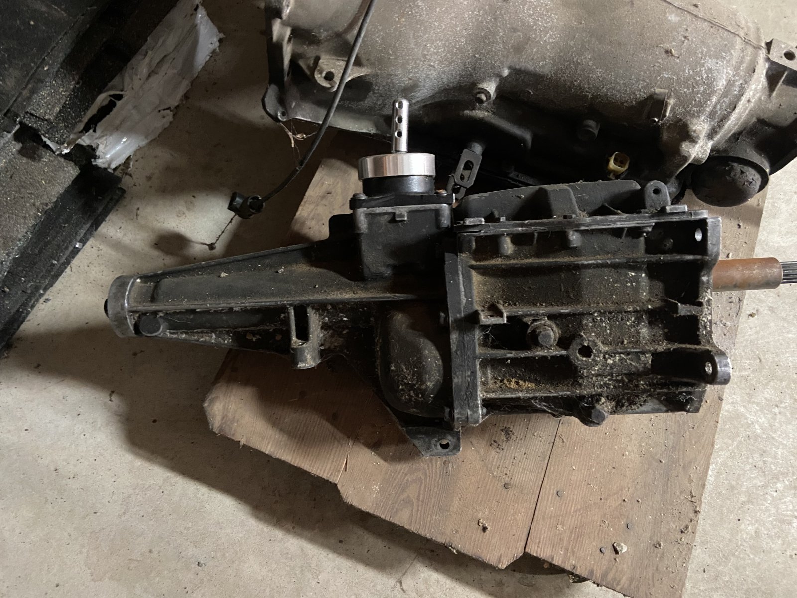

    Trying to piece together a 59a to t-5 ******. Speedway offers a few kits, but I wonder if anyone has fabbed a throw out fork and just bought the bearing.
    Also curious to know if I’m right thinking this T-5 is a gmc non world cl***. Any help is appreciated and respected

  4. gimpyshotrods
    Joined: May 20, 2009
    Posts: 24,631
    gimpyshotrods
    We cannot tell if it is World Cl***, or Non-World Cl*** without a picture.
    Most, but not all of these kits use a T5 from an S10/S15 truck. Those were mostly Non-World Cl***, but transitioned to World Cl*** at the end of the product line.
    As for a throwout fork, not only does it need to be fairly precise, it also has to withstand a fair amount of force.
    If I had to rely on my engineering, or the engineering of a company that makes the product repeatedly, I would buy one.

  6. gimpyshotrods
    Posts: 24,631
    gimpyshotrods

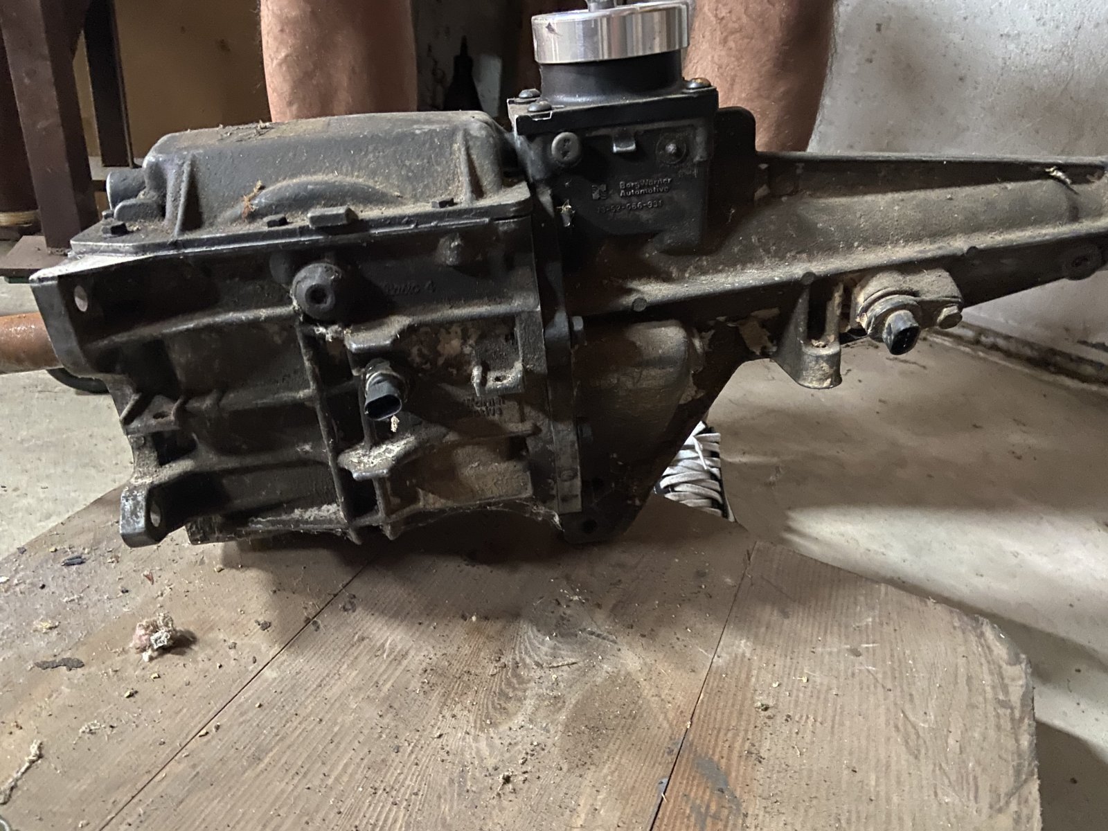

    There was a tag on one of the bolts that holds the tail housing when it was made.
    In it there are a bunch of stamped numbers. One is 1352-**X, with the **X being the three-digit build code. That will indicate what gears are in it.
    That number is (was) also on the white sticker on the top cover, in one of the corners. Clean it very gently. You might be able to still read it.

    The sticker is faded and ripped beyond use. I didn’t see the tag either. I’ll double check just to be certain. If I can determine this to be a certain make chevy or gmc. Can I piece a kit together or has anyone made a throw out fork?
  8. gimpyshotrods
    Posts: 24,631
    gimpyshotrods
    Chevy and GMC are exactly the same. There is no distinction.
    Your transmission has the GM bell housing pattern. That, and the length of the input shaft, are all that really matter.
    You do not need to make a fork. The Speedway adapter is designed to use a GM one. Those are easy to find.
    It would take a fair amount of engineering and fabrication to save $25.

    What @gimpyshotrods said. The most important thing is the internal gear ratios; you don't want a 4 cyl. application.
  10. gimpyshotrods
    Posts: 24,631
    gimpyshotrods
    Put the shifter in first gear. All the way to the left and forward.
    Put a piece of tape on the top of the input shaft. Make a mark with a pen at the 12 o'clock position.
    Put a piece of tape on the back side of the output shaft. Make a mark with a pen at the 12 o'clock position.
    Turn the input shaft as many times as it takes to turn the output shaft once.
    If it is about 3-3/4 turns, then the transmission came from behind a 60-degree V6.
    If it is right at, if just a little past 4-turns, then the transmission came from behind a 4-cylinder.

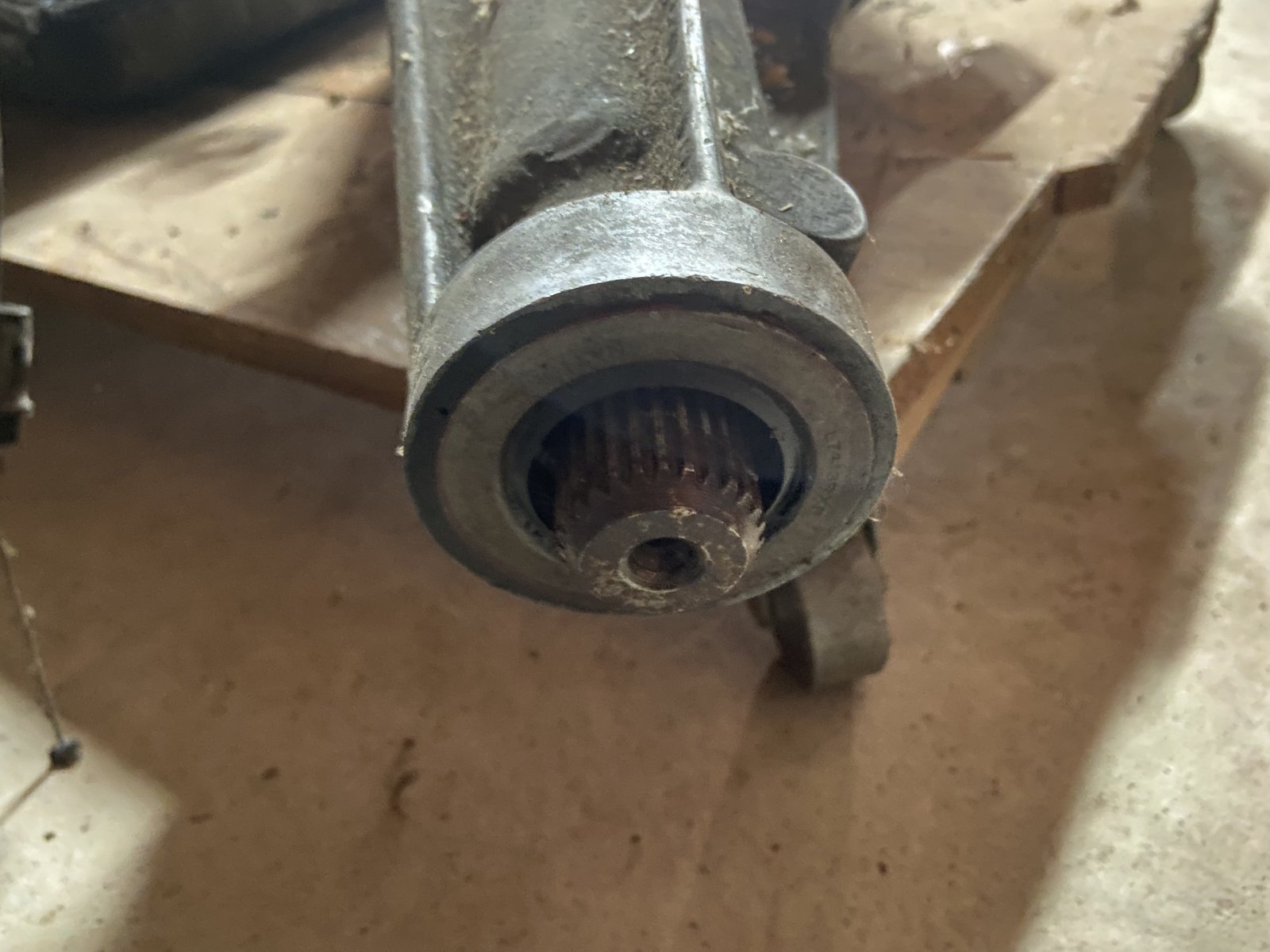

  11. Mr48chev
    Joined: Dec 28, 2007
    Posts: 36,515
    Mr48chev
    It looks like someone has been playing with that one a bit changing the shifter and maybe putting a Jeep input shaft in it. The teeth look more like Regular Chevy than S-10.
    This is one of the best T 5 ID charts I have found if you can carefully clean the tag enough to read it or most of it. Identification Key to Borg-Warner T5 transmission ID Tags (britishv8.org)

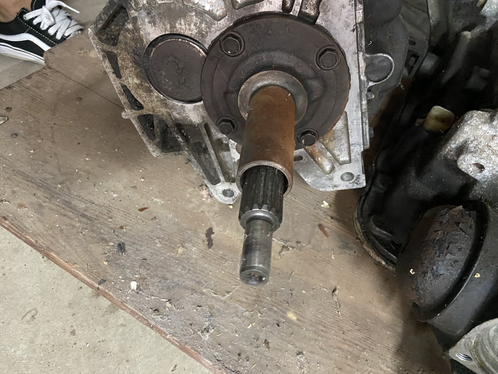

  12. gimpyshotrods
    Posts: 24,631
    gimpyshotrods
    That's a GM S10 NWC T4/T5 input shaft
    21 tooth/14 spline
    It fits in the 1984-1992 T4/T5 S10 S15 Sonoma transmission.
    Part# 1352-085-003
    The input bearing collar is S-truck specific, and is the only one with that length.
    Part# 1352-027-003

  18. gimpyshotrods
    Posts: 24,631
    gimpyshotrods
    Standard top engine oil leak.

  19. 750four
    Joined: May 31, 2010
    Posts: 41
    750four
    from 47712
    Ya, it’s covered in dirt and grime. No shifter top on it when I bought it, so I threw that cheap short shifter on it. If this has the correct ratio I’ll be excited. I have about $100 in the thing now. Internals appear clean and not worn.

  21. gimpyshotrods
    Posts: 24,631
    gimpyshotrods
    Even if it is not the "right ratio" it will still work.
    Since you mentioned a quick change, you can adjust there for best performance, based on how and where you drive the car.

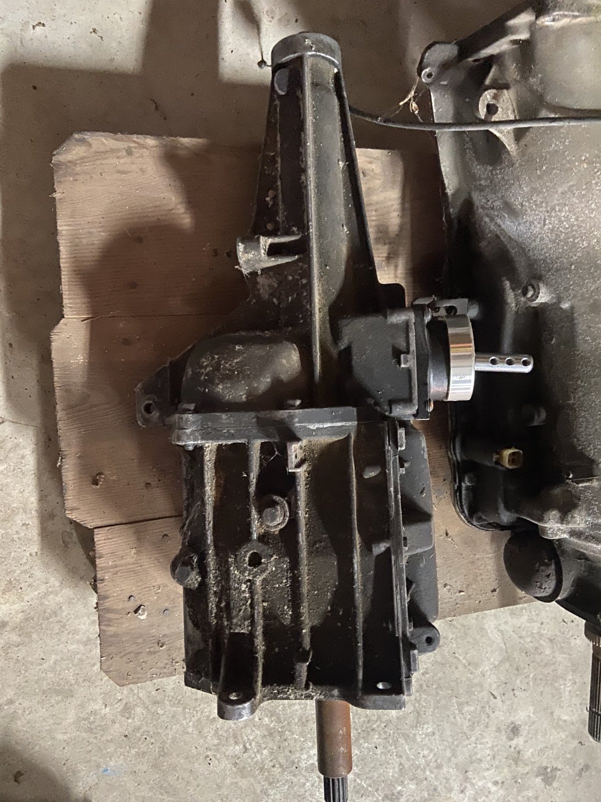

    Bought my kit years ago from Gary at Cornhuskers. I'm using the stock Ford throw-out system with a adaptor bushing that came with the kit. The hard part was sourcing the proper diaphragm pressure plate for the stock, large TO bearing. I believe Gary may have a source now. Your ****** appears to have the electronic speedometer sending unit. If you want to use a std mechanical speedometer you will need to make some modifications or purchase a special converter.
