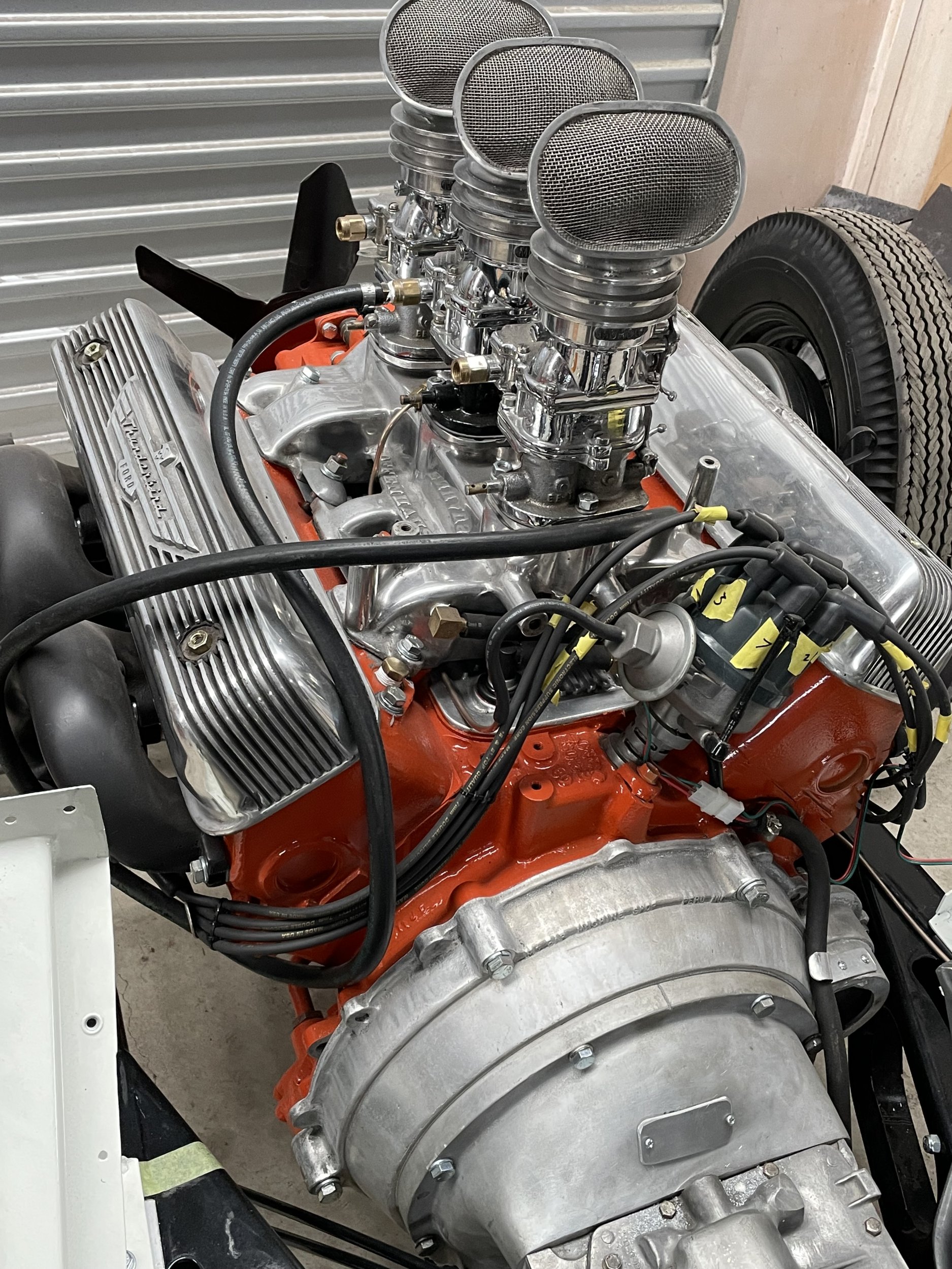

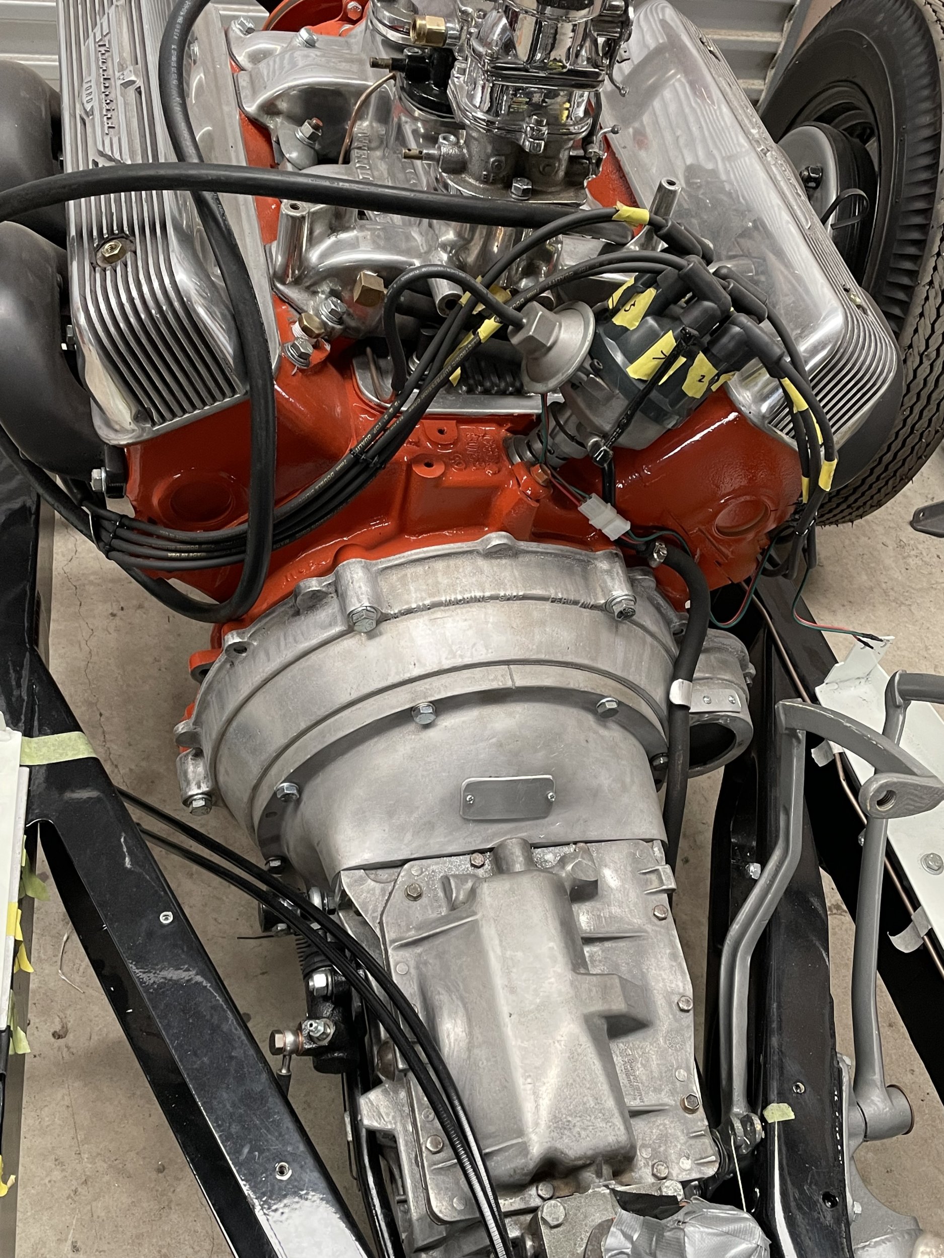

  12. Kiwi 4d
    Joined: Sep 16, 2006
    Posts: 3,885
    Kiwi 4d
    IMG_6471.jpeg IMG_6470.jpeg I know this is a model A . The nay sayers said we couldn’t use two adapters. A McBar Y block to flathead adapter and a locally made Flathead to T5 adapter. All seems to work well. Though we had a few issues with mechanical clutch ratio initially, and then went to hydraulic where we had more options to fine tune it. We were just using parts we already had on hand, for a one day whatever project and not spending money.
    I would think in a F100 you could ignore the original mount rear ears and the T5 will need a dedicated trans mount crossmember any way . The original F100 trans was very short .
