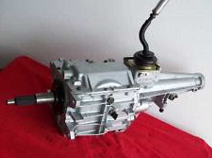

If you want to move the shifter forward on your Mustang T5, The S10 tailshaft housing will fit. You'll also need the tranny cover with the shorter shift rails. The speedometer gear prolly won't line up so you'll need to move the gear and epoxy it on the tailshaft with some shim stock like the Chevy guys... This is my Camaro V8 box with a close ratio gearset and an S10 tailshaft housing...

I'm collecting the parts to put a T5 in my 40 Ford coupe. I measured the locations of the shifters for the Mustang (94) and the S10 and it moves the shifter forward by about 8". I got my parts (tailshaft housing, shifter, etc.) from Paul at 5speeds.com. He was very helpful and his prices seemed reasonable. (no affilliation with the man or his business, just a satisfied customer)
