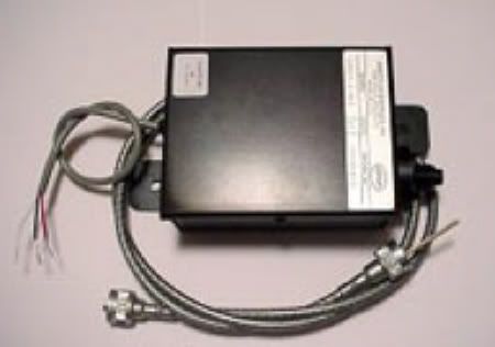

    This is on ebay. I would by one but it is bit spendy. Any lower cost devices out there?
    Cable X Manual / Electronic
    Speedometer Adapter
    ble X is the easy, cost-efficient way to operate your stock mechanical speedometer with a transmission equipped with vehicle speed sensor. The Cable X is basically an universal adapter that will pick up the electronic speedometer signal and will operate the cable driven speedometer to the corresponding speed. It's a snap to install with only three wires - hot, ground a signal. No costly installation of drive gears or long messy cs t de with.
