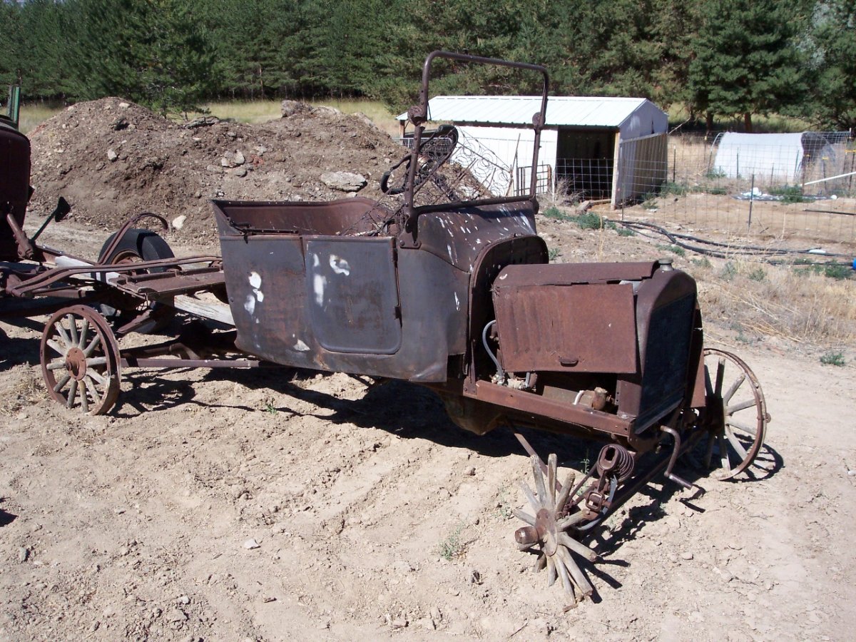

    The idea started to come reality late 2017 when I found a front half of T Touring and model A frame for sale at HAMB. It was located at Colorado and I happened to have a good friend of mine lived about 6 hours drive from there. With help of seller Banjoguy and Pufff bringing it to his house , he was kind enough to separate the body panels form each other and remove crossmembers from frame and cut the frame rails in half. That way everything was fitted about 4’x4’x2’ box, which was kind of cheap to ship to Finland.

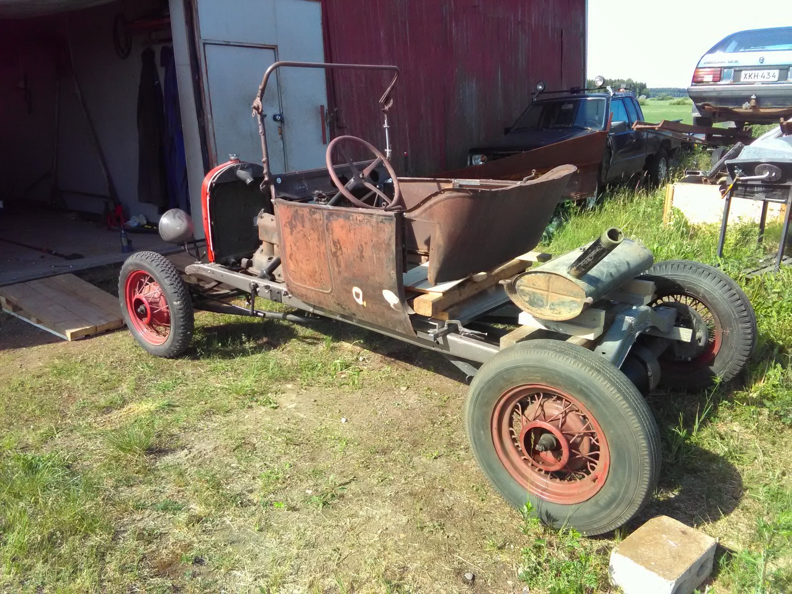

    Next step was put everything together as mock up. It was plain to see that rear wall of the body need to be about 6” further than original position of T Touring. Other way you could not fit behind model A steering gear. Also I founded out that the frame is too long. At least in my opinion, it looked like 18 wheeler without trailer.
    After the first mock up it was time to remove body panels from the reinforcement structure and give them a bath in citron acid to get rid of the surface rust.

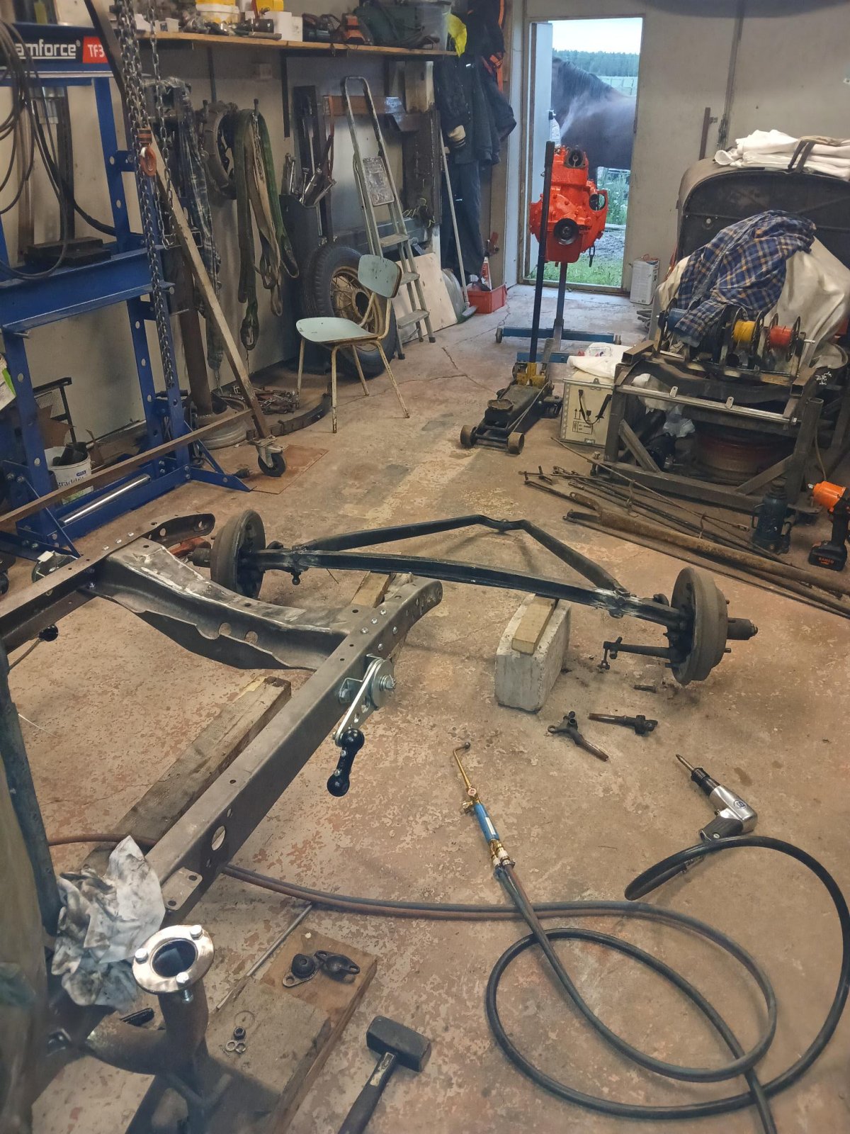

    So I decided to shorten the frame behind parking brake crossmember about 8”. The frame was easy, just cut, make some measurements to get it straight and weld it back together. Added a reinforcement plates also, so there should not be a risk of the welds crack during use. The drive shaft was little more tricky, cause I do not have a lathe. But my friend does have and he made cut so that there was a centering pin and hole to get shaft straight. The torque tube is not so accurate, so couple of angle irons and C-clamps did the centering.
    While dis***embling the rear end for shortening the drive shaft I found out that pinion gear is really worn out. Found another rear end missing some parts but having decent gears, so was able to ***emble one good enough rear end out of those two.

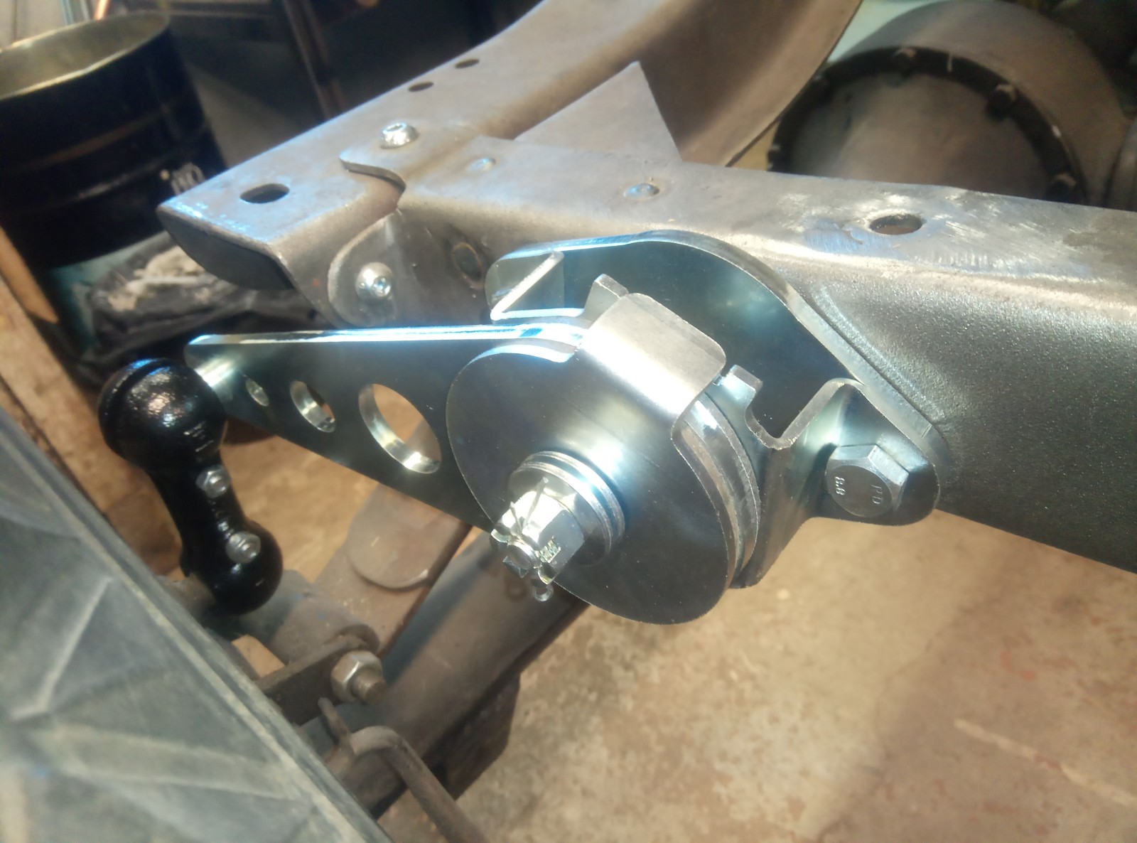

    For the springs I found a rear main leaf which has reversed eyes and I did reverse front spring by myself. Just using a hydraulic press and slowly first straihtened the main leaf and then shaped it to the original radius but opposite way. Also removed 3 leafs on both springs. The ch***is is still real high, but that it is the way they used to be, at least some of them.
    I had welded on axles mounts for tube shocks when run them on the Tudor. They just looked too modern for this one, original knee action shocks are too expensive, so I decided to go for friction shocks. I came up with idea to make a set of my own and couple more sets in case if someone else would want a set too. I ended up to make some 30 sets of those. (If you want to get a set, you can buy a set from https://www.mikes-afordable.com/product/A18015F.html or let me know. I’m out of stock now, but if there will be still need for those, I may make a new batch of them.)

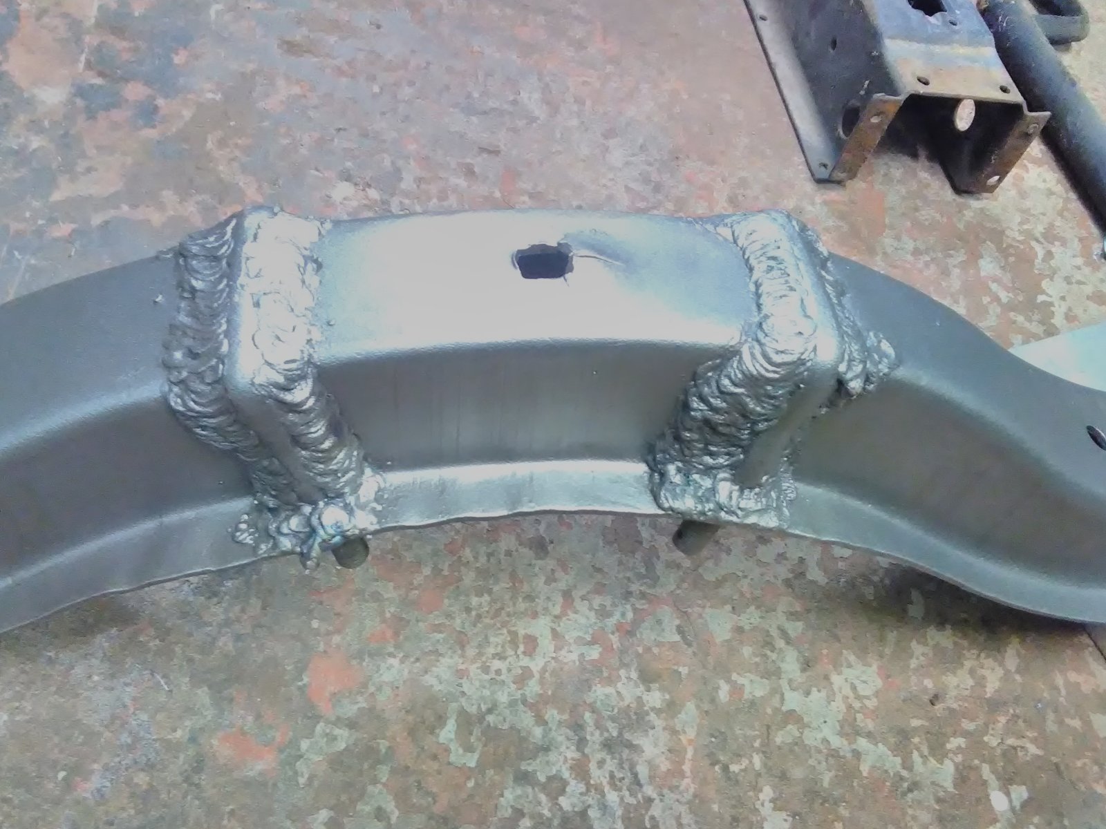

    When frame in correct dimensions it was time to fix the so common cracks on front and rear crossmembers. What is not that common is the way someone had fixed the rear crossmember by welding the U-bolts on crossmember. And welded them in big time! It took pretty many grinding disc before get the crossmember ready for some new welds.

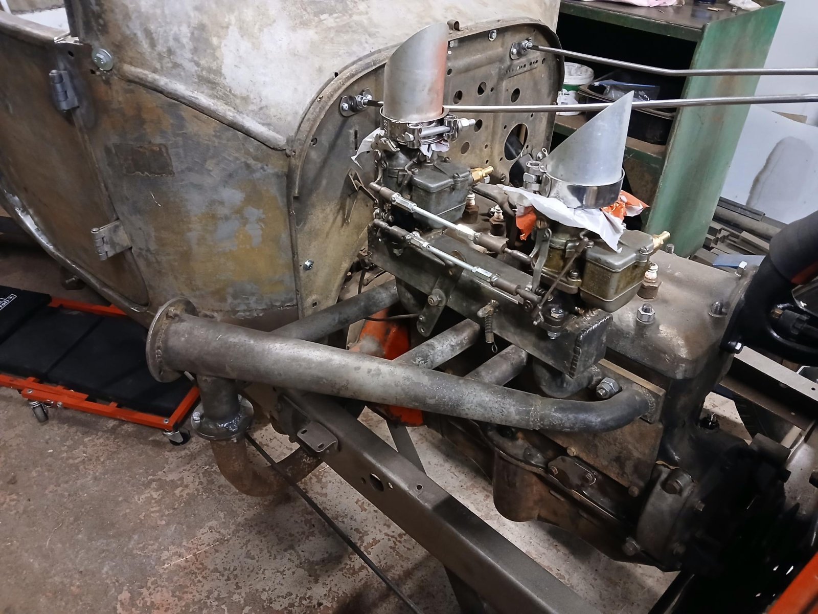

    I have the intake and header by me, which I run on Tudor with single 94, other carb was blocked . Found two Stromberg 81 carbs, cleaned them up and had kits for them. I’ll try to run them both synchronized on B engine. Maybe little too much carb for stock banger, but it is more for looks than best performance.

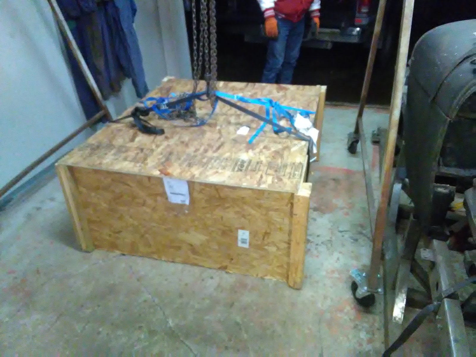

    What a man would not do to save couple of bucks from shipping ;) And i was pretty sure that i will shorten the wheelbase, so i would have to cut it anyway...

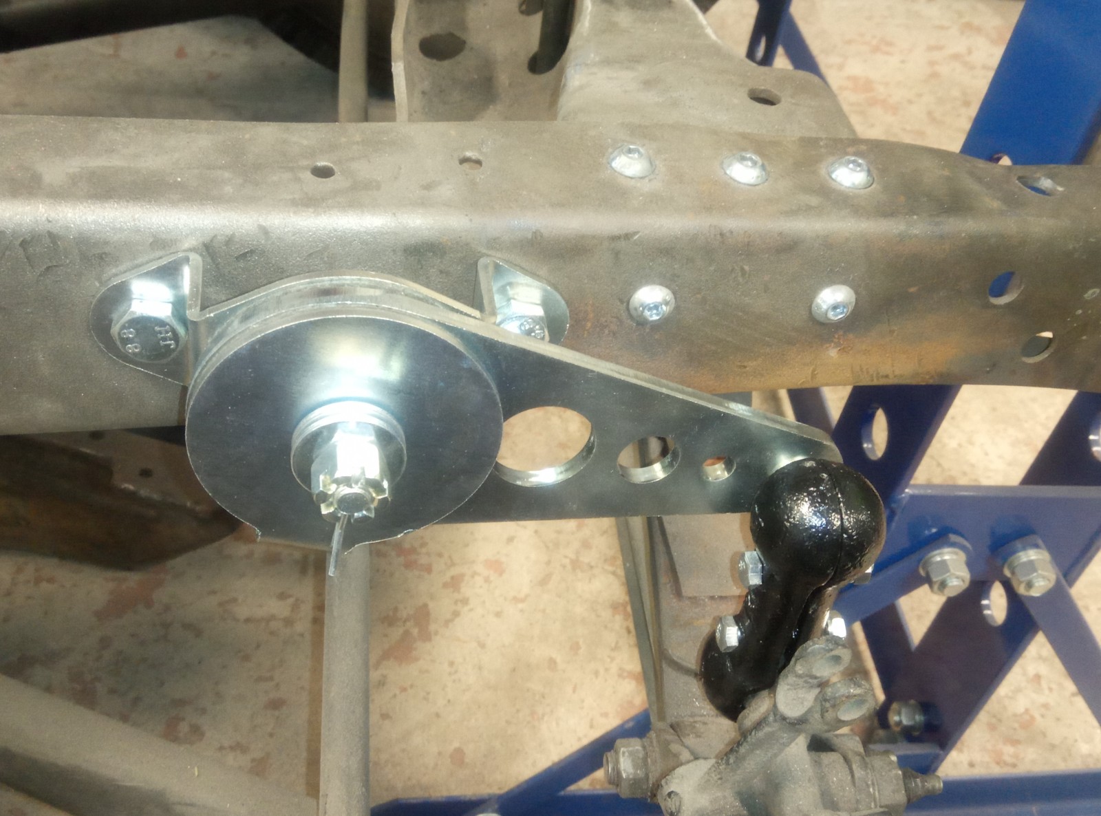

    Not much to update. Fitted the pedals, kind of tight fit. I had to shim the steering column about 3/8" towards engine, to get it inside T-model firewall, which is pretty narrow. So have to bend brake pedal to avoid hitting steering column and clutch pedal to fit inside firewall and not hitting steering column or brake pedal. Took more than 5 rounds, heat-bend-***emble-dis***emble to get everything to fit. 20240424_180031.jpg
    Speaking about steering column, i could have bought $50 column drop from Speedway, but i did buy $1 muffler clamp from local hardware store. Something i´m not sure should i be proud or ashamed of.... ;)

    I keep looking at that clutch pedal...it has many many miles with a foot riding on it to get worn down like it is.
    The column drop is perfect....

    Yes, the correct way to do this would have T-fitting in rear carb and banjo in front one. Now i have straight fittings and separate T between hoses. Just have to make sure there is no gas leaks and the hose clamps do not touch those model A spark plug stripes (uninsulated). I feel the danger... ;)

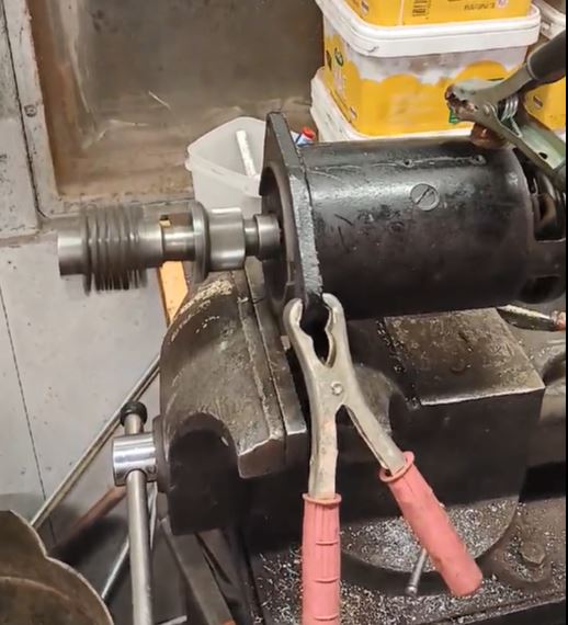

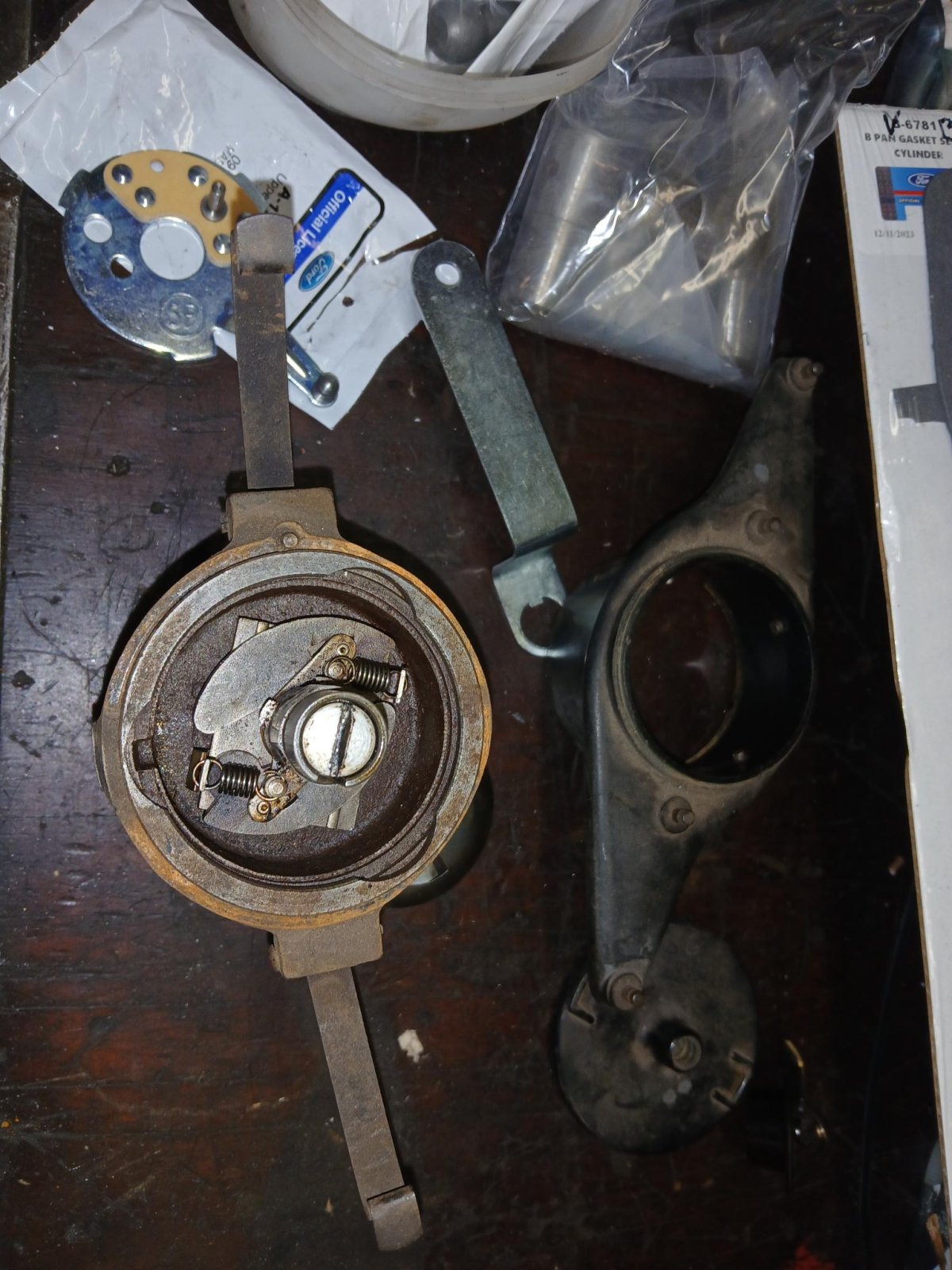

    Something little has been done. Try to put a tune up kit to distributor. But it turn out to be a model B distributor. What a nice surprise! I was wondering how it worked so good on my Tudor even it did not have manual advance rod connected. Now i know. Bad thing is that points included in model A tune up kit won't fit, but the old one seems to be OK, so i don't care.
    Got a "rebuilt" starter long time ago. Didn't work, only some smoke came out. Turn out that someone forget ***emble ground side brushes! Added them and starter seems to work now.
