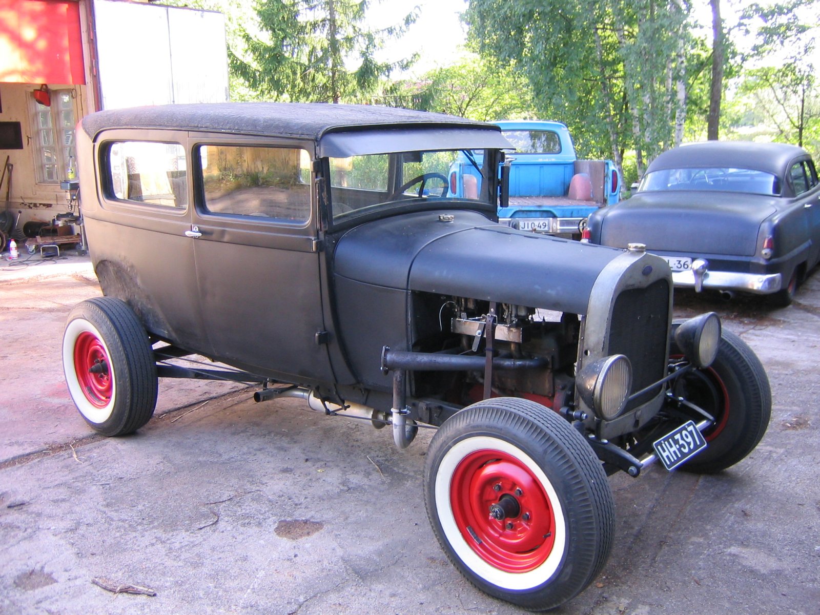

    I just realized that i haven't shared any pics of, not finished, but kind of race ready T-A-B. So here are couple taken after the really wet race. Not too much rust built up anyway.
    I did not have time to fix really rusty Ford Prefect gas tank, so i borrowed a motor cycle tank from my friend. And see all safety features: fire extinguisher, seat belts and safety pin for door lock, cause the lock would not keep door shut even a moment. ;)

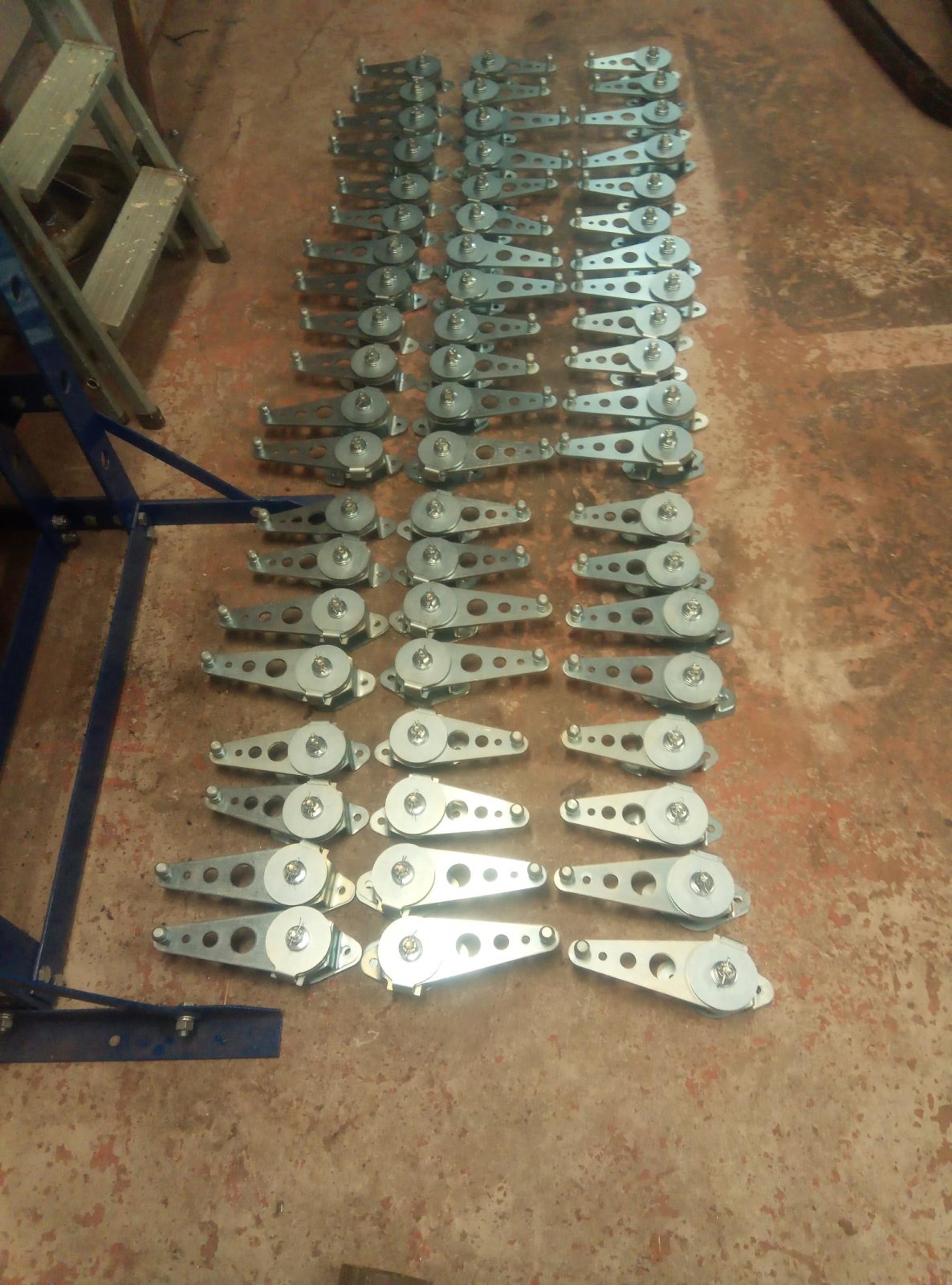

    dropped model A axle for a fellow hot rodder and
    getting 5 sets of friction shock parts ready for zinc coating. Keeping busy and doing crazy things is best way to avoid going insane.... :)
