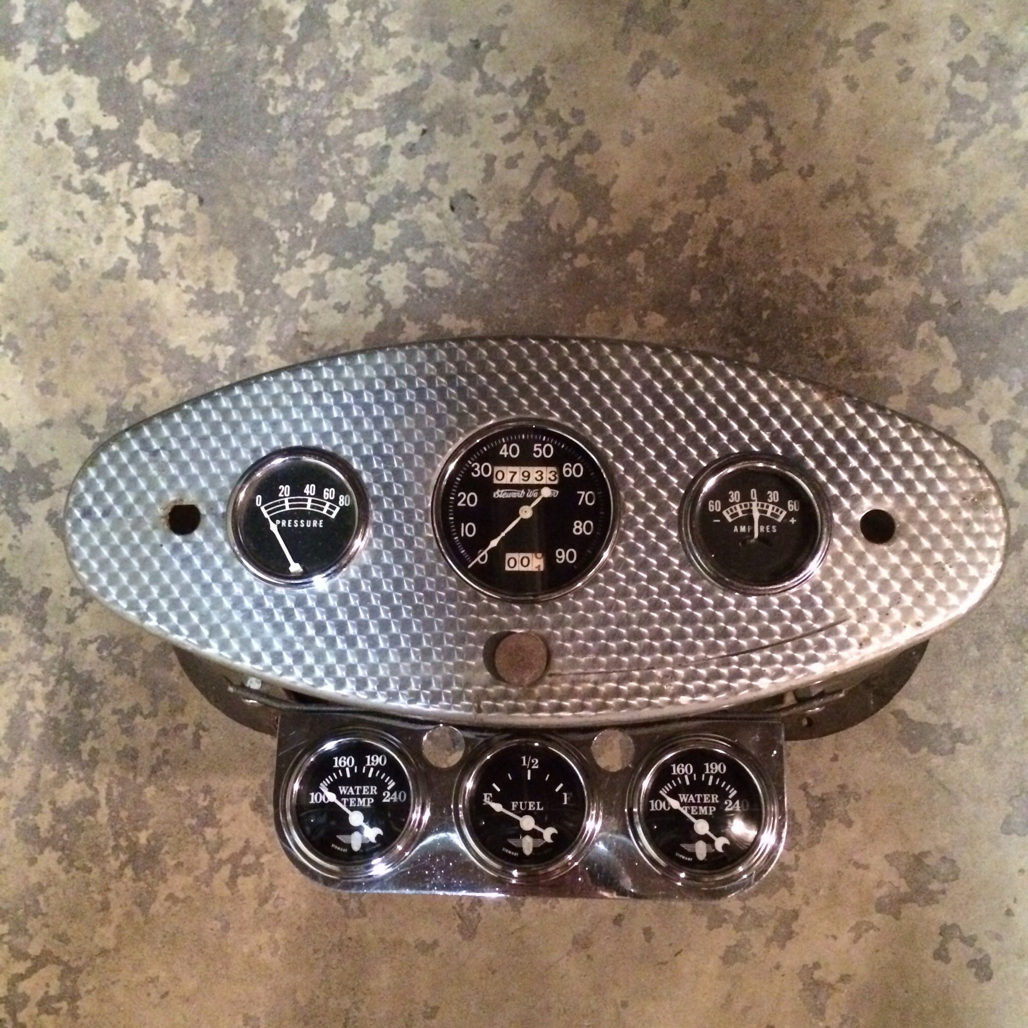

    Couple of dash mock up pics. It was cold out in the shop today.
    I haven't found any good early fuel and temp gauges that I like so I'm using SW wings for the time being. I'm using a temp gauge for each head.
    I really like my wood grained dash.

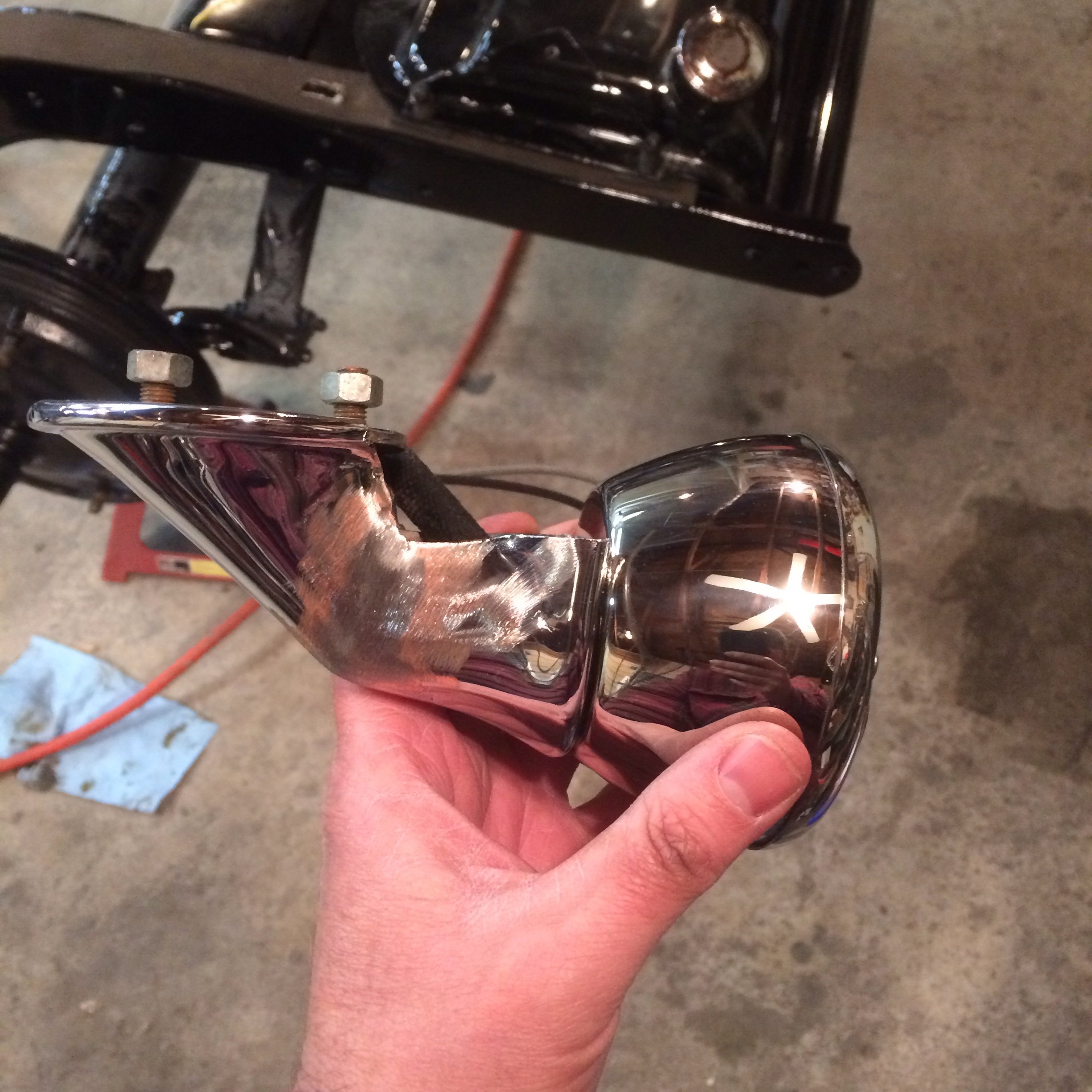

    Made some taillight brackets today. I don't really care for original '32 taillight brackets on fenderless coupes. So I modified a set from a 35 ford. I will paint the brackets black.
    You get the idea.

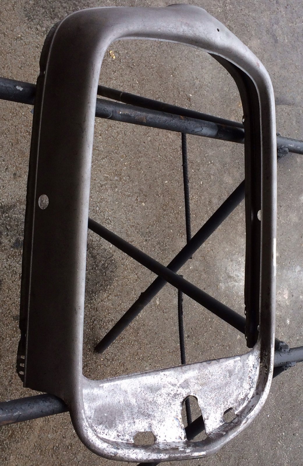

    And started working on my rusty grill shell.
    The lower panel is full of holes and pits. I managed to weld up the holes on one side but will need to patch the other.

    Dash looks great Tim. Where did you get the insert for it?
  11. T&A Flathead
    Joined: Apr 28, 2007
    Posts: 1,986
    T&A Flathead
    I got this one from Pikes Peak Motor Co. I got a good deal on it because one of the gage holes was enlarged for a 2-1/8" gage. I enlarged the other hole and I'm good to go.

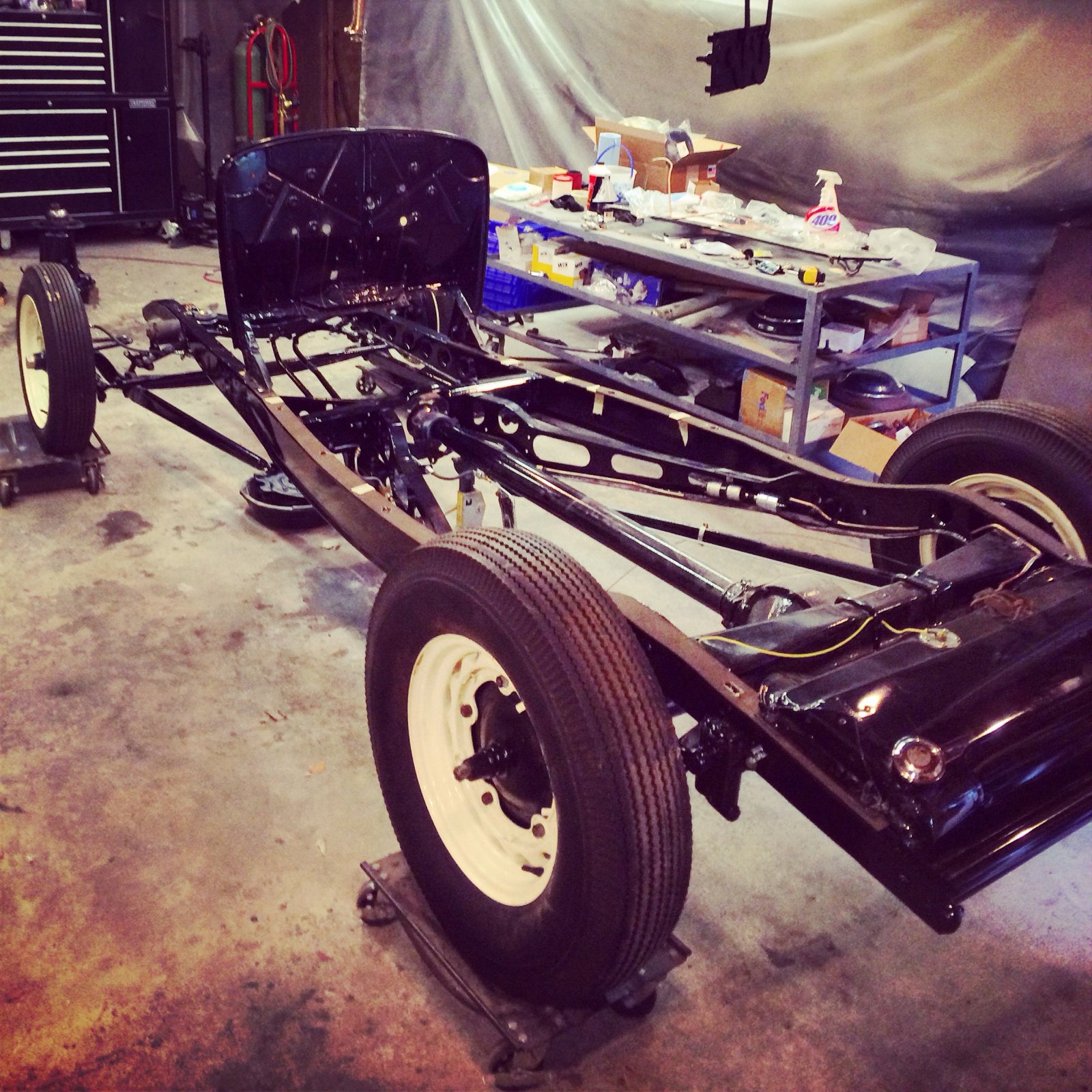

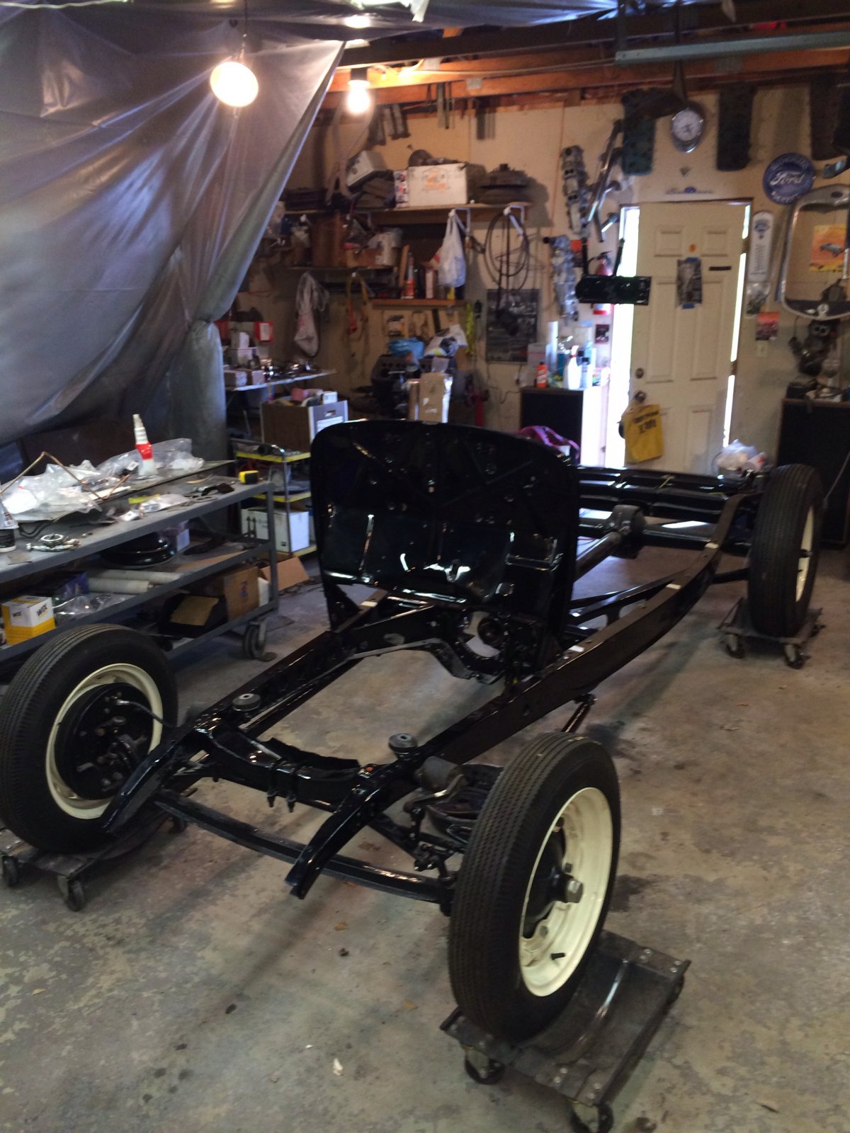

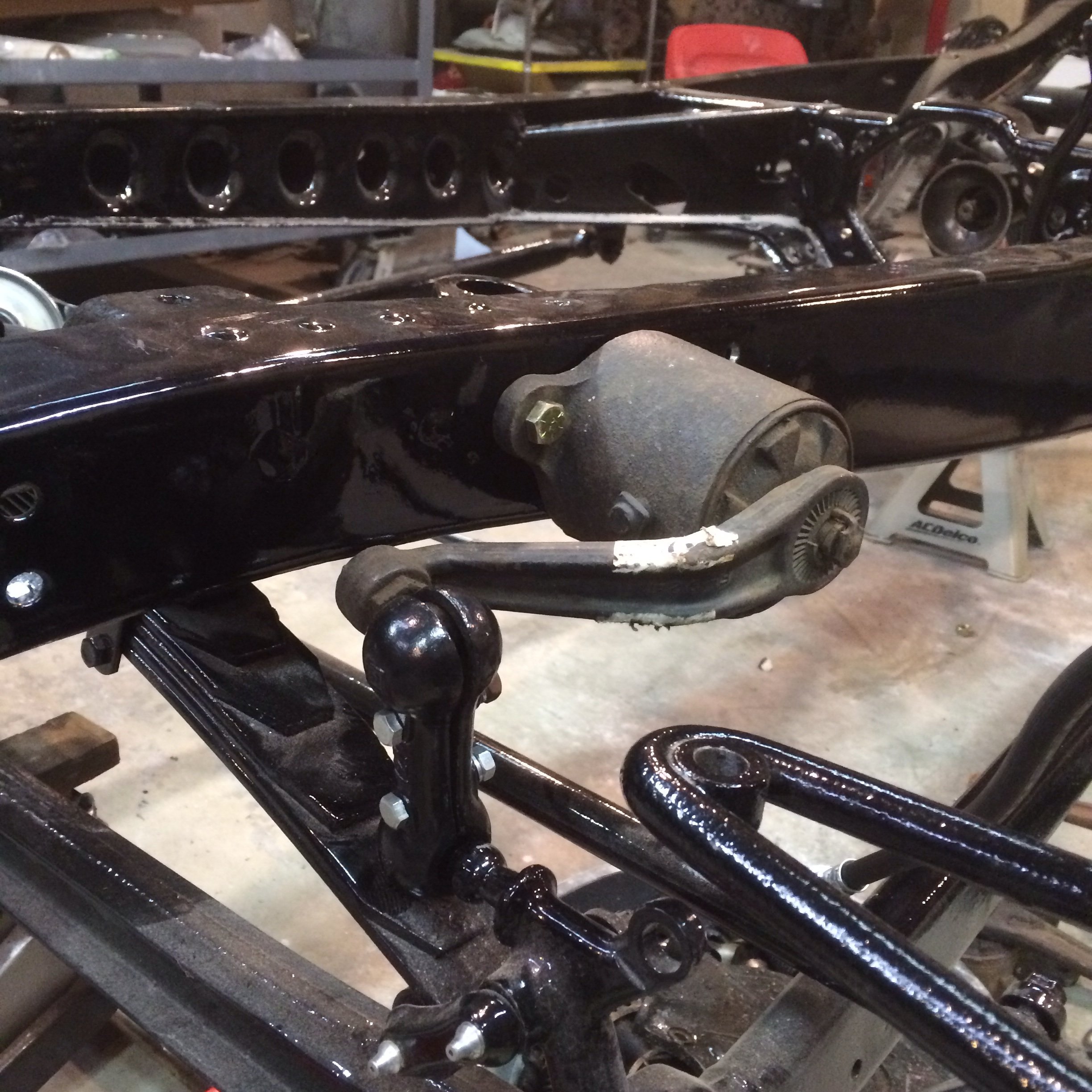

    Ch***is is ready for the engine and body. Brakes are bled and ready. Shocks on all four corners are on.
    Engine should be back from the machine shop next week and ready for me to ***emble. My 15/29 tooth trans is ready.

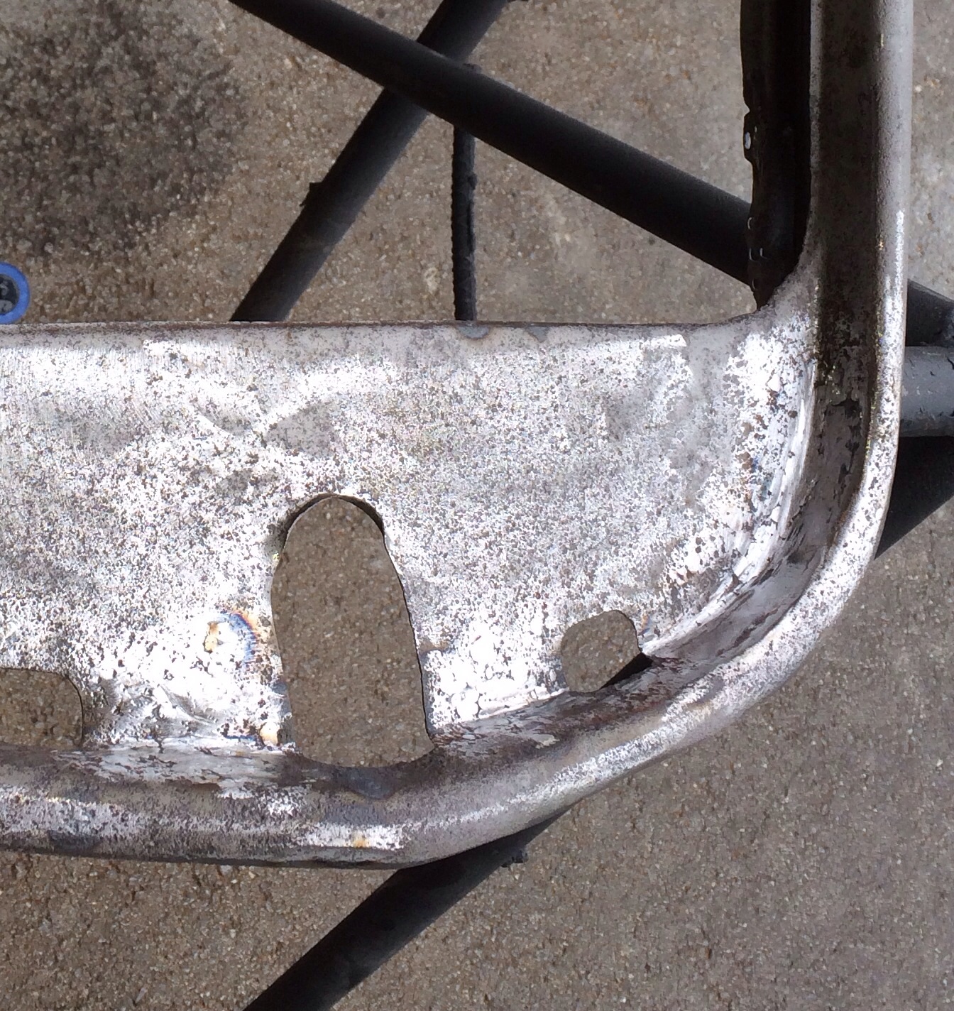

    Worked on the grill shell again today. Made a patch for the corner I cut out.
    It's got some pits but epoxy primer and high build primer should fill it in nicely. Better than a new one.

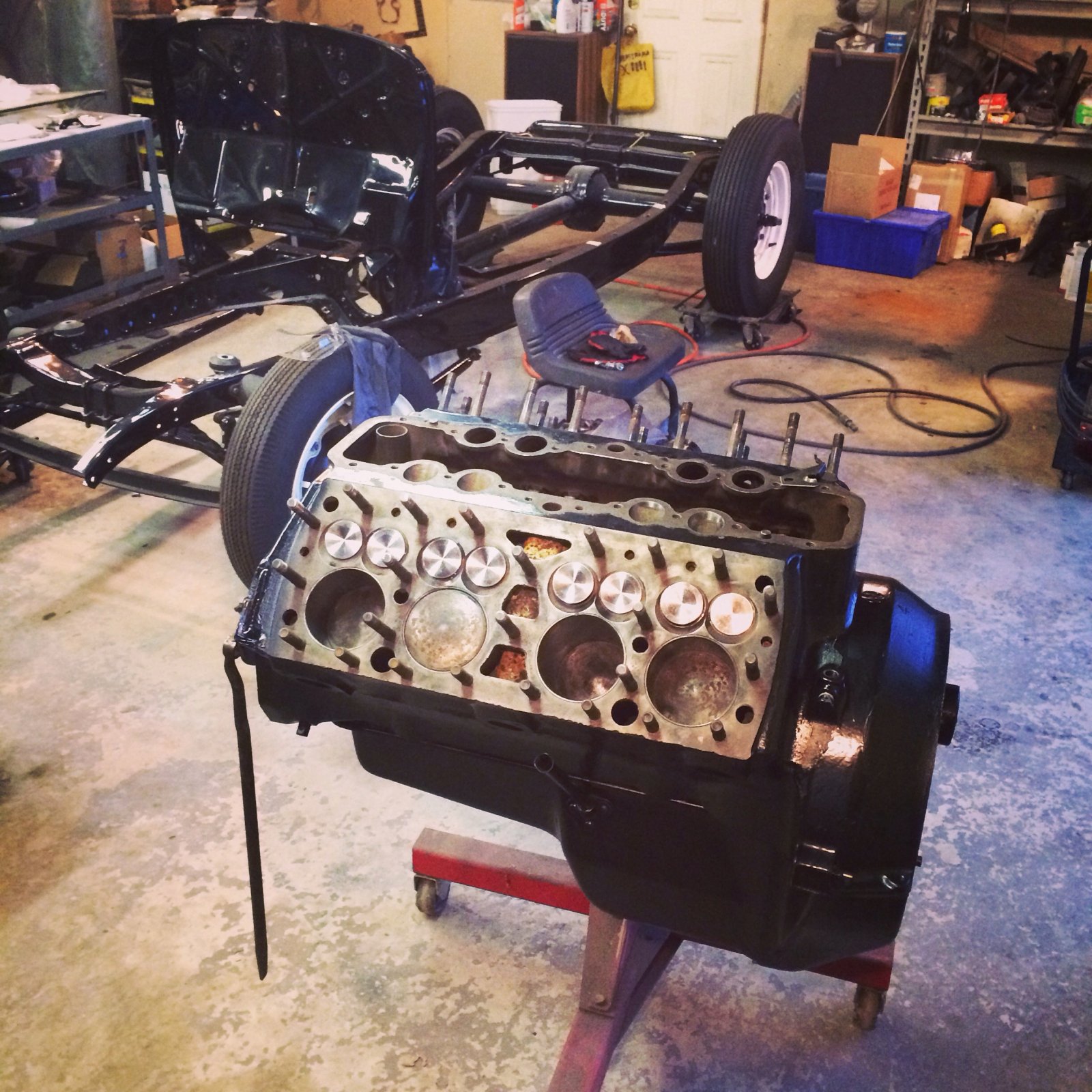

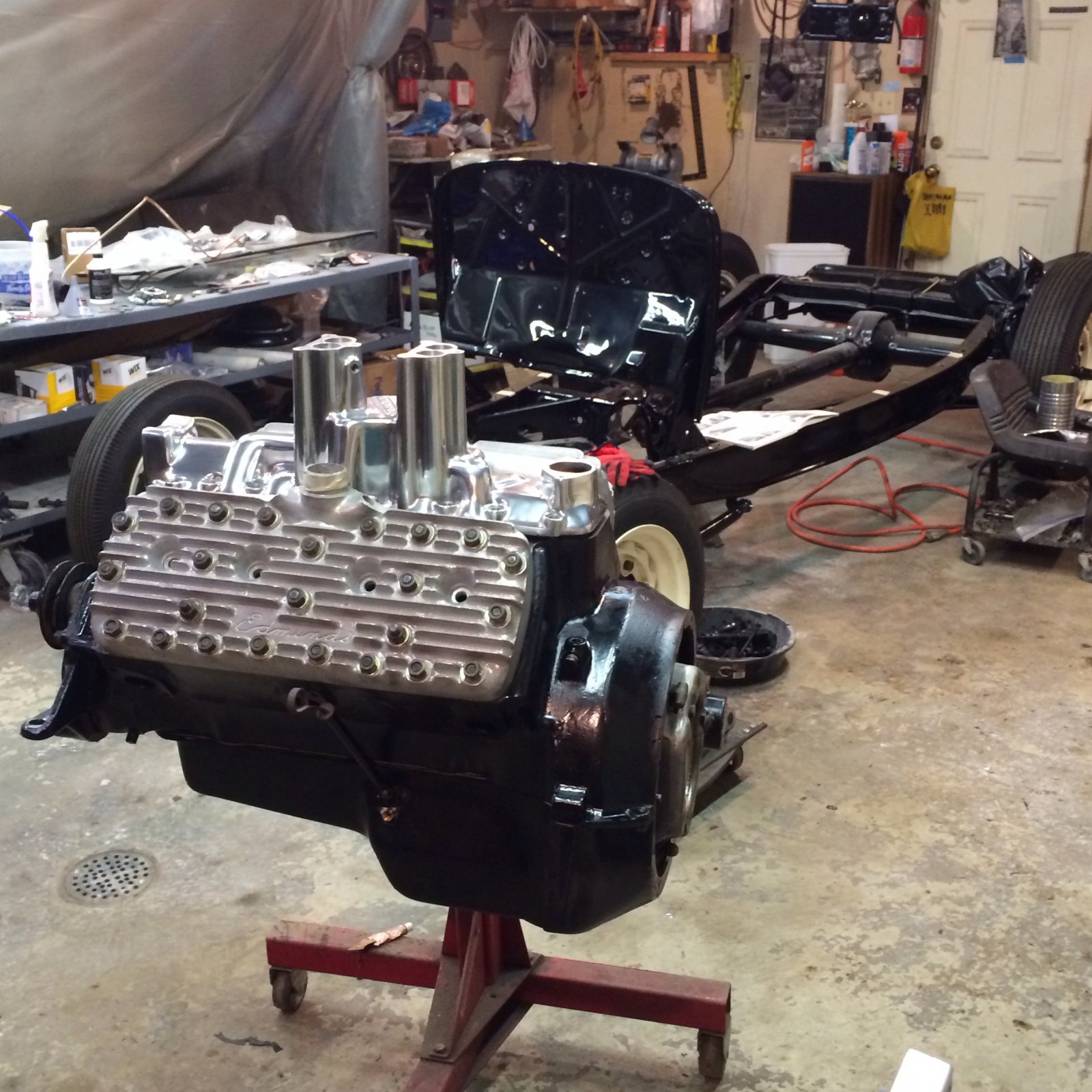

    Finally got all the pieces and parts to re-***emble the engine. Freshened up the rotating ***embly, new valve train , Winfield 1A cam. Should be okay, but not near the engine my T has.
    Engine is mostly ***embled and adjusting the valves now.

    Engine is together and back on the frame.
    Tomorrow, the body goes back on!!!
