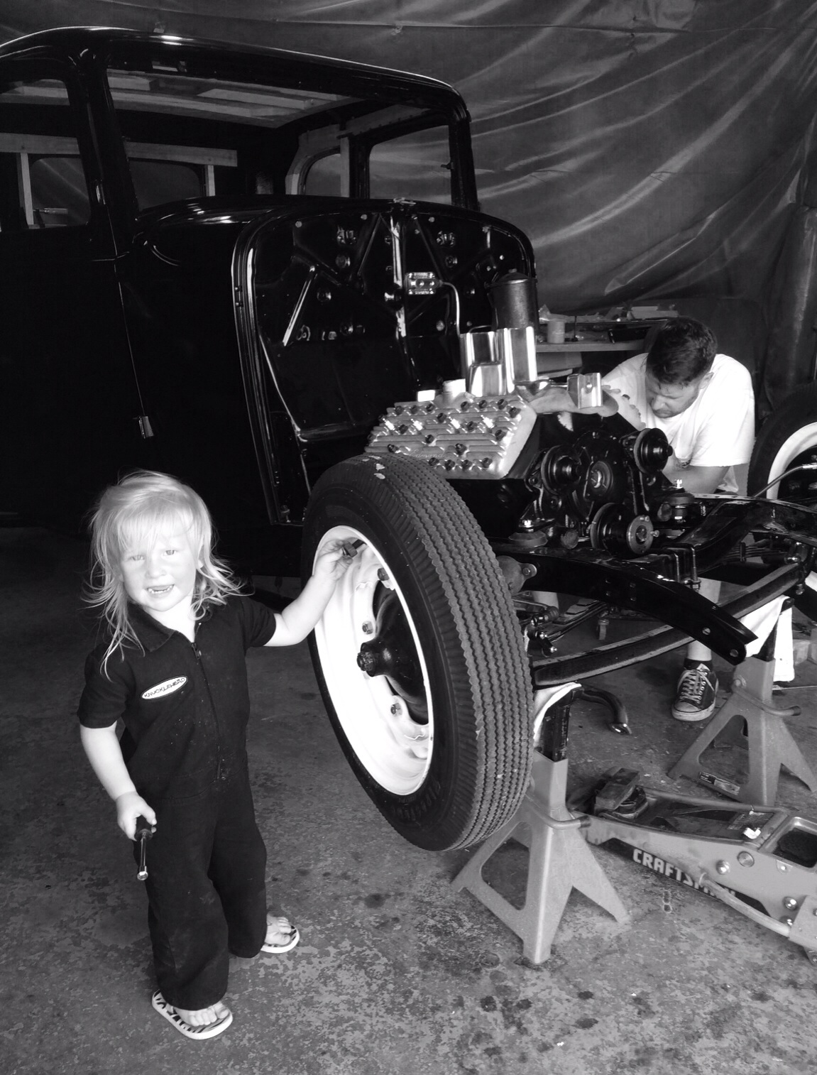

    Got a little work done over the weekend.
    Connected clutch linkage , mounted and plumbed the oil filter, finished the fuel line to the fire wall, installed the firewall insulator, test fitting grill and radiator to get it aligned for a hood.
    I had some good help too.
    Would like to get the dash in and start wiring next weekend.

    your daughter's name tag says knucklehead...

    Like the old saying says, "when the shoe fits, wear it...."
    Actually it's a handme down from big brother, her name tag should say "Rosie" cause she is good with a hammer in bad places.

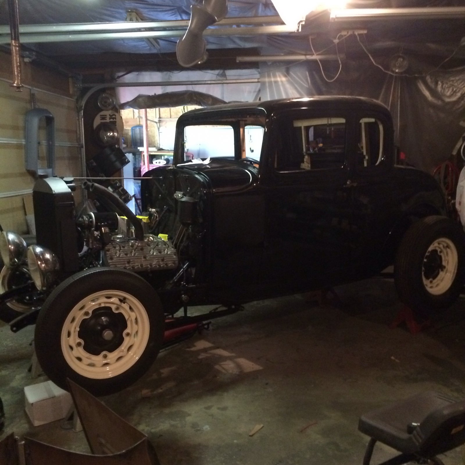

    Cowl vent in. Firewall insulation in. Dash tunnel and gauges in. Door latch and window regulators rebuilt and in. Hood fitted and holes marked to drill holes in radiator.

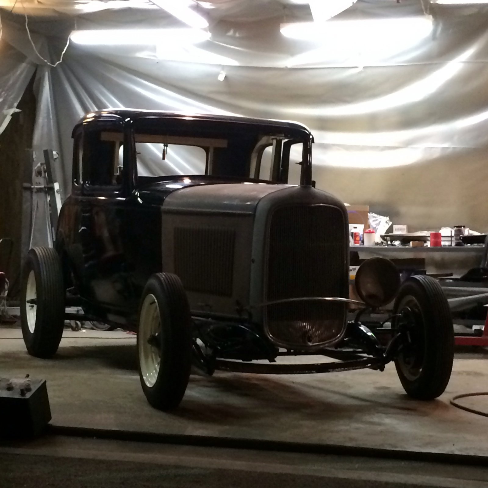

    I've been doing some wiring. Getting close to hitting the start ****on. Maybe one more weekend and it should be ready.

    Man, that looks good. I like how you mounted the oil filter on the firewall, and showing off those nice Edmunds heads.

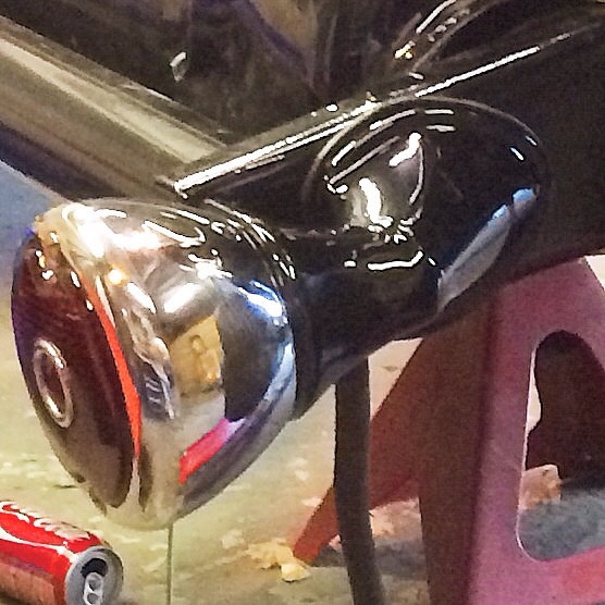

    Got a little more work done this past weekend. Headlights work, turn signals work. Replacement re-prop sockets for 32 headlights are junk. The terminal that contacts the bulb are ****. They actually don't hold position and end up contacting the inside if the socket and ends up shorting to ground. That took me a while to figure out.
    Had some good help this weekend prepping a few small parts for paint: gas pedal, column drop, taillight brackets, etc. Later that day, Sam painted what he prepped. His new nickname is Runs. image.jpg

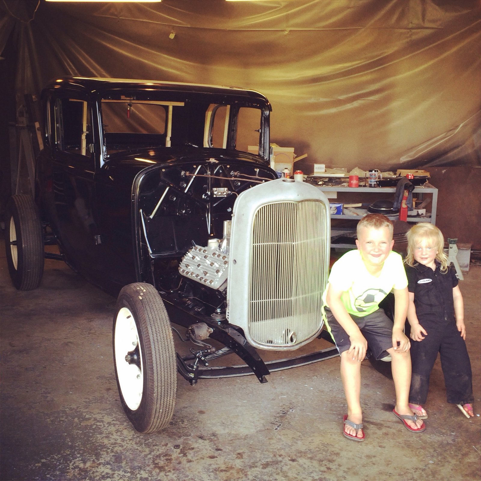

    Making a little more progress.
    The goal for Saturday is start up and the 1st drive!

    This car rules man. Can't wait to see it on the road!
