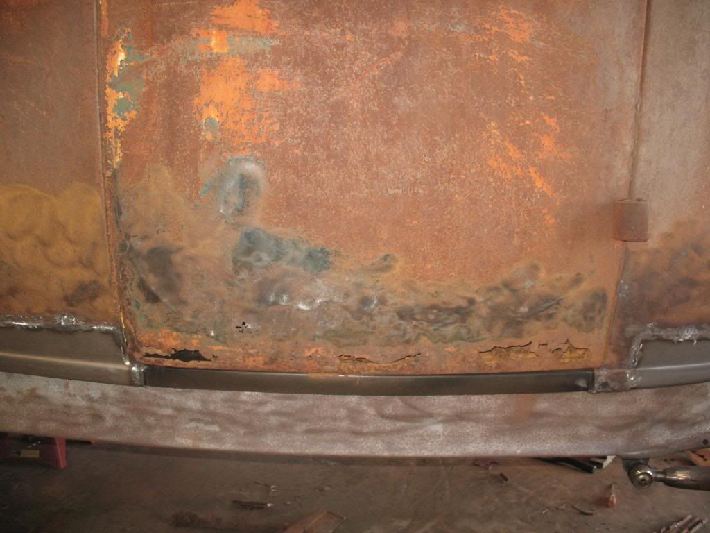

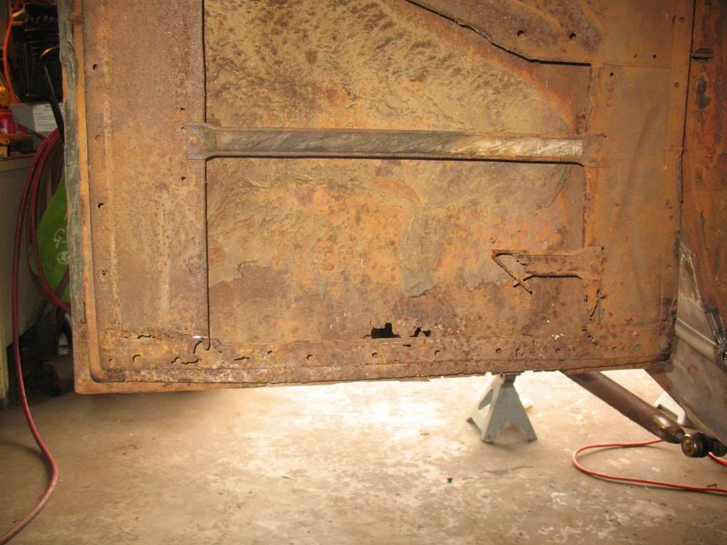

    The 32 has been dormit for a while, but over the last couple weekends and today, I got some pretty good work done. Both doors are now patched on the inner structure and the lower door skin.
    I will post pictures soon. Today I actually rolled it out side so I could clean up the garage.
    Next step is finish welding the door skins, then fill a few other holes and fix a few body cracks.
    My goal of having it drivable by the hamb drags is looking a little bleak.

    Pics of the doors from the last two weekends of work. Left Door.

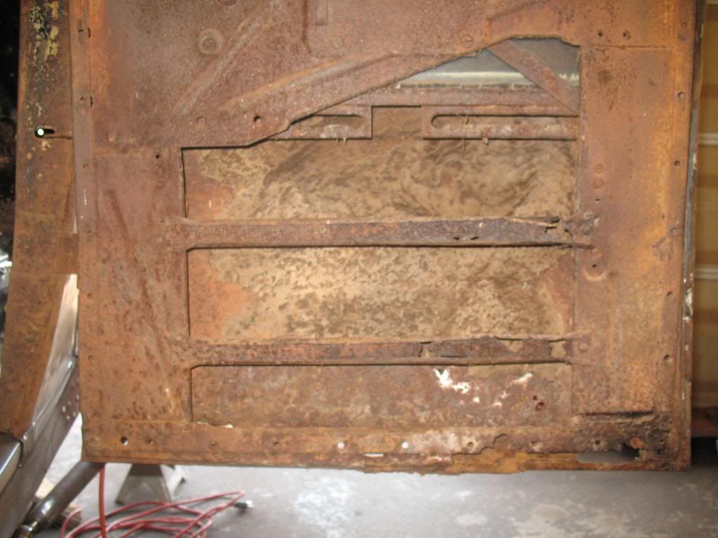

    T&A Flathead
    Right Door.
    Panels and other repairs fitted. All welds need to be finished and some hammer and dollie work needed.

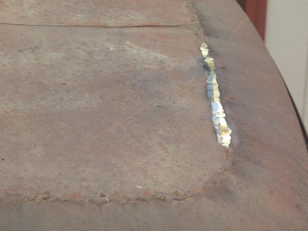

    I rolled it out side for a few photos and I removed the galvanized roof insert that was brazed in.

    The patch panels are from Tom Bay. The cowl patch and the quarter panel patch werent long enough to mate up to the rocker correctly. Easy fix. The quarter panels where they mate up to the reveal around the rear fender openning isnt quite right. The reveal is about 3/8" too wide on the patch panel. Fairly easy fix. The fender well patch is good. Door skin patch is good. Overall the panels are good, just dont expect to put them right in. And they are the best available.
