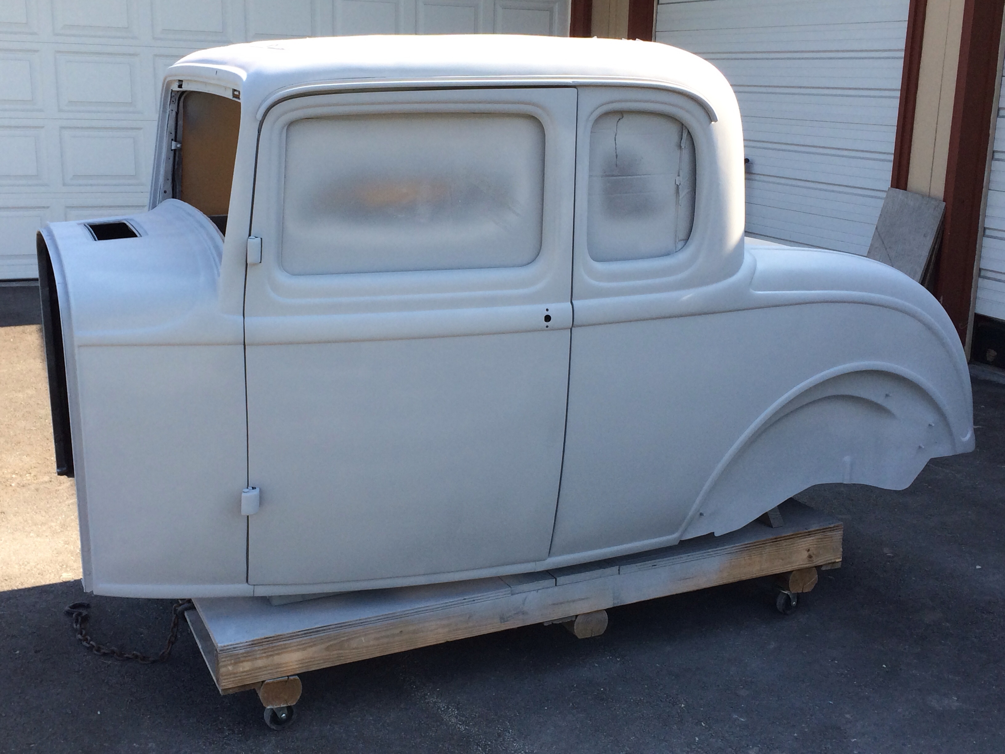

    Body back in primer. Time to block sand.

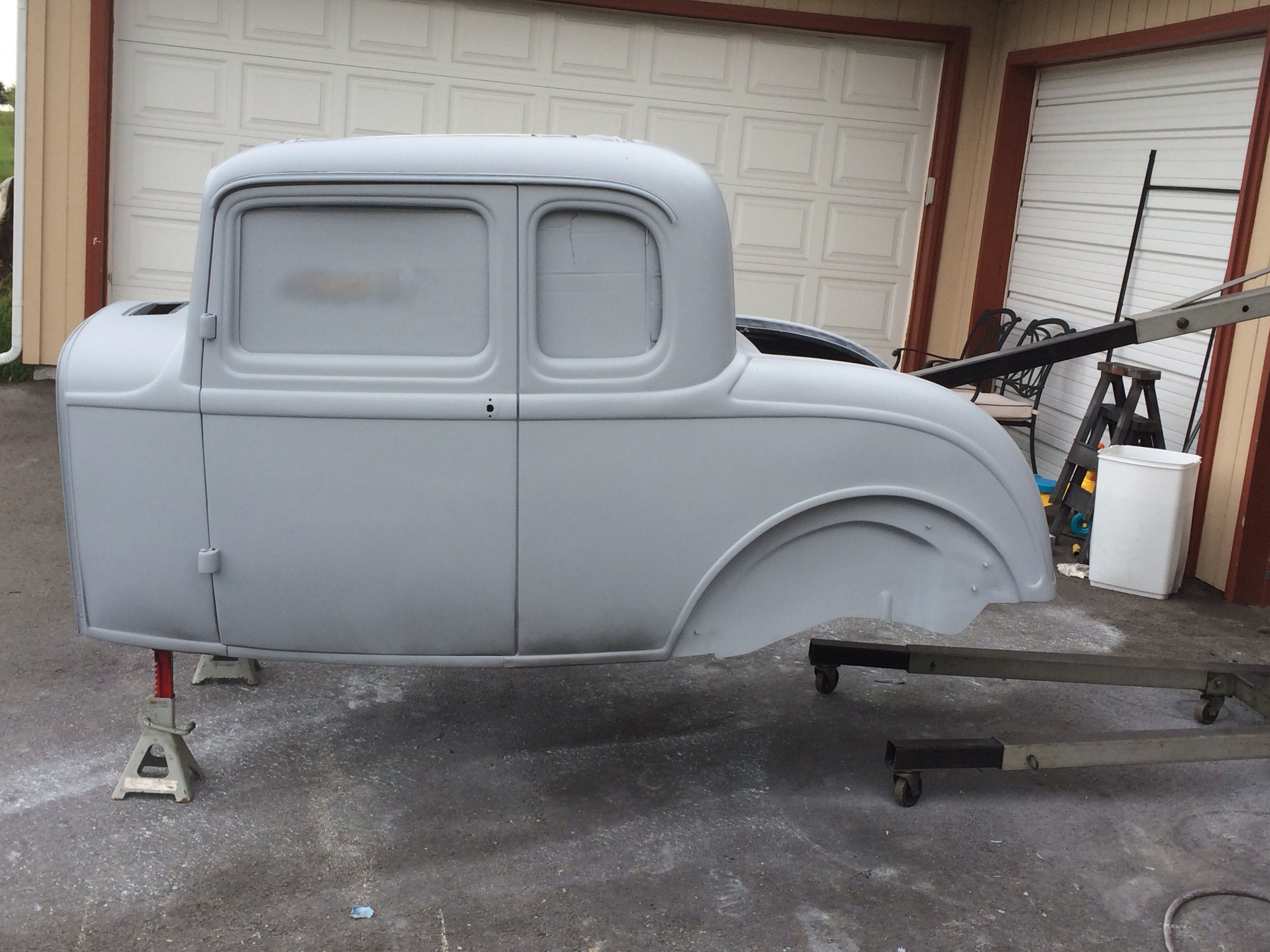

    Anyway. Here is some progress I got done on Sunday. Did some paint trials. Painted the firewall and cowl vent. I used DuPont centari. I put on the first coat according to the mix instructions, let it get tacky then sprayed again but mixed with twice the reducer. It laid down very smooth.
    Not the best pictures, but you get the point. It didn't quite flow out like urethane, but close. It will achieve the look I'm going for.
    Also did a lot of blocking on the body, still have a lot to do.

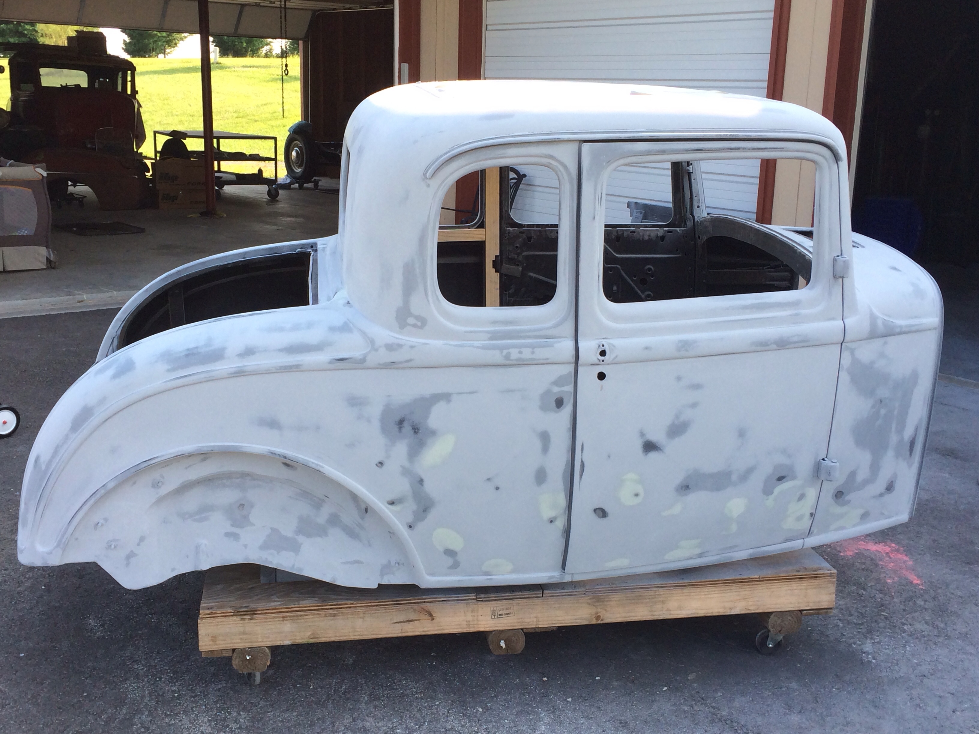

    At it again today. I skipped the hamb drags so I could keep working.
    I primed the body again after I had blocked the whole body. I will lightly block it again and it will be ready for paint.
    I also painted the underside today.
    I also laid the frame welting and poked holes for the body bolts, mounted the fuel tank and ran some fuel line, and started making the battery box.
    Since I'm not in Joplin 1/2 in the bag, I will be up early tomorrow sanding again. My goal is to paint the body next Saturday.

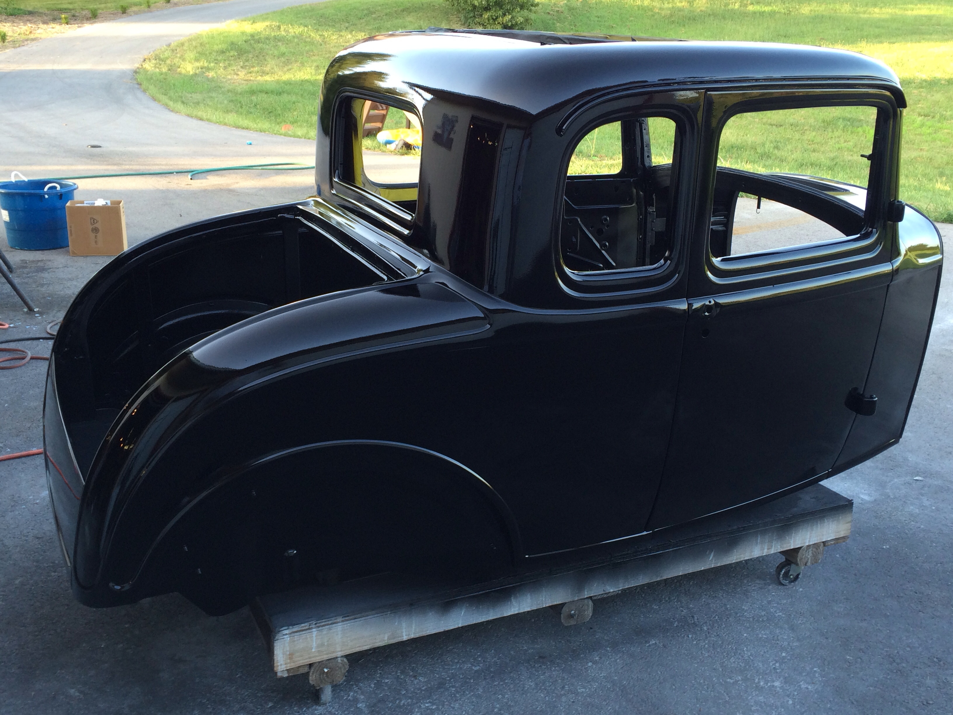

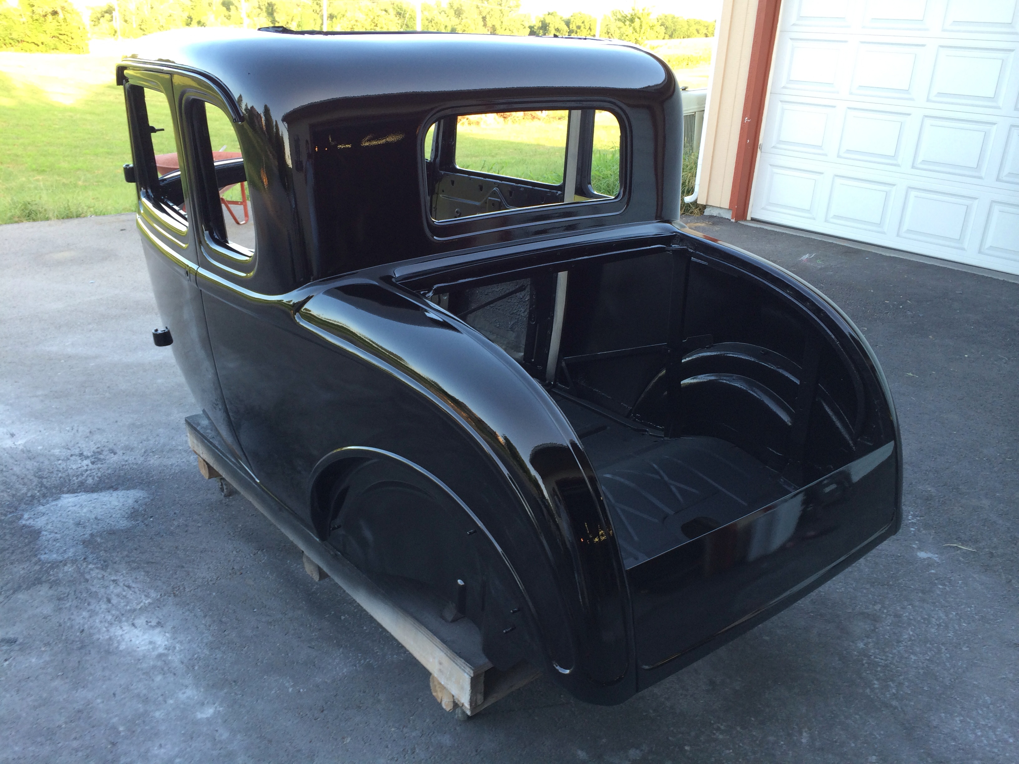

    Shot some paint this weekend. I painted it outside so it has a little dirt in it. I should have taken the time to build a booth in the shop, but I figured I was going to color sand and buff anyway.
    AHotRod and Sunday driver like this.

    Joined: Dec 3, 2010
    Posts: 13,260
    ct1932ford
  29. deucetruck
    Joined: Jan 8, 2010
    Posts: 763
    deucetruck
    from Missouri
    Wow. Shiney! Can't beat a black hot rod!
