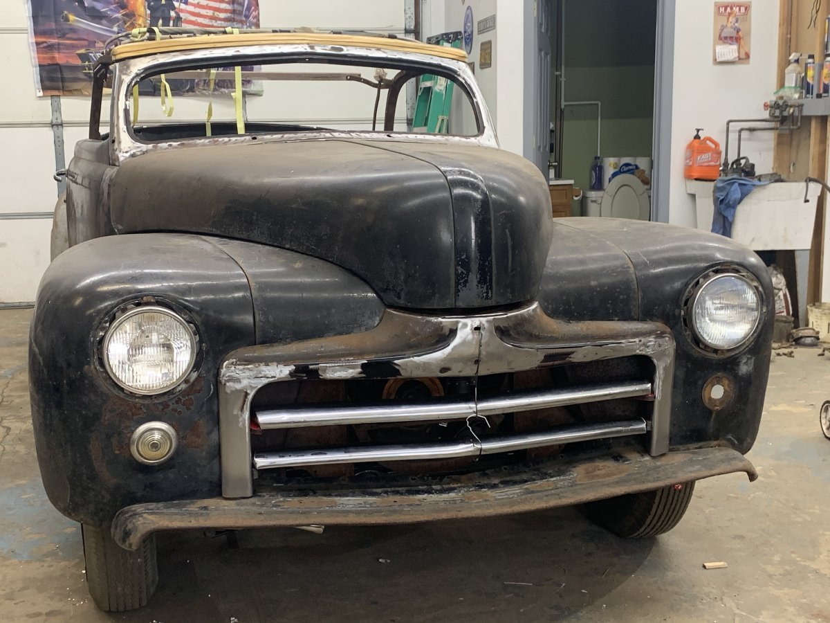

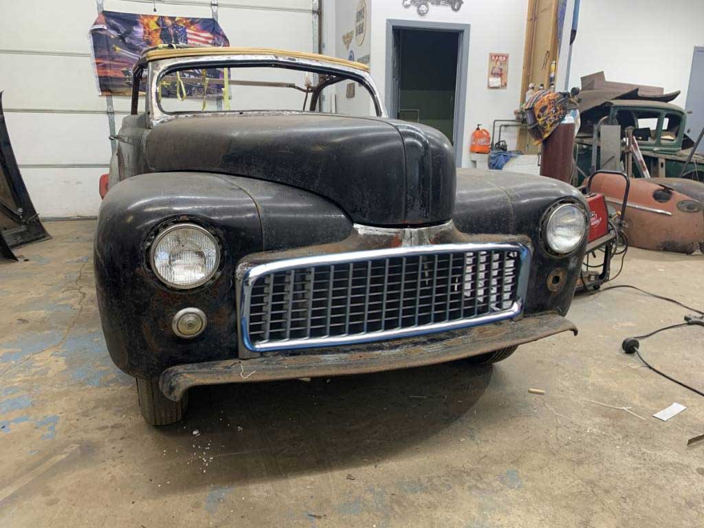

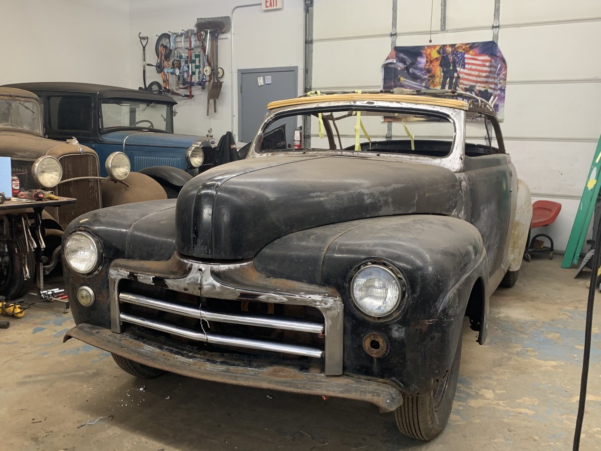

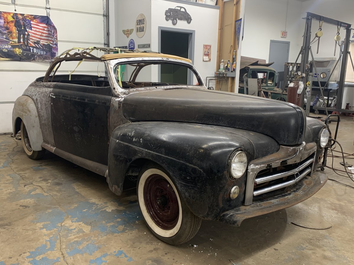

    Messed around with making a custom grill a little more.
    Crude photo shop to shade the surround in the first pic. 2 floating grill bars from a 51 Chevy.

    I like the grille. Looks better than stock.

    Tim, any chance that you have a 3rd grill bar laying around? Pretty big opening for just the 2 bars...just saying!

    I do, but 3 gets a little crowded. Once I space them right and rotate them to give them a little thicker appearance. Also, with the bumper back on, it will help complete the look and close the gap. If it doesn’t turn out, I can redo it, it all bolt on, nothings permanent.

    Just curious, how might a '55 Chevy grille look?

    Think I like the bars better.

    Do you think that is the top grill piece with the holes filled in, or was there more done to it?
  24. Automotive Stud

    Looks like a stock grille with the top trim piece removed and holes filled. Pretty simple and cl***y.

    I'm also a fan of a simplified stock grille on these cars, but I can't fault a guy if he comes up with a (good looking) alternative.

  26. Yes, and then a small piece of sheetmetal needs to bent up and welded on to line up with the bottom of the hood. The original pot metal top piece sticks out quite a bit, so when you remove it, you need to make up that space.

    I agree. But I was at a show last weekend. 1/2 the 46-48 fords were done this way, almost as common as a belly****on.
