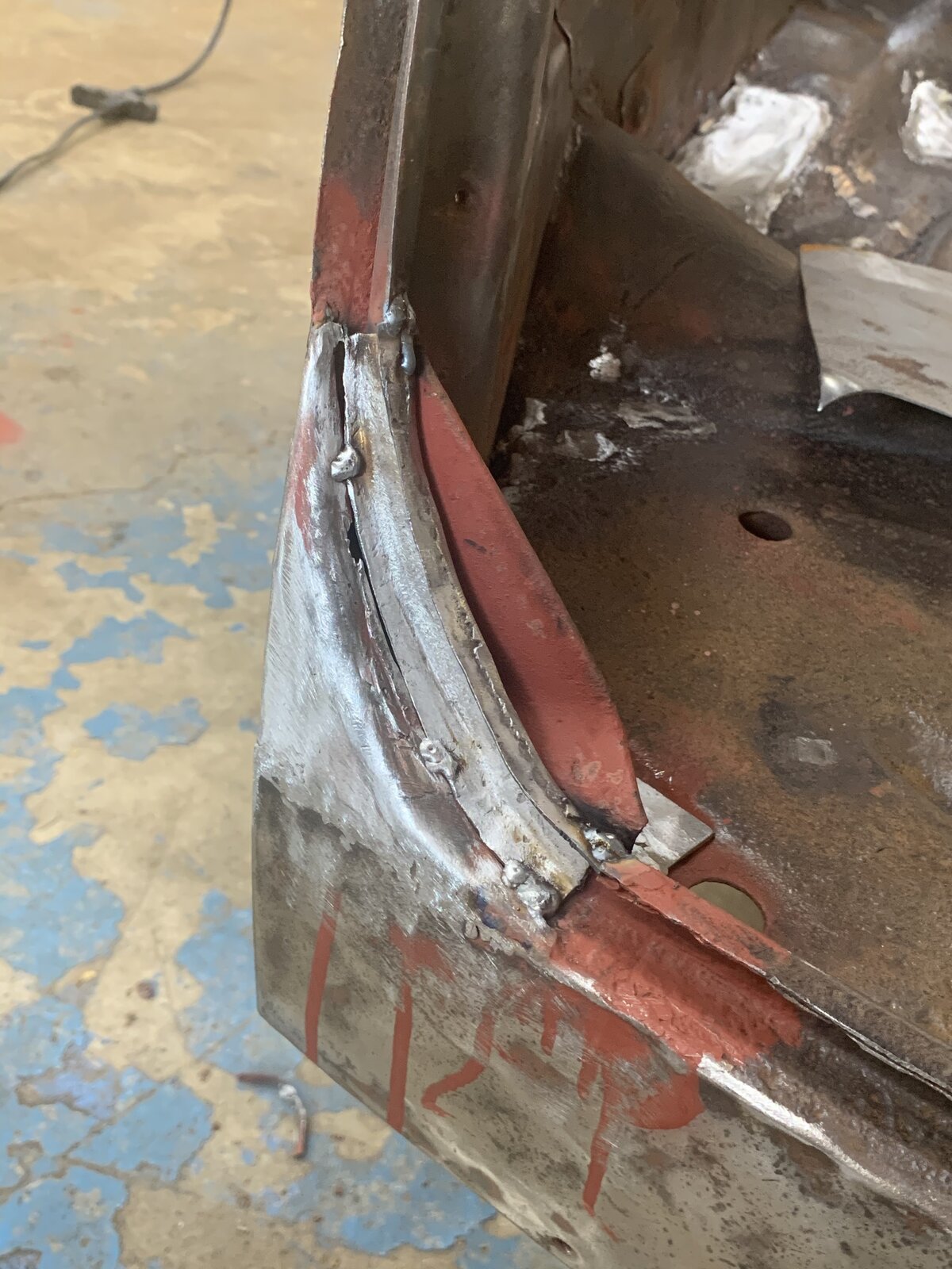

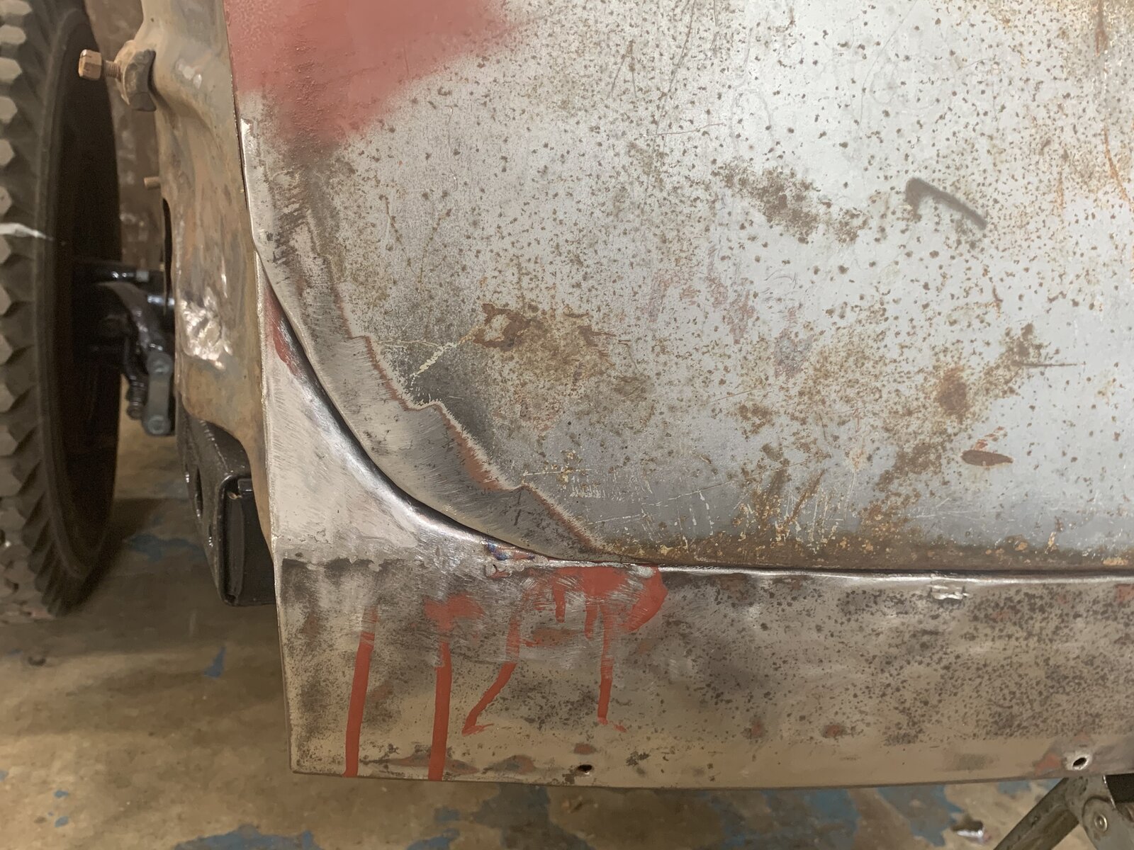

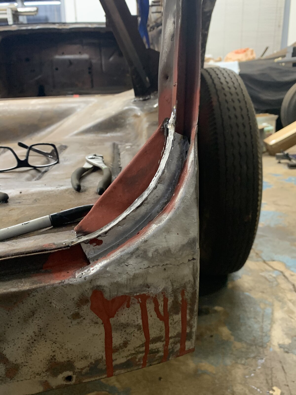

    I didn’t like the way this turned out. It bothered me ever since I posted the above photos, so I cut some of it out and made a gutter. Not done yet but it’s tacked in place. Also have the drivers side metal fab 1/2 done.

    Once I get the gutters done, I’ll trim and smooth the radius on the deck lid.

  2. Dick Stevens
    Joined: Aug 7, 2012
    Posts: 4,139
    Dick Stevens
    That's much better, I wasn't liking it the first way at all!

  3. T&A Flathead
    Joined: Apr 28, 2007
    Posts: 1,986
    T&A Flathead
    I absolutely hated it after I saw the picture, I don’t know what I was thinking. That’s what I like about metal work, cut it out if you don’t like it and start over.

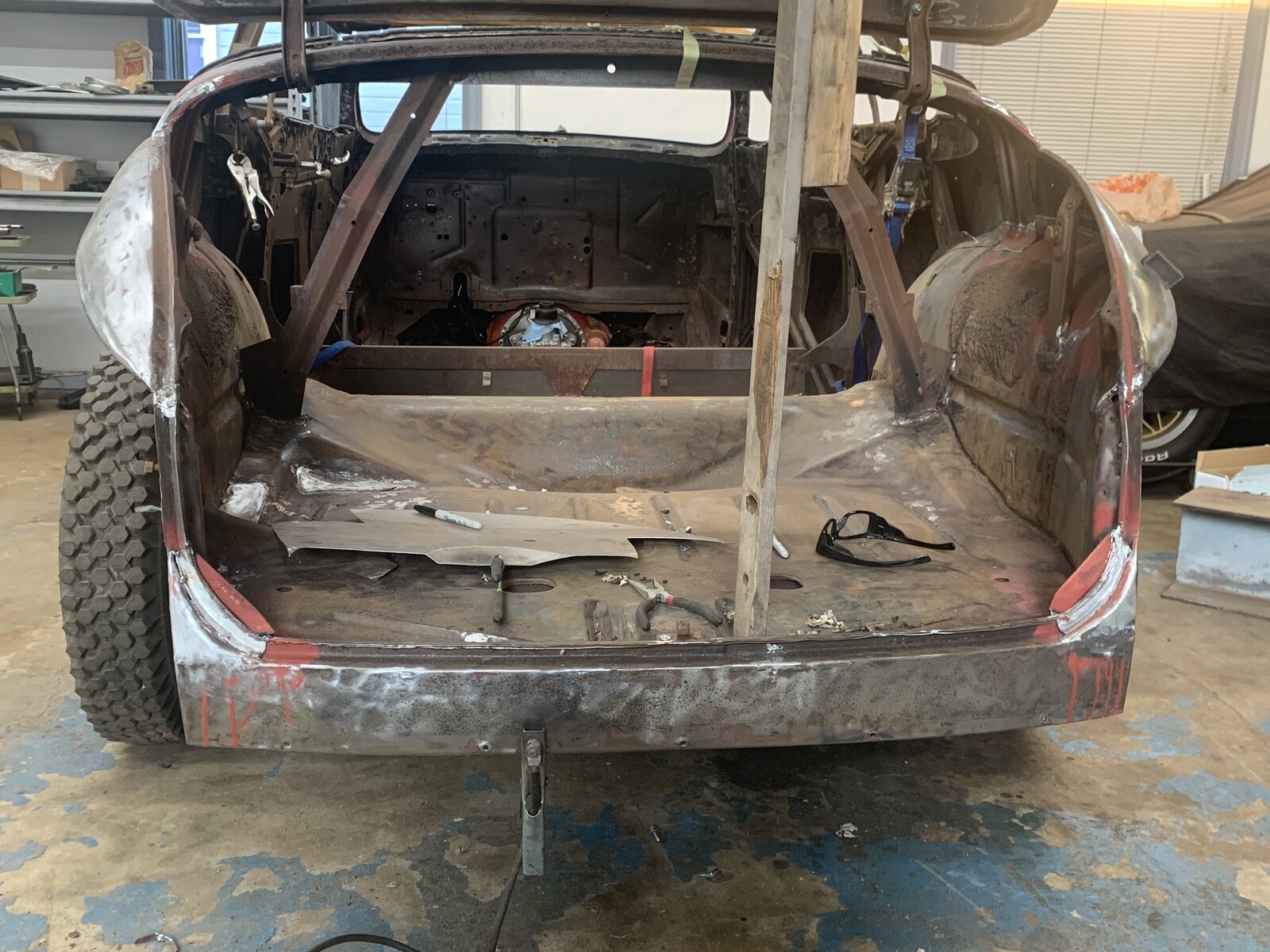

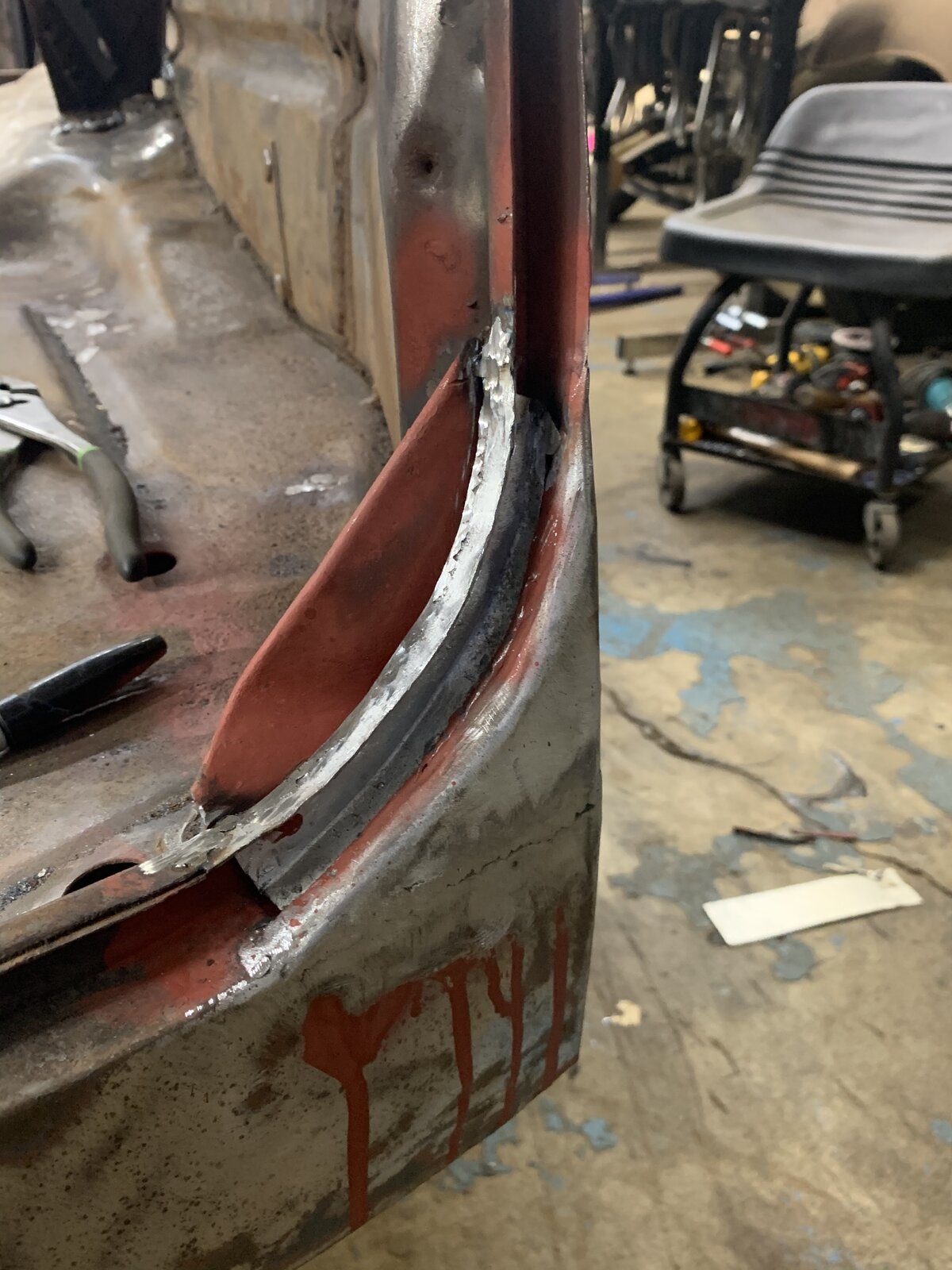

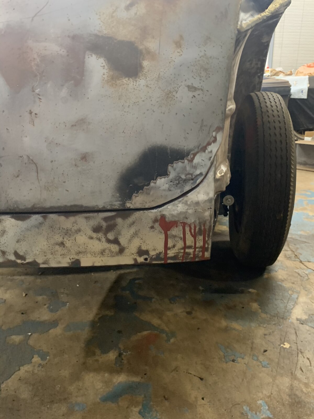

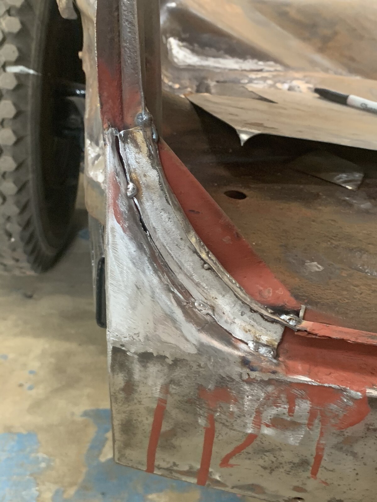

    I got the drivers side gutter tacked in. Final weld and finish work remains on both sides. So glad I decided to redo what I did a few days ago. Thanks for not being too critical on me on my first attempt , but I can admit my own mistakes.
    86DA48BF-836F-4382-83EF-4009D5993D27.jpeg 89FA8565-F718-4949-A79E-E986B253607F.jpeg B198560E-BAF3-40C1-A567-EB5EEF6B3C5A.jpeg 8B629CFB-4CA4-495B-9525-B689DC01E1A8.jpeg
    now to fine tune and match the radius
  5. hotrod1948
    Joined: Jan 17, 2011
    Posts: 515
    hotrod1948
    from Milton, WI
    Looking very good. Like the second fix much better. Keep going!
    T&A Flathead likes this.
  6. 36 ROKIT
    Joined: Oct 3, 2008
    Posts: 1,569
    36 ROKIT
    Kudos for your courage, man. Not many of us would have attempted the "learning as I go"
    route! Coming along nicely.

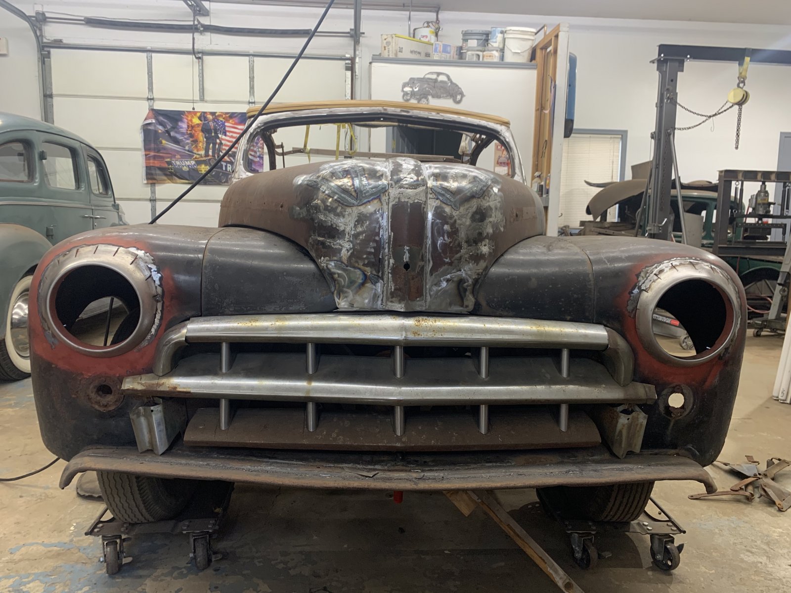

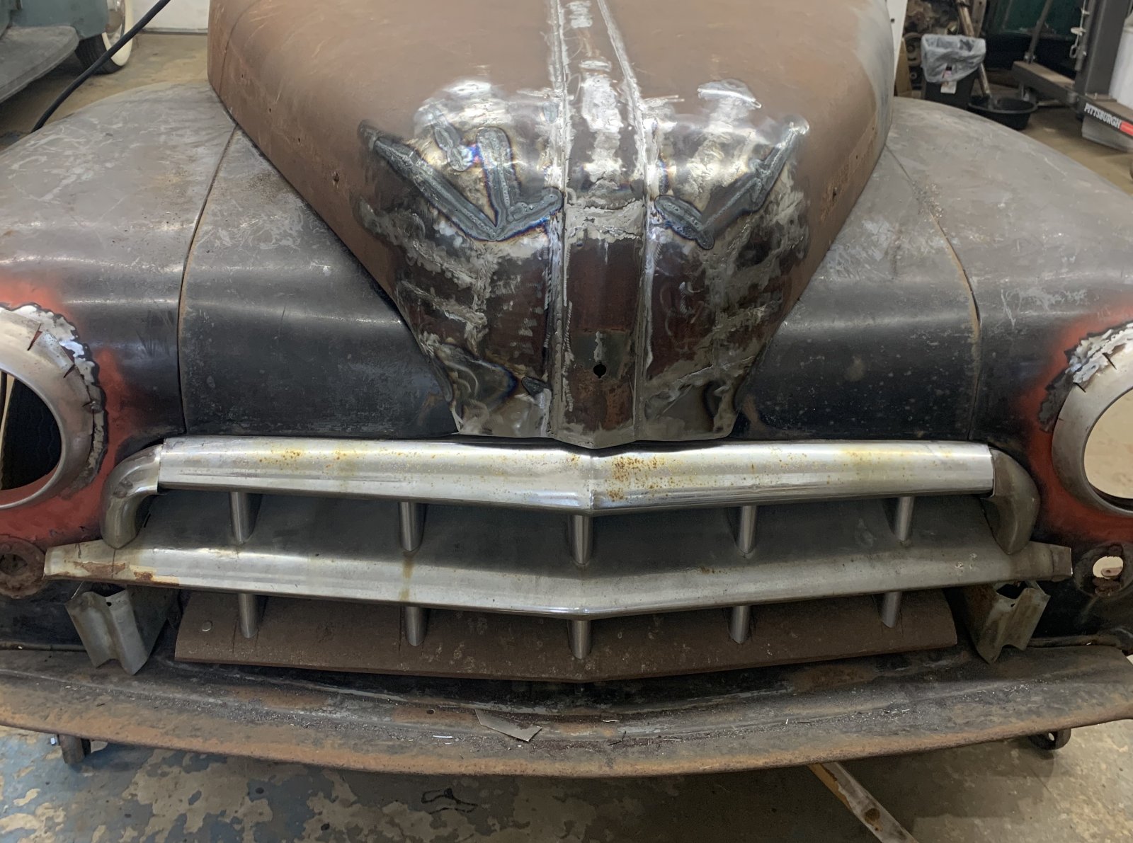

    I am playing around with a grille change, this time a ‘49 Cadillac grille. Barris put one in a ‘48 Merc
    Early mock up pic.
    537B7658-28B0-483C-AFEF-5CA2DAC29663.jpeg B7945C74-72D7-4562-B019-E94CFD39F0B3.jpeg 4987E10C-44FC-4E05-AF46-90C8A225442E.jpeg
    If I decide to use this grille, I’ll detail all the modifications I made to the grille. It’s narrowed 4.5” and I recessed the lower horizontal grille bar 1.5”so it doesn’t protrude past the center bar.
    To make the grille look like is belongs in the car I want it to fit right with the fender extensions and hood without it looking like it has a fat upper lip. I also shortened and re-radiused the nose of the hood. A lot of work left to do, but I am liking the look of the Cadillac grille.

  16. Imho, I've seen a lot of custom grilles on the 46-48 Fords and it's hard to beat Henry's original work. The Olds option does have a certain eye appeal though.
    I've been following your build with a lot of interest.

    you cant go wrong with the Caddy grille, but your first grill was certainly Kool

    Love the Caddy grille. Great to lose that odd surround that the Ford had originally.

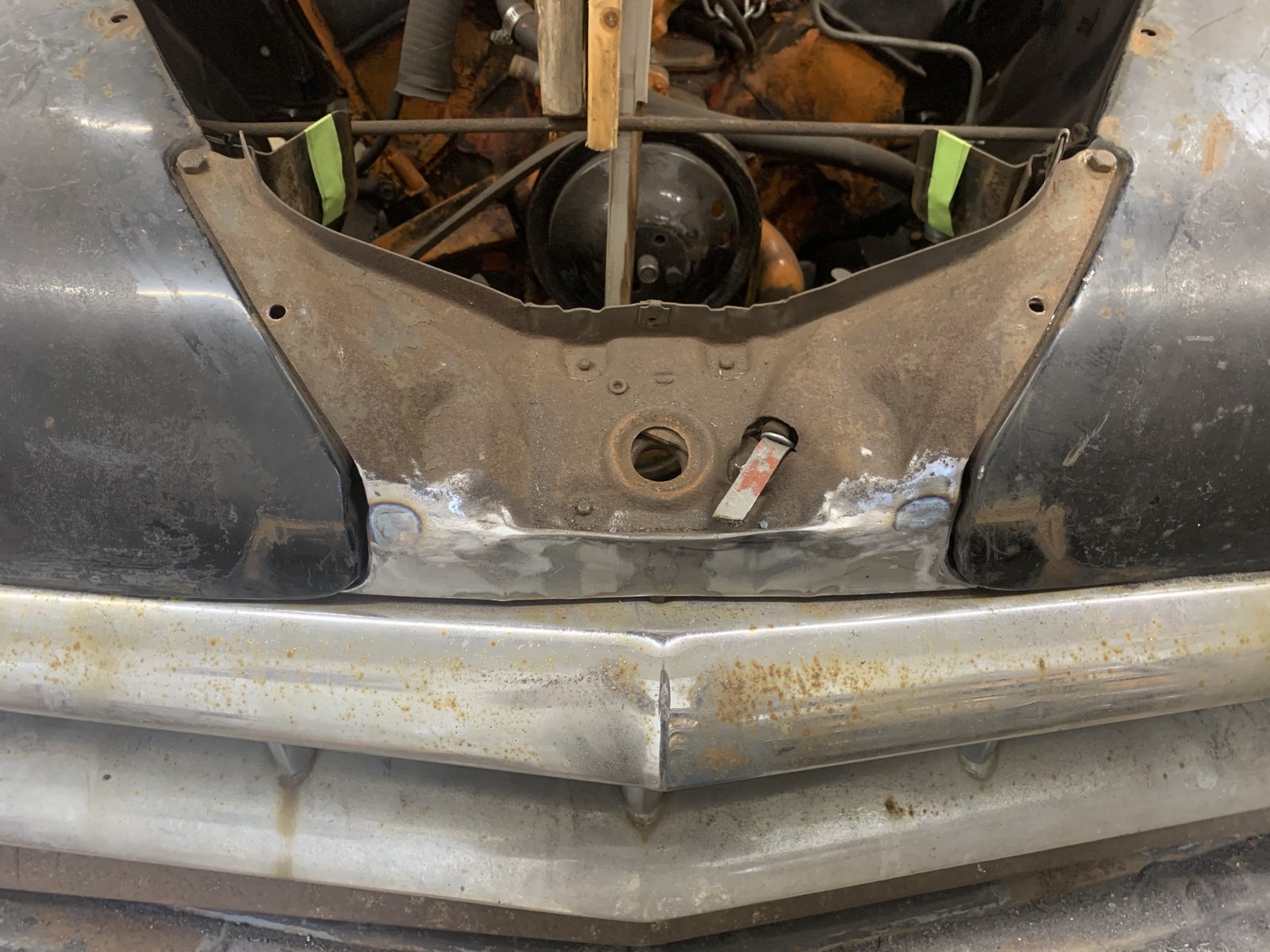

    Spent a couple of minutes at the shop on my way home from work. Did a little fitting and t******* in the grille. I have a plan, I think it’s working. A lot more to go, but the grill is coming along.

  27. louisb
    Joined: Oct 13, 2008
    Posts: 1,126
    louisb
    That is looking on target. The only thing is the ends of the center bar. Wonder if you could make some gl*** spear tip shaped lights to use as running lights.
