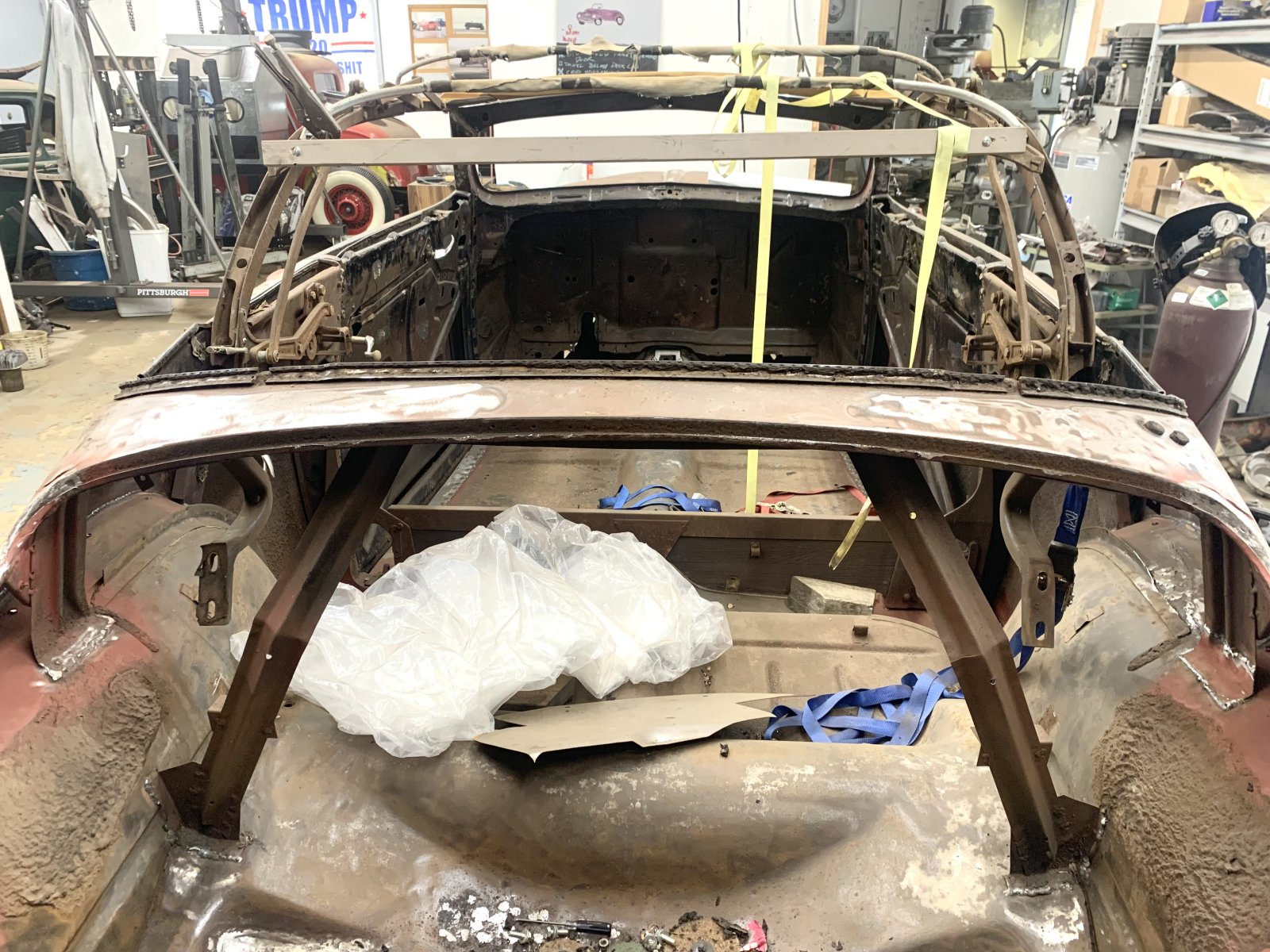

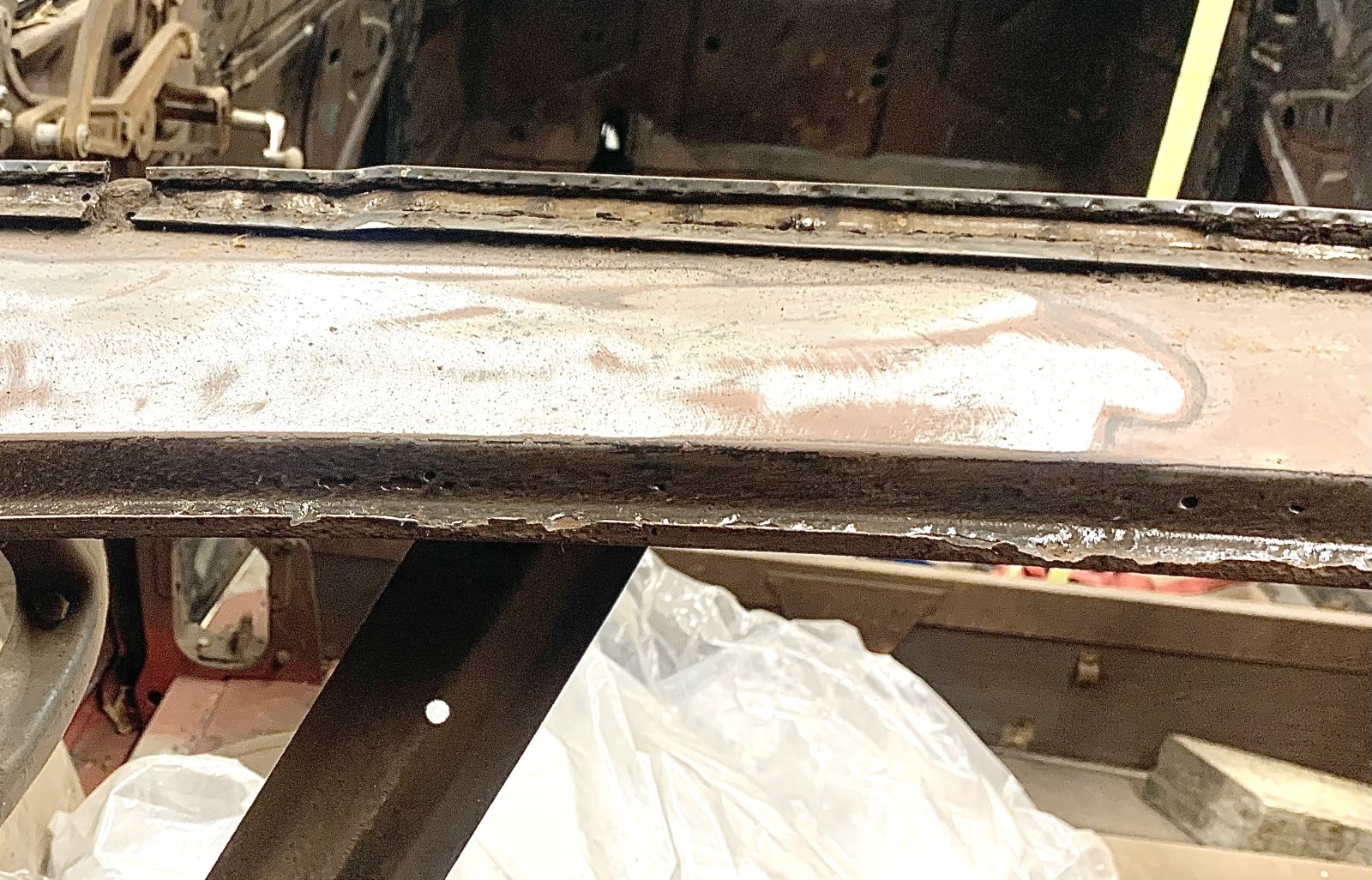

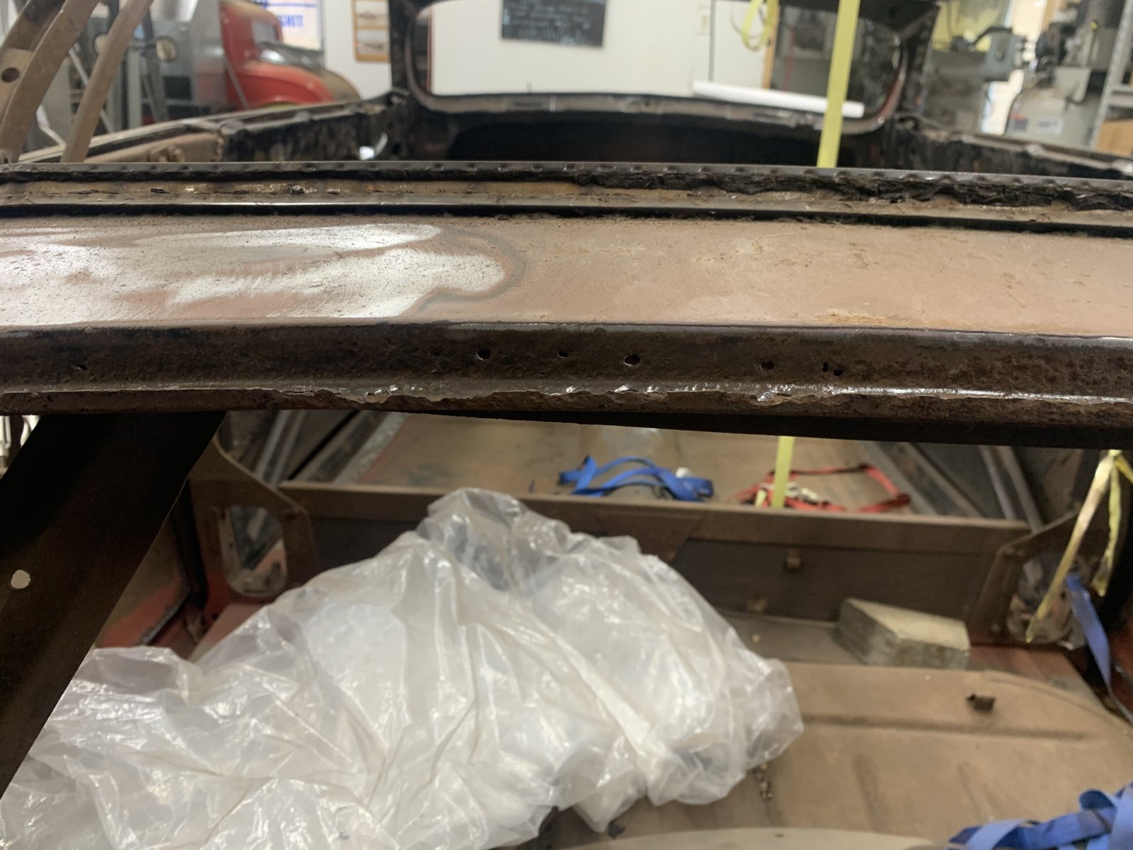

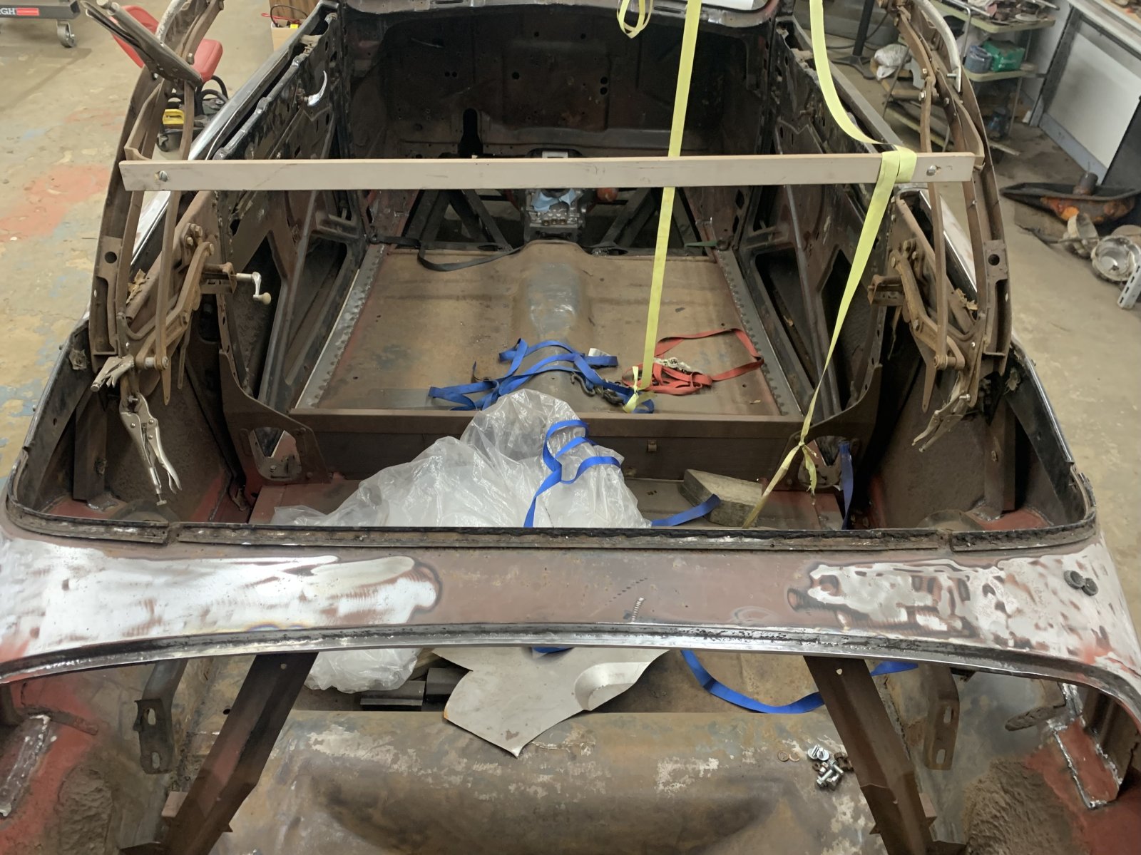

    Got some shop time today and spent it repairing the last of the rust. I’ve been putting it off for a while but decided to knock out the rust in the upper trunk area rain gutter.
    7E234D54-531D-4DEA-9C2E-710739BCE6F3.jpeg FFDC8FD3-09C1-4D70-8561-1F442ED2E9F3.jpeg BF0865DD-580A-44F4-88E1-83D7383D2BC5.jpeg EC5F9916-1B9C-45F3-8AD8-A01CF9250294.jpeg A47BF5E5-6CAC-4734-B97D-A4F4D58B532A.jpeg F2D1CAC6-C808-4432-A955-37EAEFE464DD.jpeg 61DB29D0-2B90-40F2-A4DD-E5A1C2925974.jpeg 1FD41BC5-676F-4286-942D-AE6F0B4DC185.jpeg

    Nice job...that ****er was rough!

    yep. It’s a real turd.

    The good thing about that area is that the trunk gasket covers a lot!

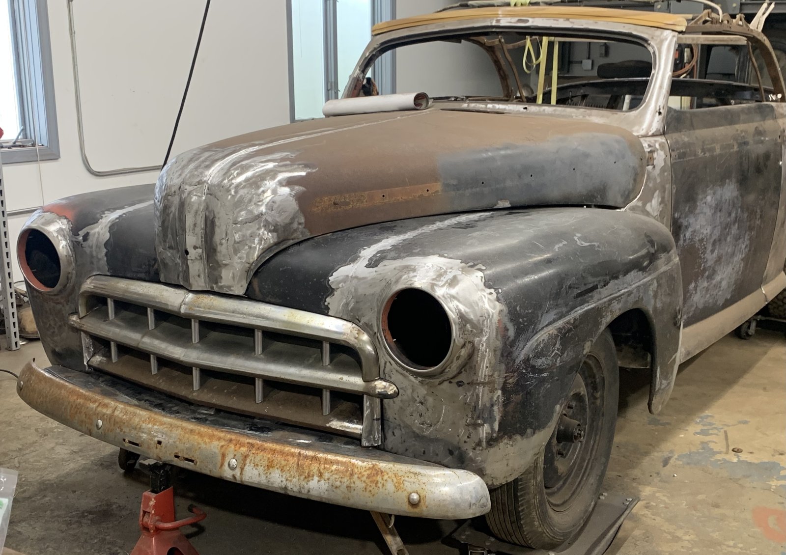

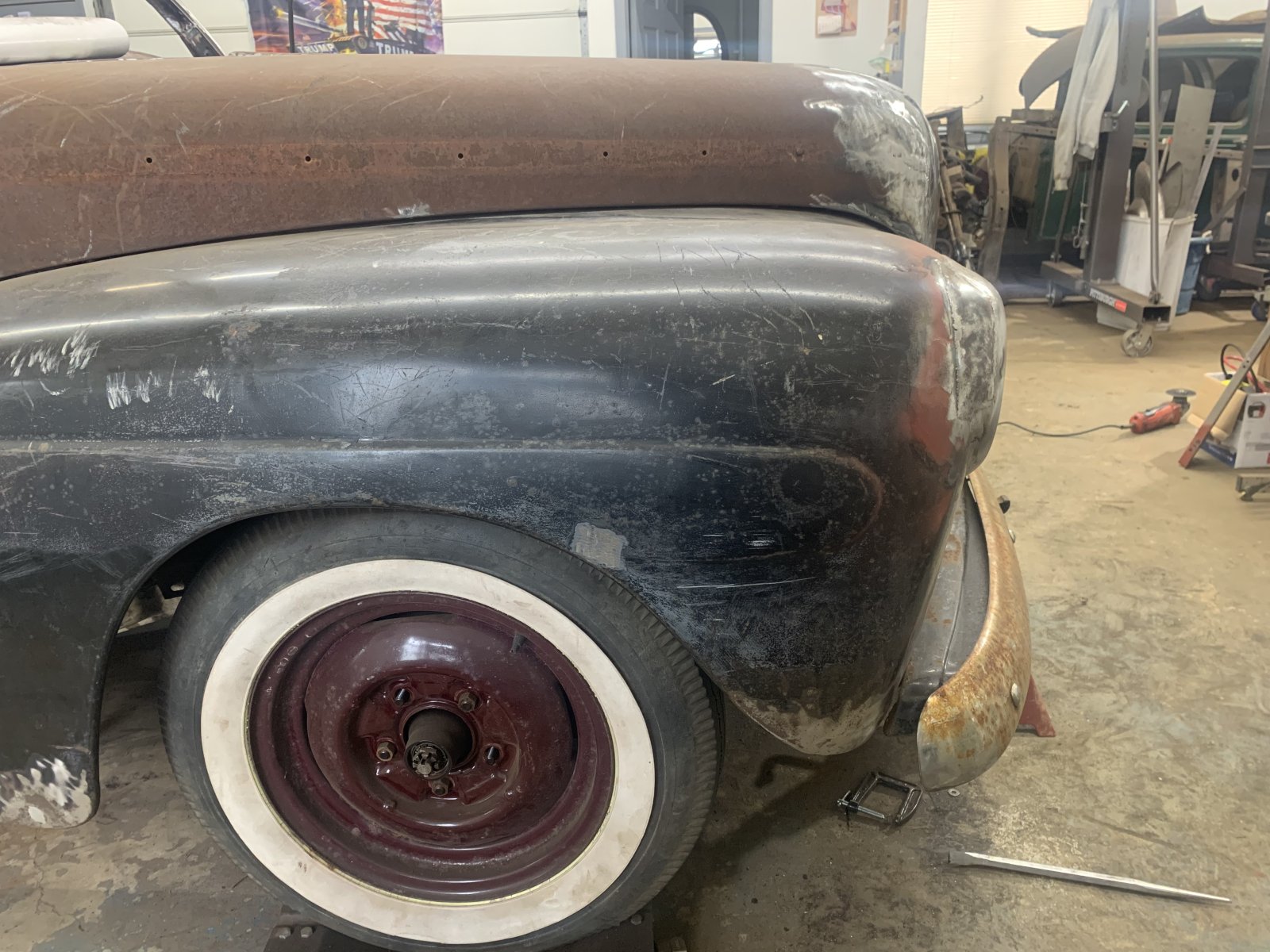

    A little more work today. I trimmed the gravel pan back and recessed the front bumper. I don’t like that the bumpers stick so far out so I tucked it in a little.

    really nice work on the front, everything has a tight balanced look.

    thanks. I stare at it a lot to make sure it all works together.
    next I’m going to fill the seems between the fender and the fender extension.

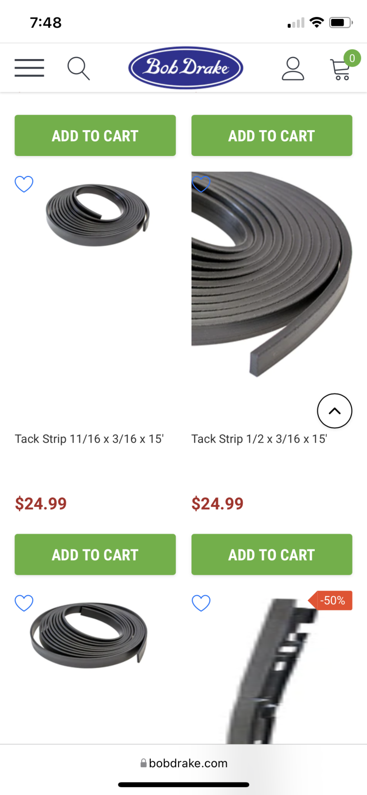

    Could You post pictures of the front wooden bow ? The one that sets down onto the windshield frame .
    Have You figured out what goes into the channel that the cloth top attaches to ? Some type of soft plastic or rubber ?
    I hauled home a 47 Merc ragtop and those pieces are missing.

    it’s a hard rubber tack strip. There are nails in it. I need to find someone who restored one to see what they did. I’ve never seen a replacement material. I may ask over on the ford barn.
