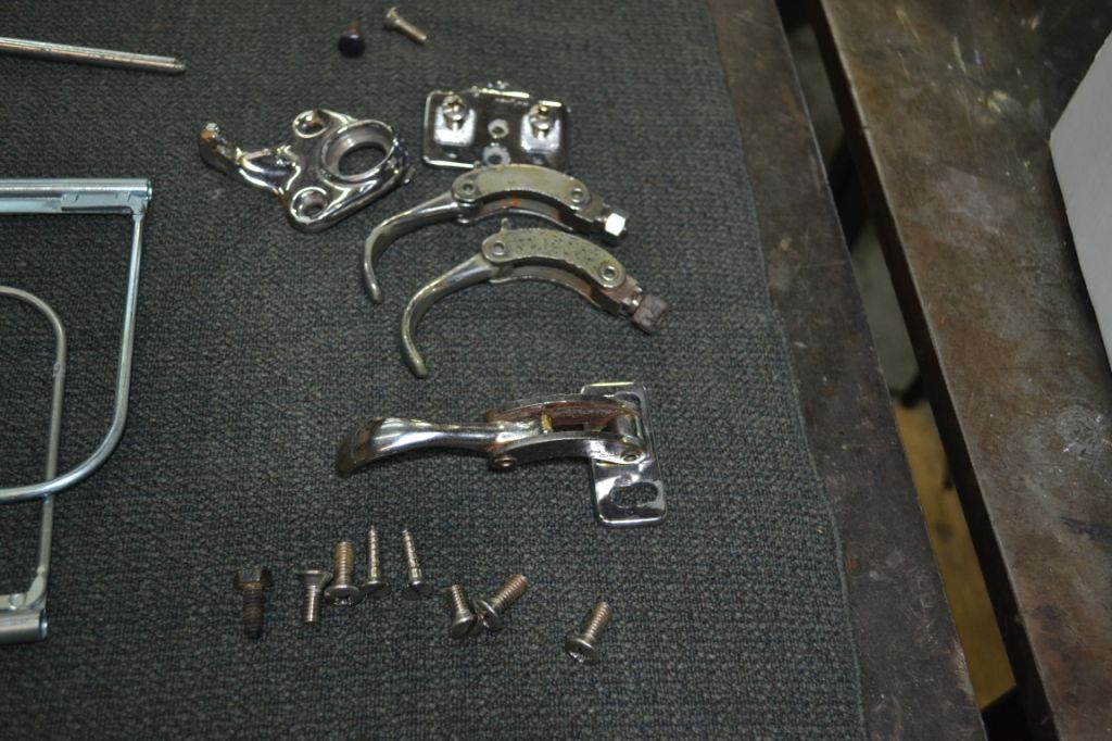

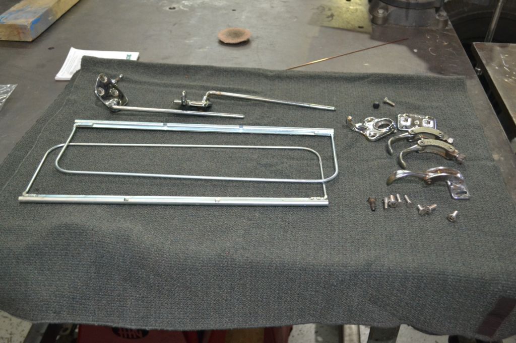

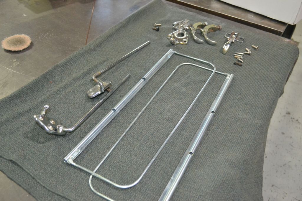

    EDIT*...Jim at Hot Rod Garage sent me these pics of everything he has and says he'll take $300 for all + shipping...call HIM at 918-241-6333 and do the deal direct with them...they're good people.
    Top Latch hardware and 2 sunvisors...package deal

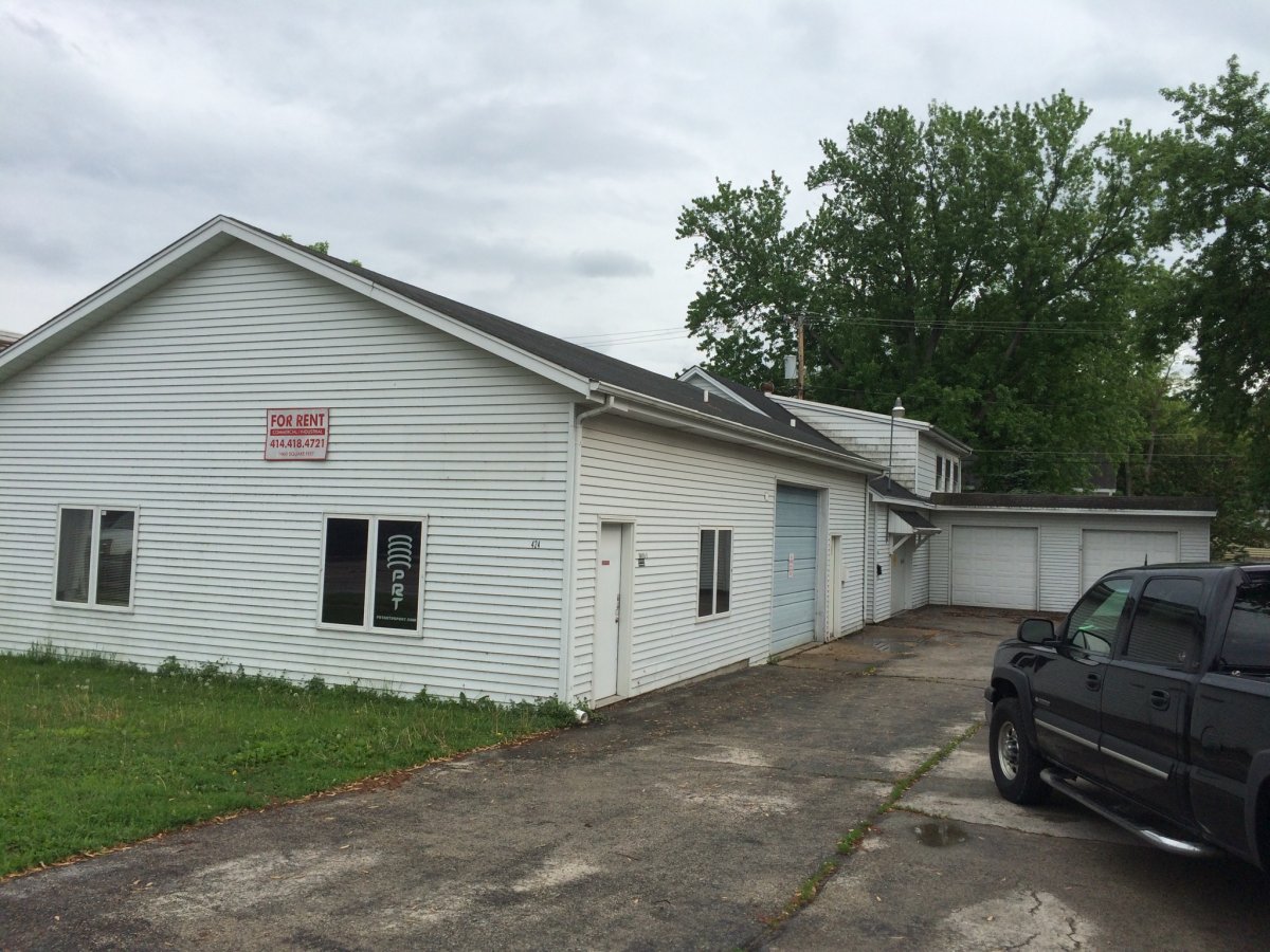

    We've moved and in a few weeks I will have a new shop about 10 mins from the house (and on my way to work).

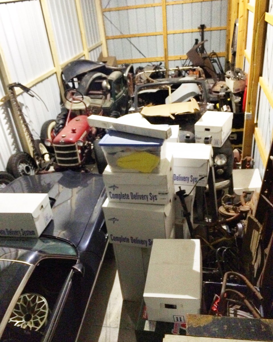

    My projects and parts have been stuffed in here since March.
    The 48 is in there somewhere.

    The entire place will be mine, more than I need at the moment, so I am going to lease a section out.

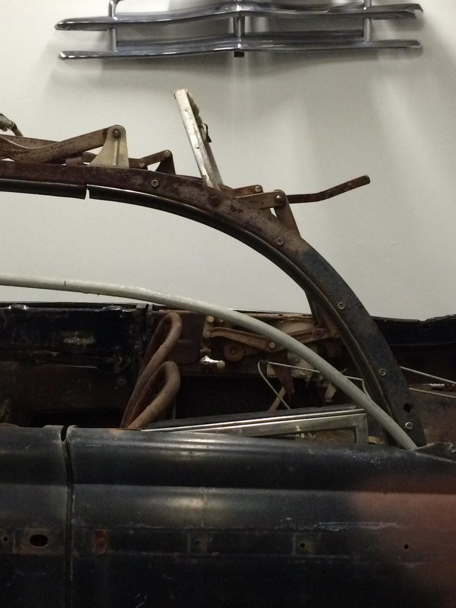

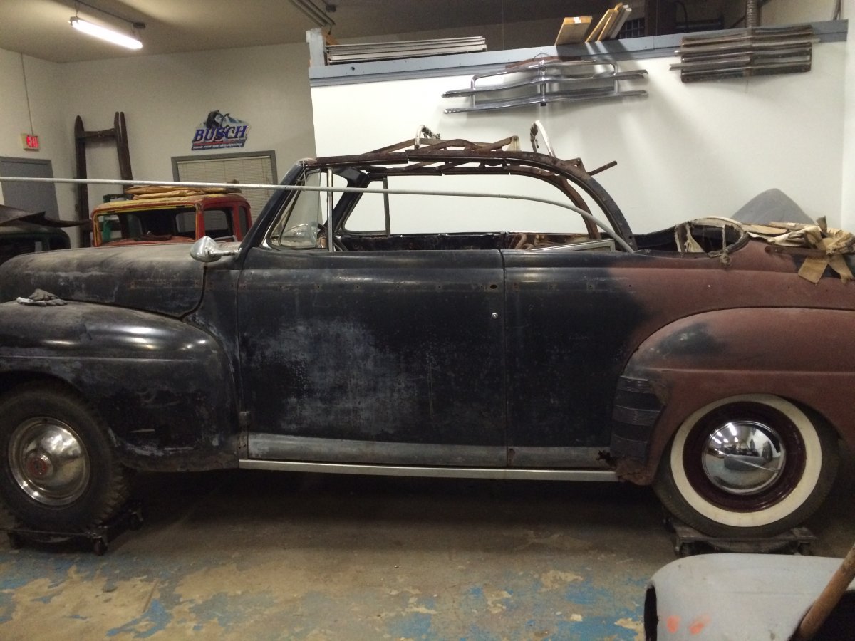

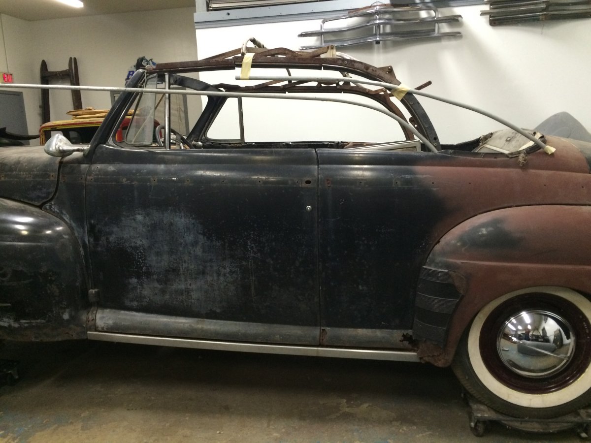

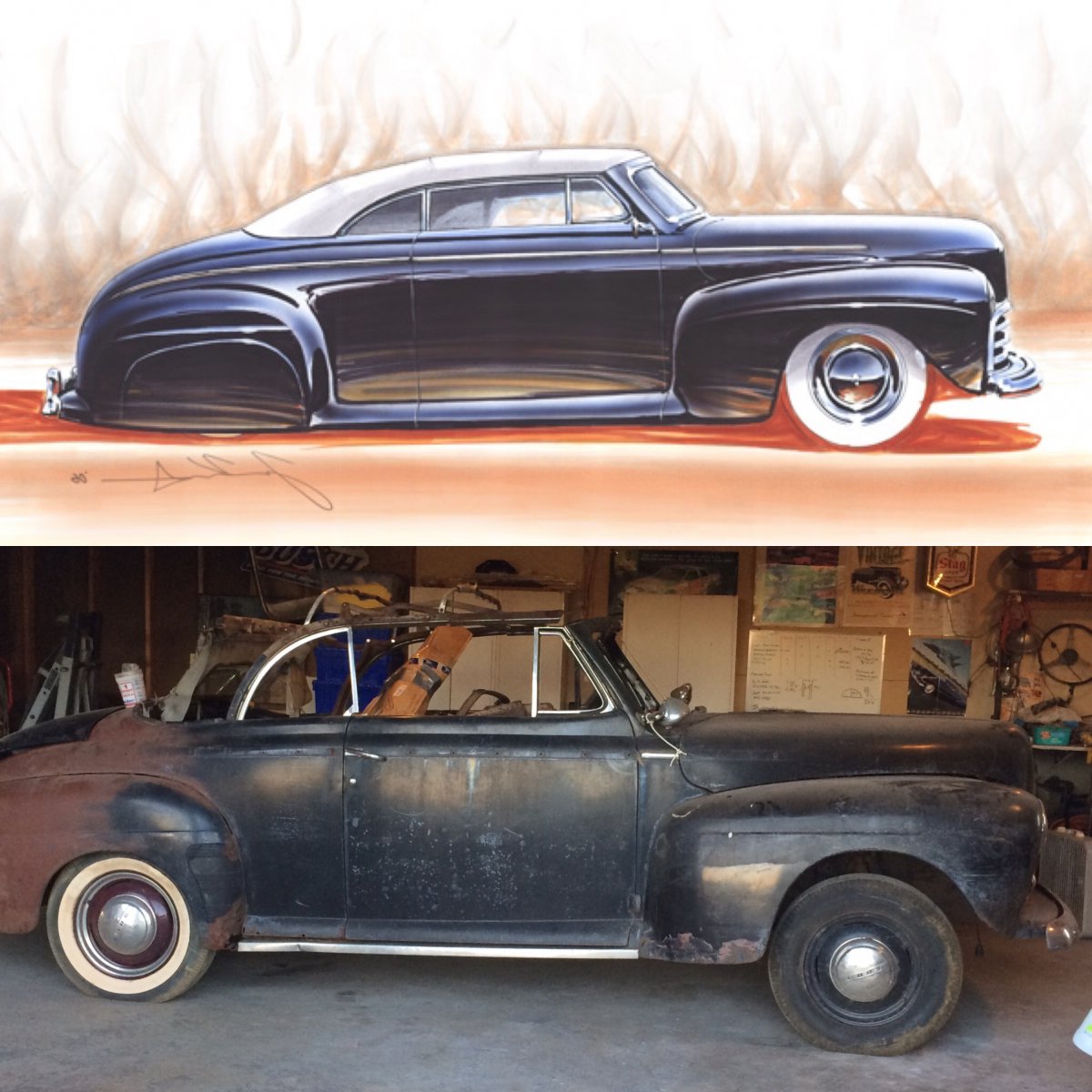

    I actually got to spend some time in the shop today. I need to reset my priorities. I've been messing around with my new 32 coupe. But I want to work on this old ragtop girl.
    I don't like most chops I see. Most keep the original radius of the rear window and just lower it. It doesn't seem to flow well.
    This is my goal.

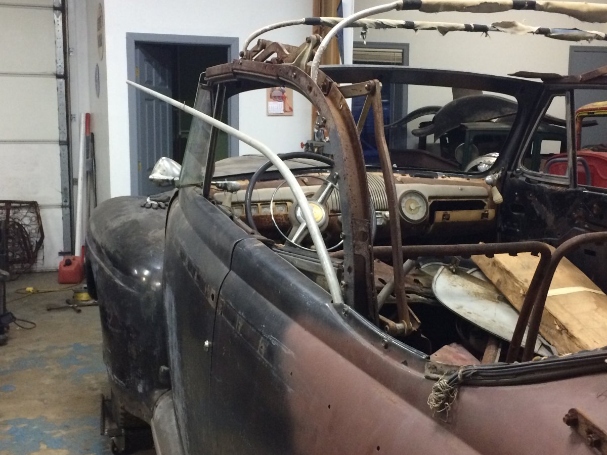

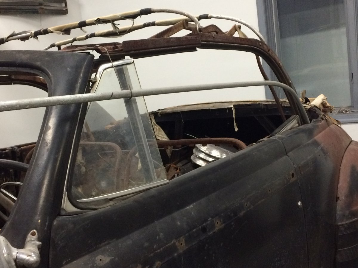

    Today I started planning my chop. I made a mock-up guide that I will use to align my chop to. It's a bit crude, but you get the picture.
    It's 4" at the windshield and 5.5" at the front of the rear window.
    If anyone has done this and kept a folding top and have pointers, let me know.

    Looks cool is the top going to operate?
  21. T&A Flathead
    Joined: Apr 28, 2007
    Posts: 1,986
    T&A Flathead
    Yes. I have some work to do to make sure the top folds. I think the links will fold, but concerned once the material is on. Also need to make sure the rear window can roll down.

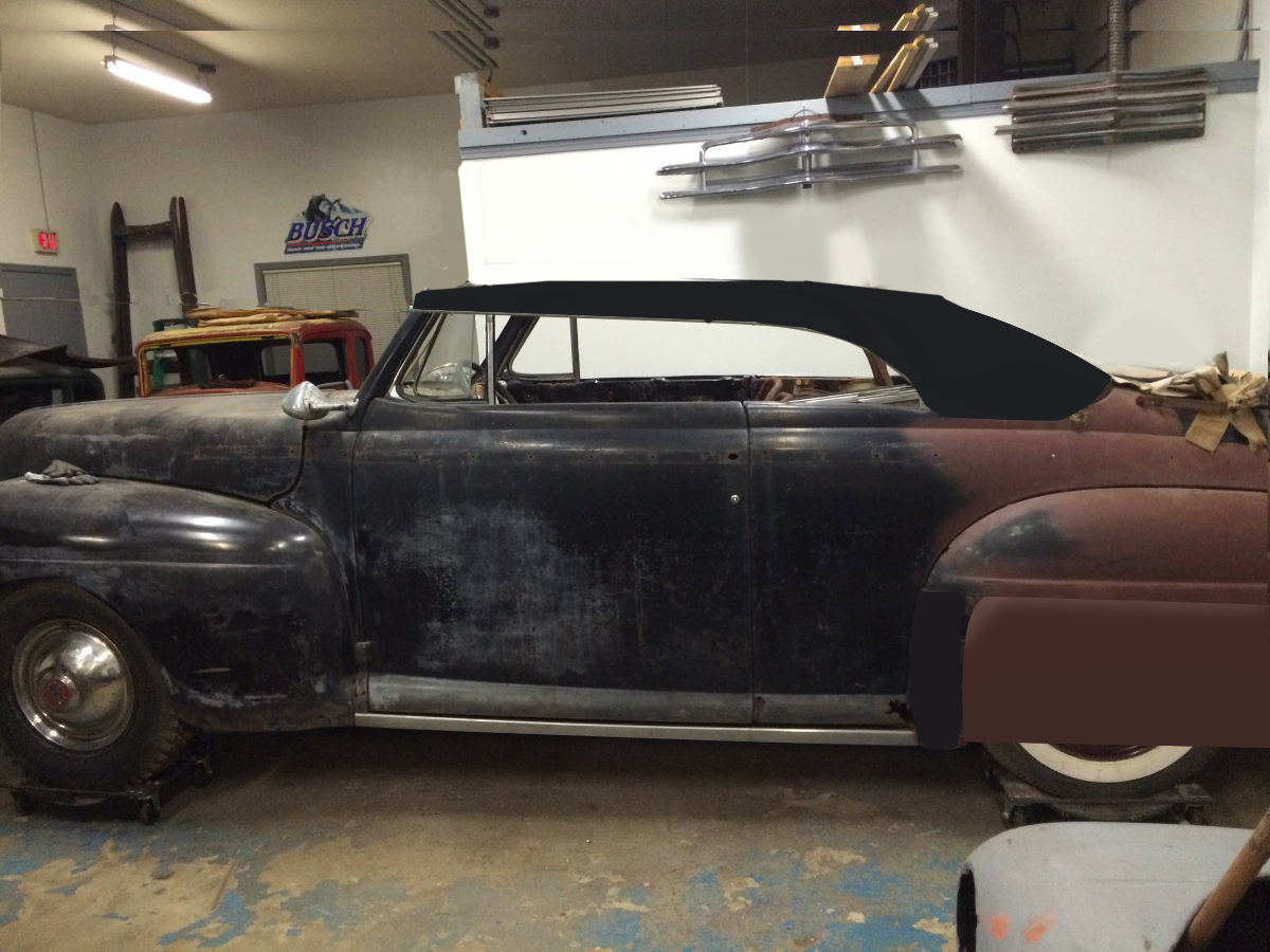

    Just my opinion: I think the rearward slant of the window tops is a little too "new millenium". Can you make the door's window a bit more parallel top-to-bottom than your EMT shows? That would give it a bit more cl***ic look. Your illustration has more parallelism and looks great. A nice flow but still traditional.
    Now, getting all that to fold is sure to be a trick though. :)
    Atwater Mike and Chris like this.

    I agree that top looks like it's going uphill. I would try to make it more level.
