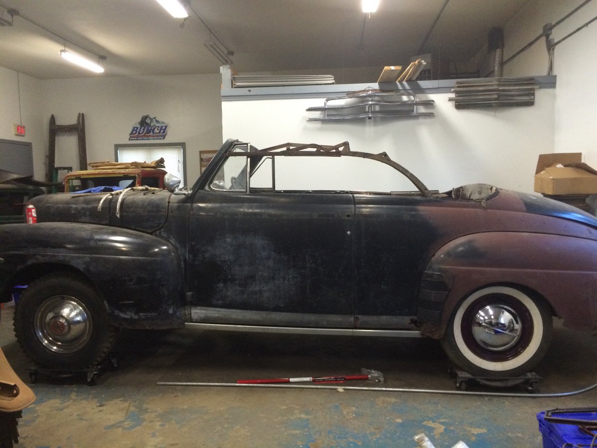

    Here, I straightened the car out.

    Madfish, put a more gradual slope in the quarter window, more like the original illustration in post 49. And can you turn the top white? It will make a huge difference in the "look".

    Chris and Alchemy, I see you points. Although the illustration is slightly going up hill to the windshield, I went too much.
    I agree based off of photos I've found parallel will be more trad.
    Madfish, can you change the curve of the rear window to begin at the very front of the window? The rear quarter window should be one large radius.

    I think the illustration appears like it is going uphill because the side window frame is slightly crowned. But a rule of thumb is tops should never run uphill...it's gotta "flow"

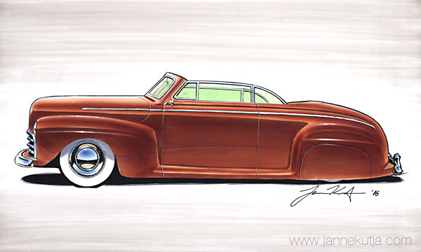

  7. K13
    Joined: May 29, 2006
    Posts: 9,733
    K13
    I agree with Chris and Alchemy. Here is another of Janne's illustrations without the top but with the windows up. You can see the door window frame is pretty parallel with the top of the door and just slightly starts to taper down towards the very end of the frame.
    T&A Flathead likes this.

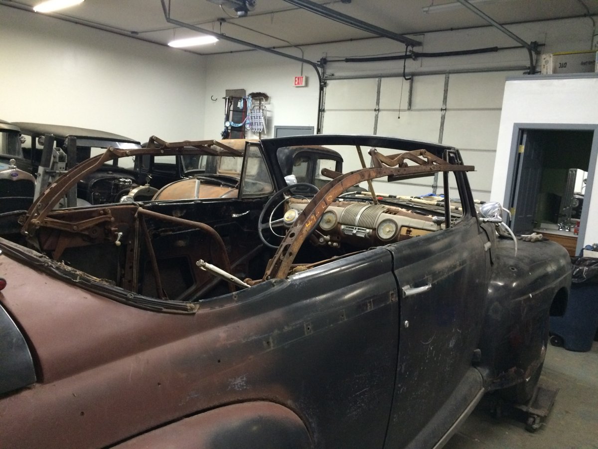

  11. T&A Flathead
    Joined: Apr 28, 2007
    Posts: 1,986
    T&A Flathead

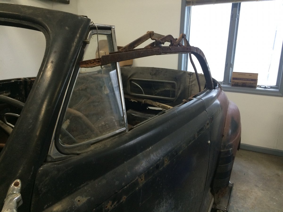

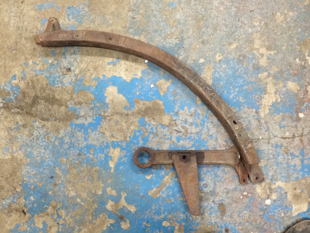

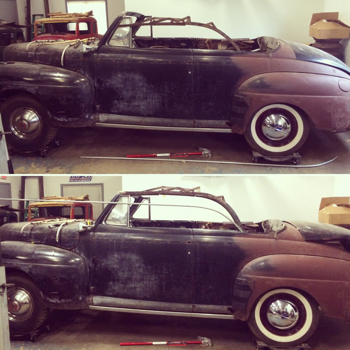

    Spent more time with the ragtop today. Studying, planning, scratching my head, more studying....
    I made some adjustments to my conduit pattern. Used all the good feedback. I'm happy with it.
    My plan for the chop is to separate the bow above the rear window from the pivot arm, rotate it forward, and then re-arch the channel by making 4 cuts.
    Based on the patterns I made, the bows should still fold as designed.

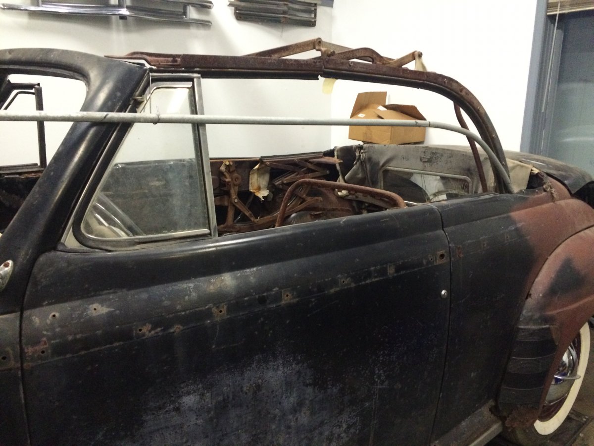

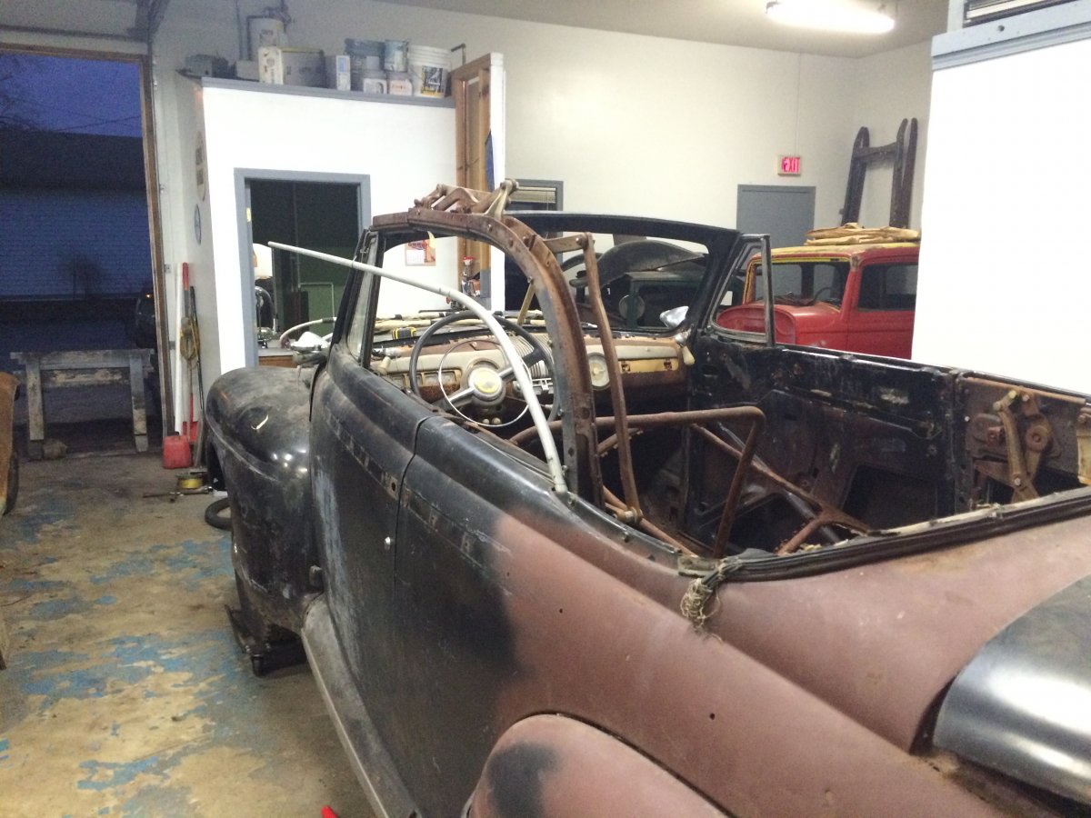

  17. T&A Flathead
    Posts: 1,986
    T&A Flathead

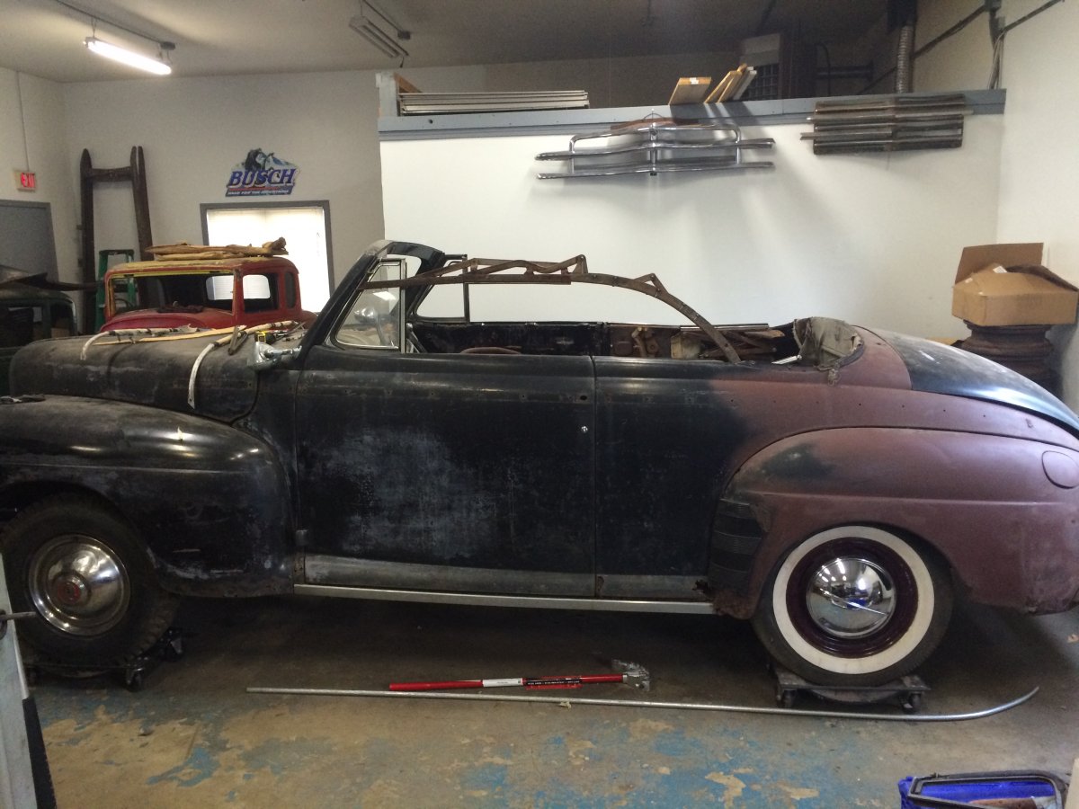

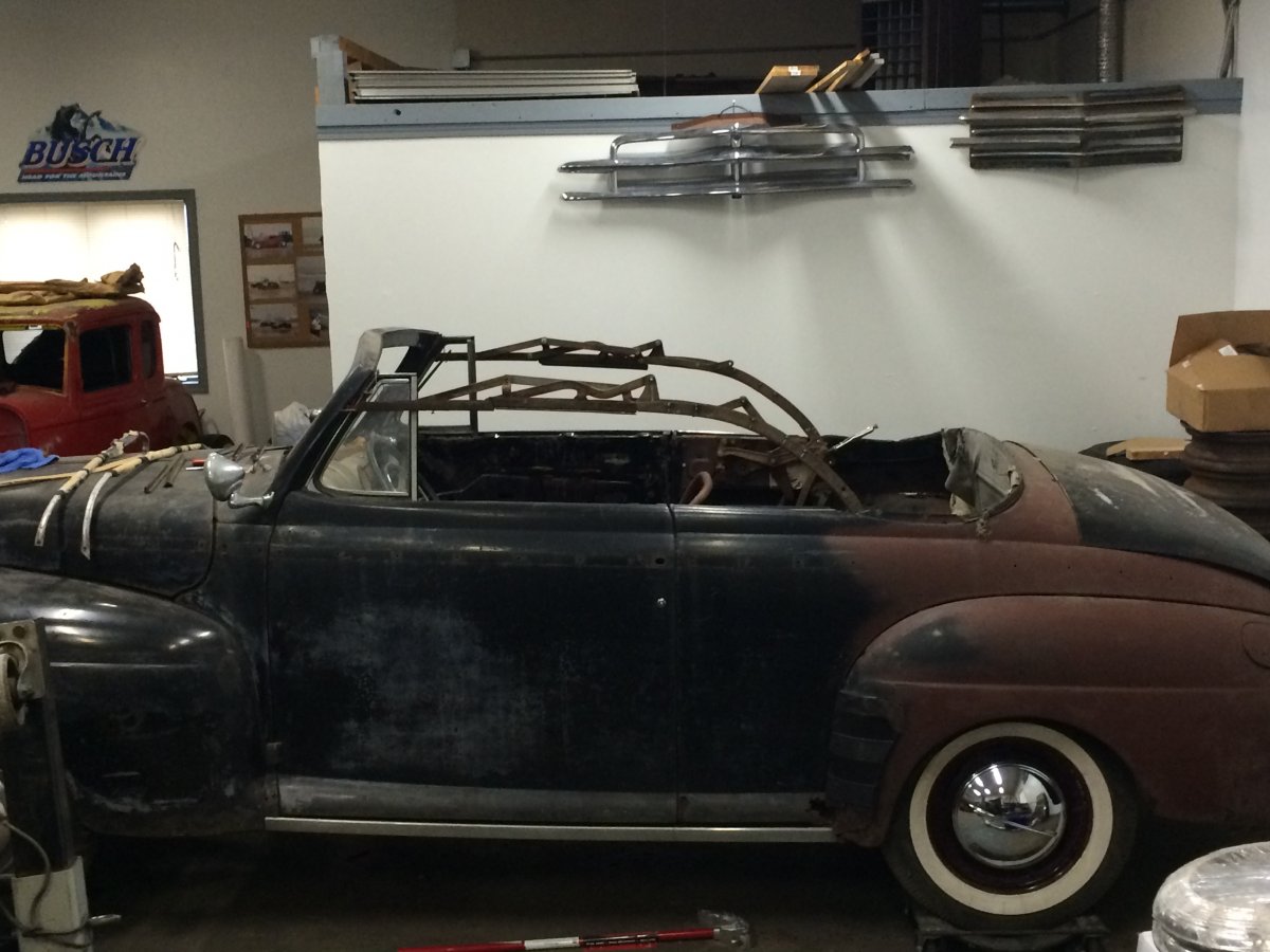

    Some real progress today.
    4" chop, re-shaped the rear bow channel, and it still folds. More adjustments are needed to get the front bow to align properly. I've only re-shaped the left side, so on to the right, then the windshield.
    This one shows the comparison to stock.
    I'm pretty happy with it.

    I think you're right on the money! 3" chop on the Buick. I'm a less is more kind of guy on chops!

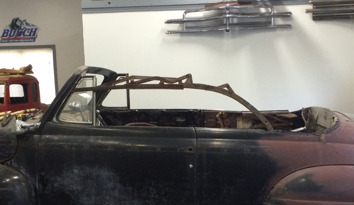

  22. T&A Flathead
    Posts: 1,986
    T&A Flathead

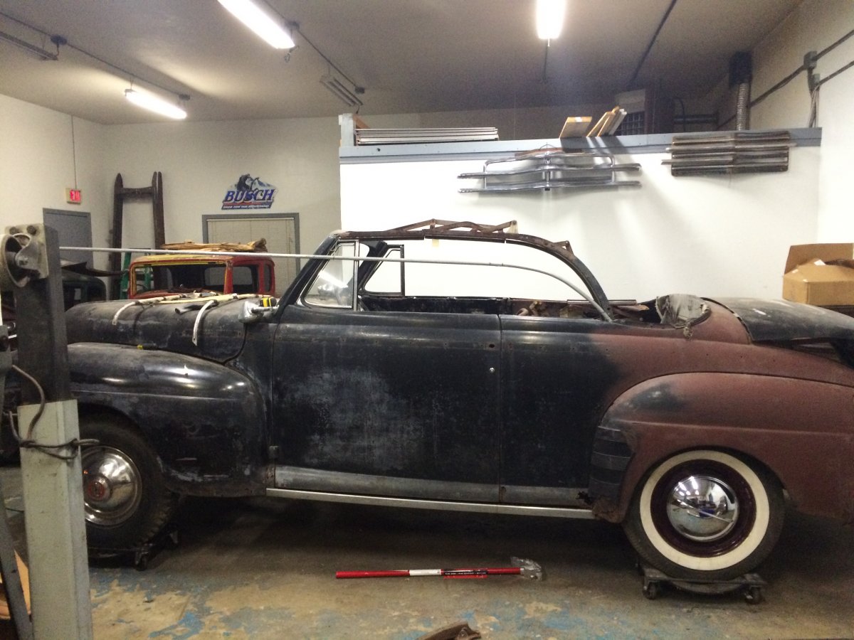

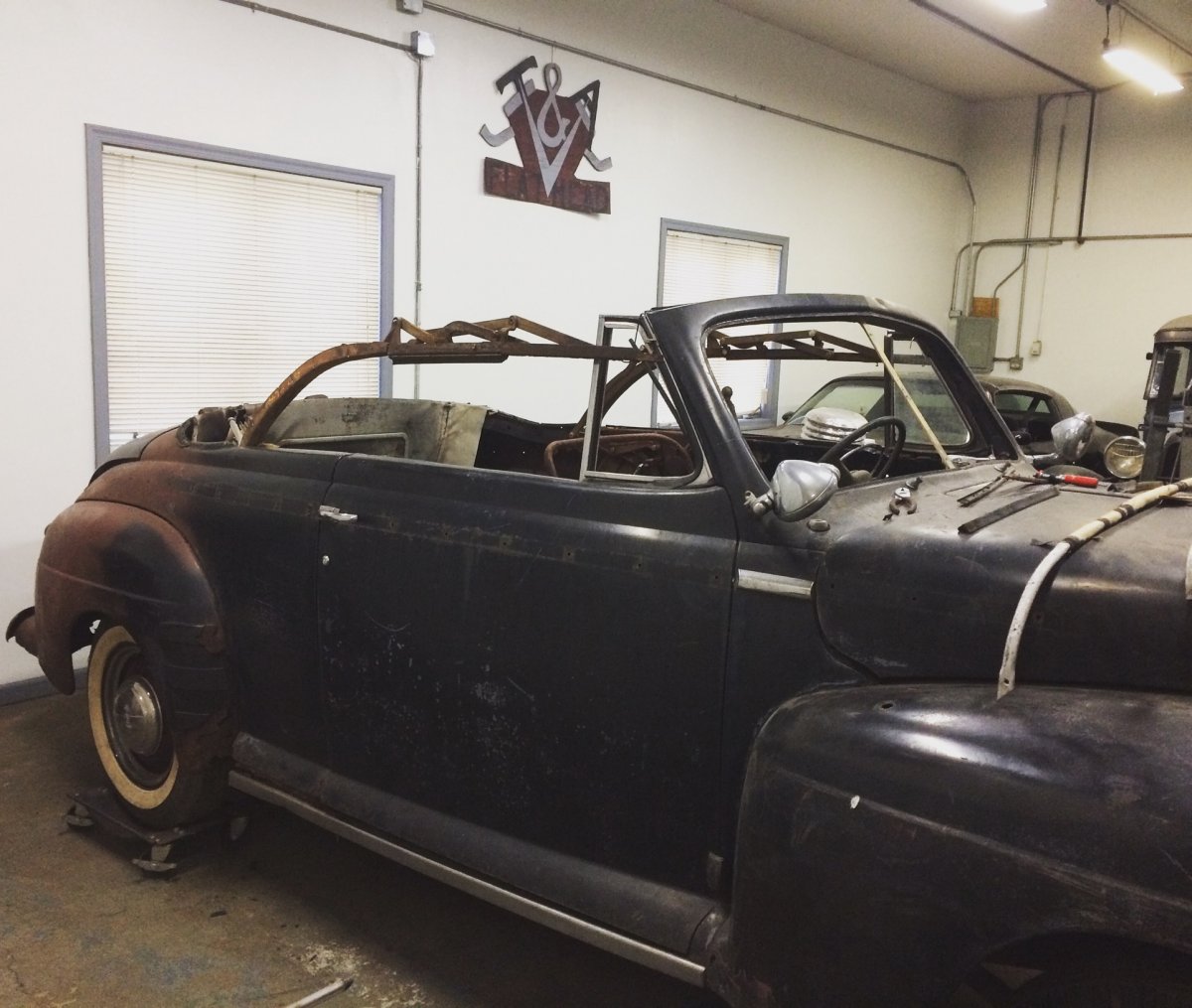

    I haven't been able to spend much more than a few minutes in the shop over the last few weeks. So with the little time I've had, I made a few adjustments on the top irons. The angle of the front section near the windshield is much better. It is giving me the confidence to start chop on the other side.
    What do you think?

    I see that you have the obligatory left front snow tire for authenticity ! Thanks for do***enting this build. I am sure enjoying reading along.
    slimcat7m3 likes this.

    James, that looks fantastic! Especially for us taller folks. I'll be interested in seeing how Tim's chop comes out, as I'm sure it will look incredible too.

    Looks good the straighter line you have with the top rail looks much better than when it was dipping down at the front.
    Atwater Mike likes this.

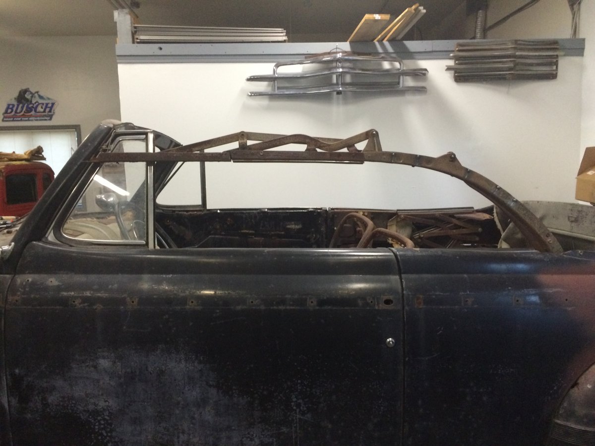

  29. T&A Flathead
    Posts: 1,986
    T&A Flathead

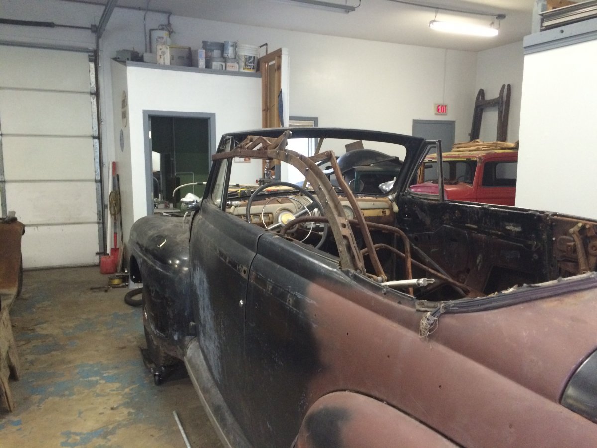

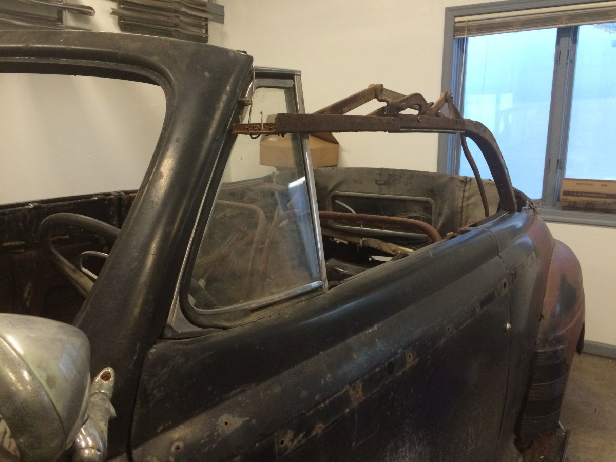

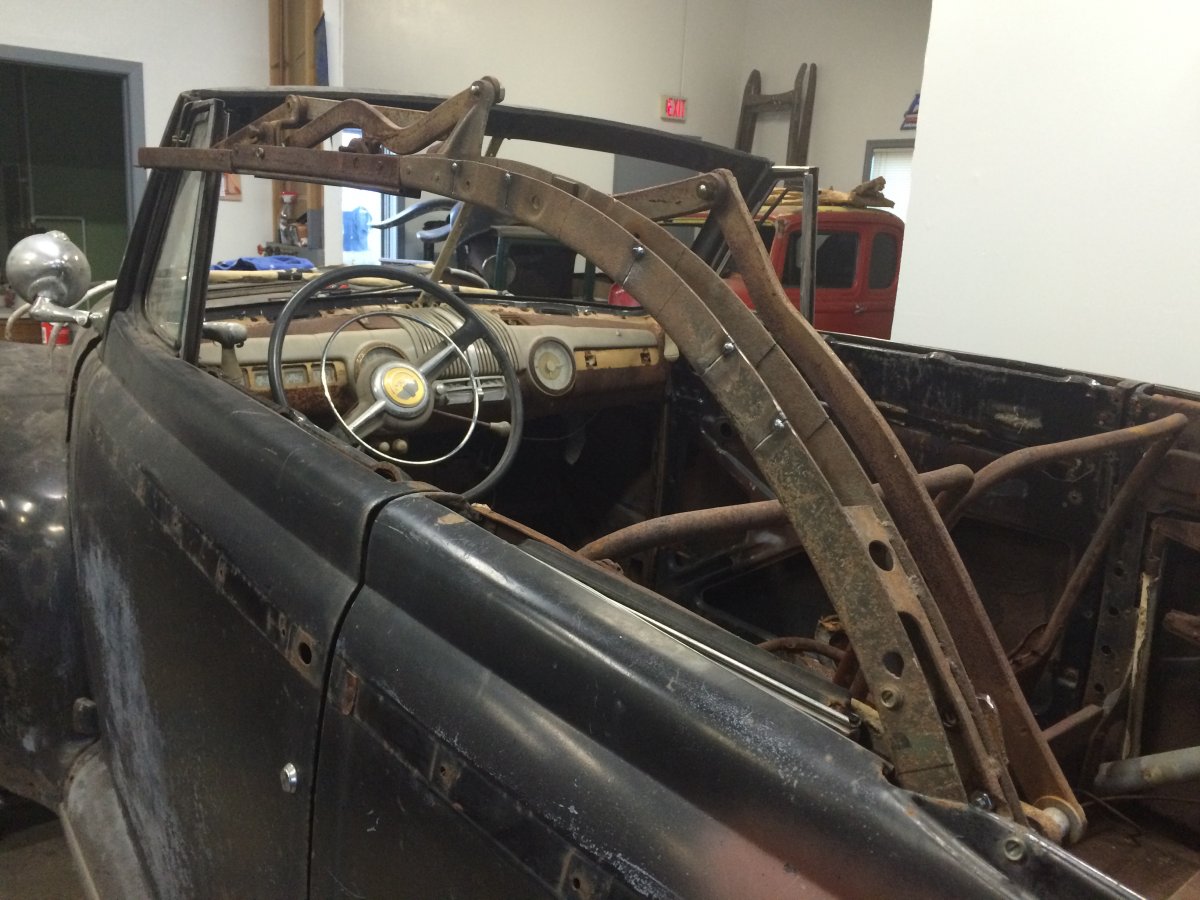

    Finally got in a little shop time today. I was able to get the right side top irons chopped. Both sides are equal and time to move onto the windshield.
