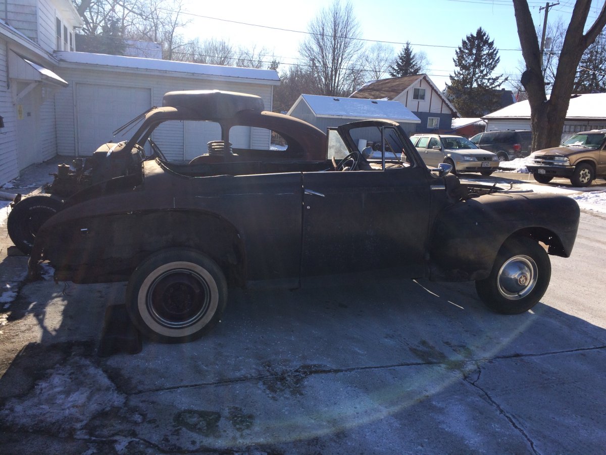

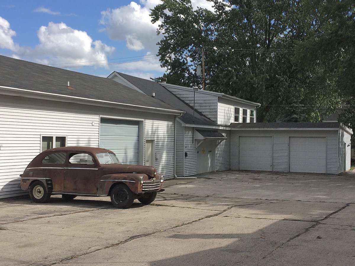

    Not much activity on here lately. I did finally get my parts car up here from Missouri and I've been scoring a few needed parts off eBay and hamb cl***ifieds.
    I will end up using the frame and floor from this car.
    If anyone needs parts from here let me know.

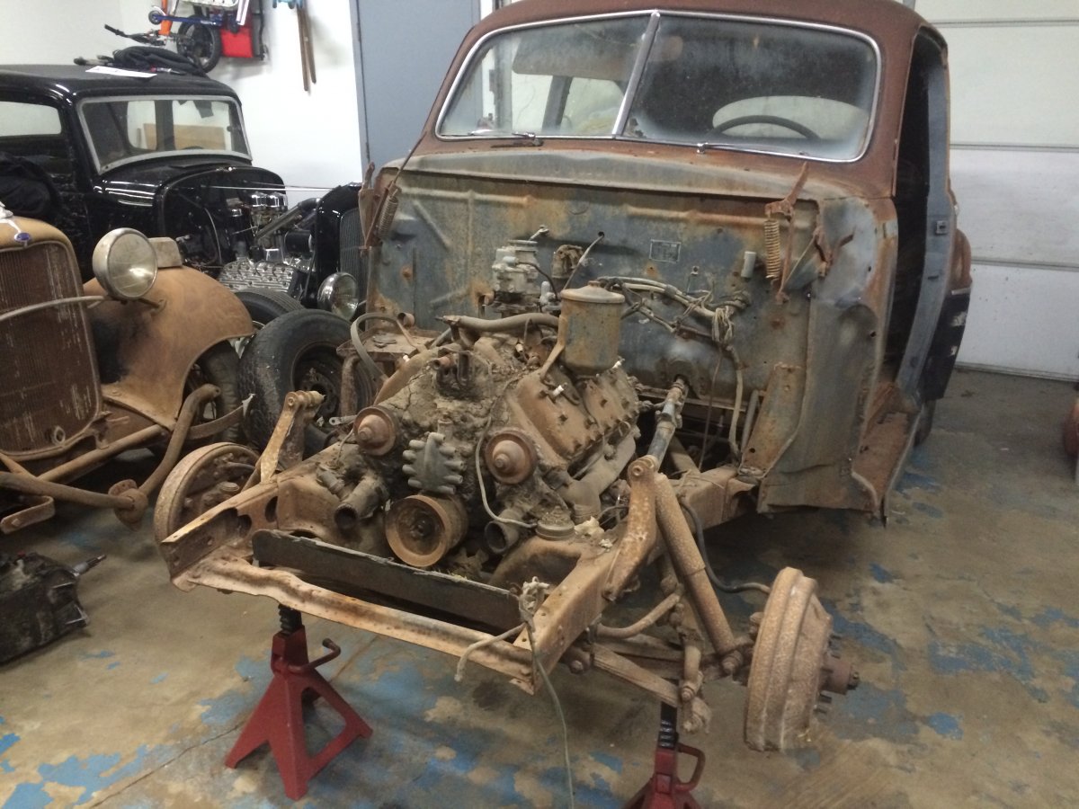

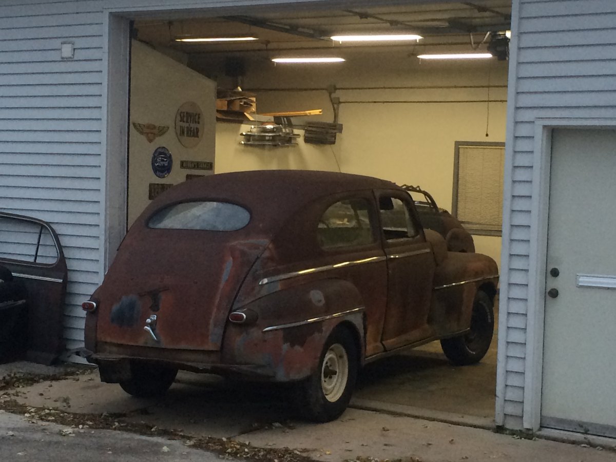

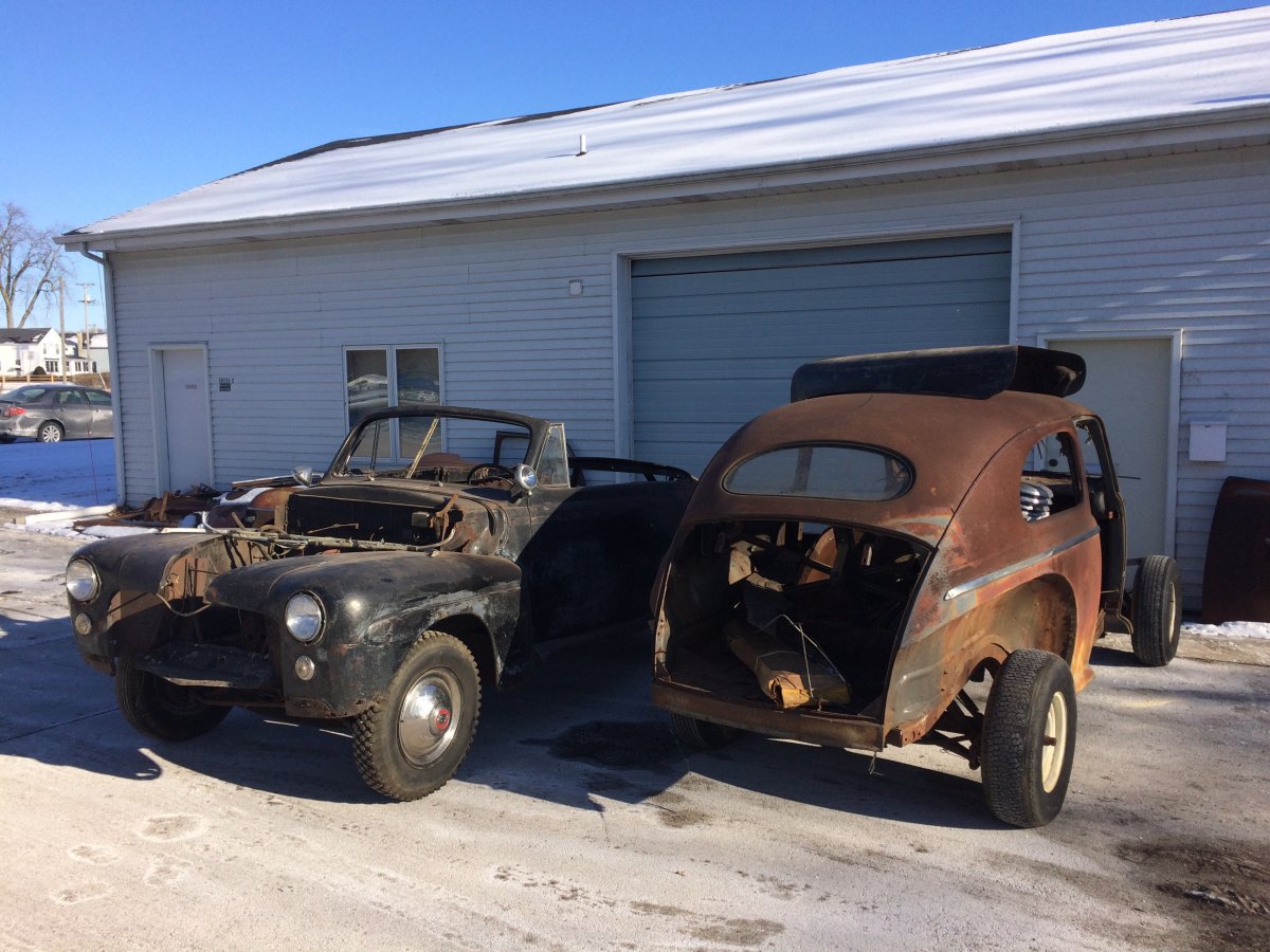

    I actually got a little shop time in. I have started to strip down the Tudor donor car.

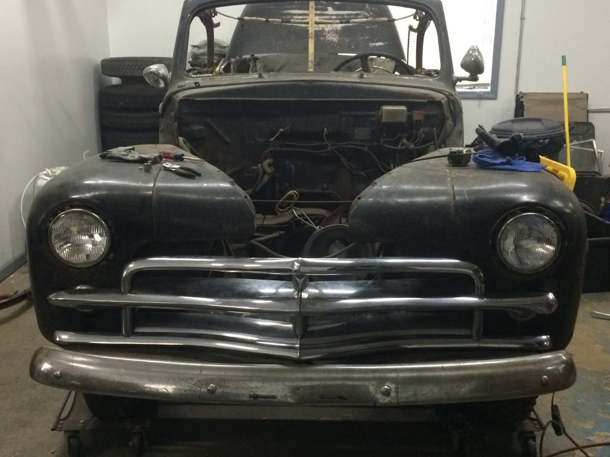

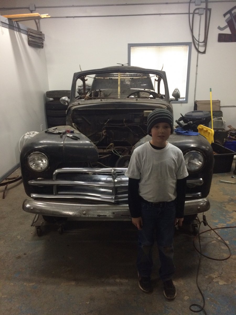

    More parts stripped off the sedan. Trying to figure out the best way to use the floor and quarters.
    Also started removing parts off the convertible. And played around with the 50 Plymouth grill.
    I have good help.
  11. Asphalt Demon
    Joined: Jan 19, 2014
    Posts: 363
    Asphalt Demon
    from Australia
    The grille looks great
  12. Tim
    Joined: Mar 2, 2001
    Posts: 20,429
    Tim
    from KCMO
    Digging the grill. Thinknit might look funny with headlight trim rings but “frenched” looks pretty good from here if I squint a bit

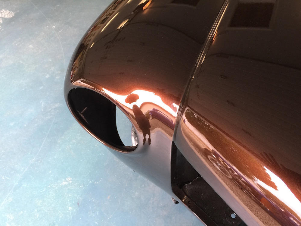

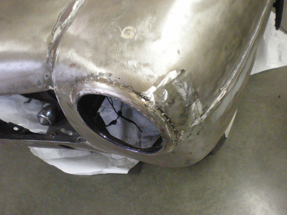

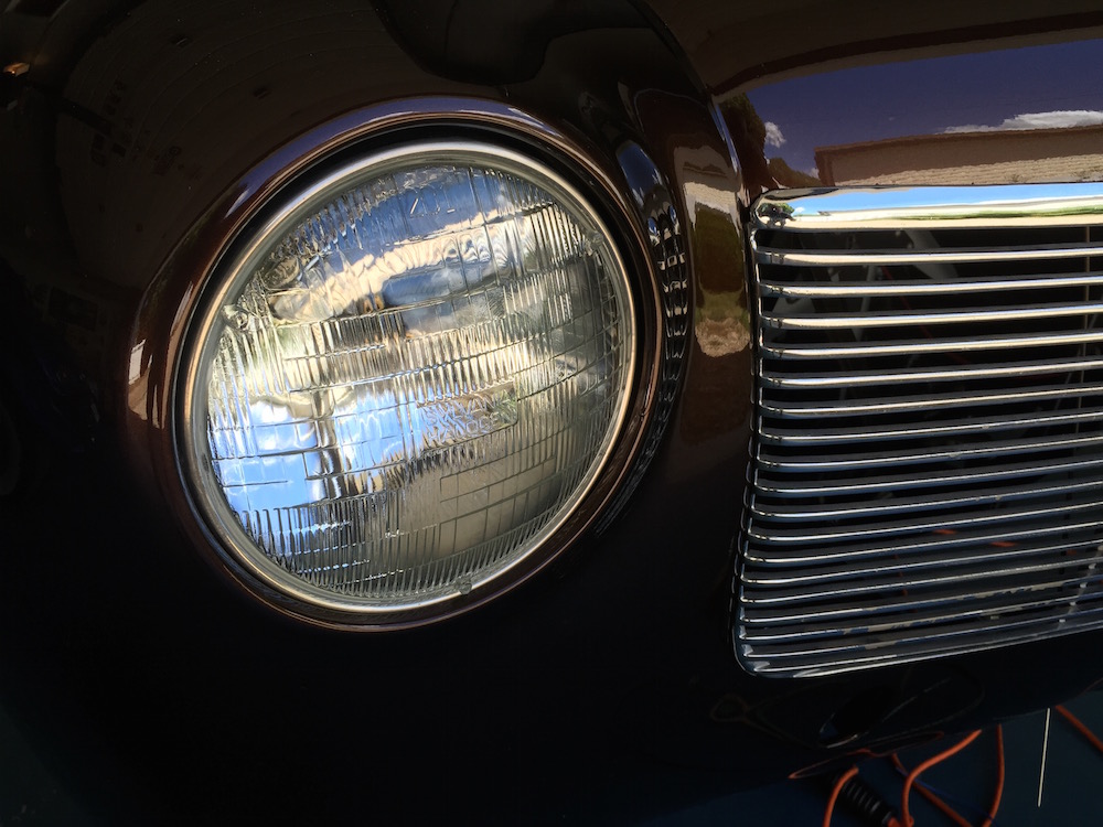

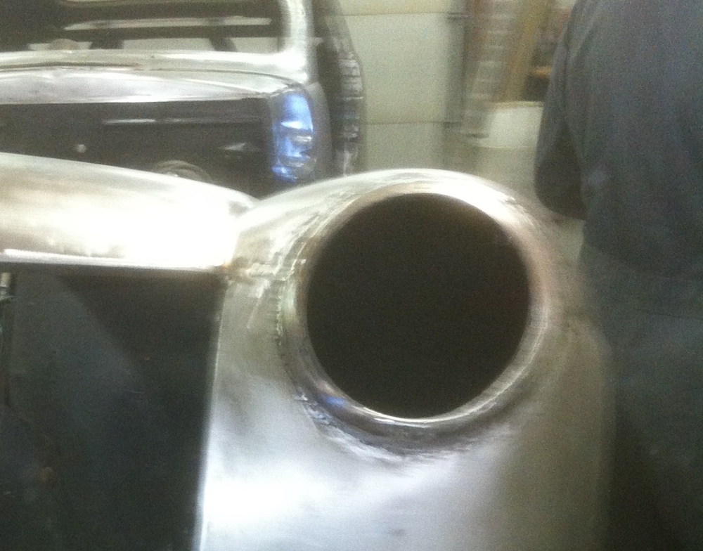

  14. Here's the way mine are done - frenched flush (not "tunnelled")..
    The original bezel is tacked:
    Metal finished with the bucket bolts welded behind for mounting:
    You can partially see the bolts in this shot:
    Lamp ***embly:
    And.. the results (I have seen them done without the stainless ring as well, but this was our way of keeping the bulb in place)!
    Hope that helps a bit!
    Dave
  15. Tim
    Joined: Mar 2, 2001
    Posts: 20,429
    Tim
    from KCMO
    That looks perfect! No weird lip all the way around or 10 foot deep tunnel.
    Leaving the stainless ring on really bumps the quality feel up and lets you have a little bling around the light. Absolutely love it man
    rodncustomdreams likes this.

    Great info and quality work. Thank you for sharing. I like the look with the stainless ring and flush mount. I have never been a fan of the tunneling.

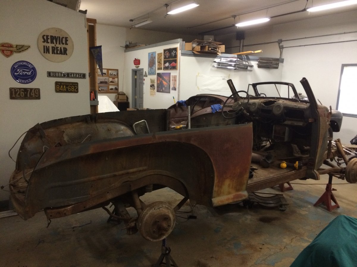

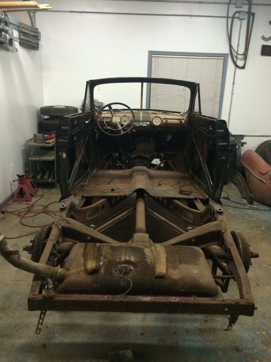

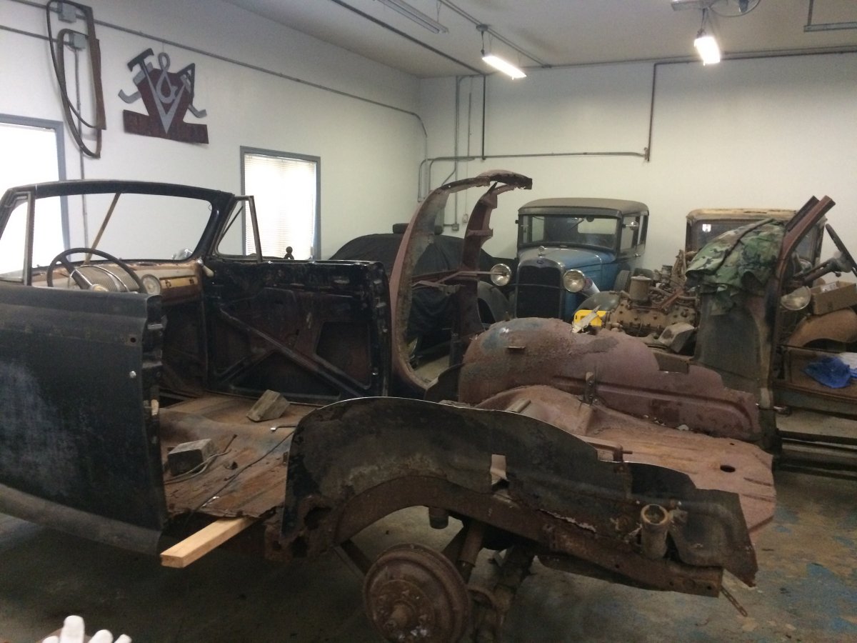

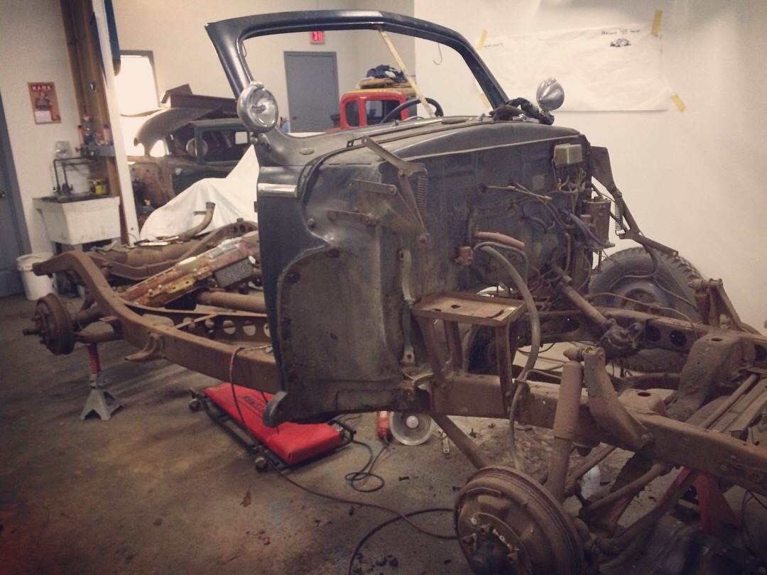

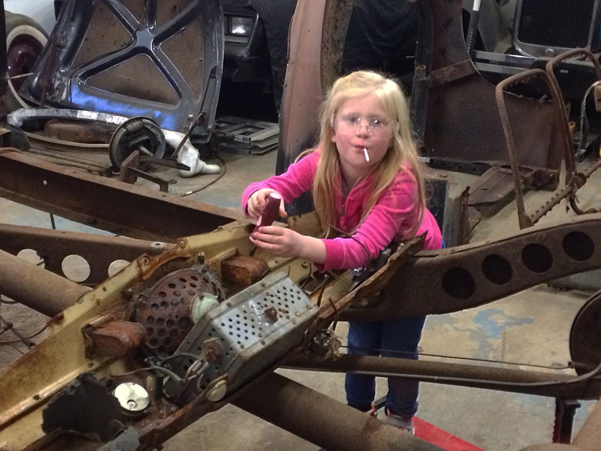

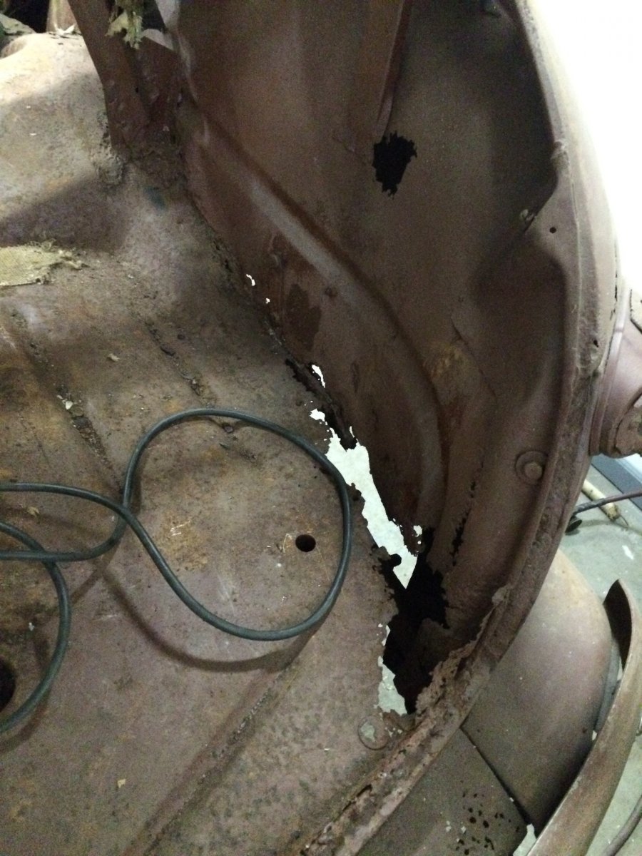

    I have been spending some time at the shop stripping parts and rust off the convertible.
    Then I had to quit, clean the shop, and roll the cars outside to host a cubscouts shop cl***.

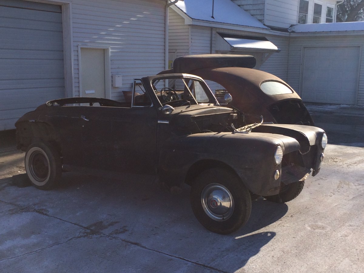

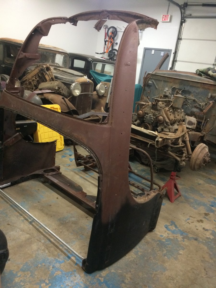

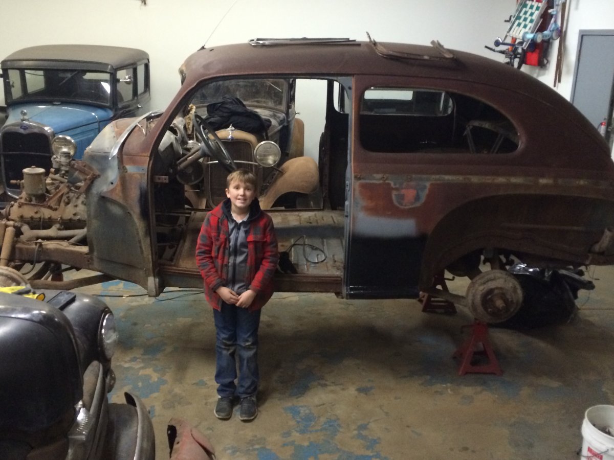

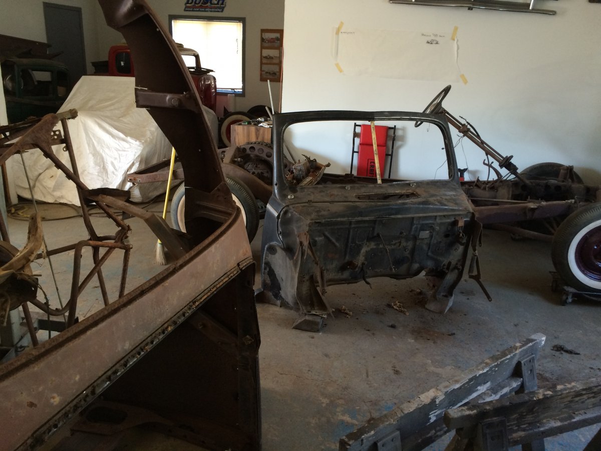

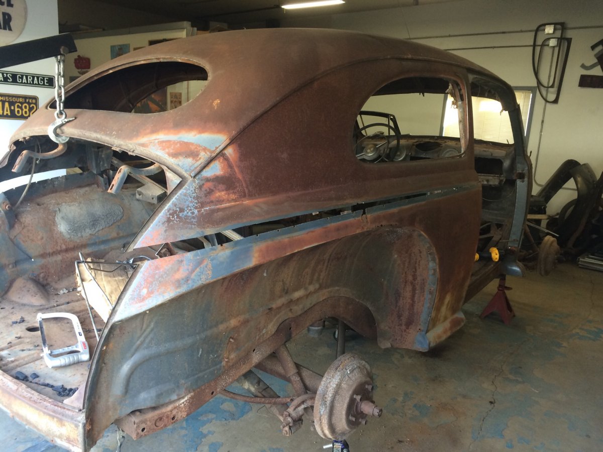

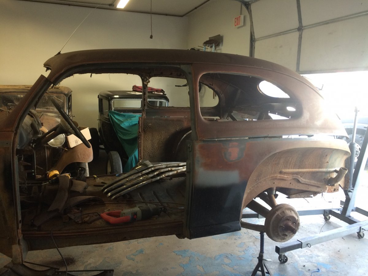

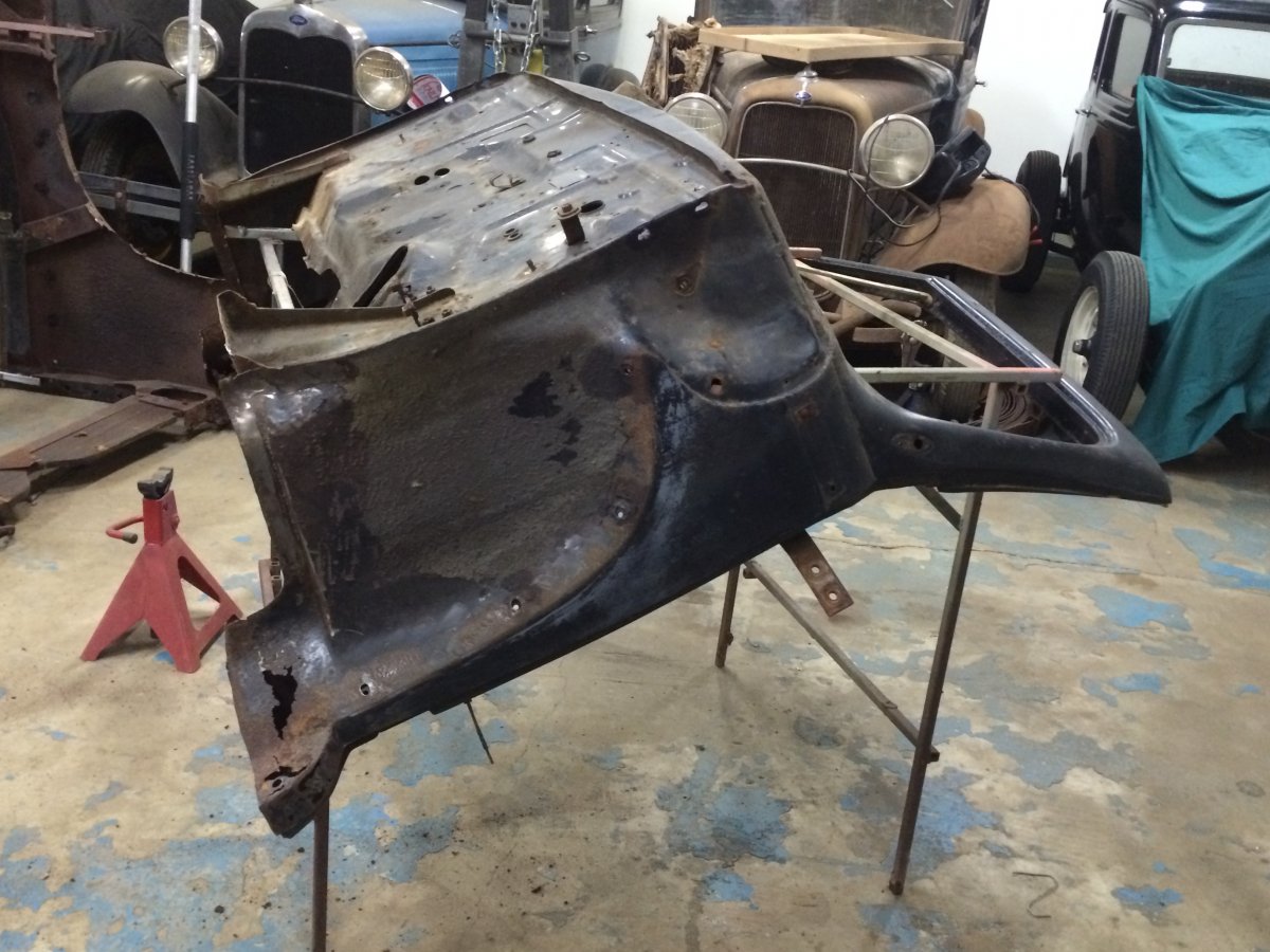

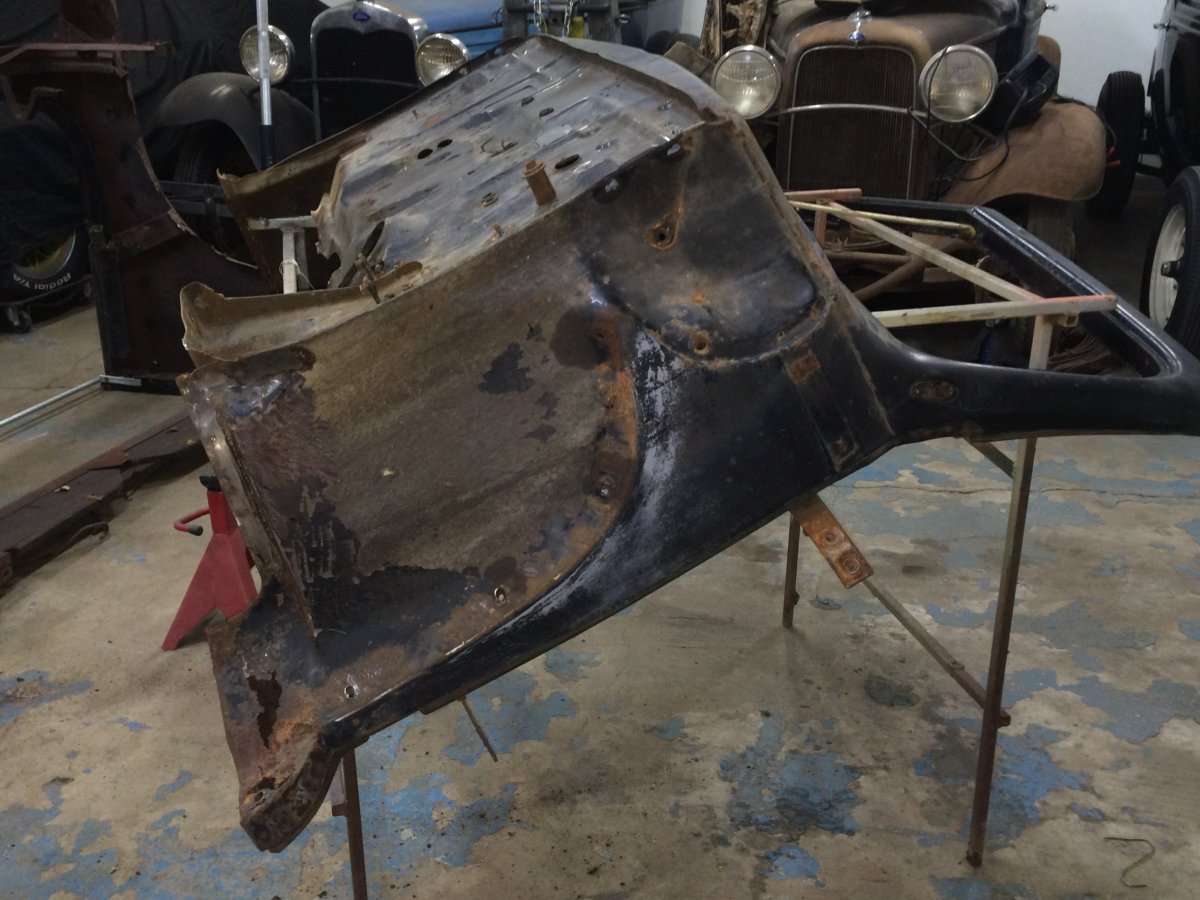

    Today I cut the roof off of the Tudor to get it ready to mate with the convertible. Instead of putting in about 30 patch panels, I'm going to use as much of this Tudor as possible.
  19. T&A Flathead
    Joined: Apr 28, 2007
    Posts: 1,986
    T&A Flathead

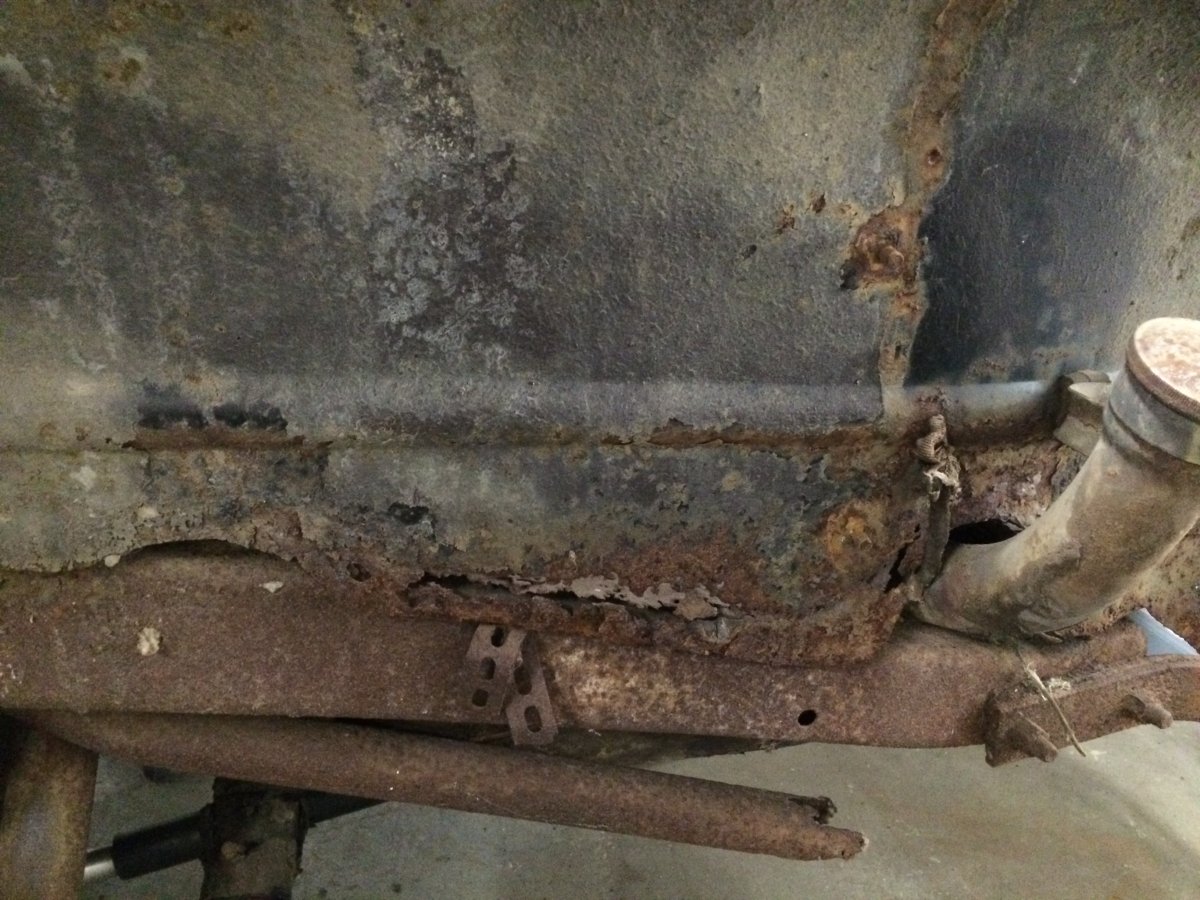

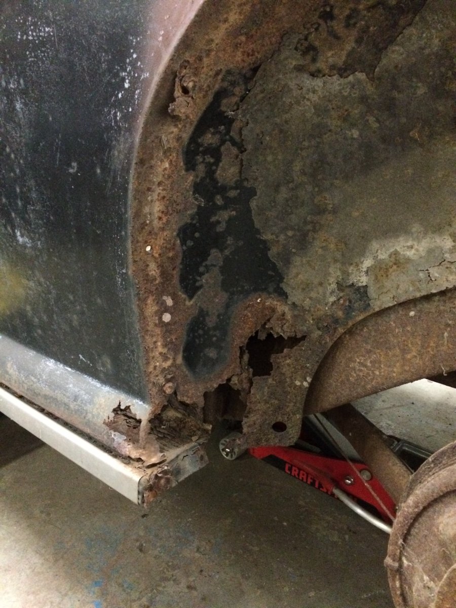

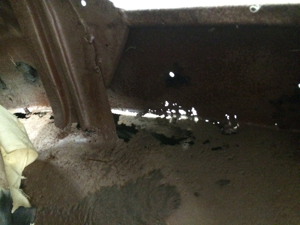

    What have I done, no turning back now. The lower back half of the thing is beyond rusty. Now to get it ready to merge with the Tudor.

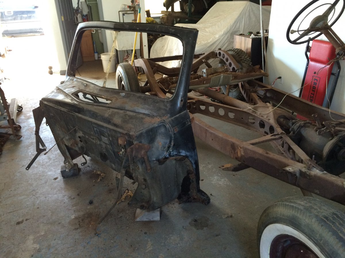

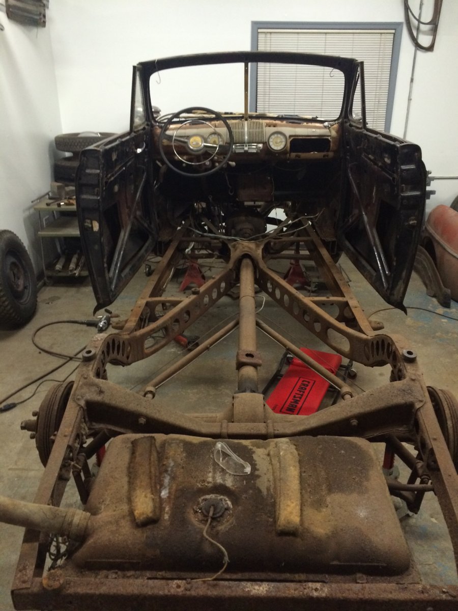

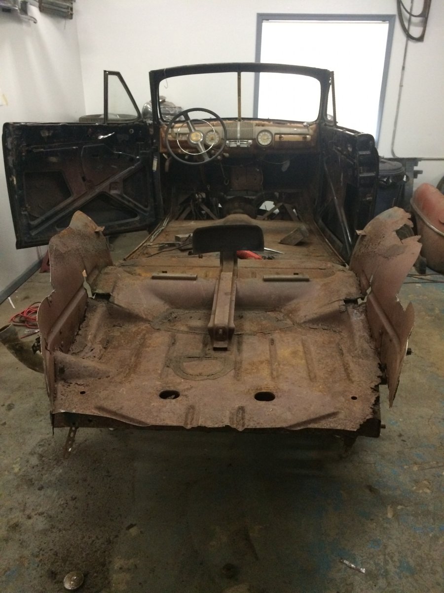

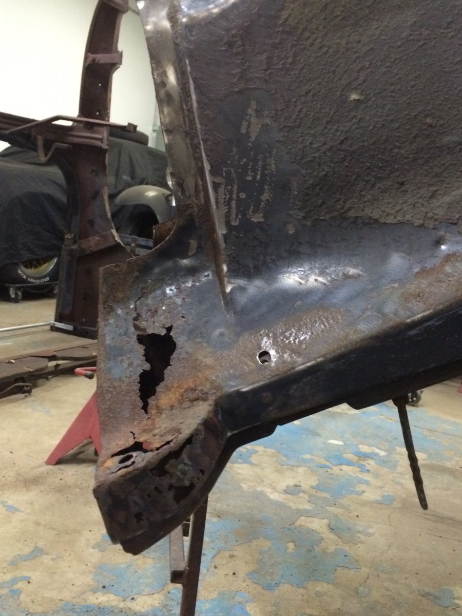

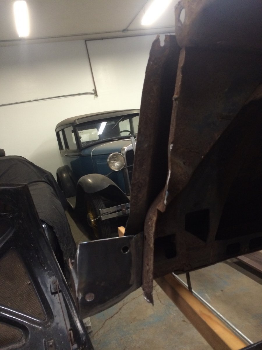

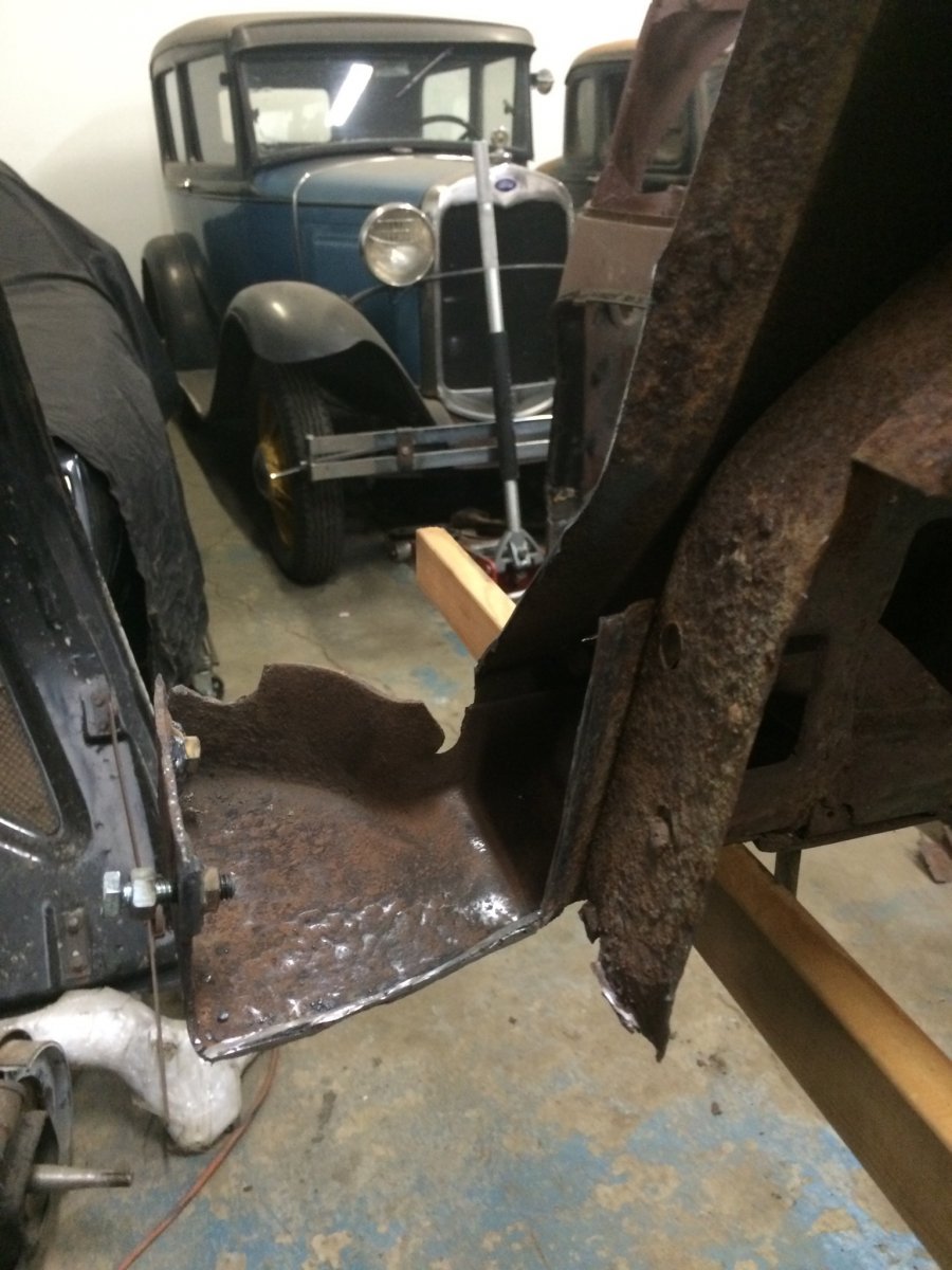

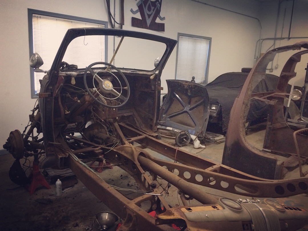

    Finally got the ol' girl stripped as far as she's gonna go. I cut out and removed the rocker boxes in the cowl. The rest of the cowl is pretty decent. New rockers are on their way. I'm ready to start replacing rust with new metal.
    Had some help stripping the dash.

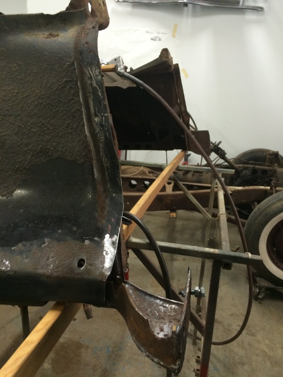

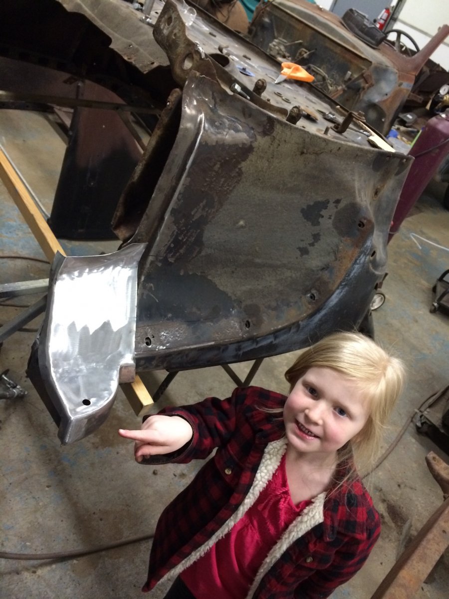

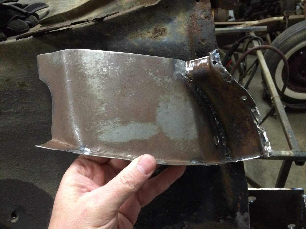

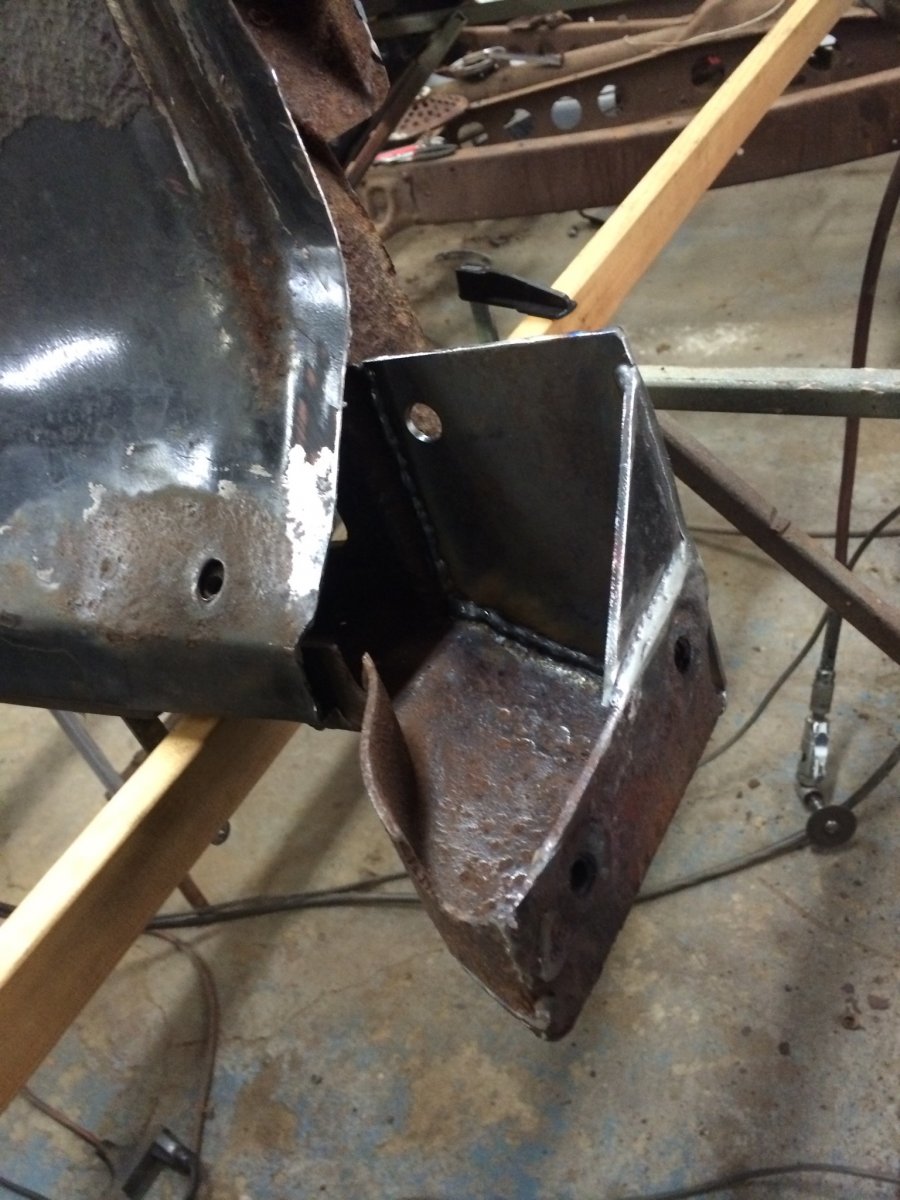

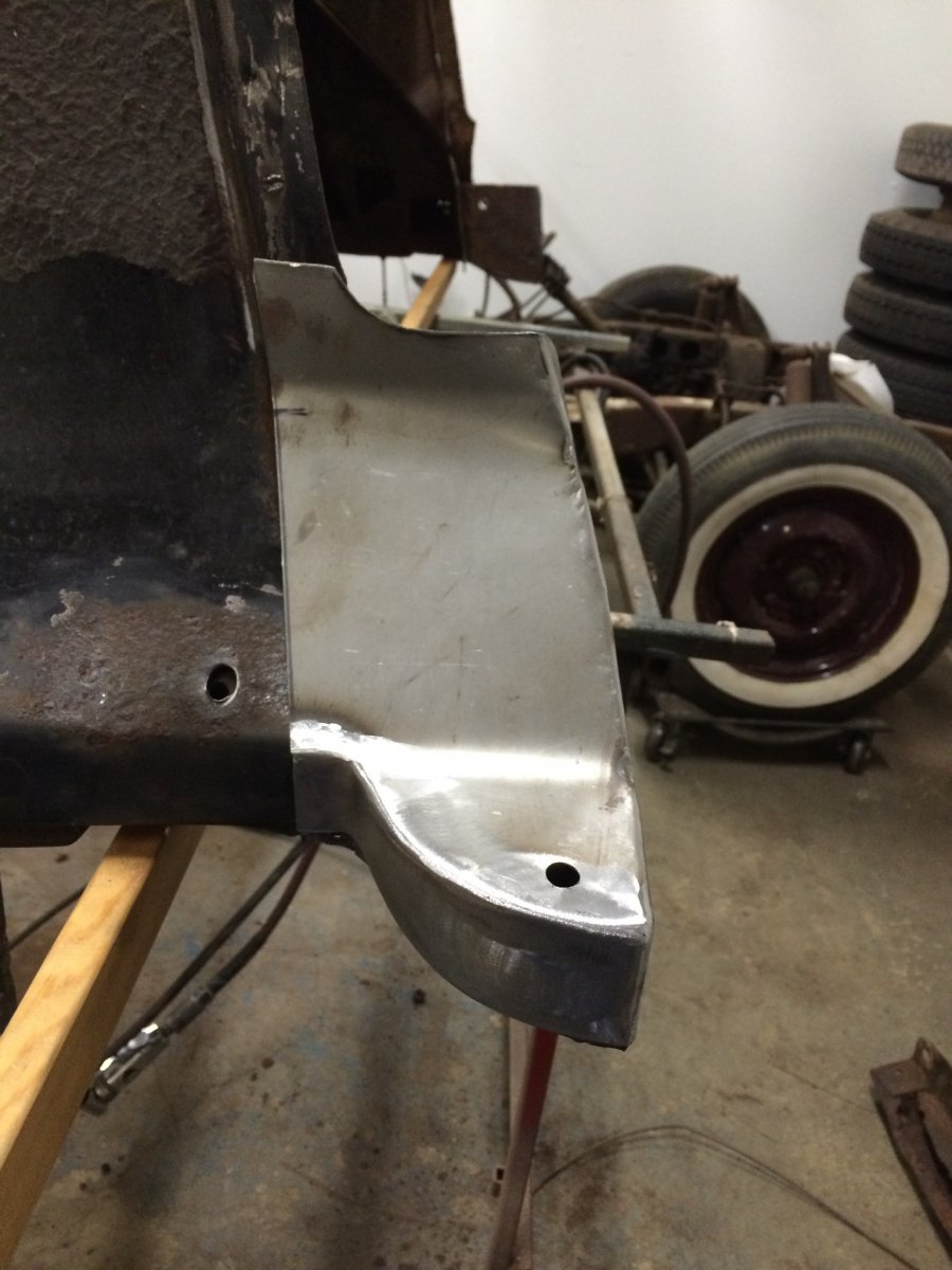

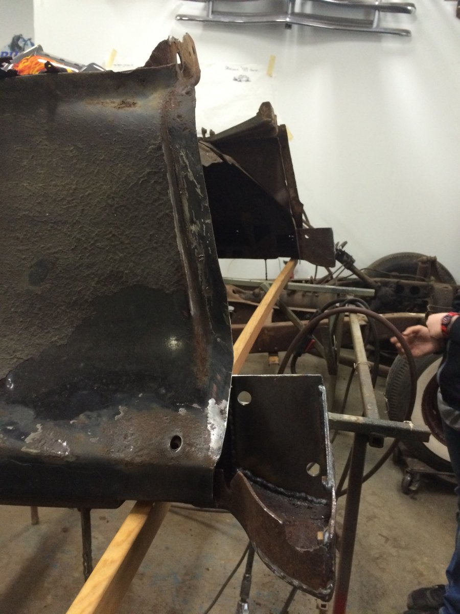

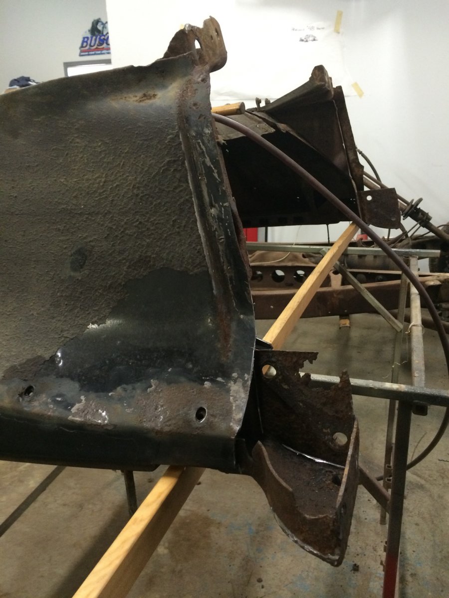

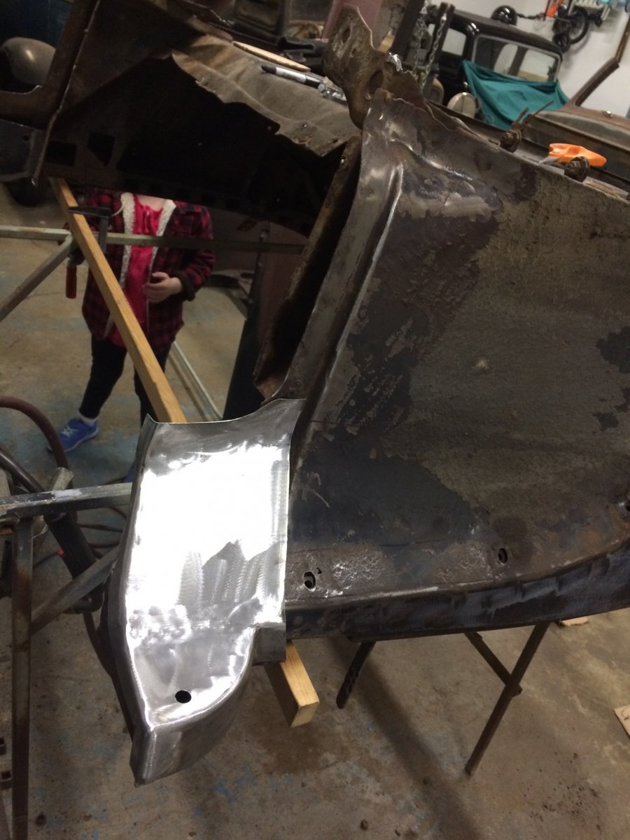

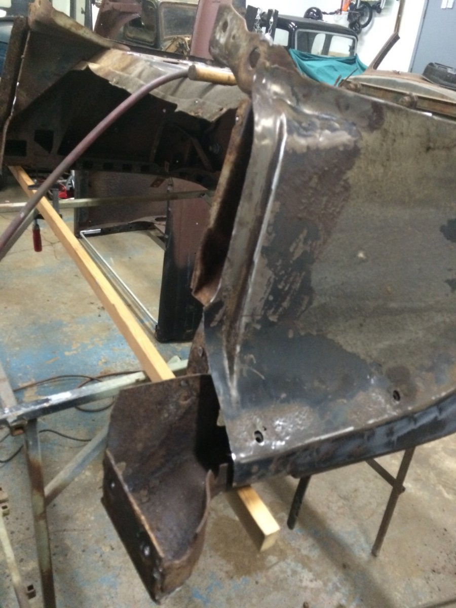

    Rust repair begins. Repairing the cowl structure first. Pretty simple repair. For those that didn't know, the convertible lower cowl and rocker bracing is different than the closed cars. I added a corner brace for strength.
    I also started to make the lower outer cowl patch from parts car. I will install those next along with new rockers.
  25. T&A Flathead
    Posts: 1,986
    T&A Flathead

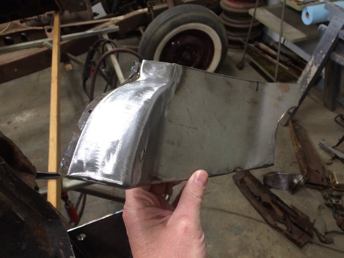

    I had some good help from my neighbor (retired) on making a lower cowl patch panel.
    I cut out the curved piece between the front fender and the door from a parts car and made the rest of the panel from sheet metal. I still need to do final t******* and fitting before welding in.
    I think they turned out pretty good and Natalie approves !
