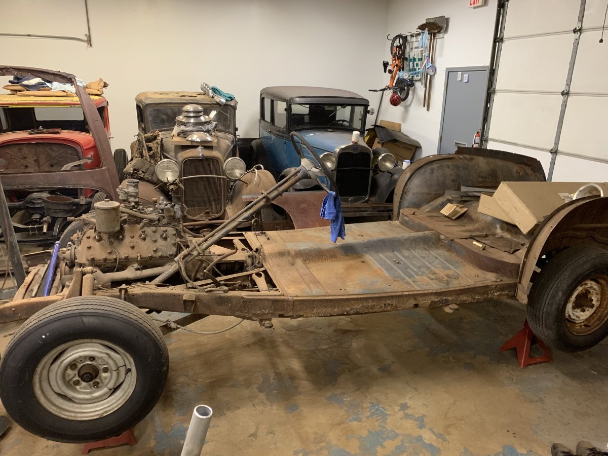

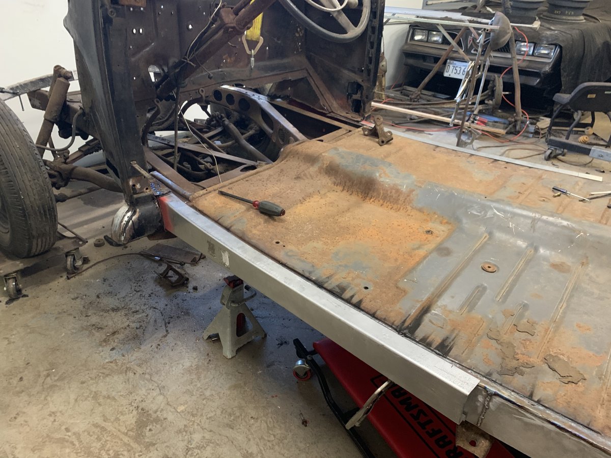

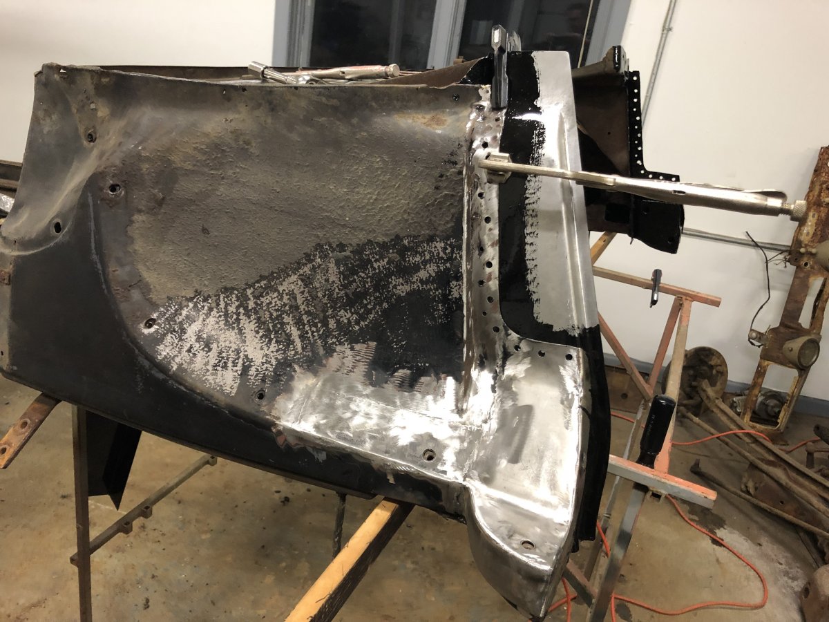

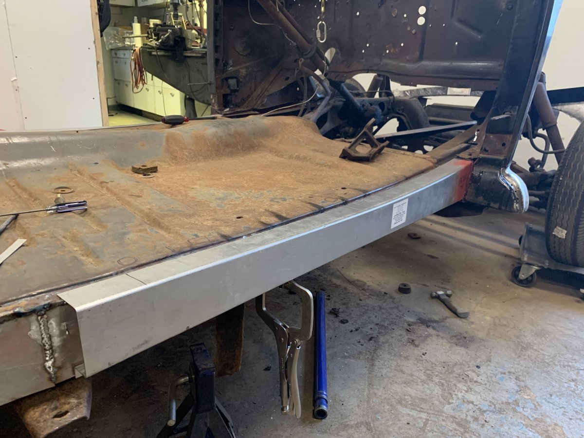

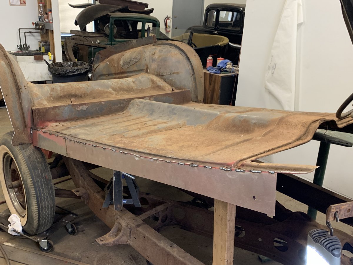

    Happy New Year everyone. It has been a long time since I’ve posted an update, only because it has been a long time since I’ve been able to be at the shop to get any work done. It felt good to spend a few hours working on this thing again.
    I spent some time cutting my floor donor car down further and have it really close to joining the convertible cowl and rear section to it. I also removed the outer rocker panels and will replace those as I re***emble the convertible body. I am glad I stripped the cars down this far as it will be fixed the right way now.
    Hopefully it’s not another 6 months before I get to do more work on it.
    A few pics.

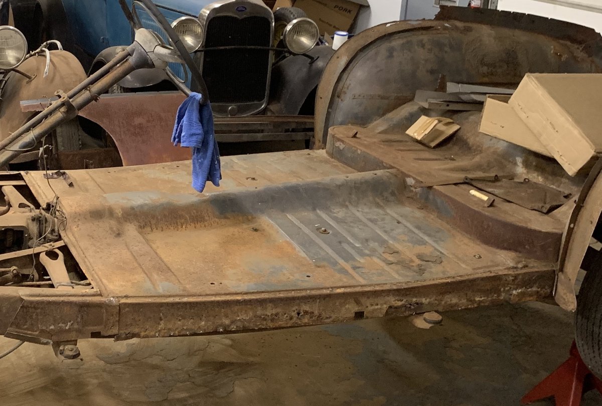

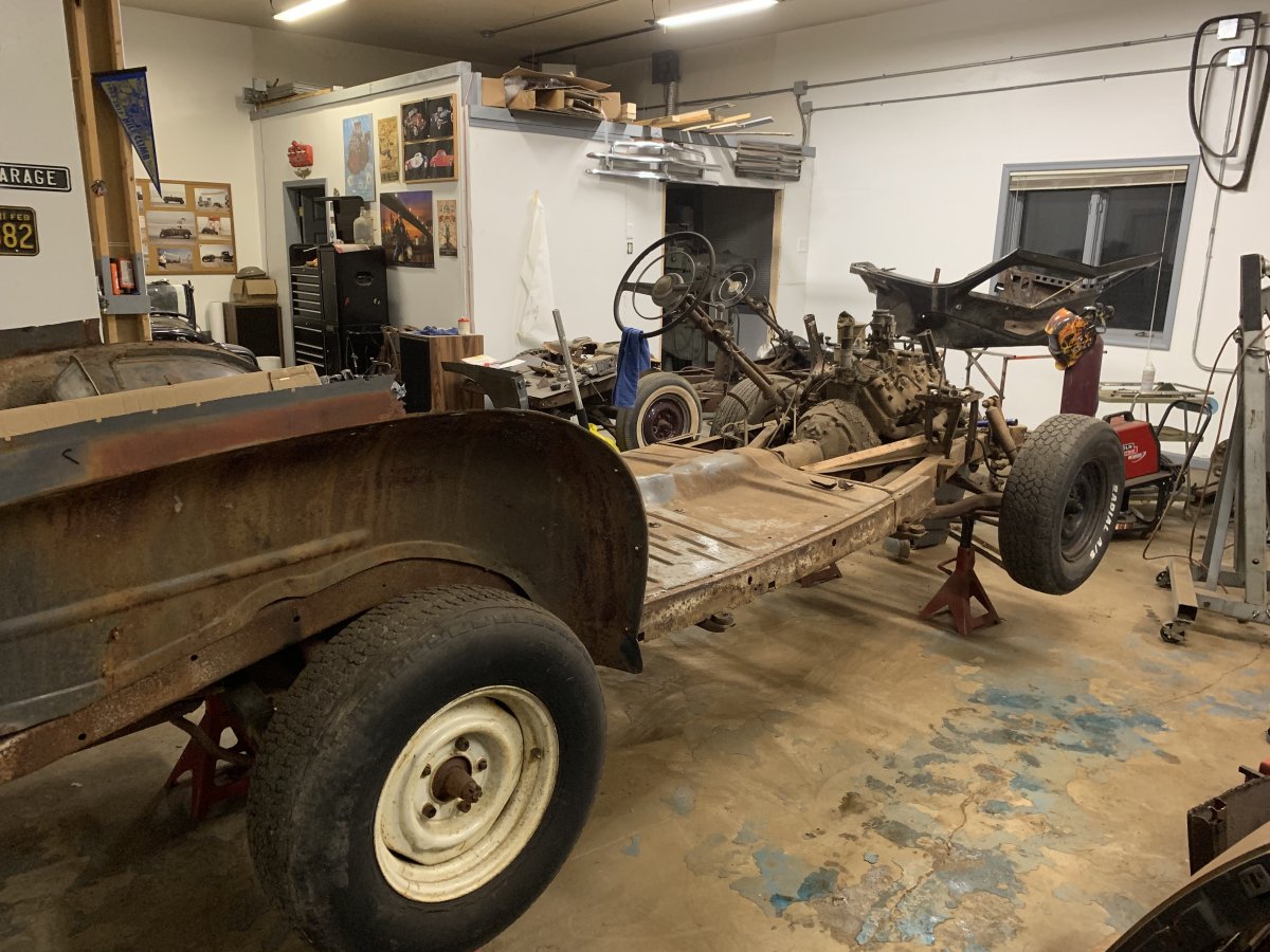

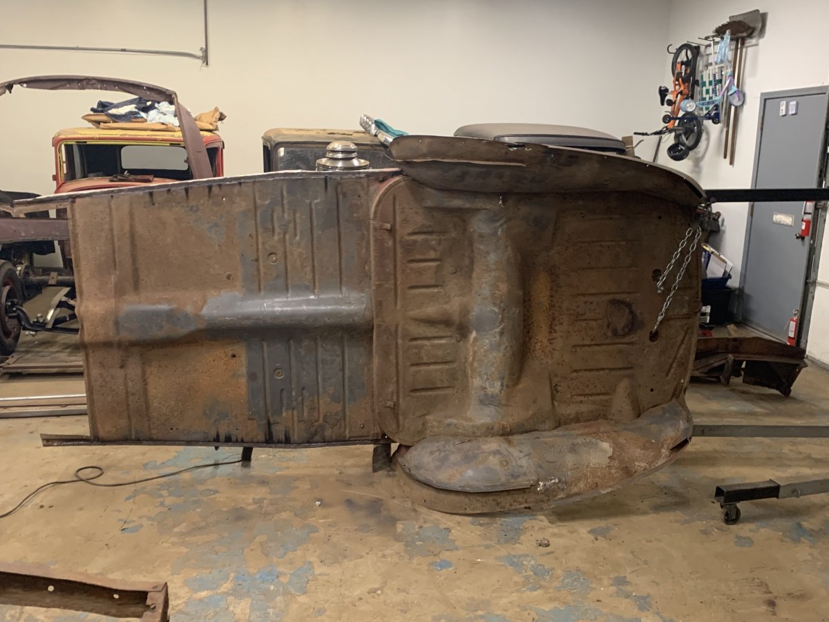

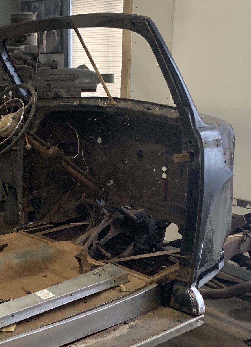

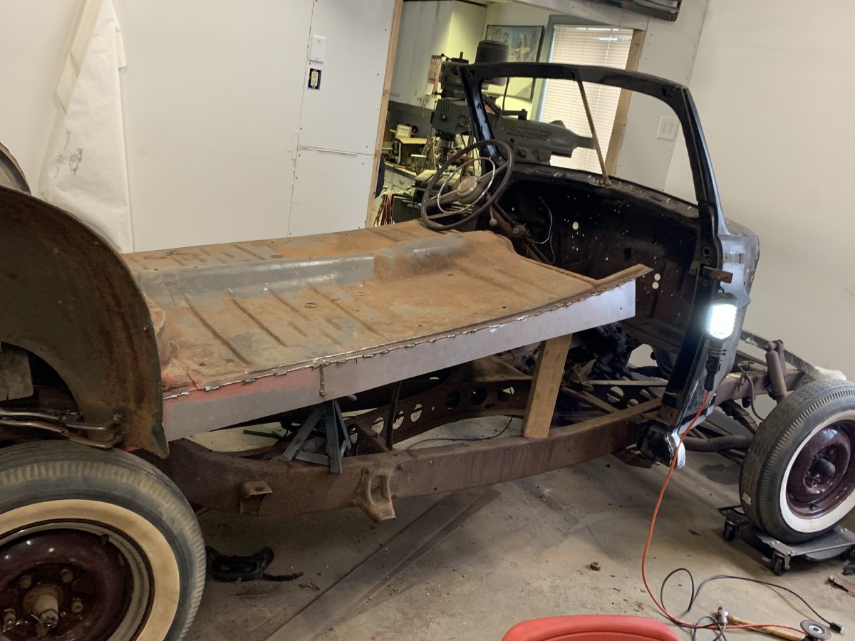

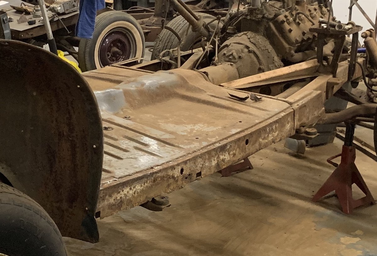

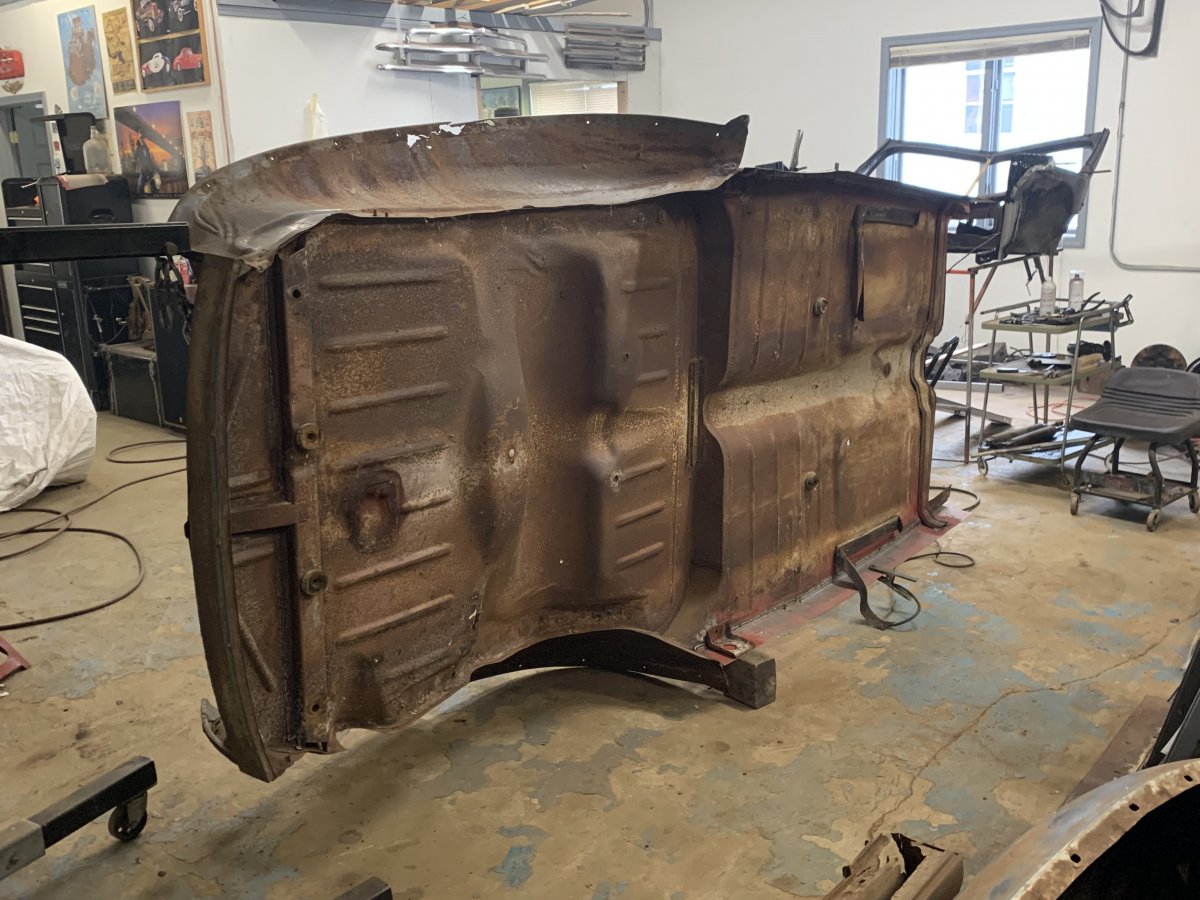

    Got a little more work done thanks to some good help.
    Removed the floor from the Tudor and put it on the convertible frame so I can get the Tudor ch***is out of my way. The Tudor floor is pretty nice. Only a couple places to patch.

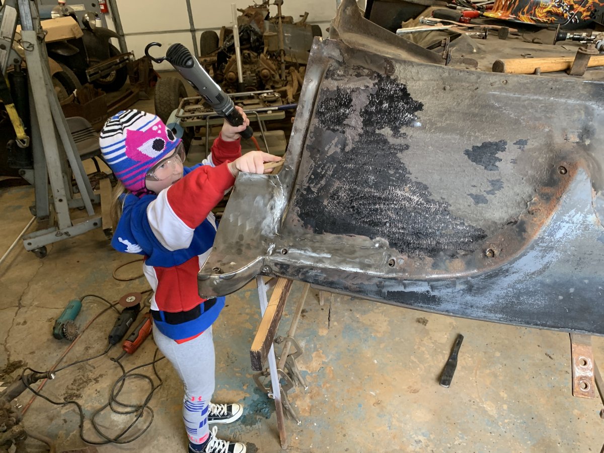

    I also finished welding in the patches on the cowl and had my little helper POR15 the underside of the cowl that will get covered by the rockers and she spread it everywhere else she could reach.
    Great attention to detail. Using the light to make sure she got good coverage.
    Next weekend, hopefully some work on the inner rockers.

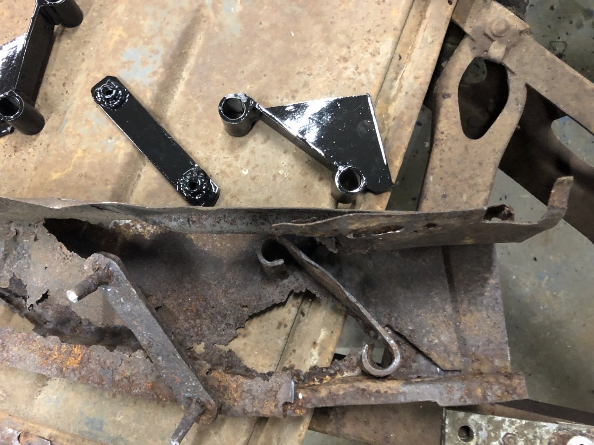

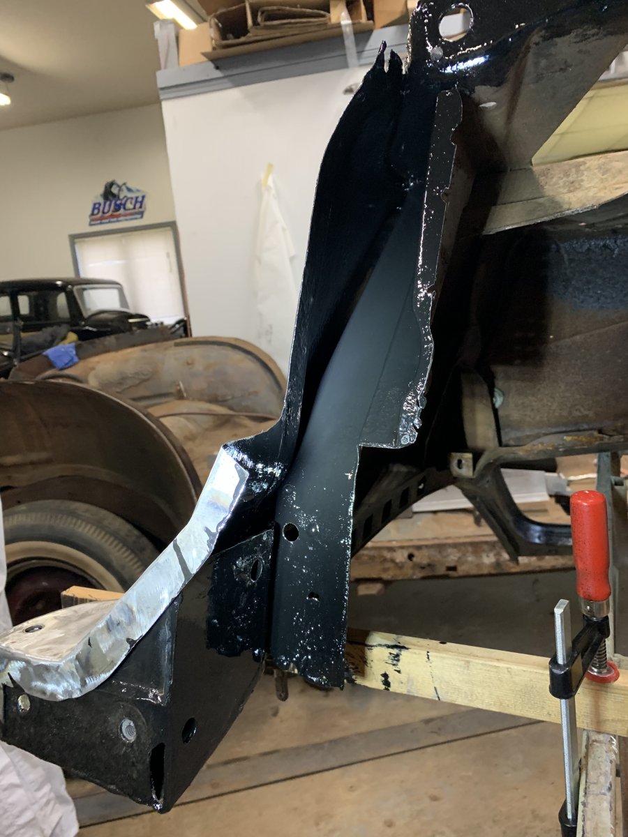

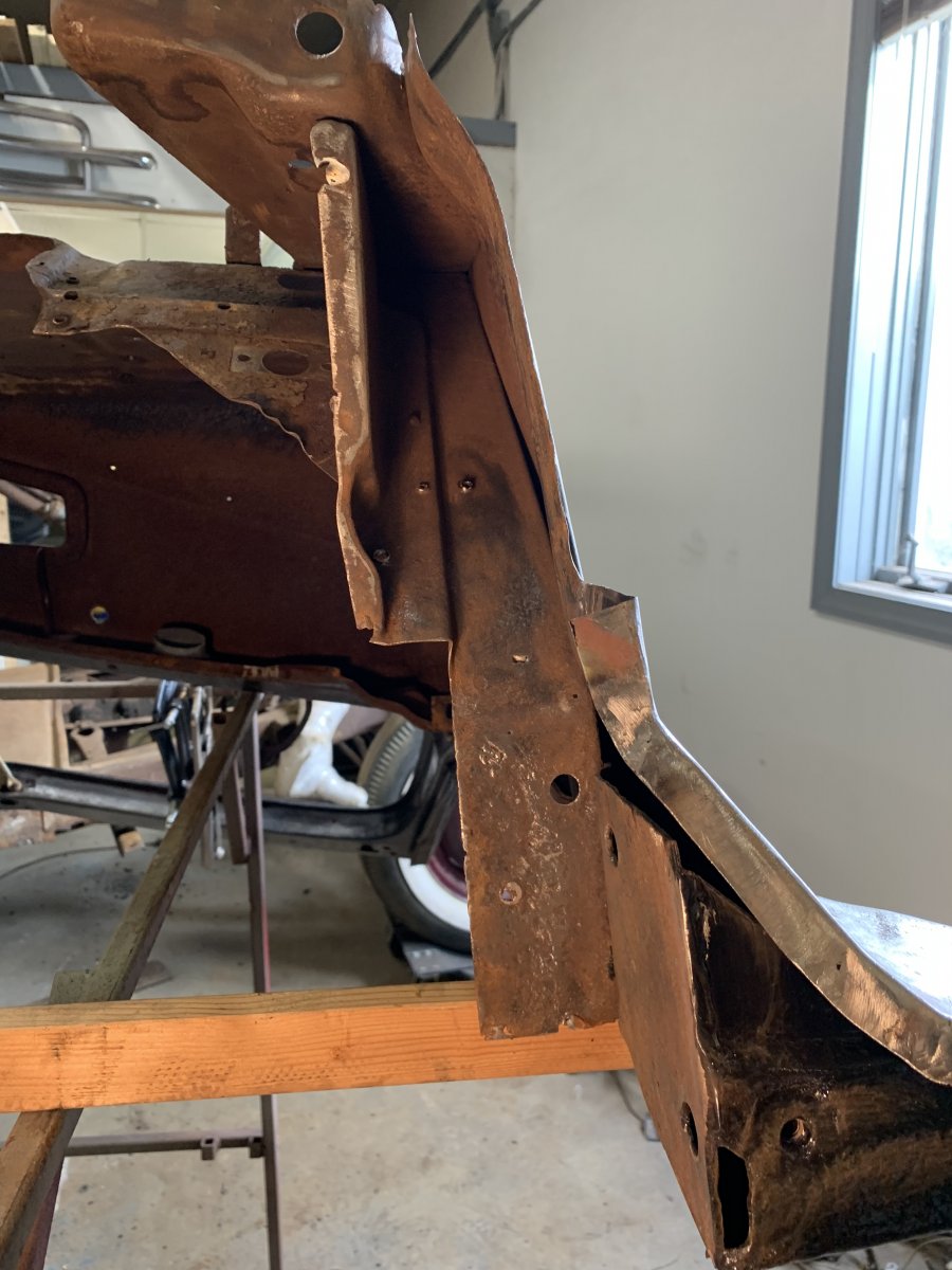

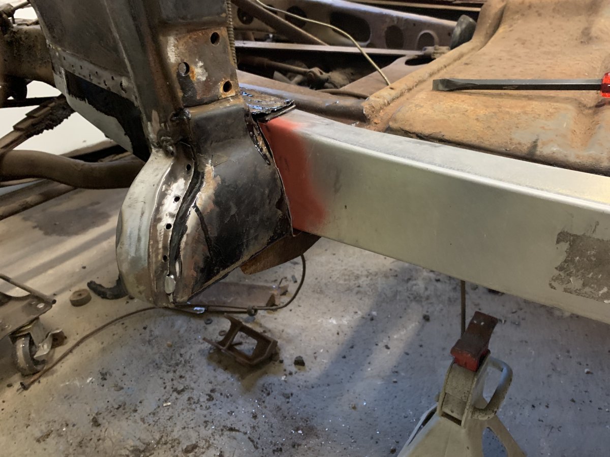

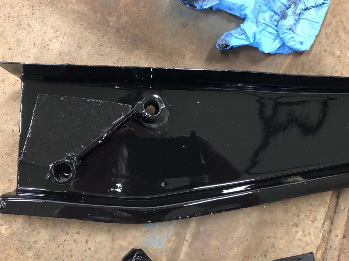

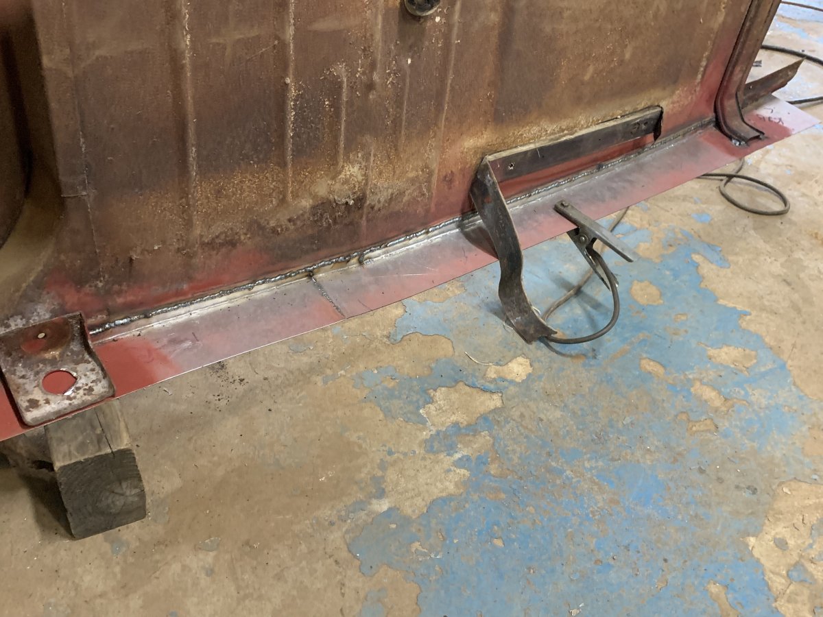

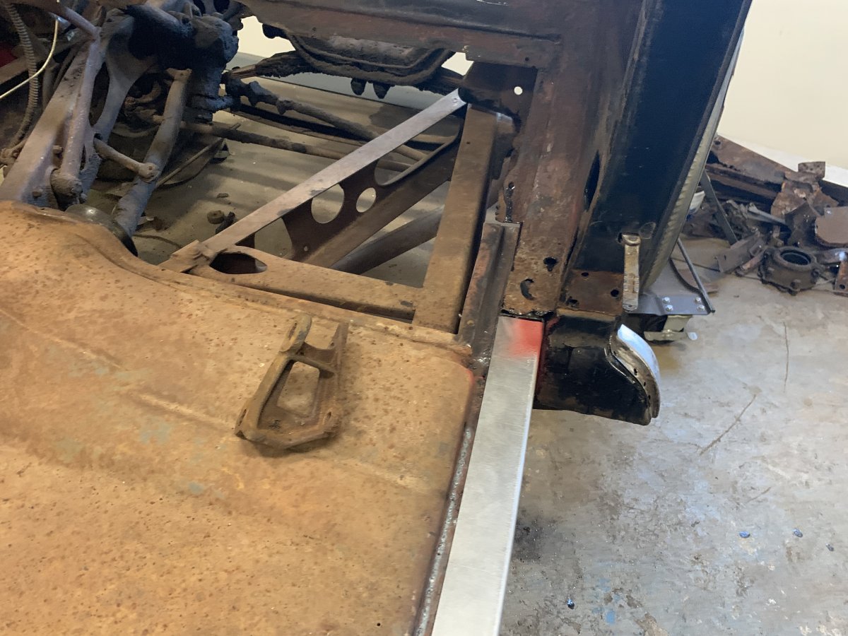

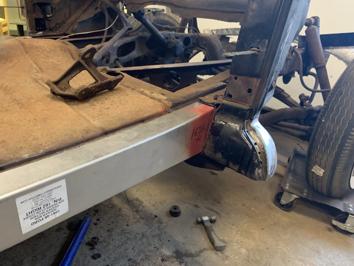

    The original cowl rockers were so rusty the cowl support brackets were were beyond use. There is support bracket between the inner and outer rockers were rusty beyond use and are convertible specific, so I whipped up a new set.
    I am just doing some final fit up on the outer rockers before I weld them in. Thanks to Natty she got the cowl ready for the new rockers.

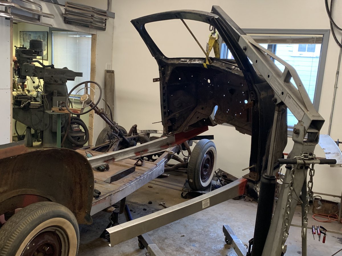

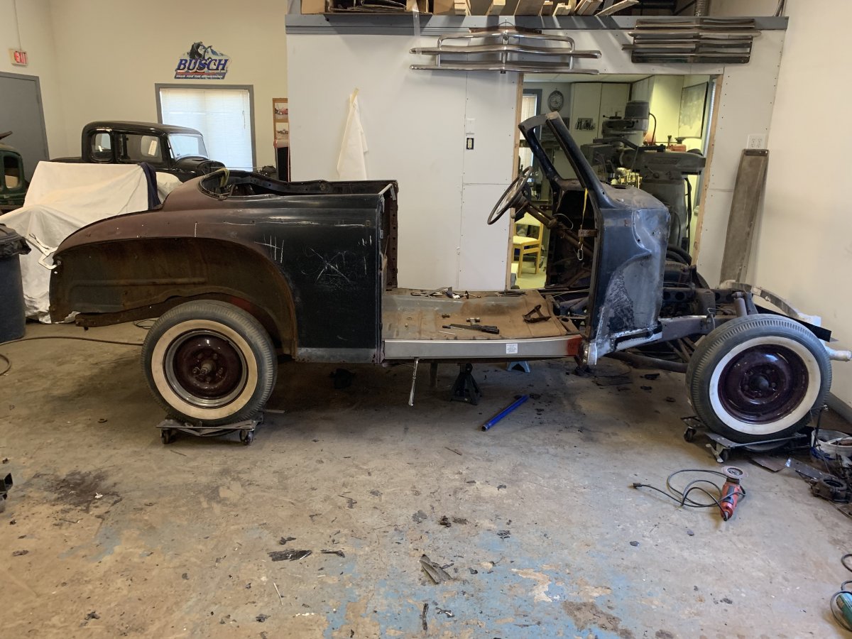

    Didn’t get to spend much time in the shop today before baseball practice.
    Sam helped me put the cowl back on the frame.
    Laying out the 6 pieces of inner and outer rocker panels (per side). If I get shop time tomorrow I’ll start welding in the inners.

  11. topher5150
    Joined: Feb 10, 2017
    Posts: 3,770
    topher5150
    how are your rockers rotted out, but not your floors
  12. T&A Flathead
    Joined: Apr 28, 2007
    Posts: 1,986
    T&A Flathead
    This floor is from a different car. But they were still pretty bad. The space between the inner and outer was full of dirt. When attempting to remove the running boards, the cage nuts ripped out from the rockers and tore big holes. They were week.

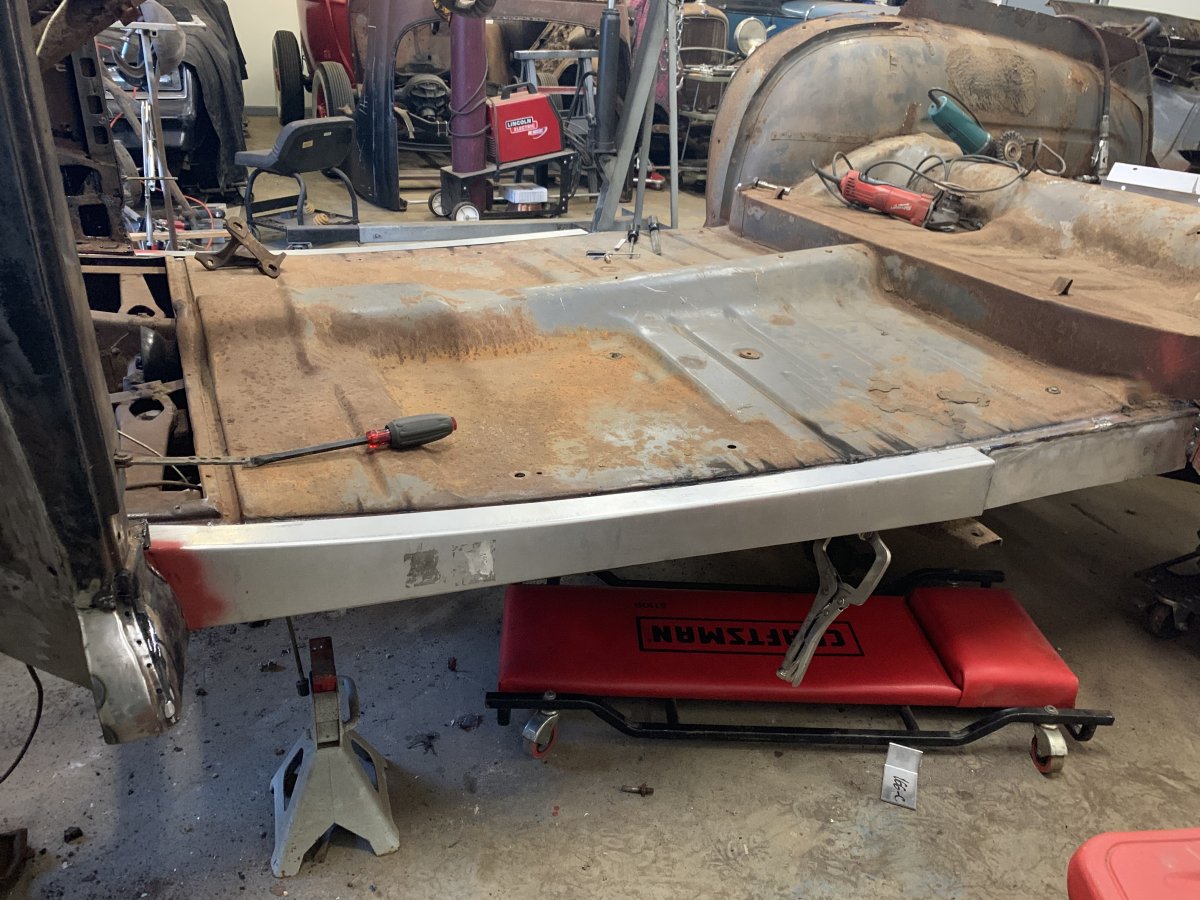

    Inner rocker on the p***enger side is partially welded in.
    EE8B7FB2-2119-4B8E-AE78-085259535AE6.jpeg 3DE544E3-8354-449A-98F7-F273D62F7845.jpeg
  19. T&A Flathead
    Posts: 1,986
    T&A Flathead
    While the west coast is having a blast at TROG Santa Barbara, I was welding on the inner rockers.

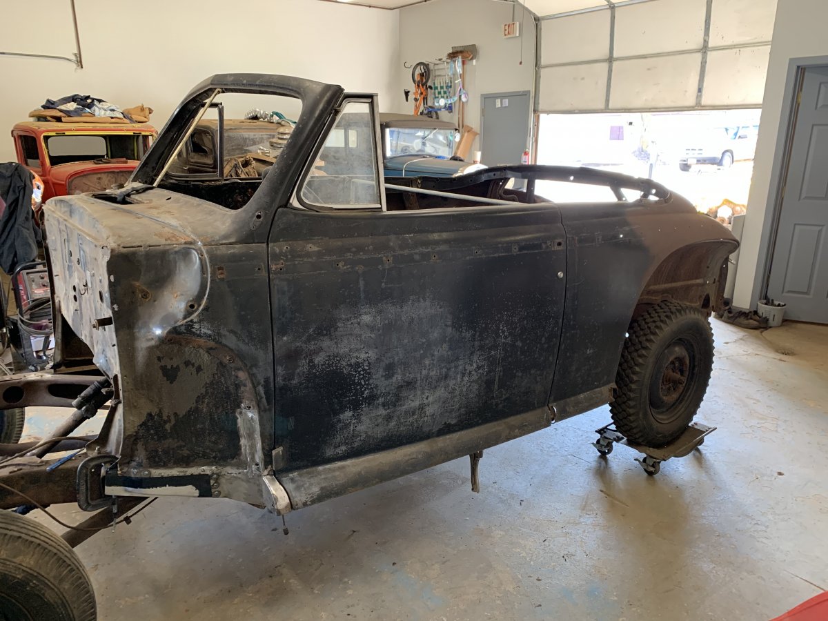

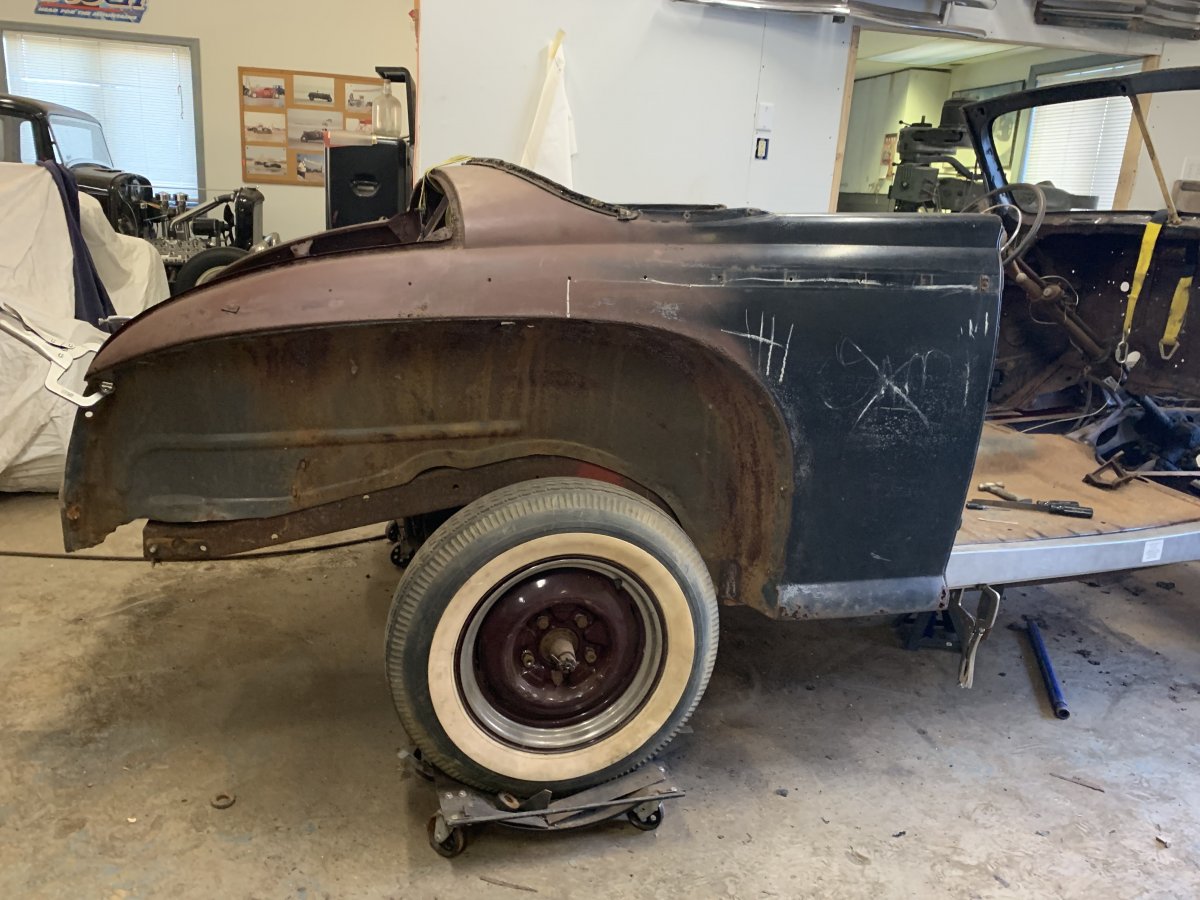

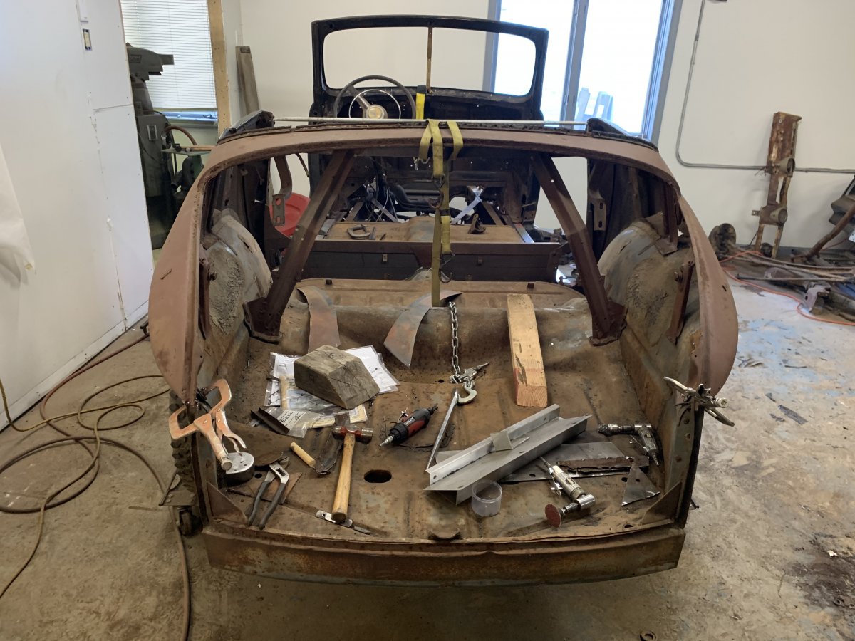

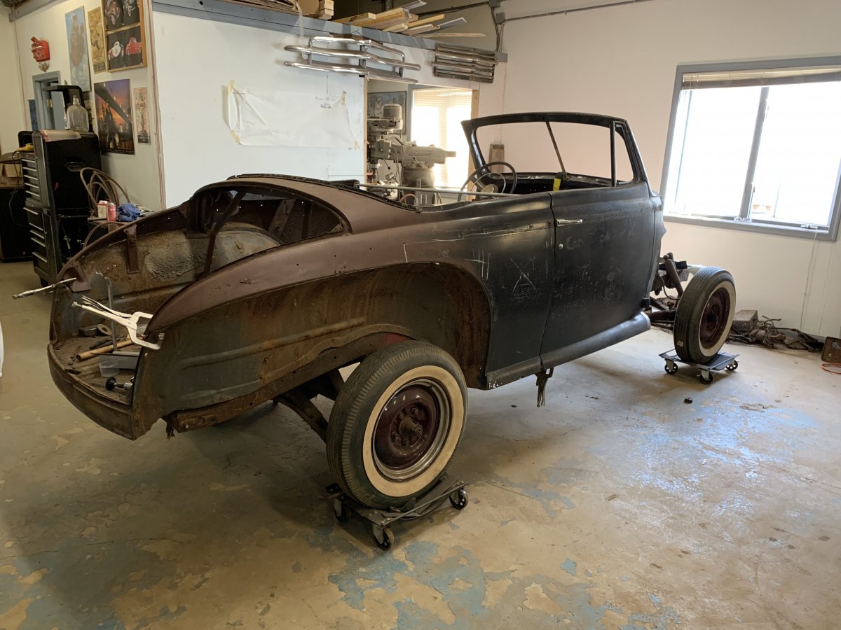

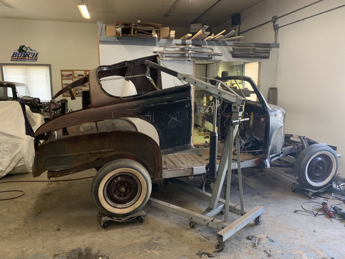

    Fitting the rear section of the convertible body to the Tudor floor and rear inner fenders. I wanted to set the body on the frame to check door gap before permanently welding the cowl to the rockers and floor.
    This is how I move stuff around since I am a one man shop.
    It fits decent. The Tudor inner fenders must have relaxed a bit, but nothing I can’t close up.
    FB798AE3-0762-4F88-8B2D-D92FF6E59F24.jpeg F7309C69-2978-4E14-9622-6C239E673CE3.jpeg B469016C-B509-40FE-A2CF-67269E7121B0.jpeg 47BCB26B-9203-4C9D-A619-A13B307425F6.jpeg
    The rear will come off/on again several more times.
    After putting the rear body on I am convinced this was the only way to fix this rusty girl.

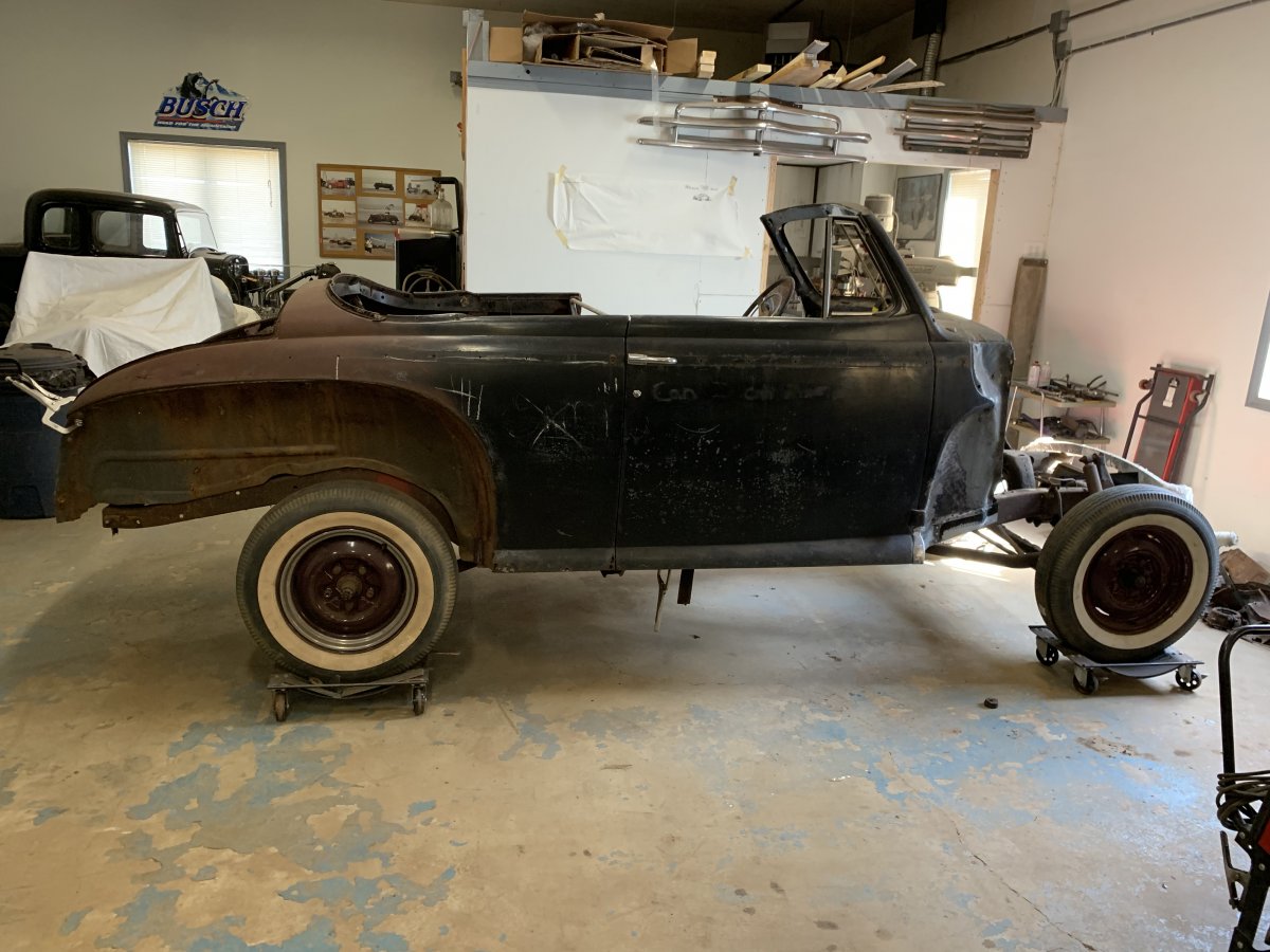

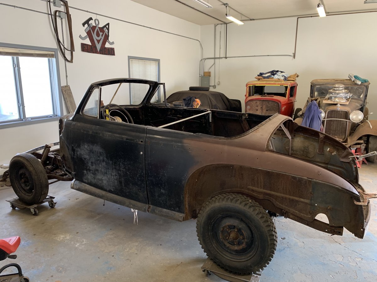

    Hung both doors just to make sure the gaps are good before I weld the rockers to cowl. Time to weld the rocker to cowl and then pull it all back apart again.
