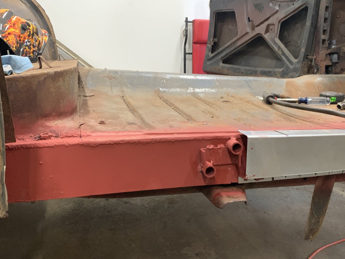

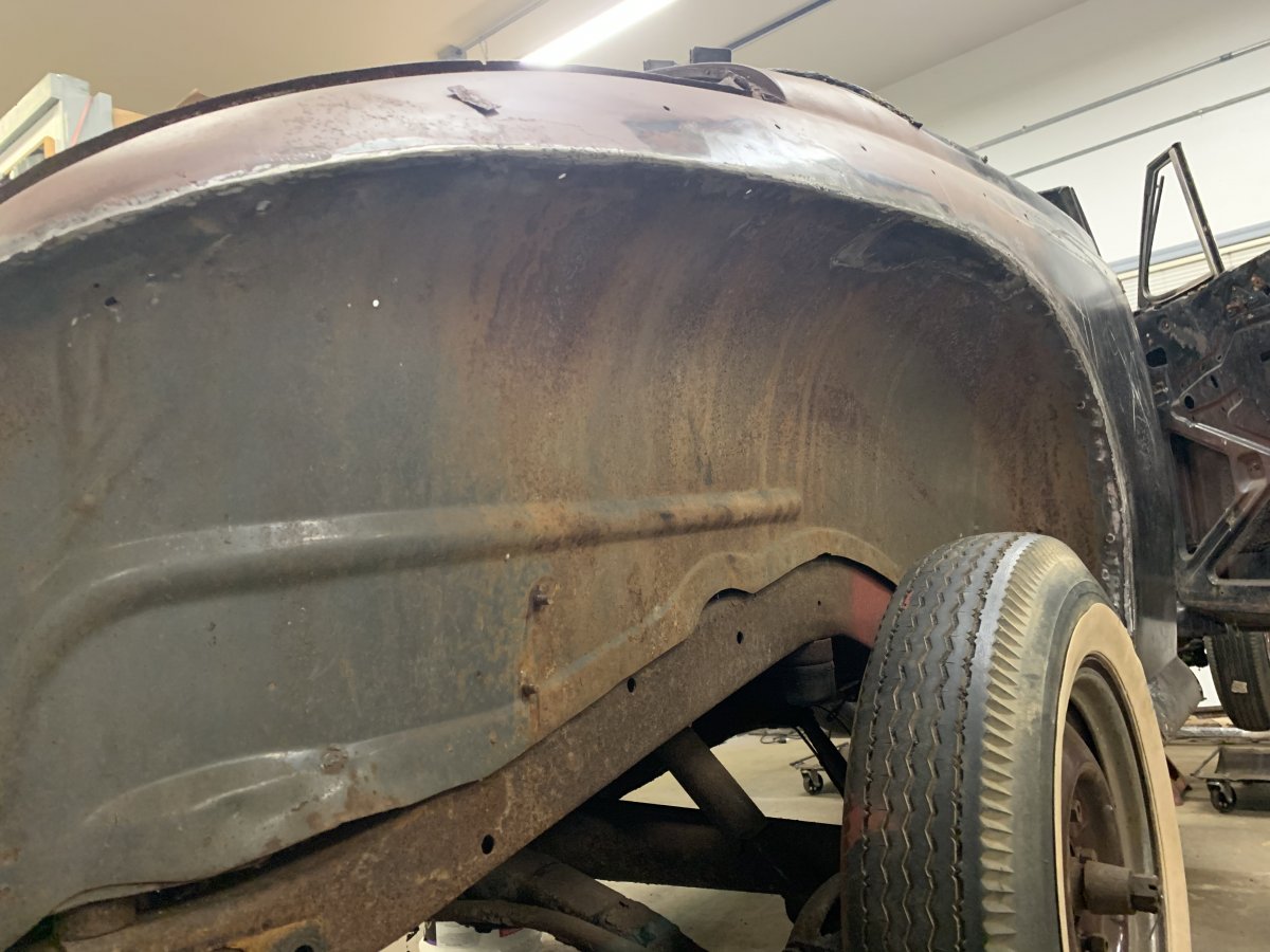

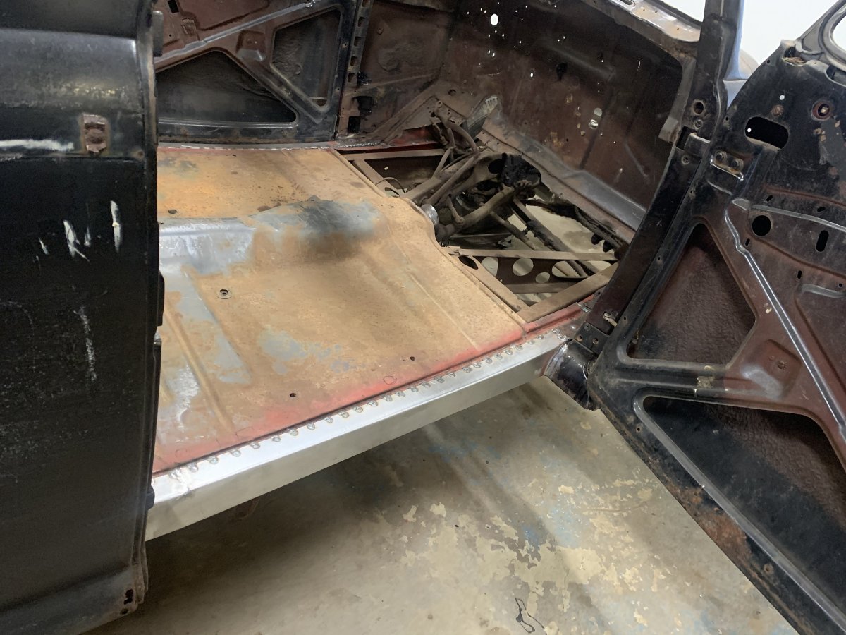

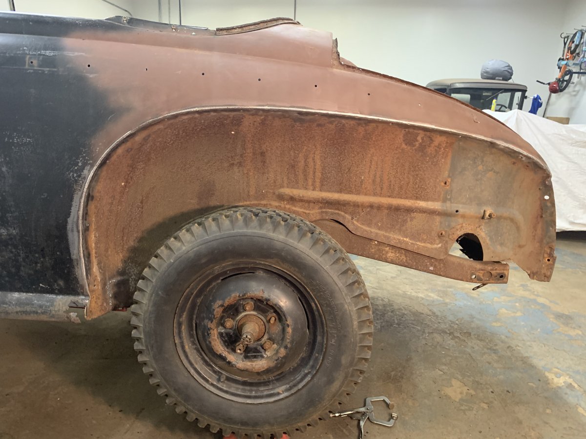

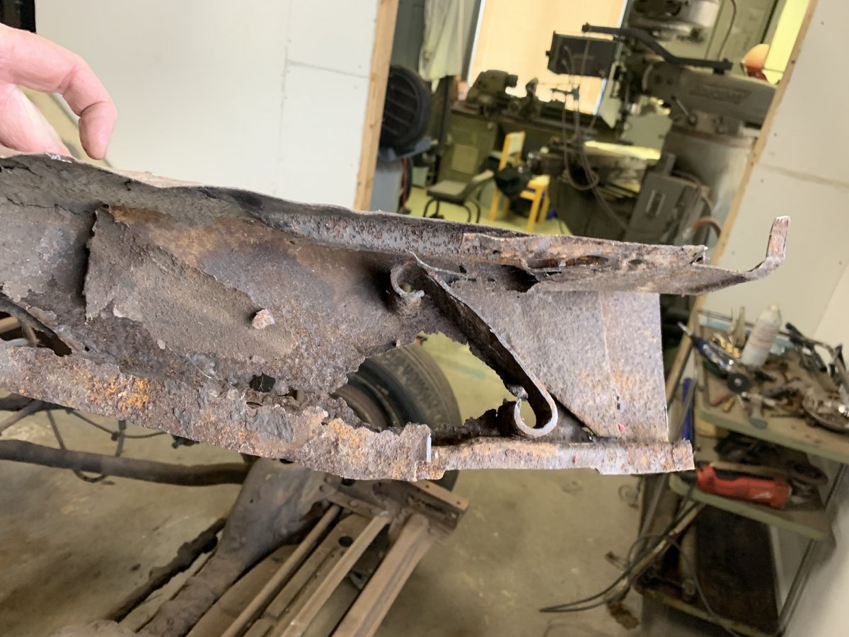

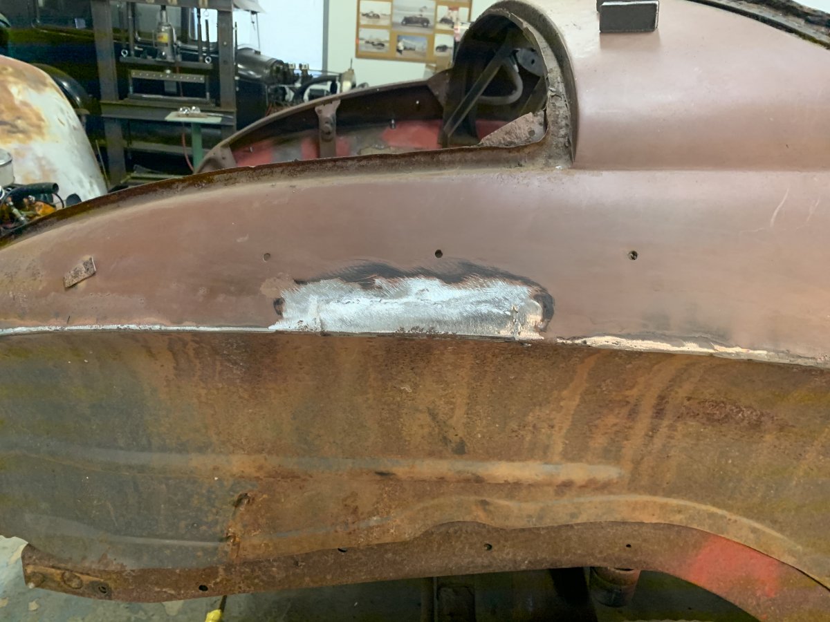

    This thing sat all spring and summer and collected dust. Now that the snow is flying and the hot rods are away, I’ll be getting back to work.
    Still working on the rockers but made some progress today.
    9AF605B9-B618-4A3F-8079-F5EB53824A04.jpeg 4B3B8B07-4A5D-4C66-8B19-0ED77BFF1077.jpeg B4E0CCB9-2030-49B9-8ACF-CFA4AFC4CC88.jpeg 06B8D337-247E-4C21-BCF5-F08D5266BC79.jpeg
    reminder on how bad the cowl rocker was.
    A few more things to do and the cowl will be ready for welding to the floor.

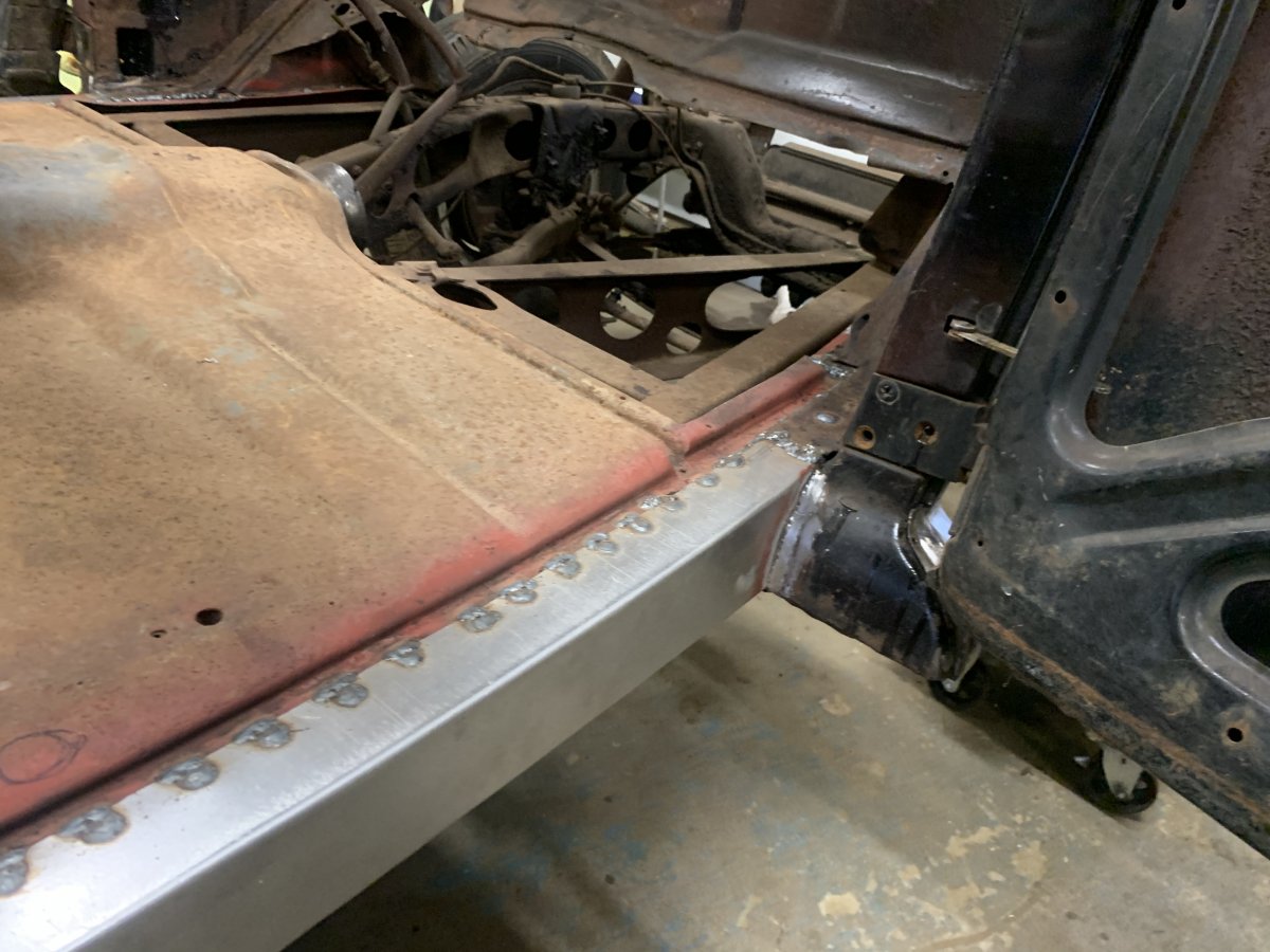

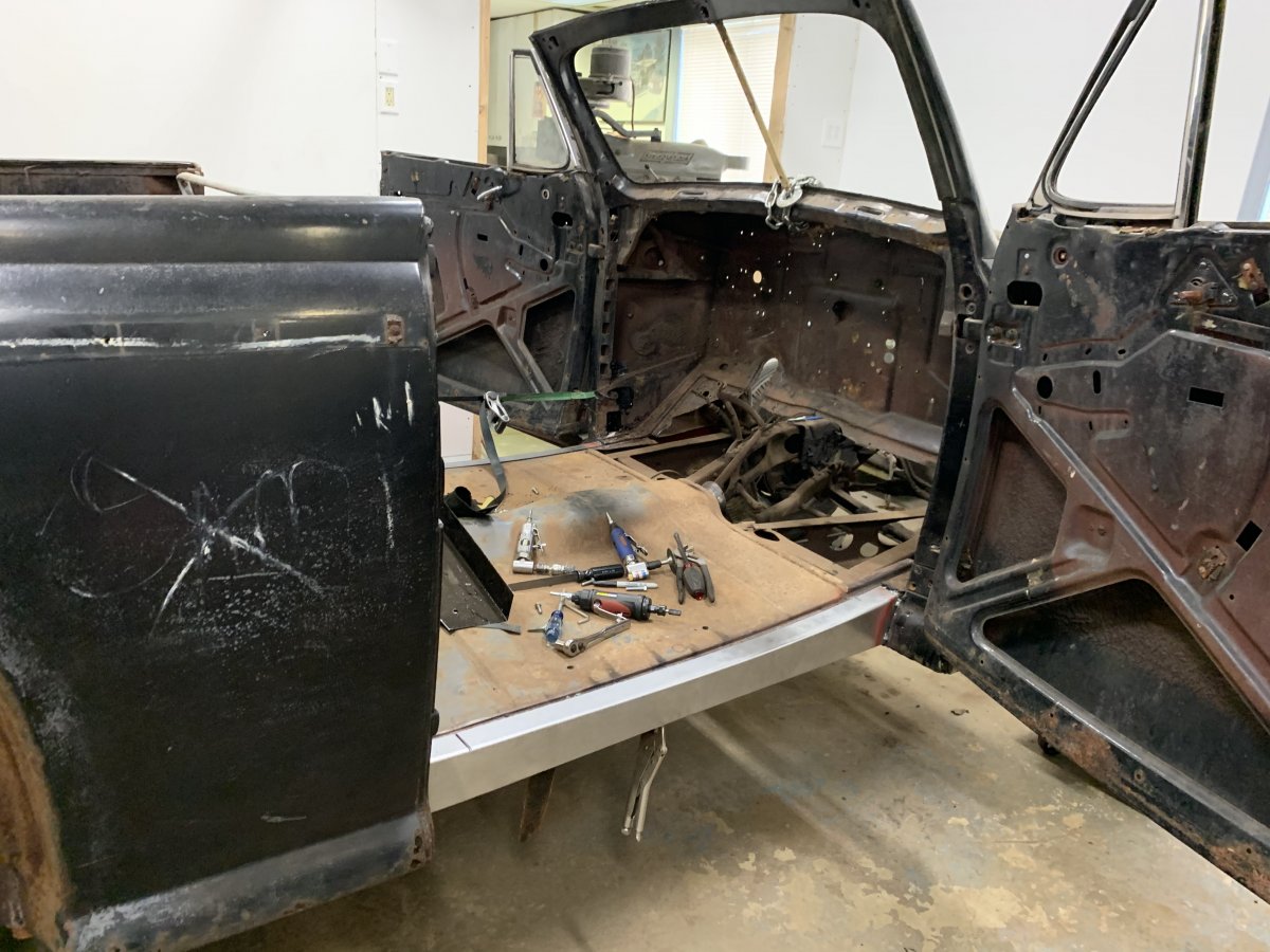

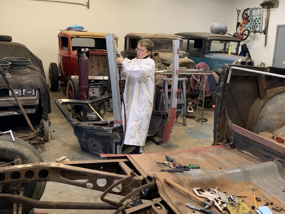

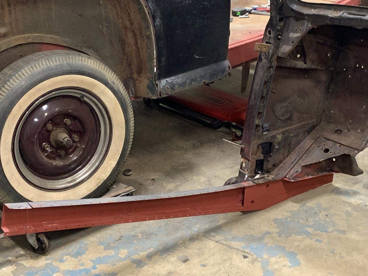

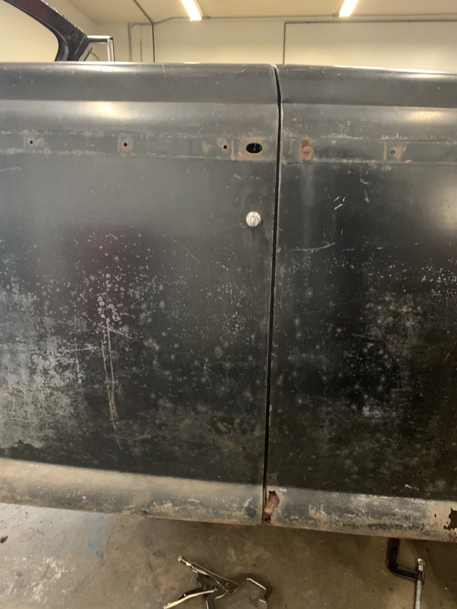

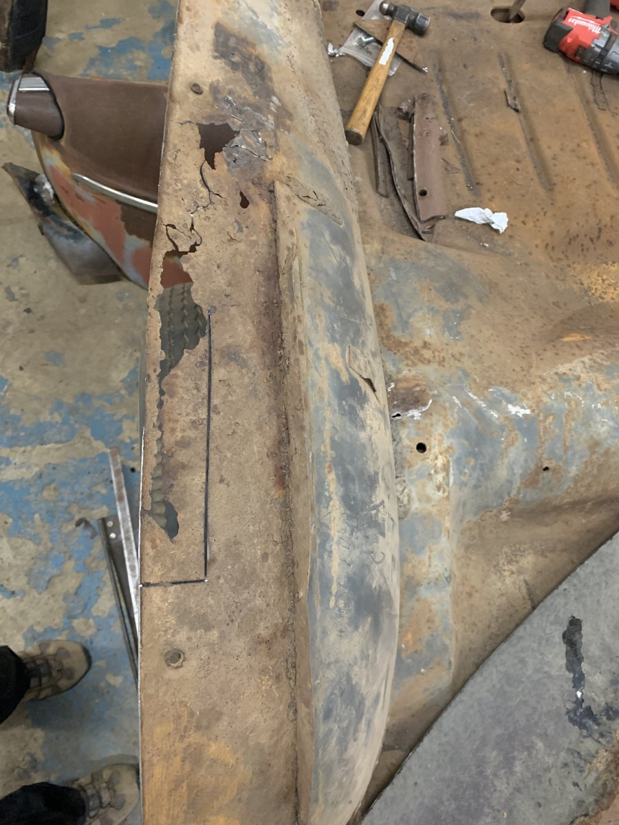

    I had some good help in the shop today. Sam punched all the holes in the outer rocker so I can plug weld it to the inner rocker tomorrow. I also got the cowl inner rocker aligned and welded in. I’ve aligned the rocker at the b-pillar and made a brace. Hopefully I get the cowl tacked to the floor tomorrow.

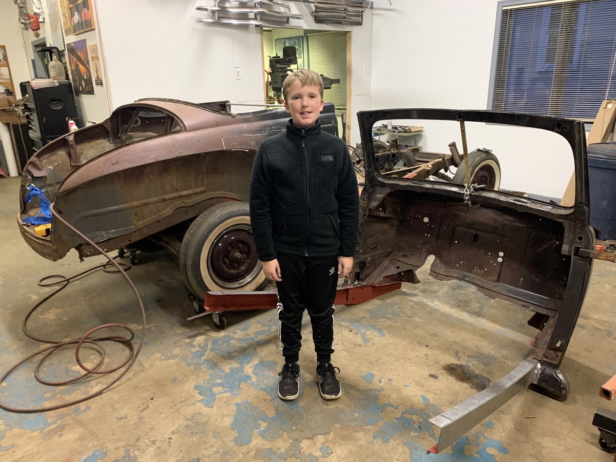

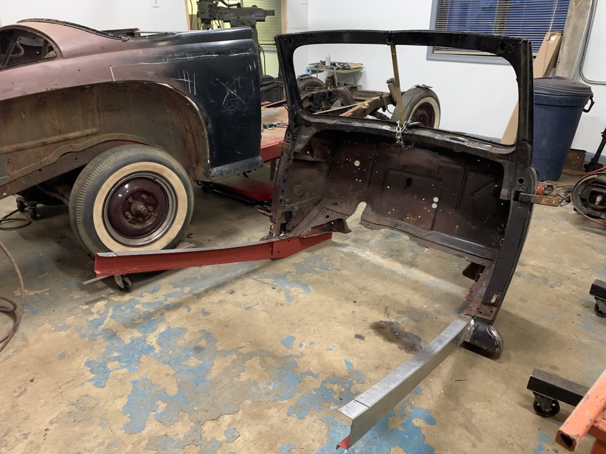

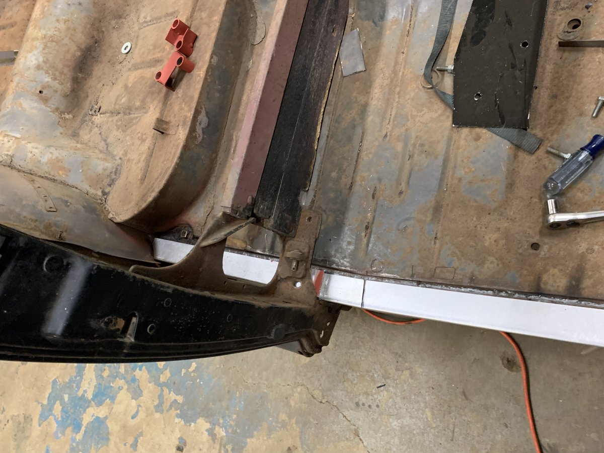

  7. T&A Flathead
    Joined: Apr 28, 2007
    Posts: 1,986
    T&A Flathead

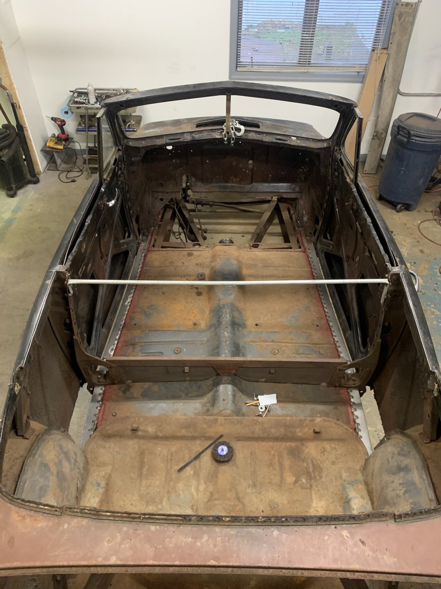

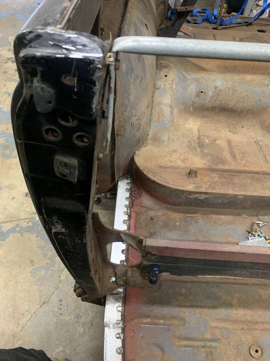

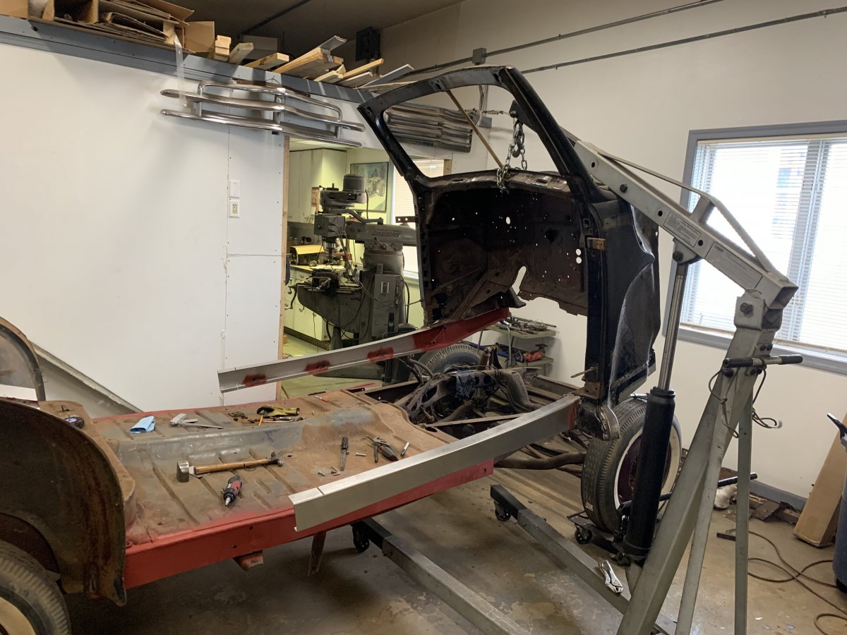

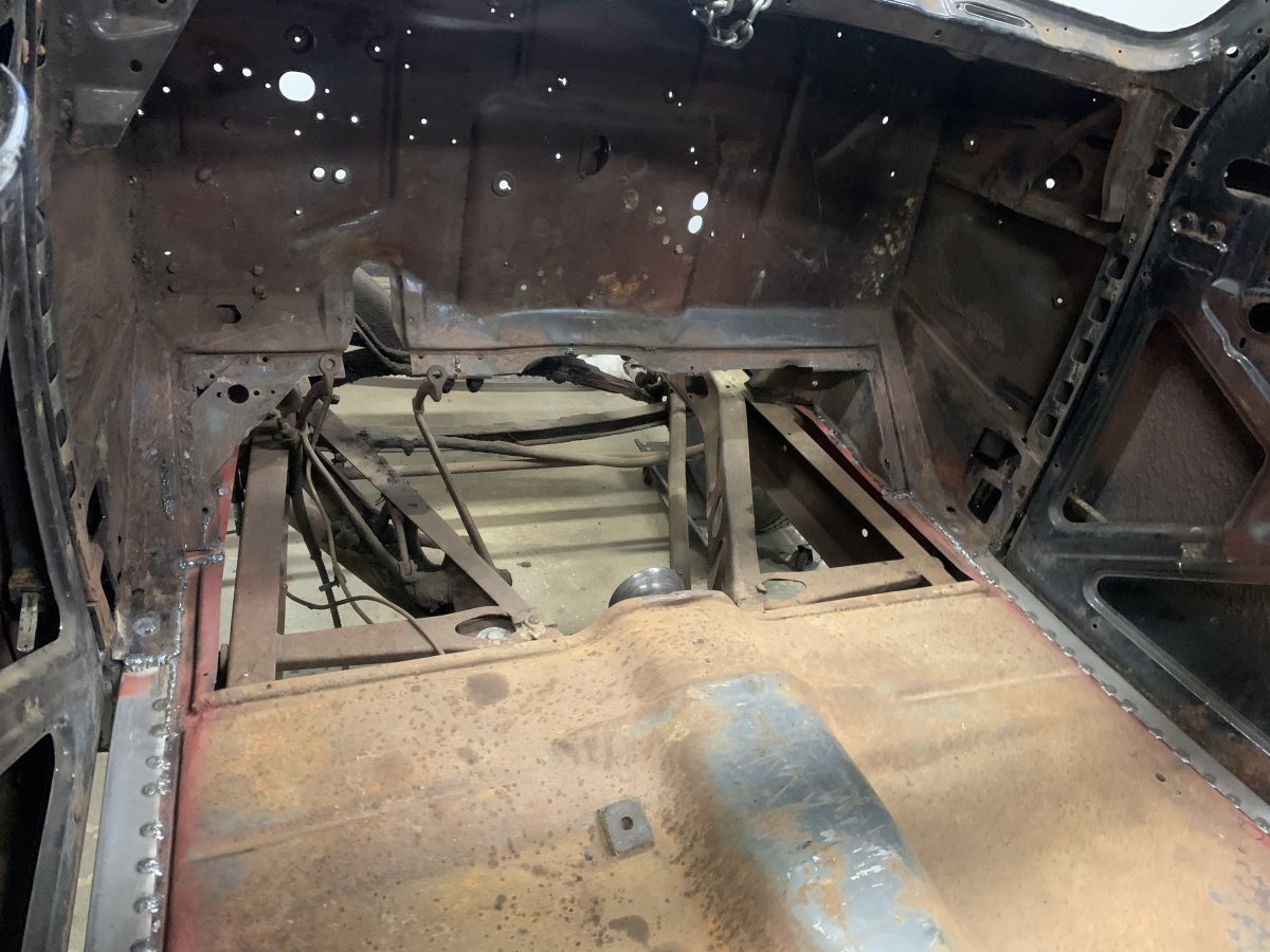

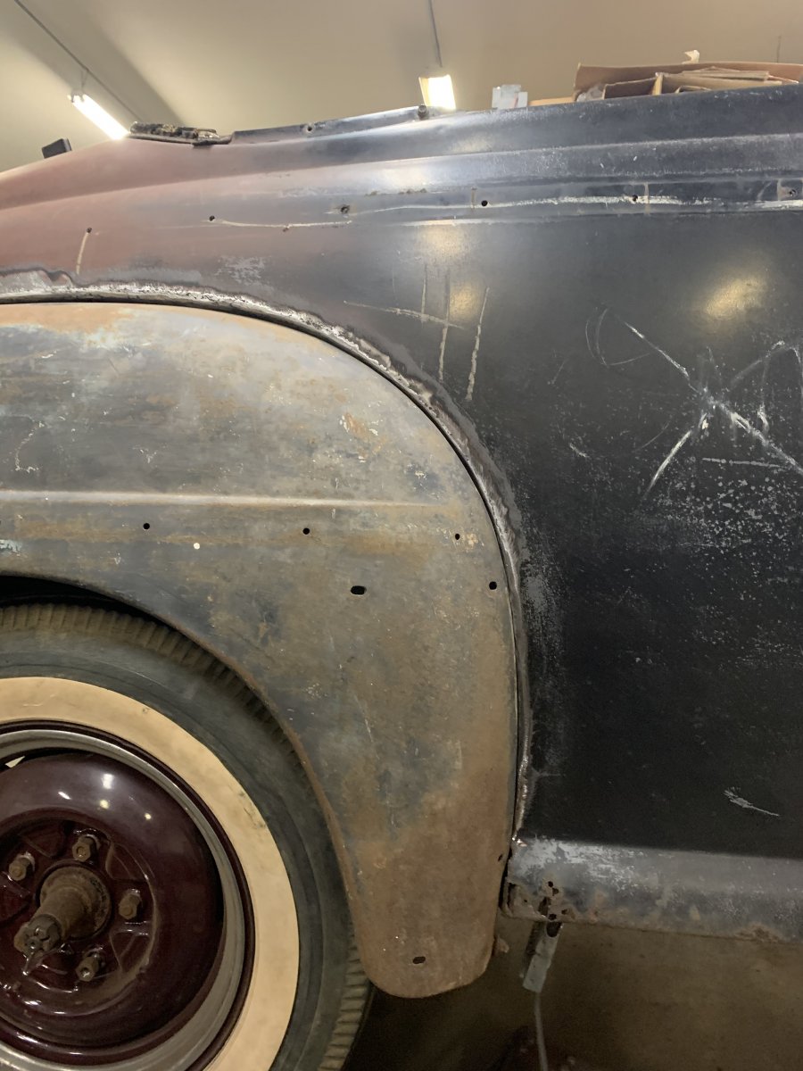

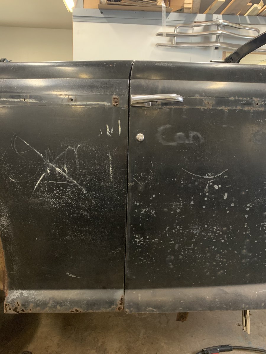

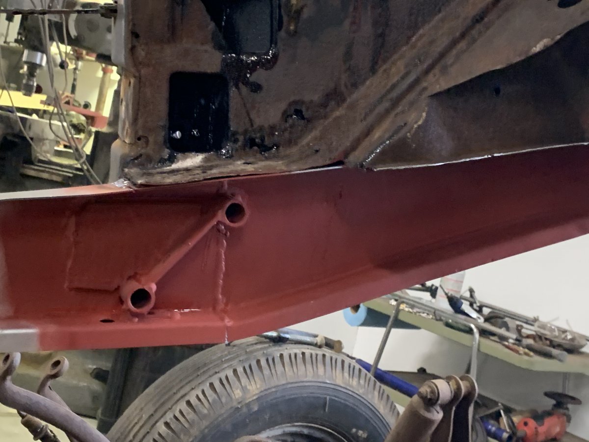

    Installed the B-pillar support that goes between the inner and outer rocker. I’m not entirely sure it looked like this because the rockers were completely rusted away. But this should work.
    And just like that the cowl is now welded to the donor floor.
    782FC0CC-7969-4147-BC20-07118E6EFBEB.jpeg A4B2917C-15E7-41BA-ADC5-4B7717BFAA17.jpeg F5B99317-C9CD-4FB9-90E2-63852FE08AB0.jpeg FFB56F63-D43A-424E-B1E5-B452F48C6E9E.jpeg
    Door gaps fit better than before I cut it apart and they can still be adjusted.
    The rear section is aligned in the factory holes but not welded in yet.

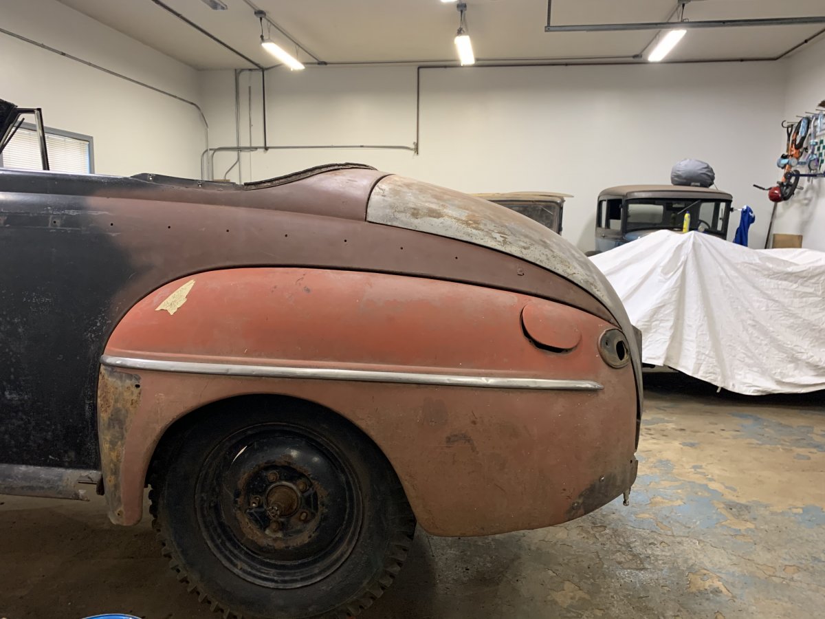

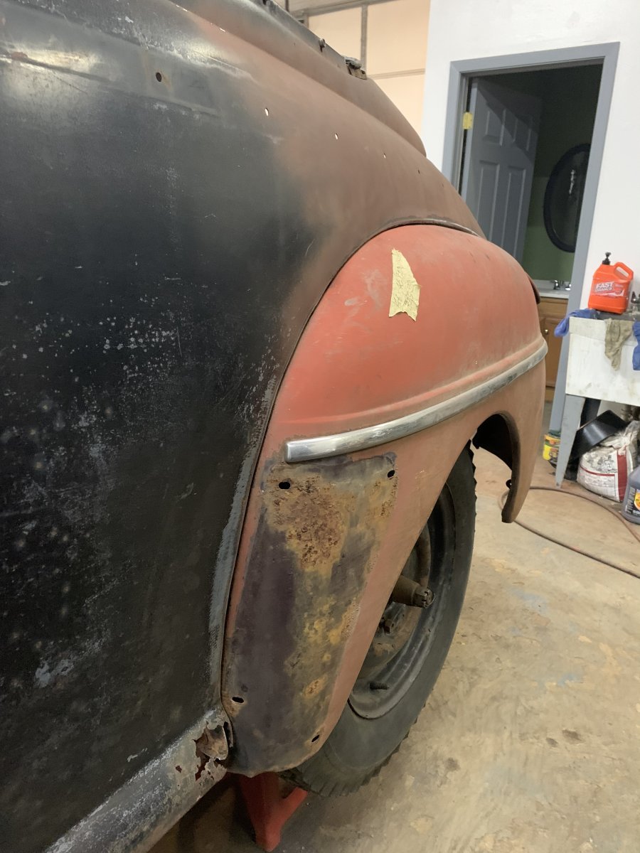

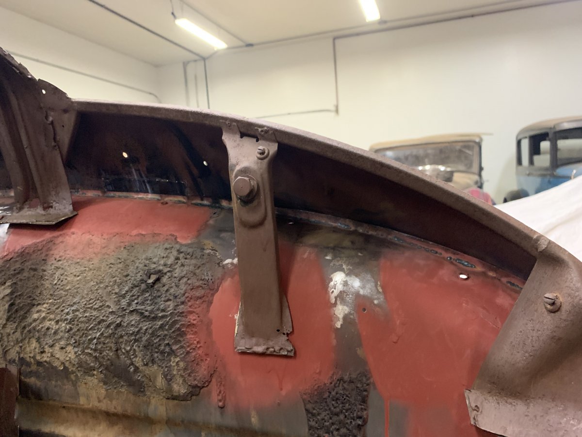

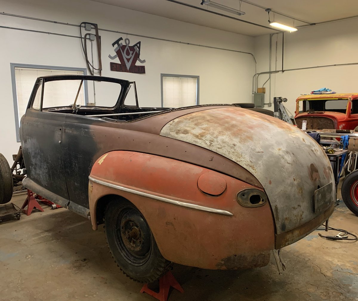

    More work today. Fixed some rust. Almost ready to tack the rear section to the rest of the car.

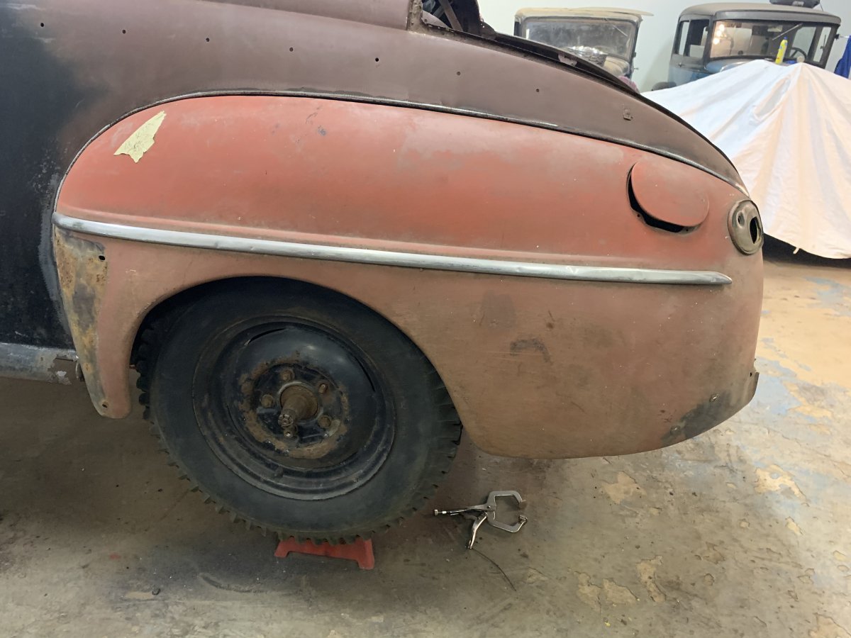

  17. T&A Flathead
    Posts: 1,986
    T&A Flathead

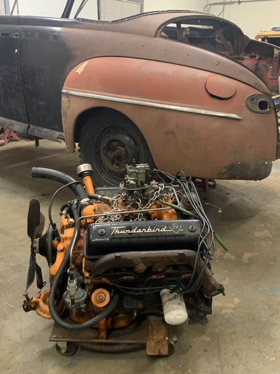

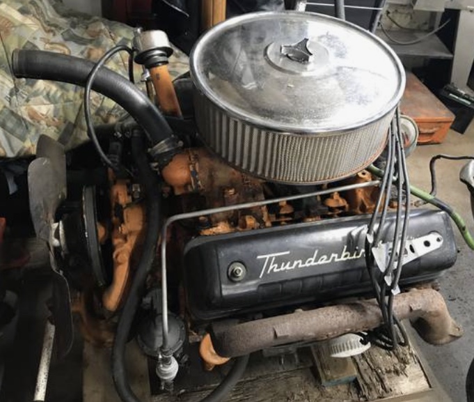

    Brought my engine home tonight.
  18. theman440
    Joined: Jun 28, 2012
    Posts: 386
    theman440
    from Las Vegas
    That's a screwy looking carburetor!

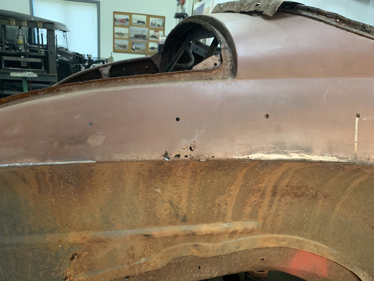

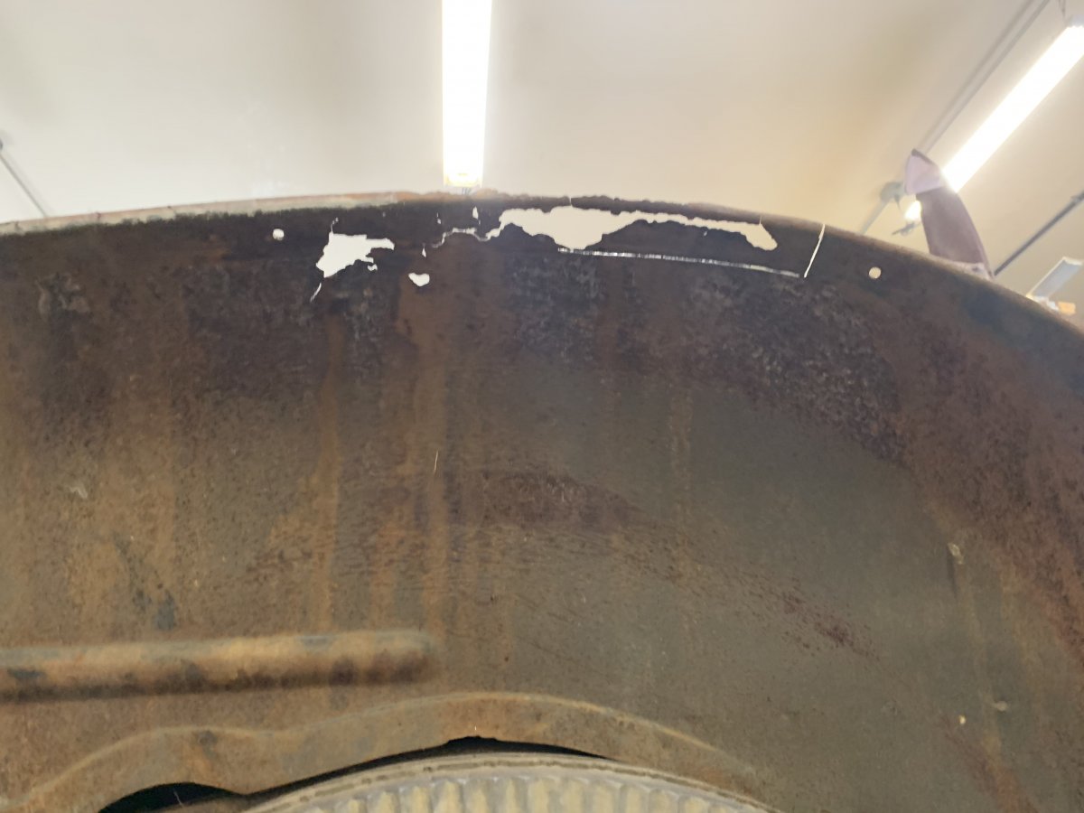

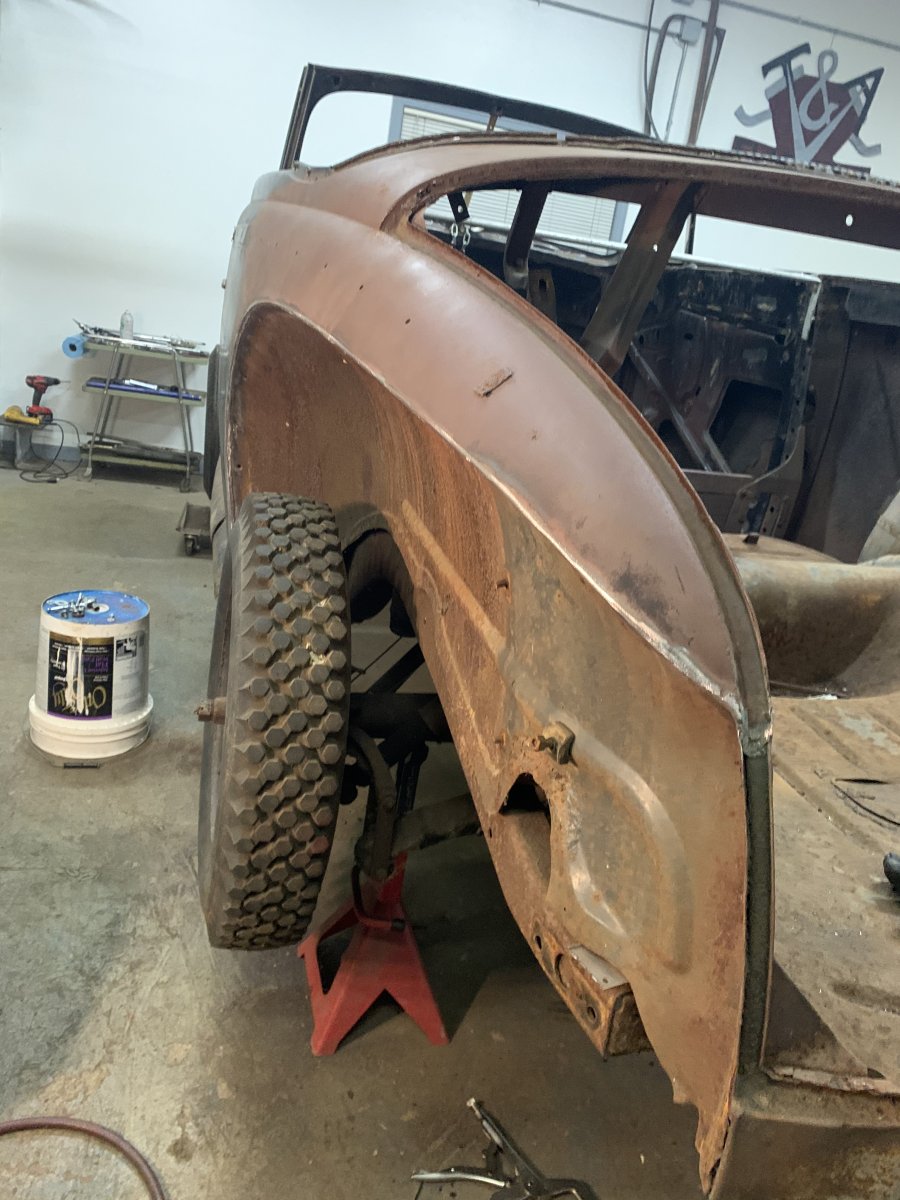

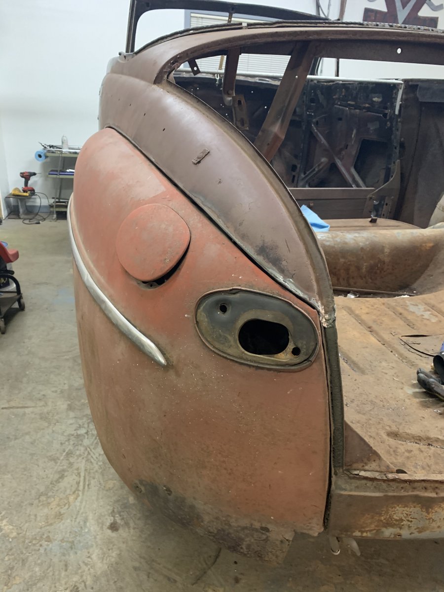

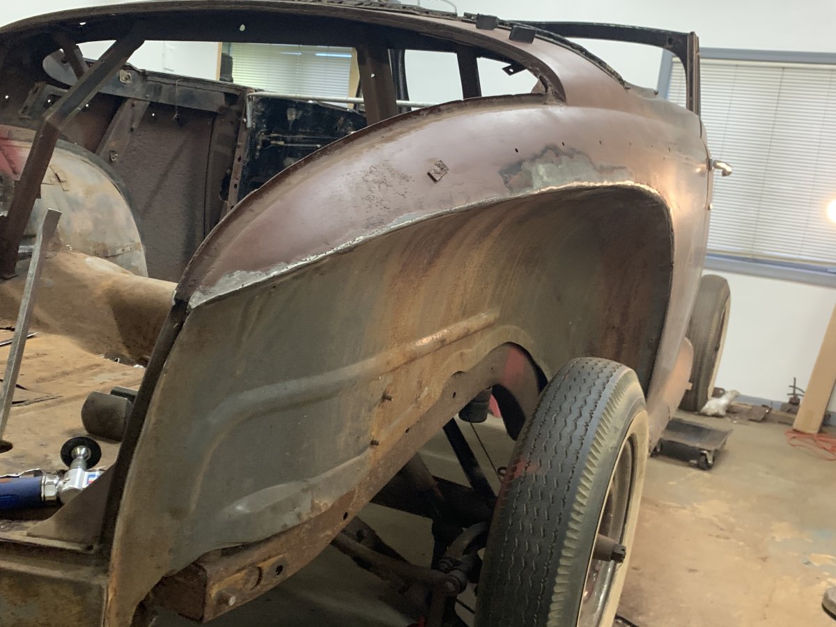

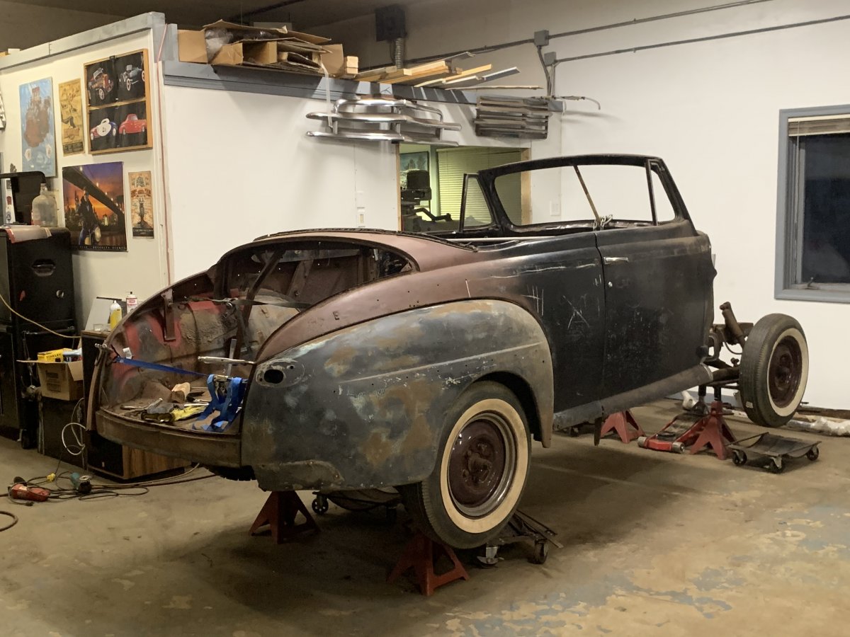

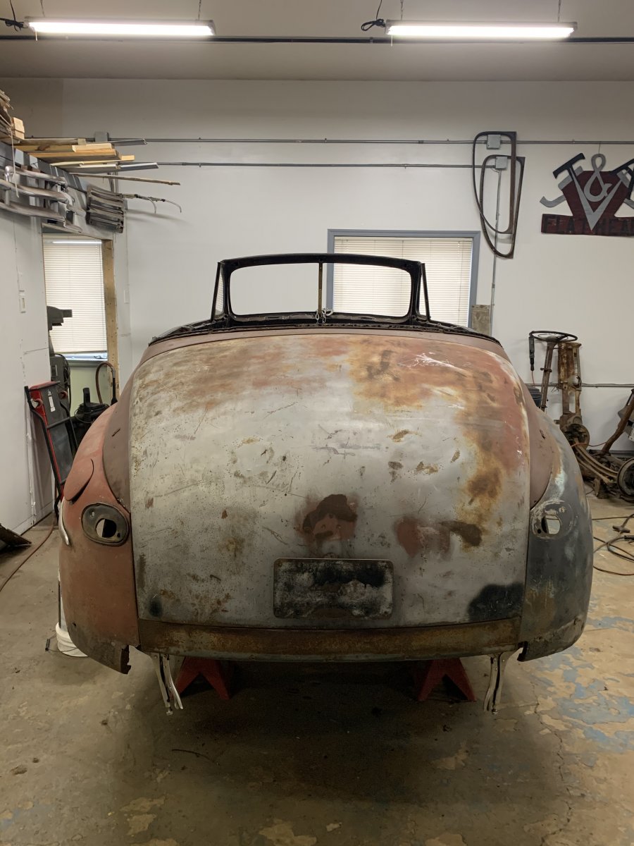

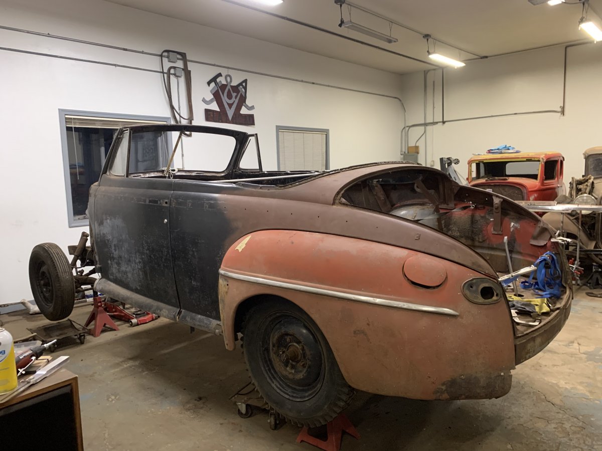

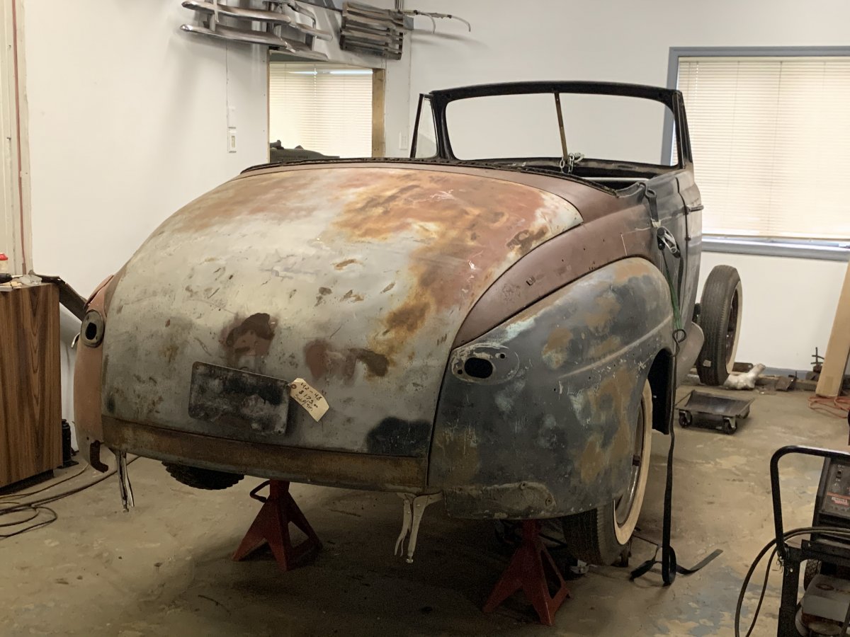

    A little more progress since I decided to skip my day job today.

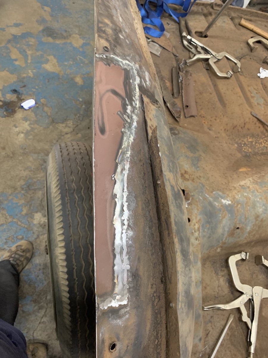

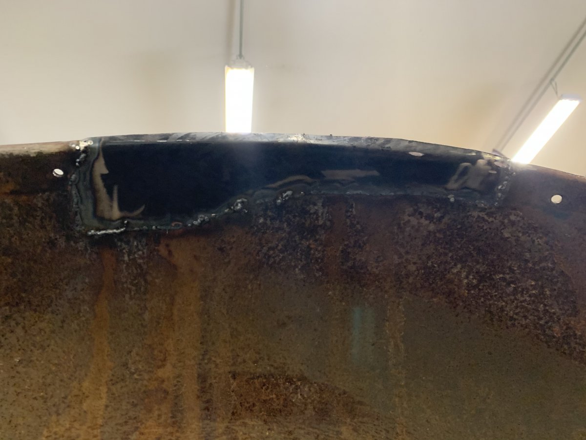

    I put the truck lid on just to check gaps and alignment before I begin welding the rear section down. Also fixed a rust through spot and started welding the rear section.
    Pretty pleased so far considering all this thing has been through.

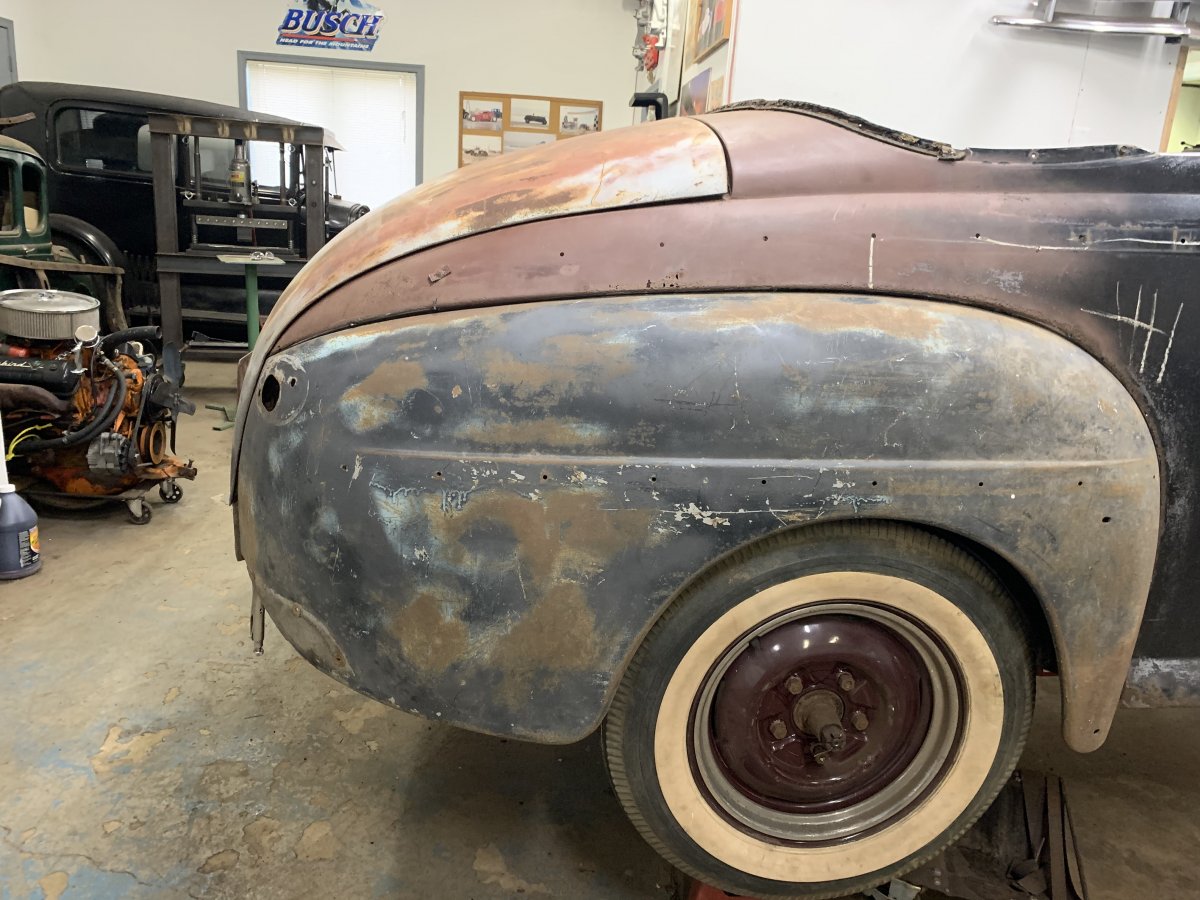

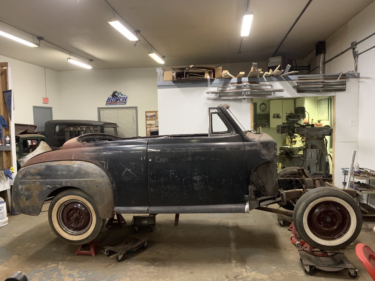

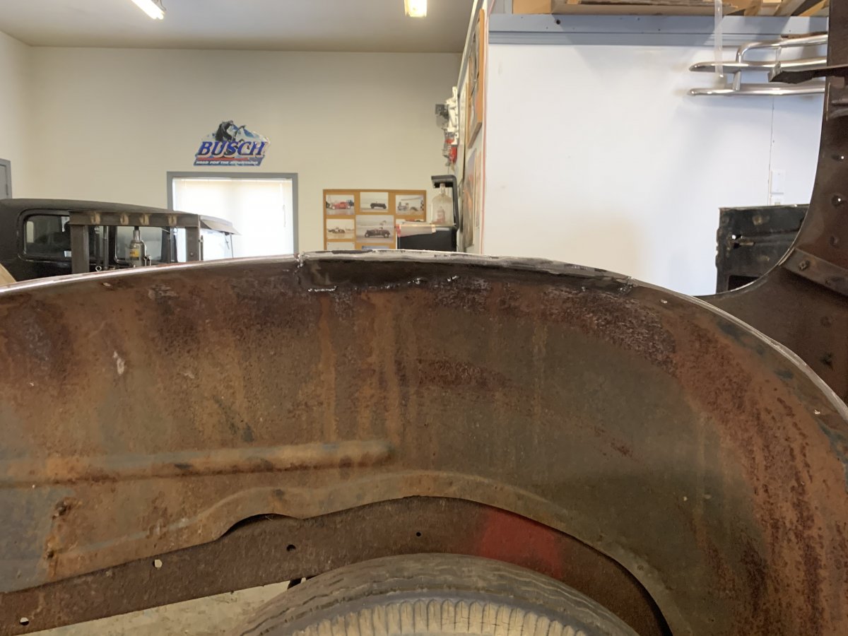

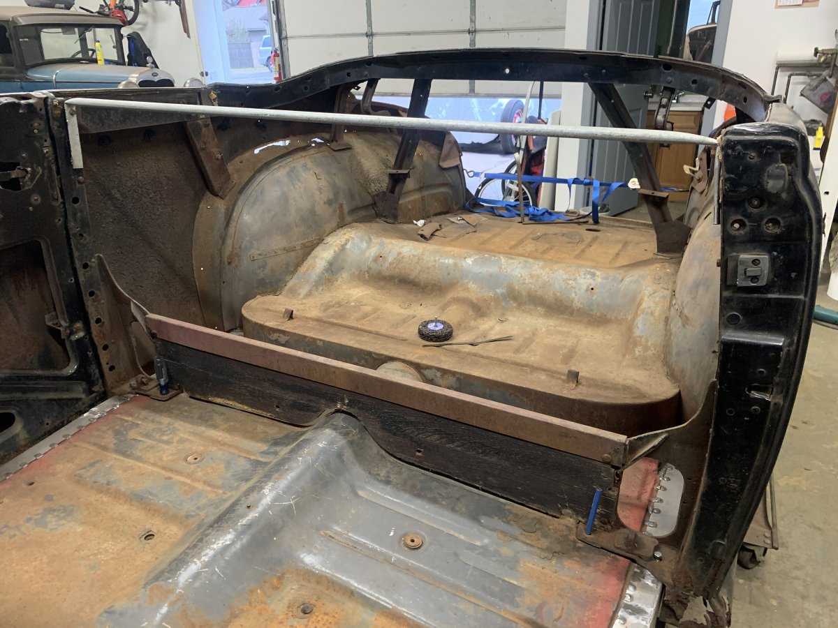

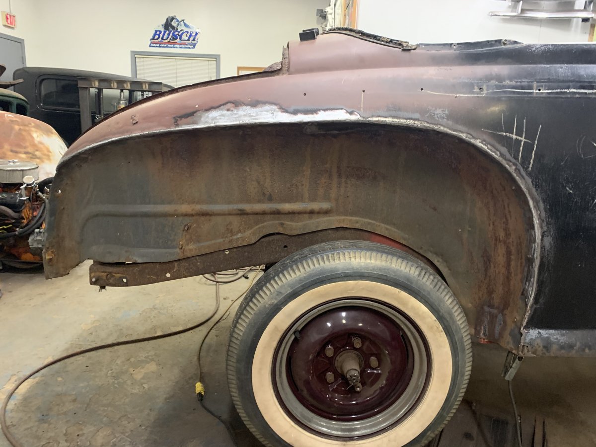

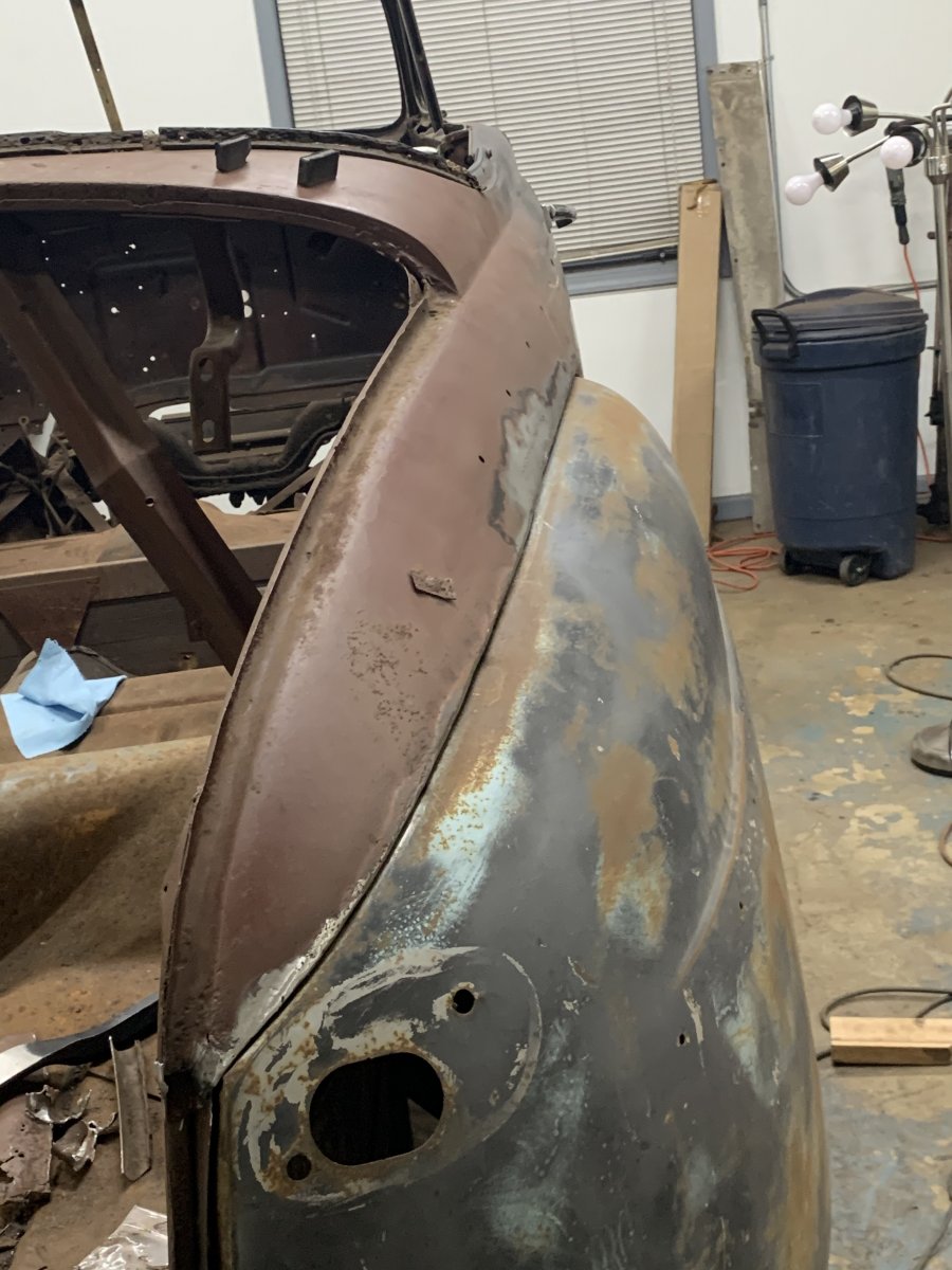

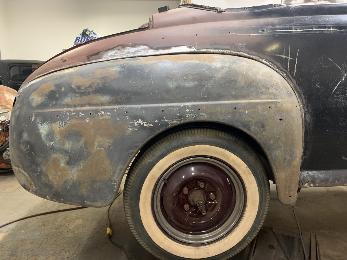

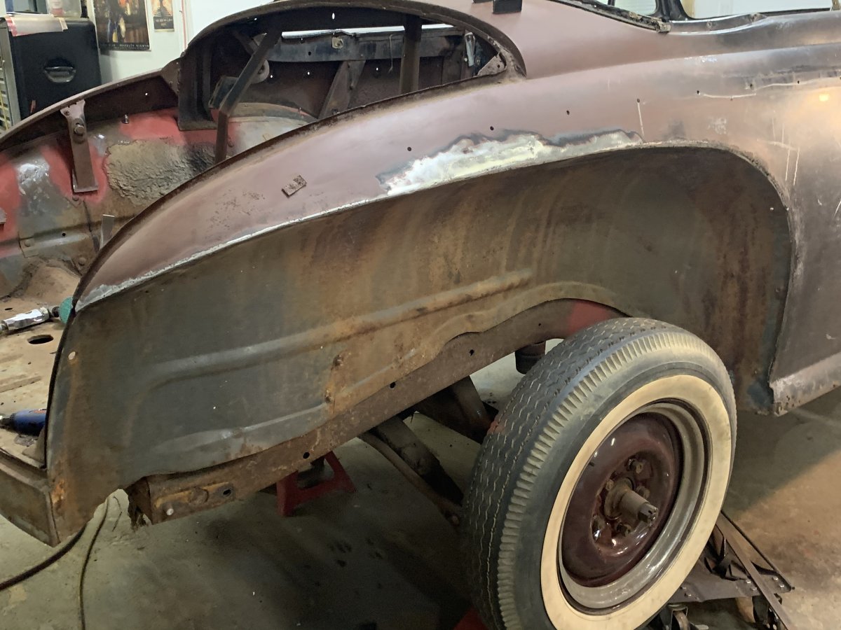

    Back in the shop for a couple hours today. Nothing too exciting, but I did finish welding the fender wells. I have more welding to do on the inside where the body supports contact the floor and the fender wells. Pretty happy with how everything lined back up. I was planning on molding the rear fenders into the body, but the fenders fit so go I really don’t need to. I’ll decide what to do later.
    0C05EC1F-AB5A-439F-A226-A7468381207B.jpeg 243EC4C4-10B0-47E2-8C37-982A128331B7.jpeg 74C8510F-0440-4D8F-BA9F-866B661BA33D.jpeg 41B52EF3-FAFE-47BC-A3E9-456C4294DF39.jpeg F2A88838-0EE0-4F0B-95EA-E0D7D2B59F40.jpeg 921F1FCF-0B67-4C59-9F98-987FDD38079E.jpeg 320E6967-7C28-4495-9173-E53CDD65CEEC.jpeg 1CE5B10E-6A0C-4CC4-94E2-D6686DE1308E.jpeg D3C8F907-2AC0-4176-ACD9-6A4D9A0BD47B.jpeg 2AA746BA-3AAA-403A-90BD-02EBA841AA06.jpeg
    I also need to decide if I should weld the seem on the inside where the rear section over lapped the fender wells, or just use a seem sealer.
