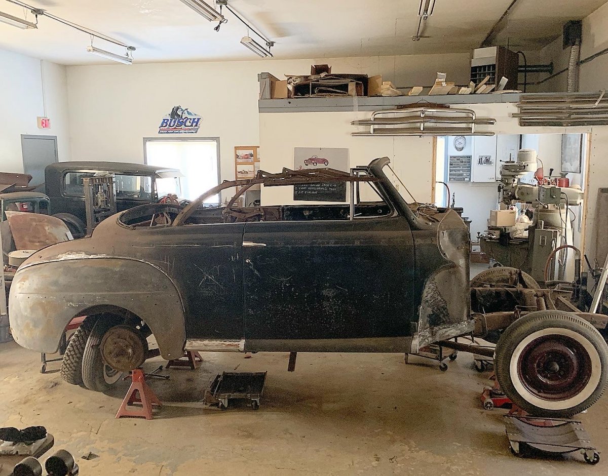

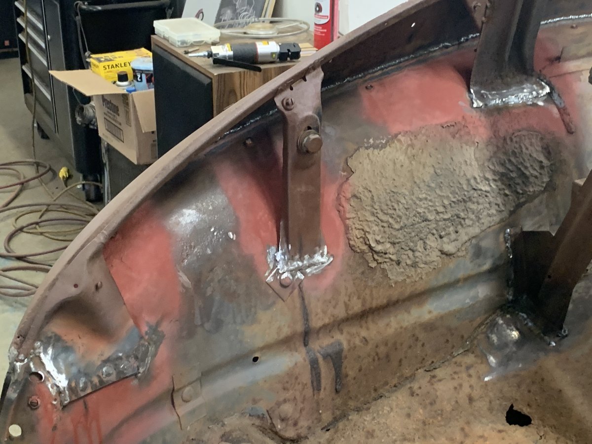

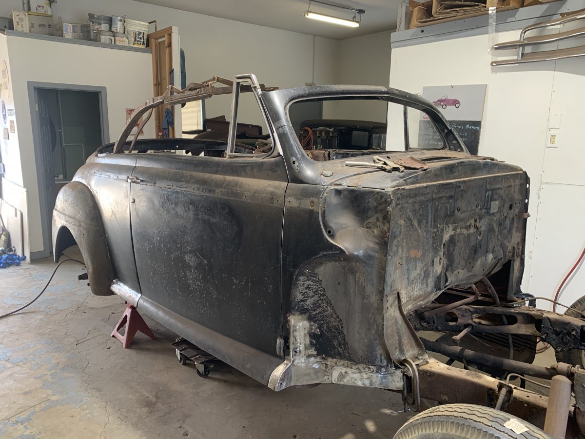

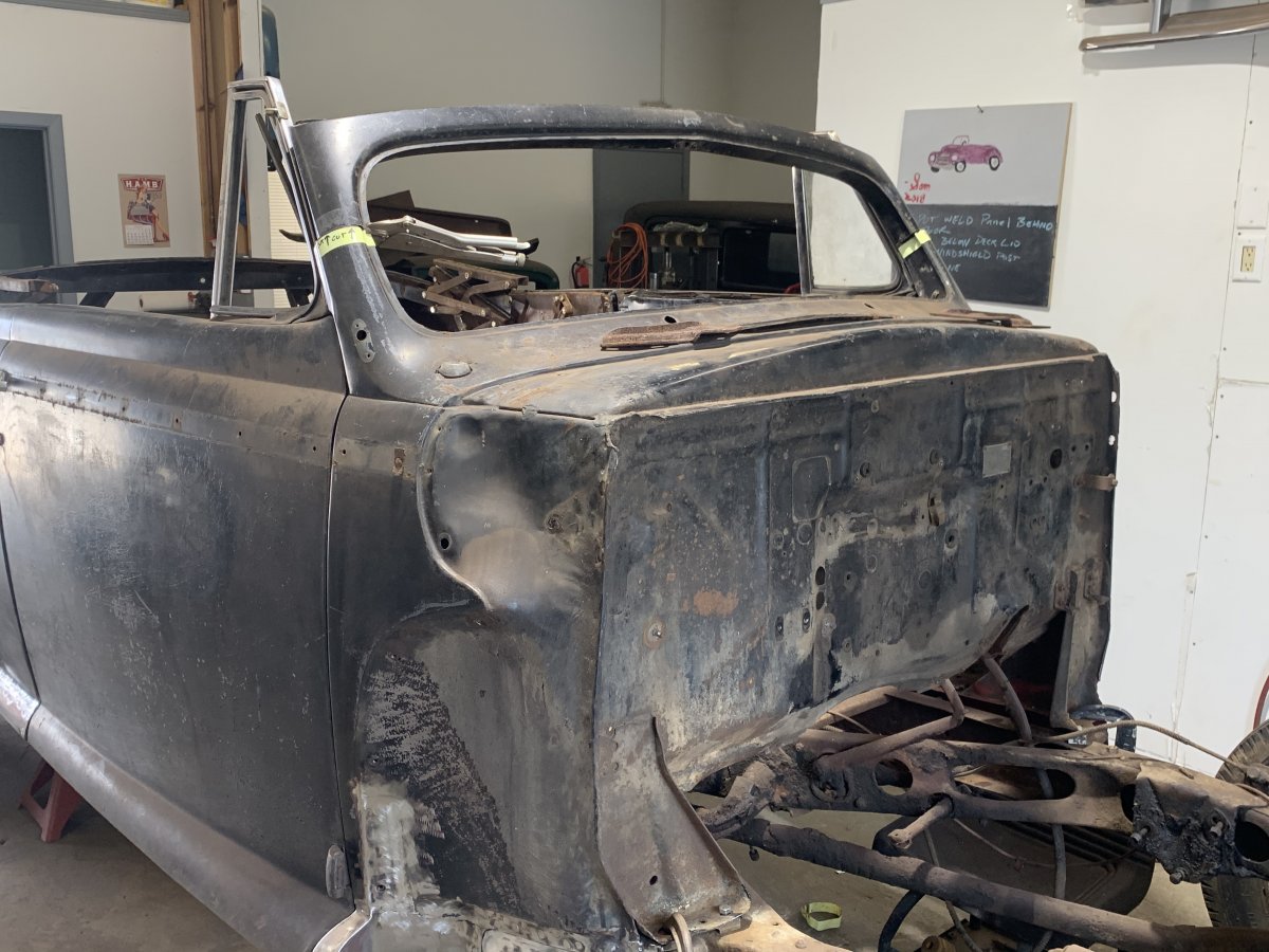

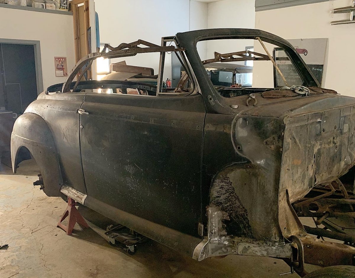

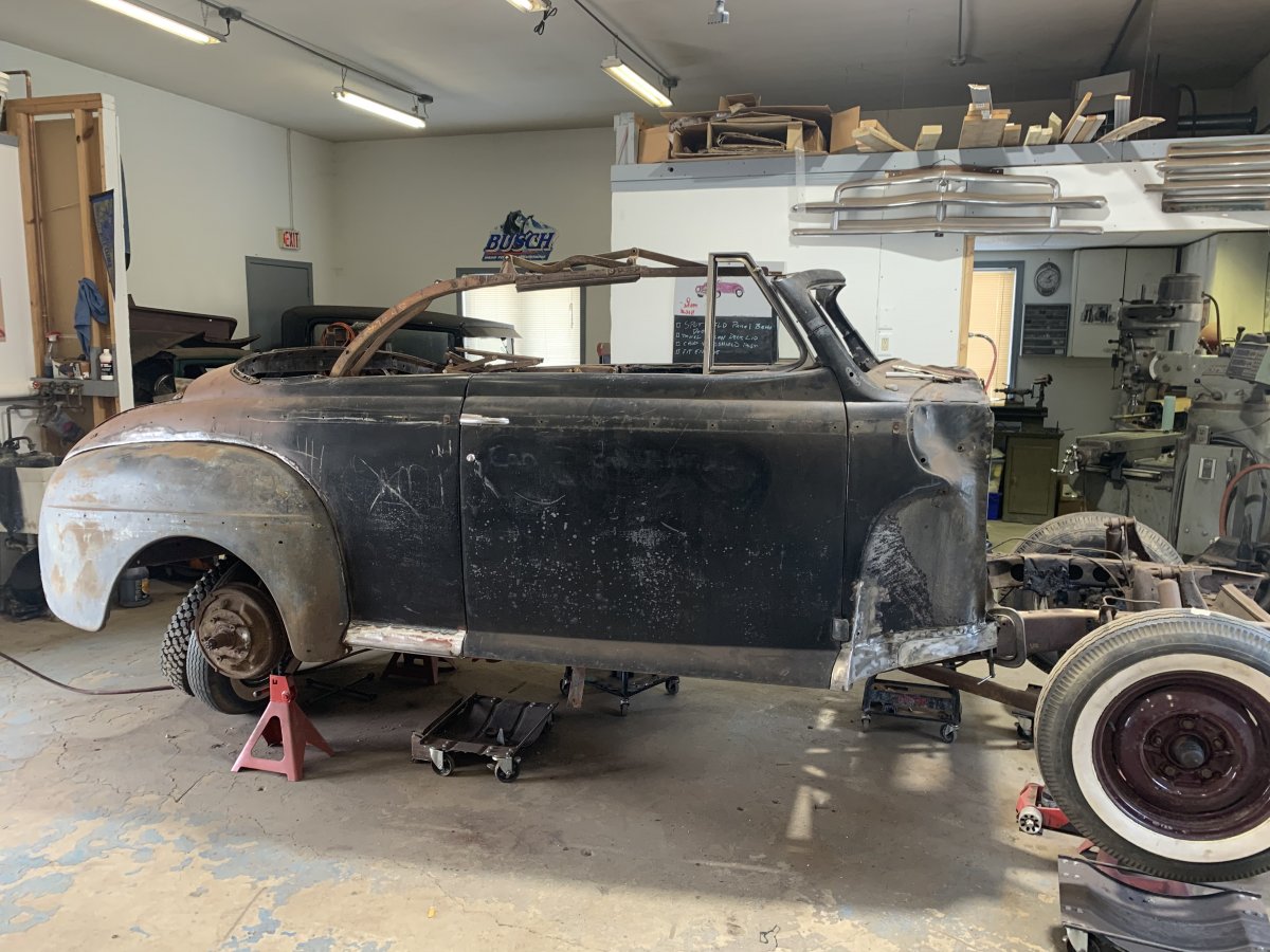

    Got some work done. Nothing glamorous but stuff that needed to get done. I welded the inner seam where the convertible body section overlapped the donor Tudor body section. I also welded and repaired the body structure supports to the floor and inner fenders. Last was reshaping the rear body structure bracing of the convertible body to tie in with the donor.

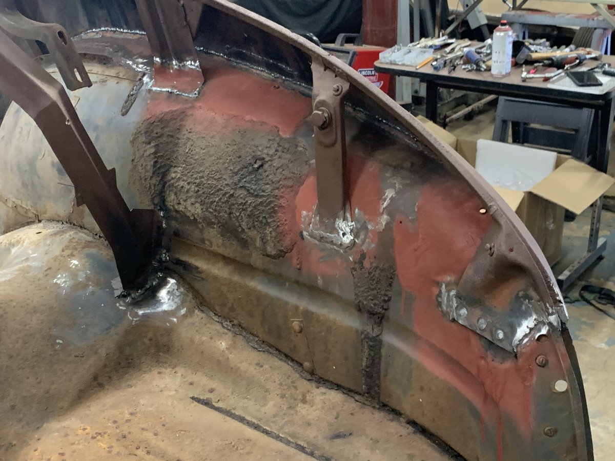

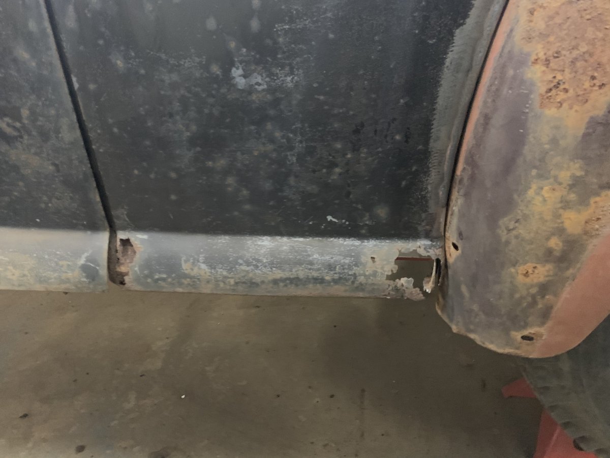

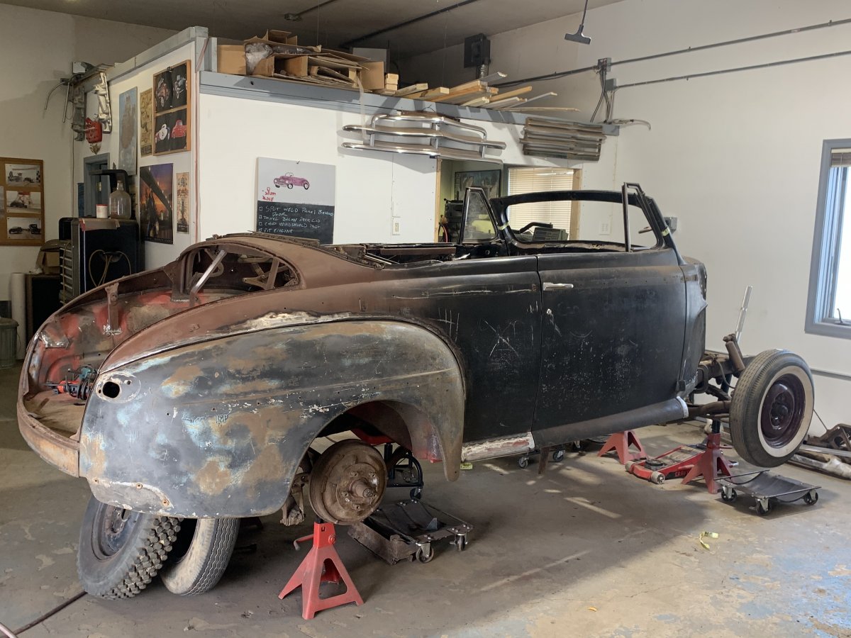

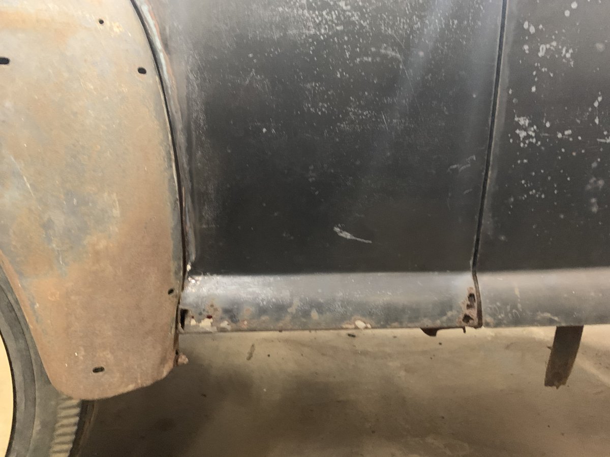

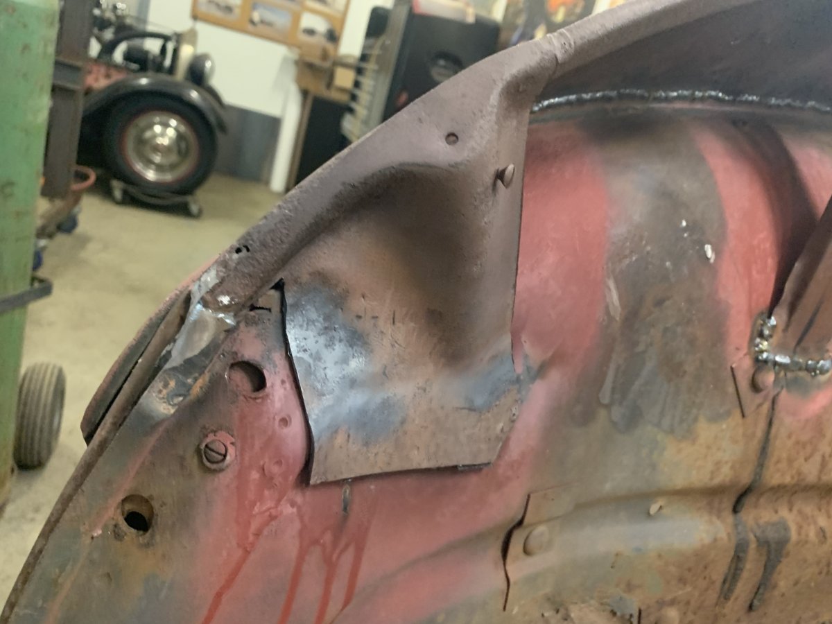

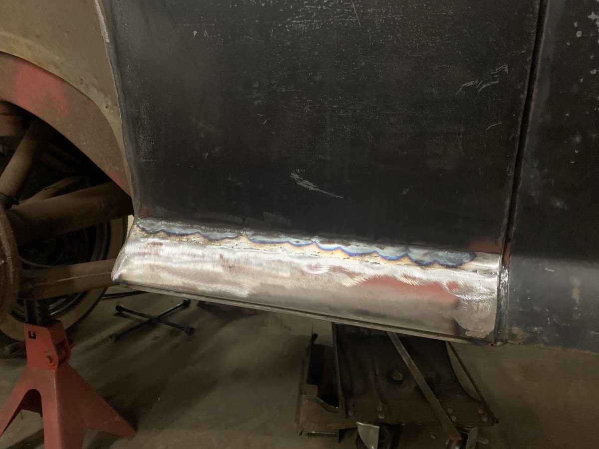

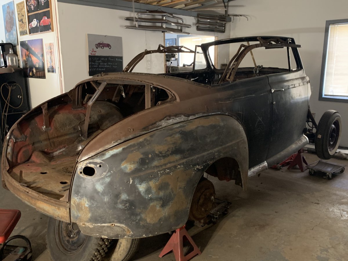

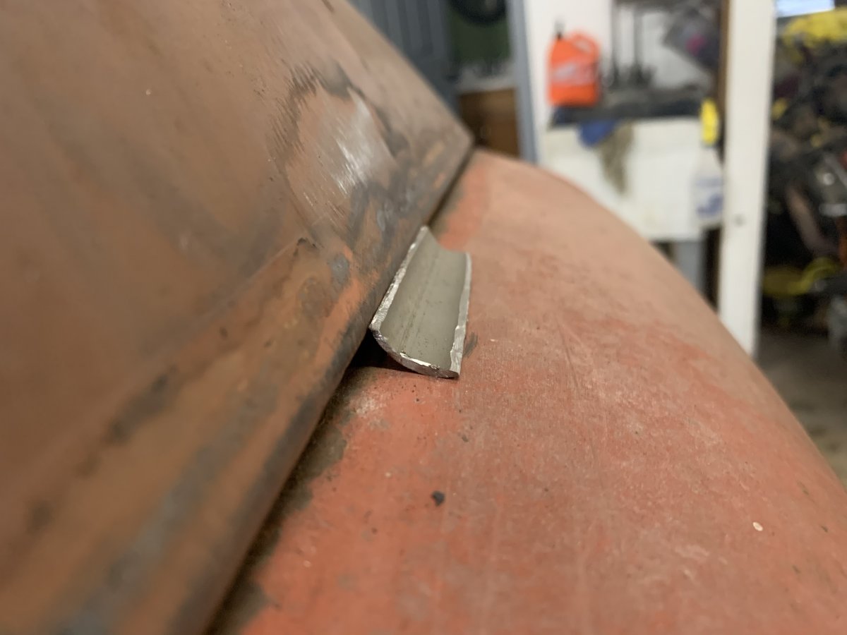

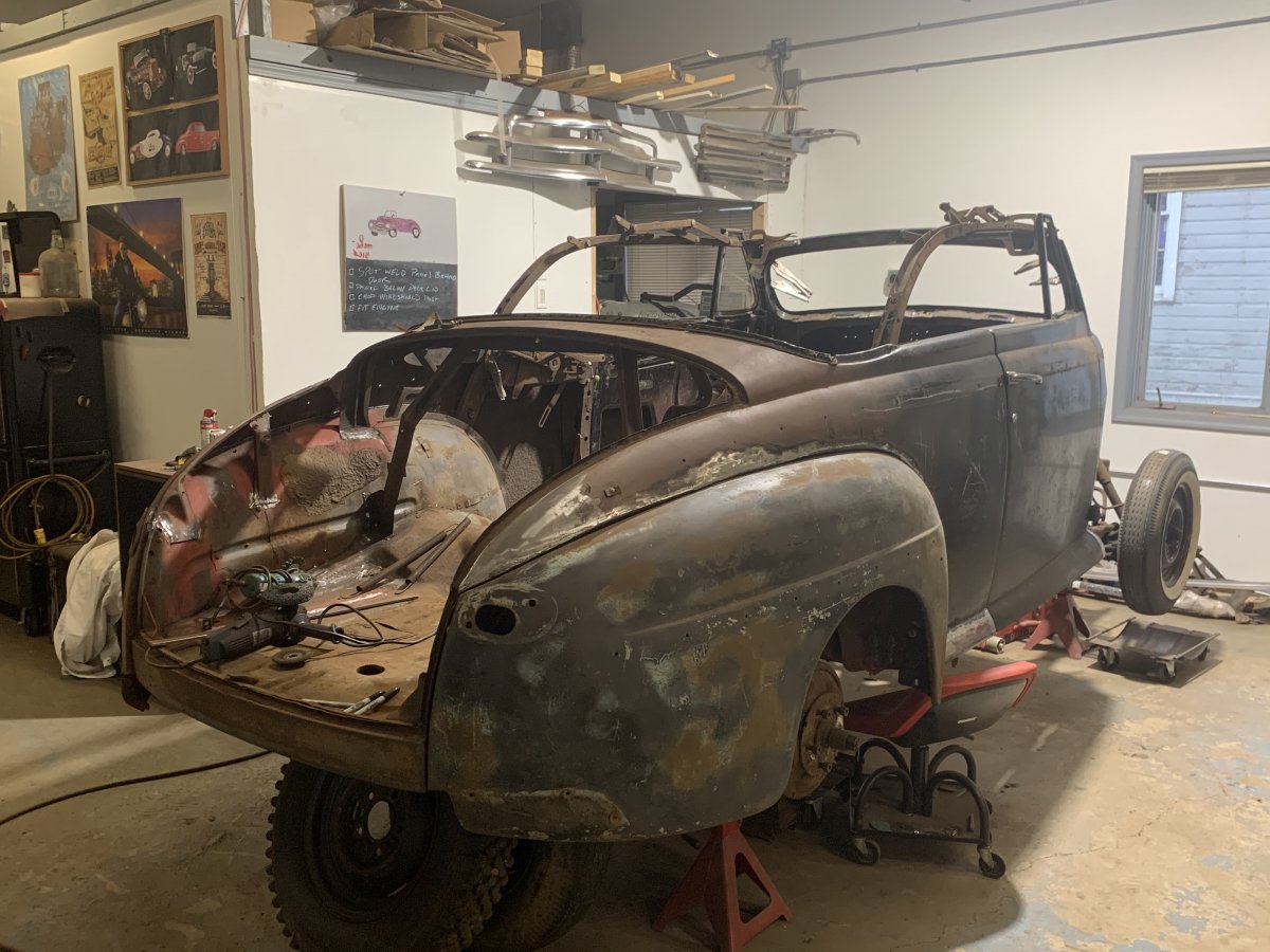

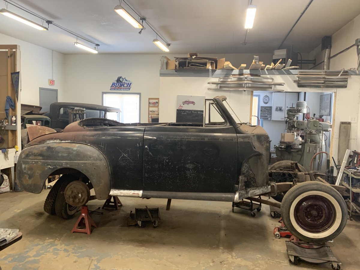

    Started working on the quarters. This is the last major rust repair on this old heap.
    96597DF8-F2B7-4B23-874D-FD29D09EB604.jpeg 46C9CCDA-ADD1-4DA2-98FE-A1B92C280C7D.jpeg 2D48142A-535A-4FDA-8CA7-723525373356.jpeg 7A313F9E-520F-4B63-B484-0D15DB1696DE.jpeg 80F1E615-0226-4342-8BD2-83207E6F99D5.jpeg FFE176CC-FBDD-47E6-9FEE-8B50D57BAFE7.jpeg
    I also started messing around with different ways to mold the fenders in. I am leaning towards using 1” tube and shaping it around the fender then cut out the section I need for it to flow into the body and fender.

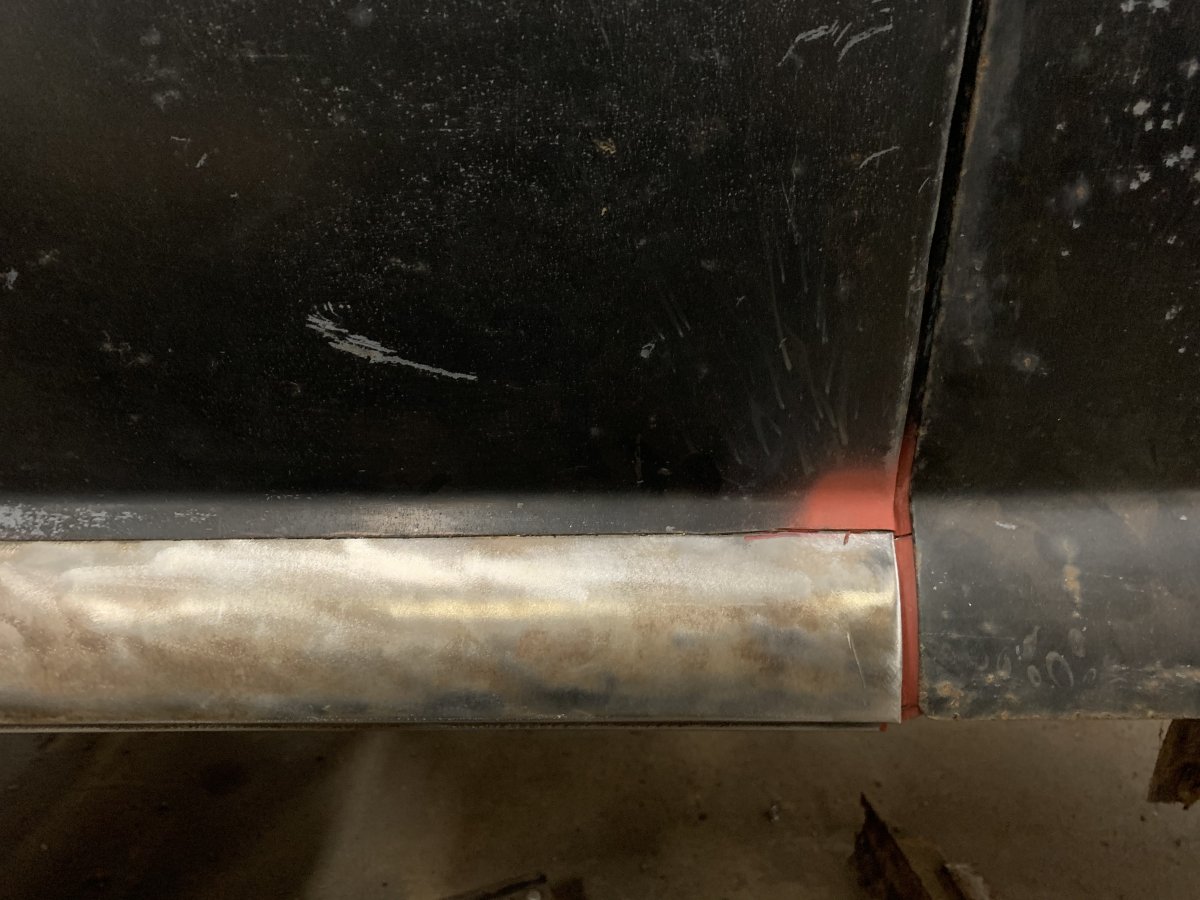

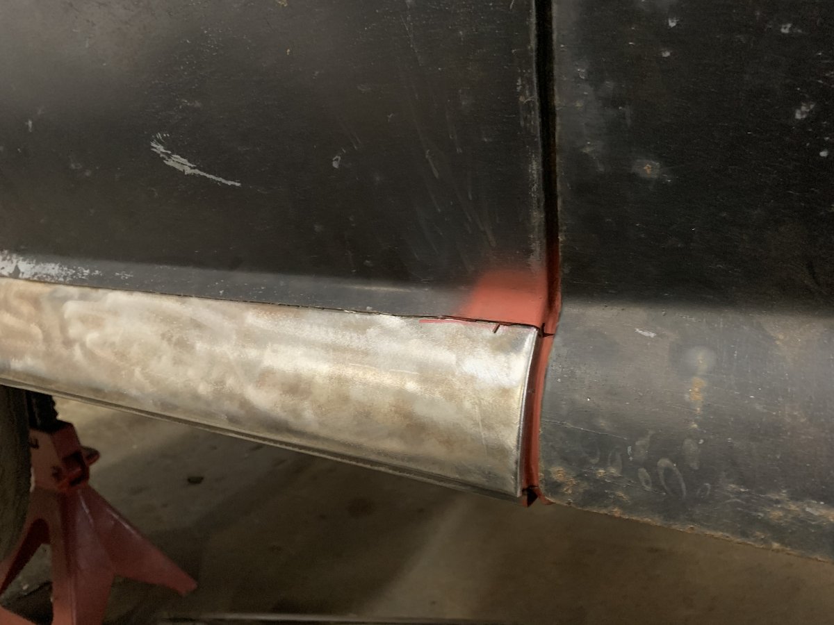

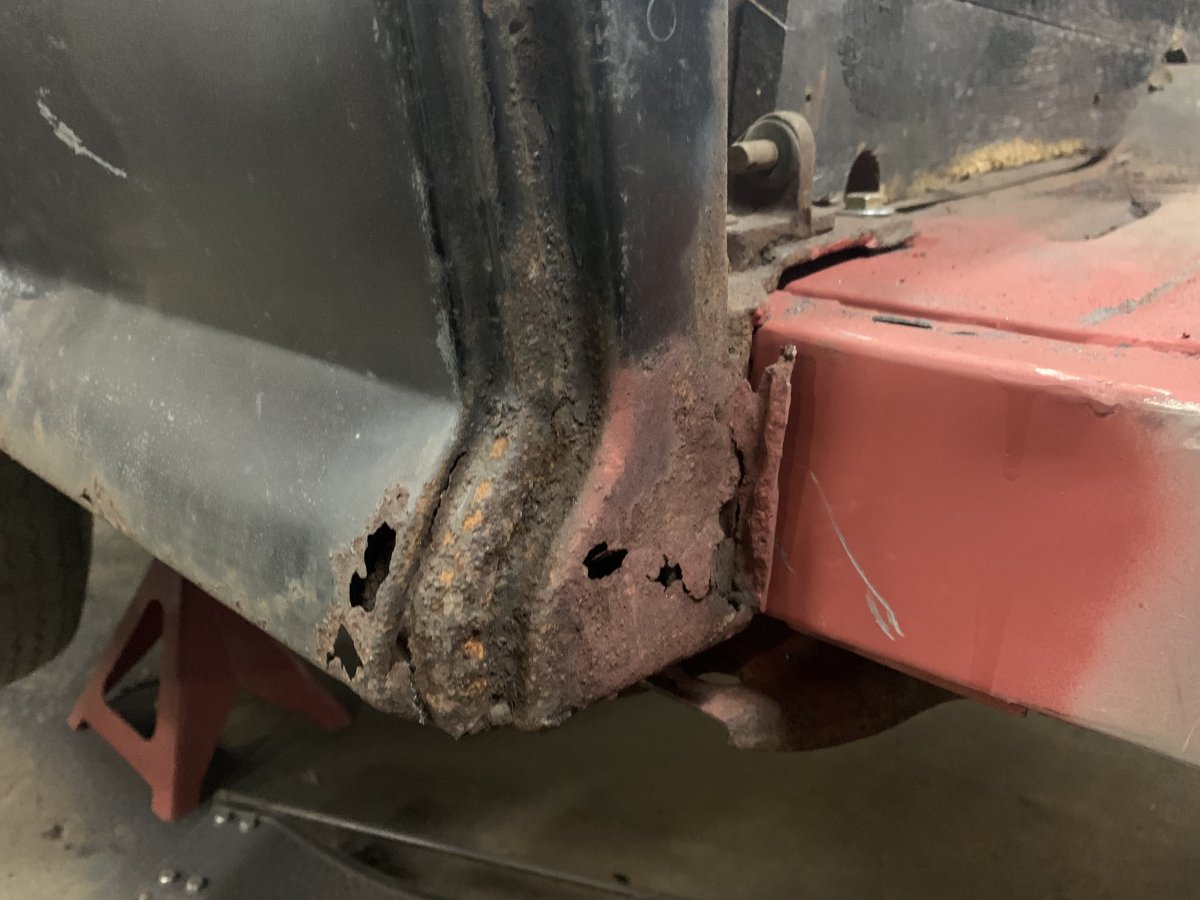

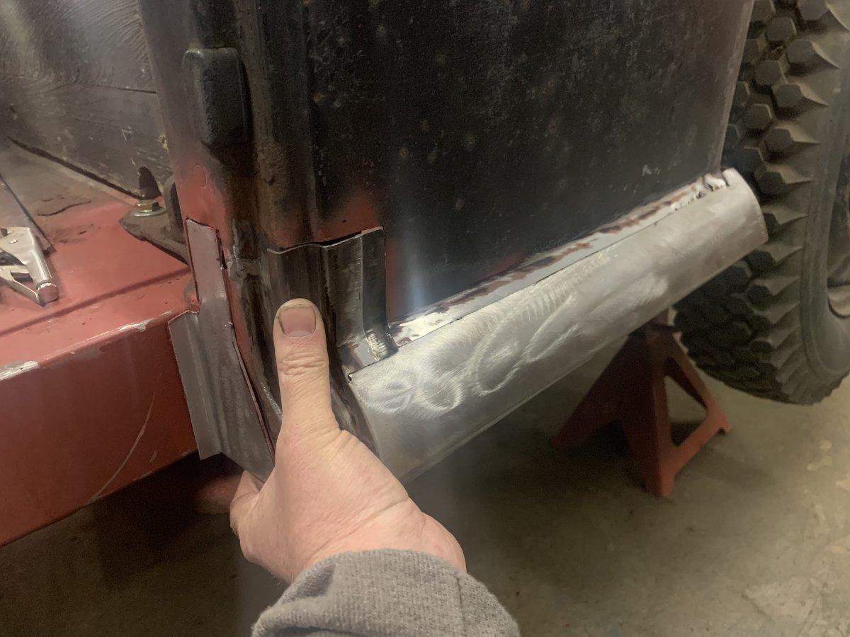

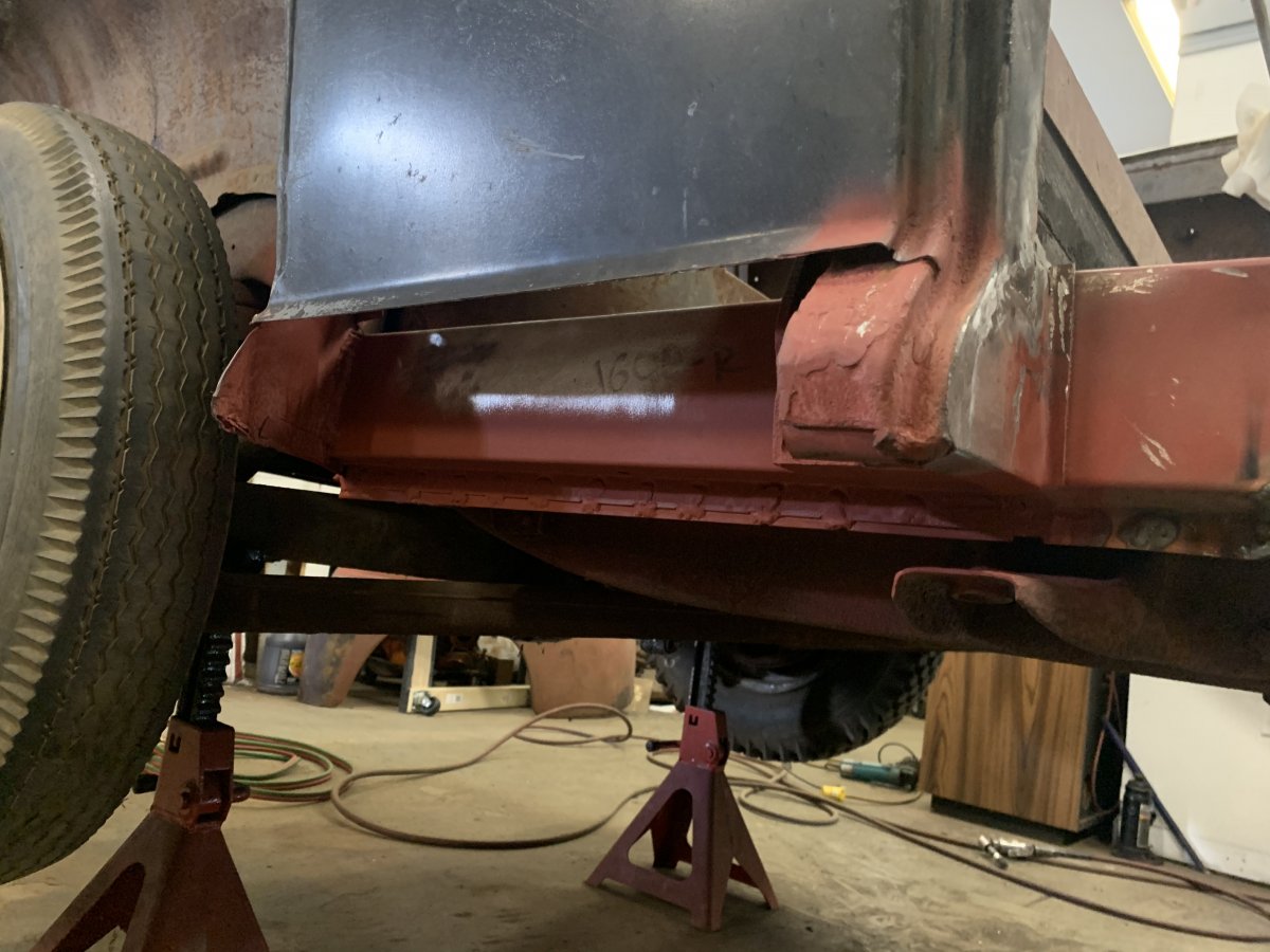

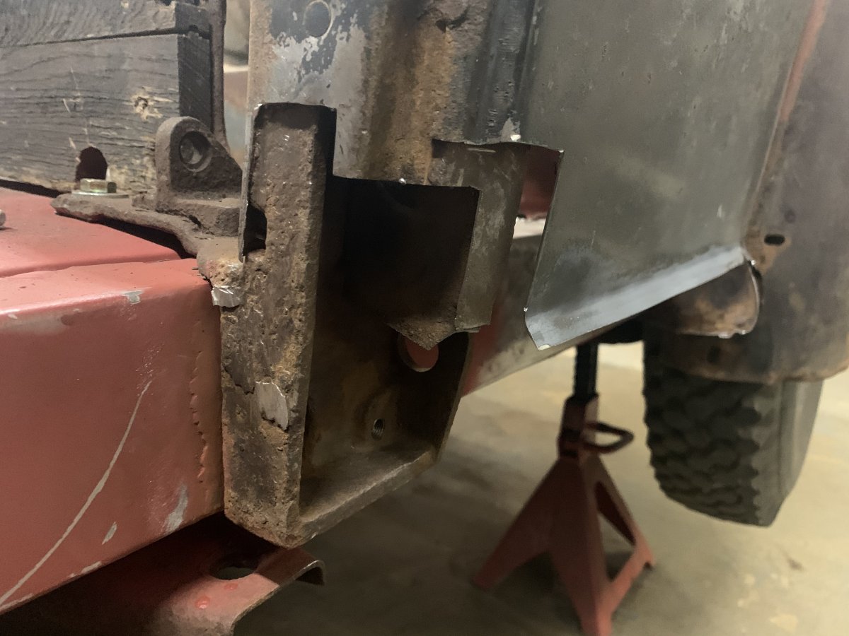

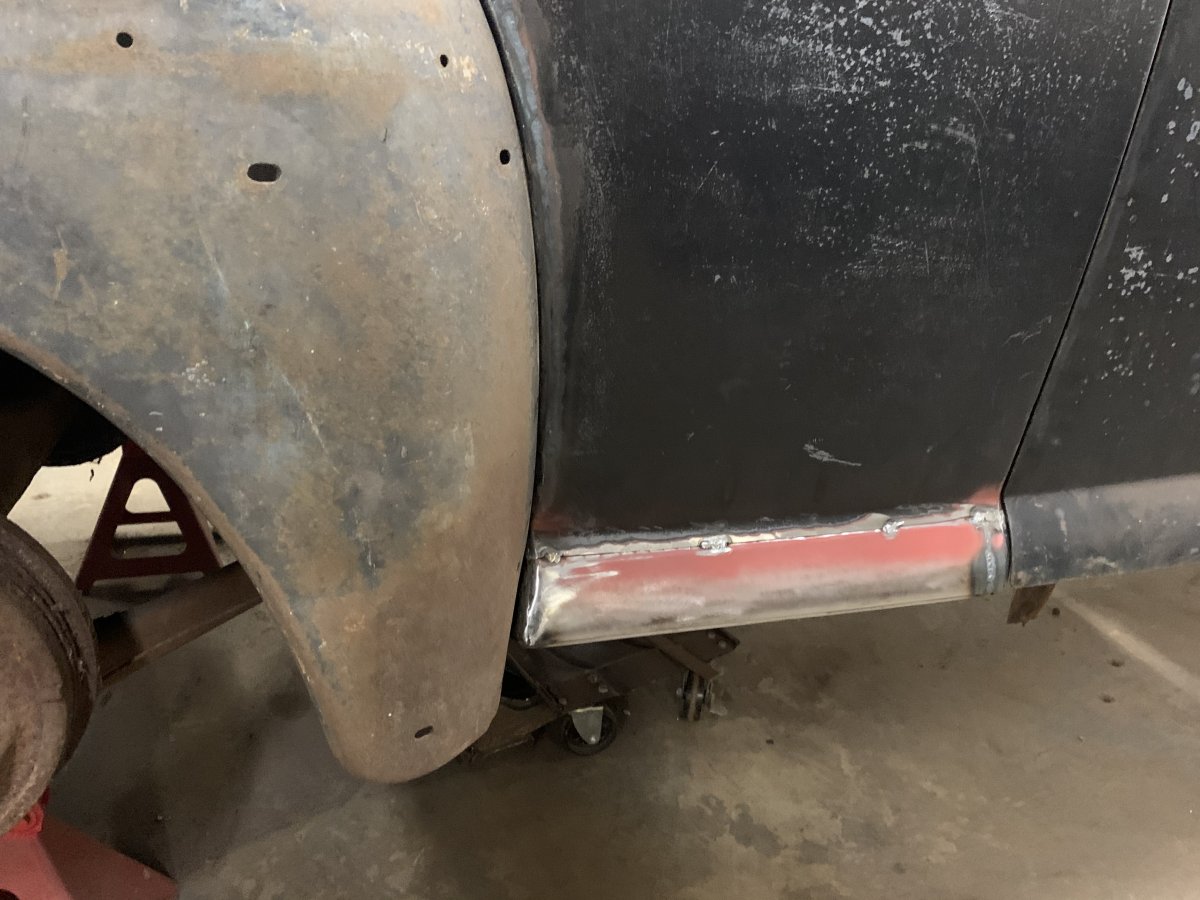

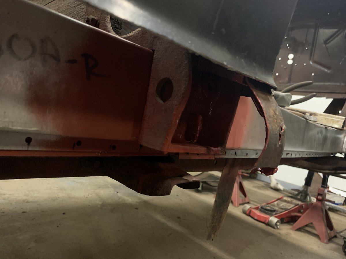

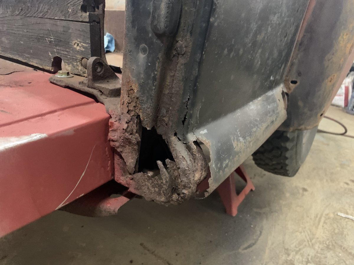

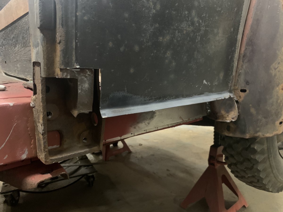

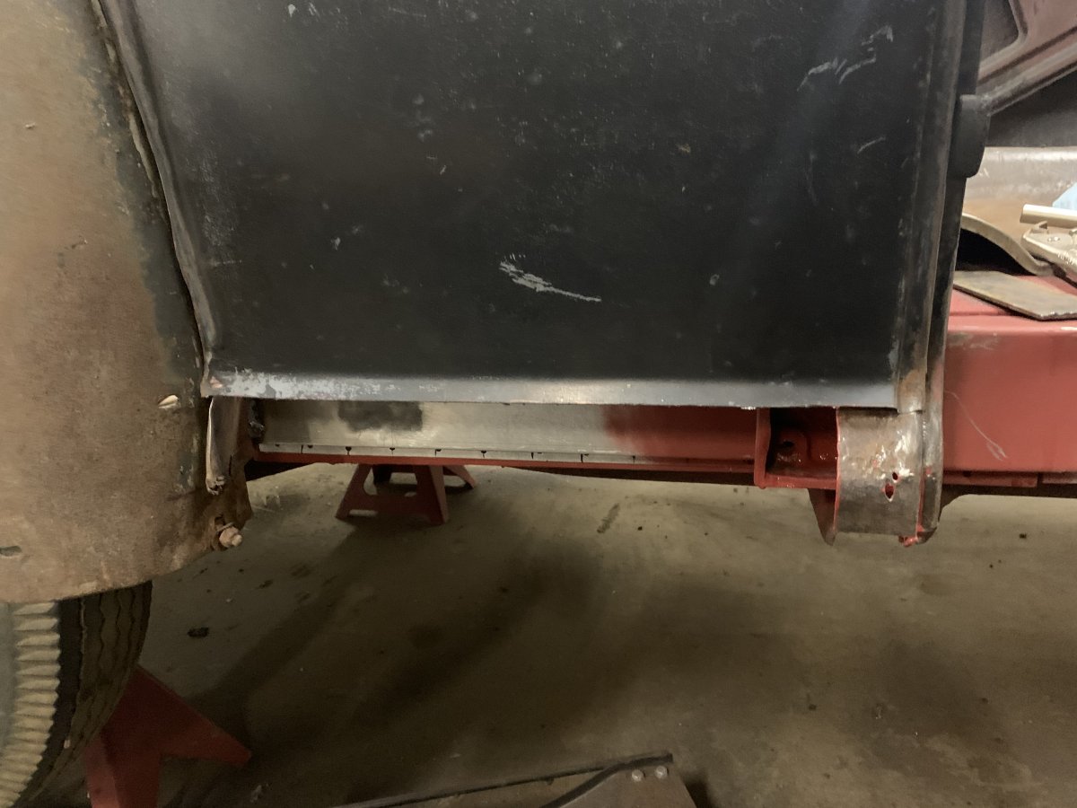

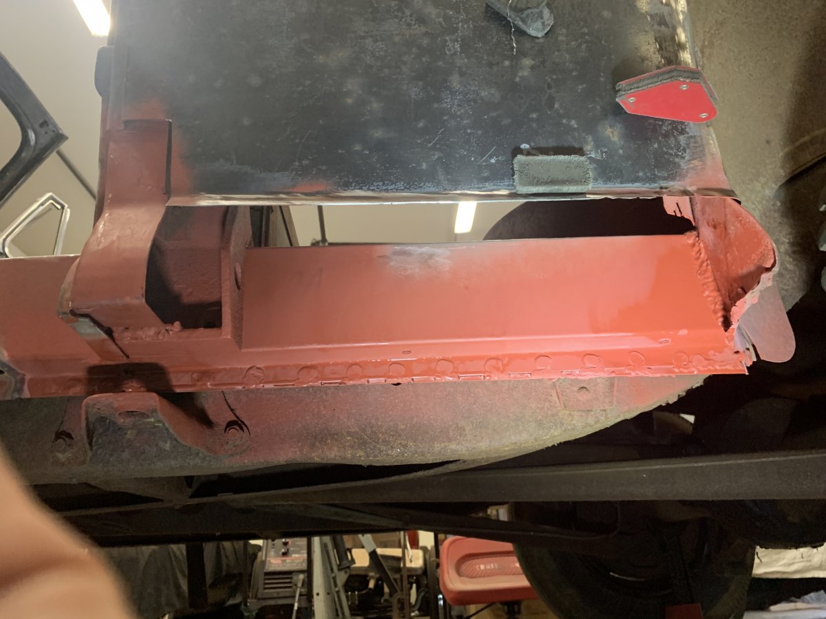

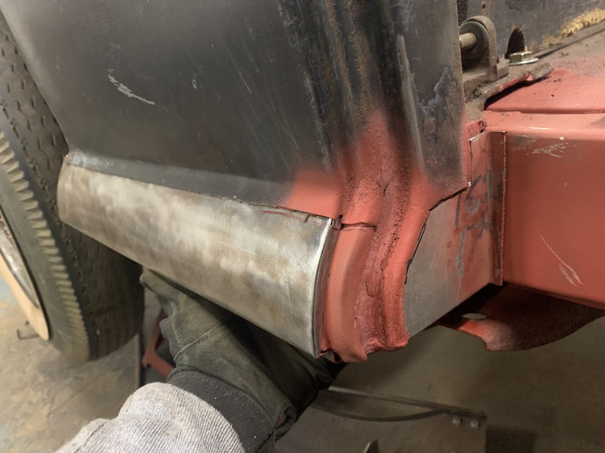

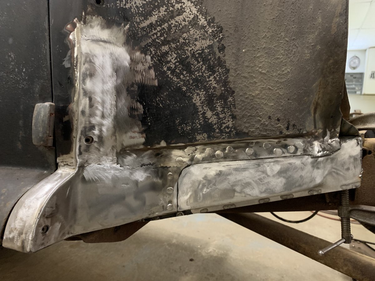

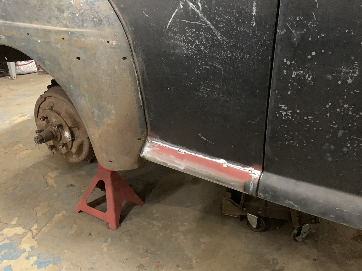

    Made some progress fabricating some panels for the p***enger side. Not welded in yet, just fitted. I also stiffened up the running board attachment to the b-pillar, original method was a little flimsy.
    DAF15844-A174-40BC-9559-BAC8A4D3BDC4.jpeg 9AAD0DA1-E3FD-4485-8FFC-BCA163F91735.jpeg 30B9084C-807B-48C1-8EC0-B2E5D68FE506.jpeg
    I also started to cut out the drivers side. It’s much worse, more of the structure is rotted away.

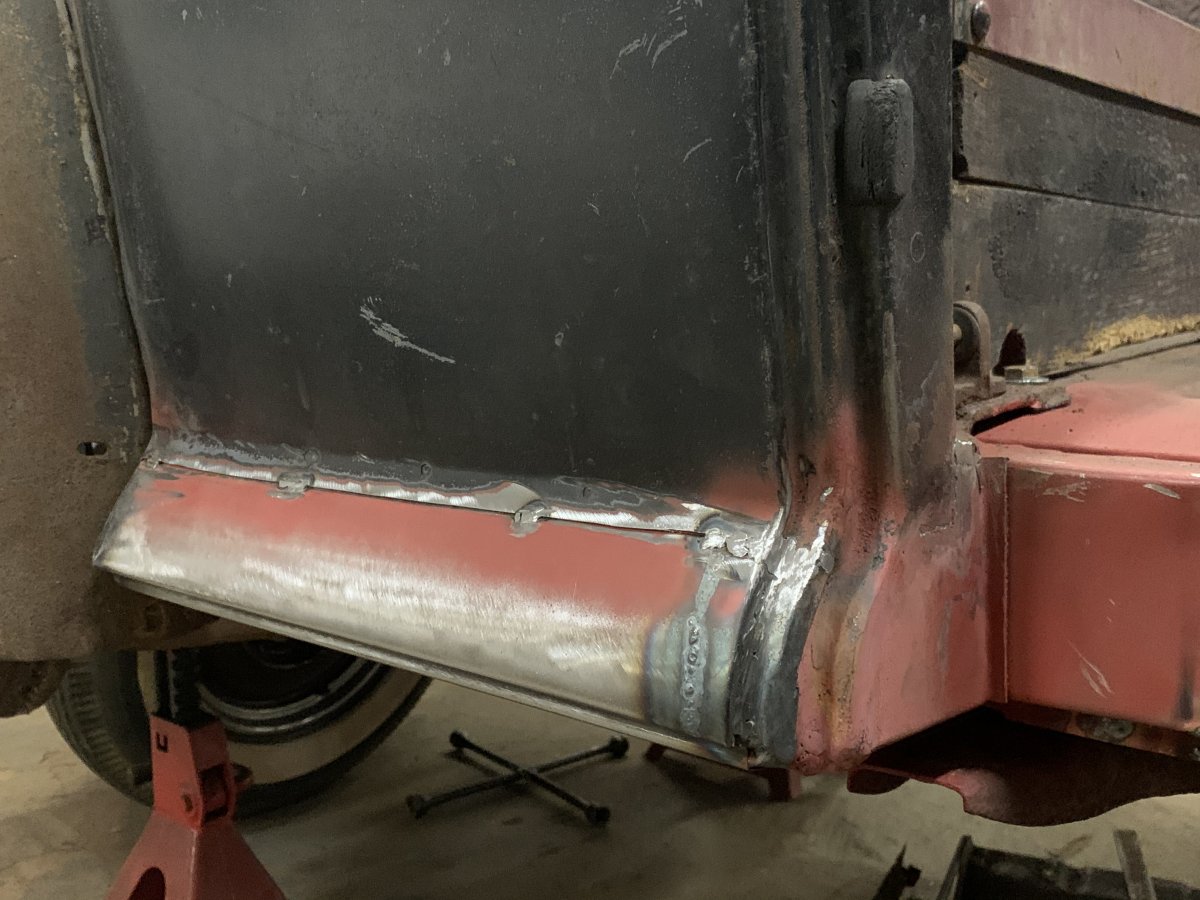

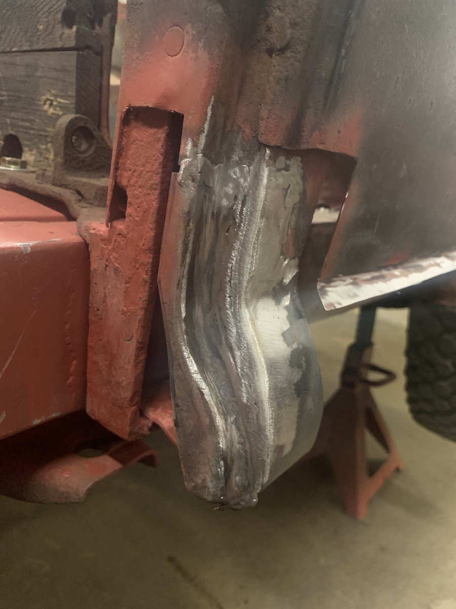

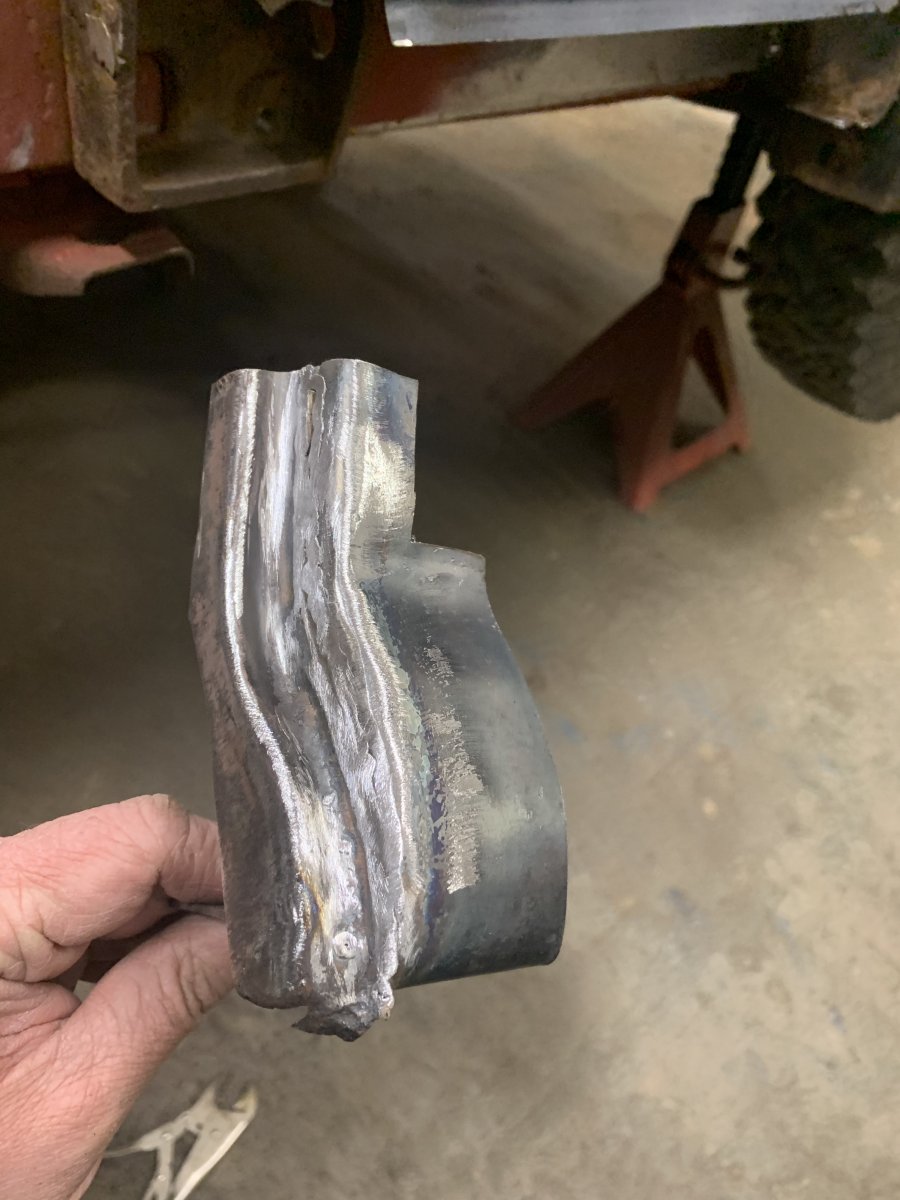

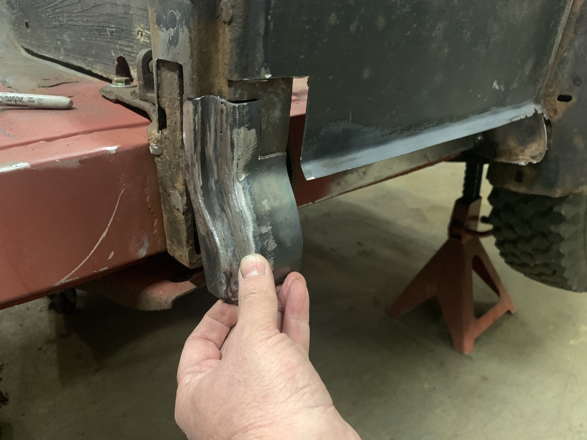

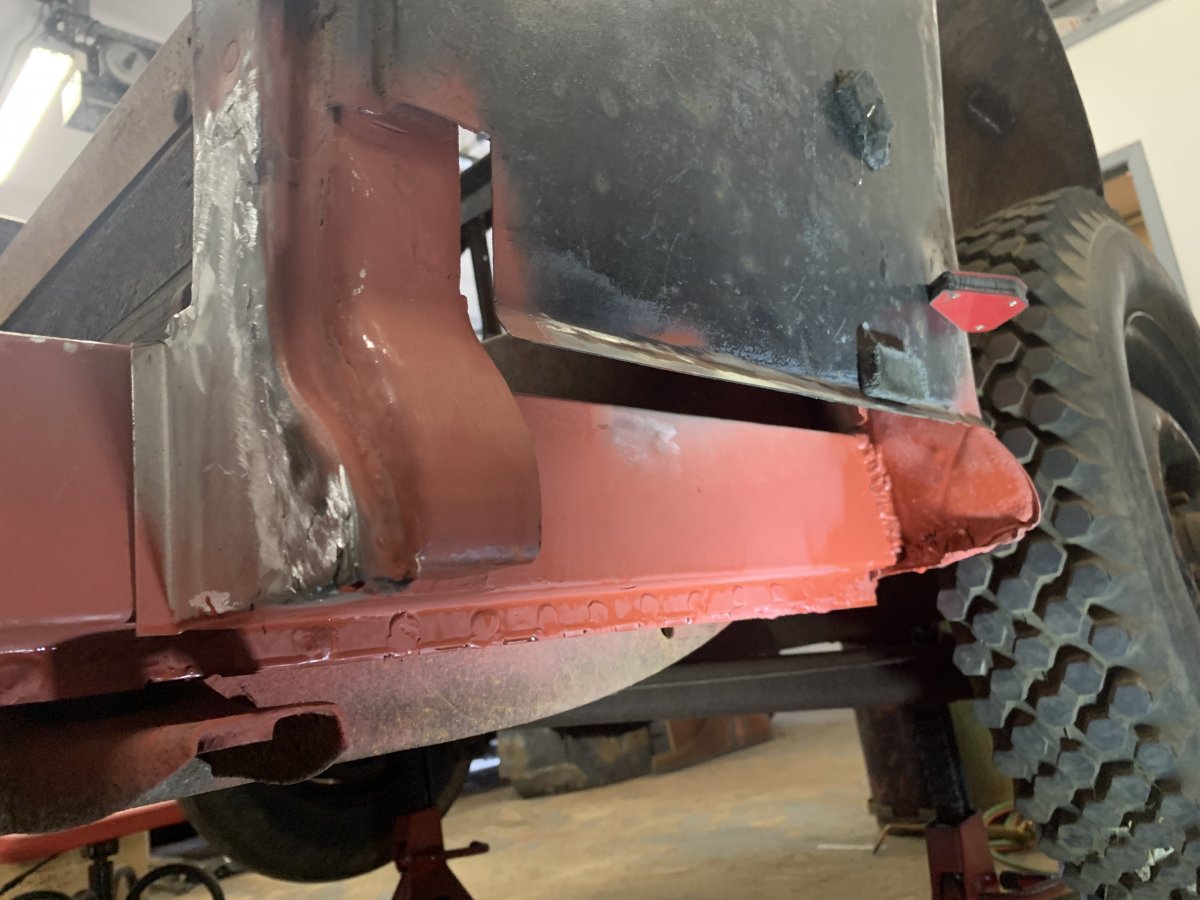

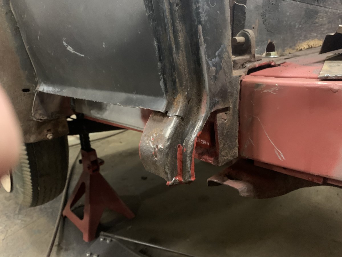

    Got a couple hours in the shop today. I beat a new lower B-pillar piece into shape.
    89982D0B-51C6-472D-AA33-4D0AFE31C0D1.jpeg 75658C91-5380-416D-8034-D7D868E190DB.jpeg B1C6F331-E4E7-47A9-BBCE-459694DF585D.jpeg F96B719B-B226-4089-9F63-30436F04F504.jpeg

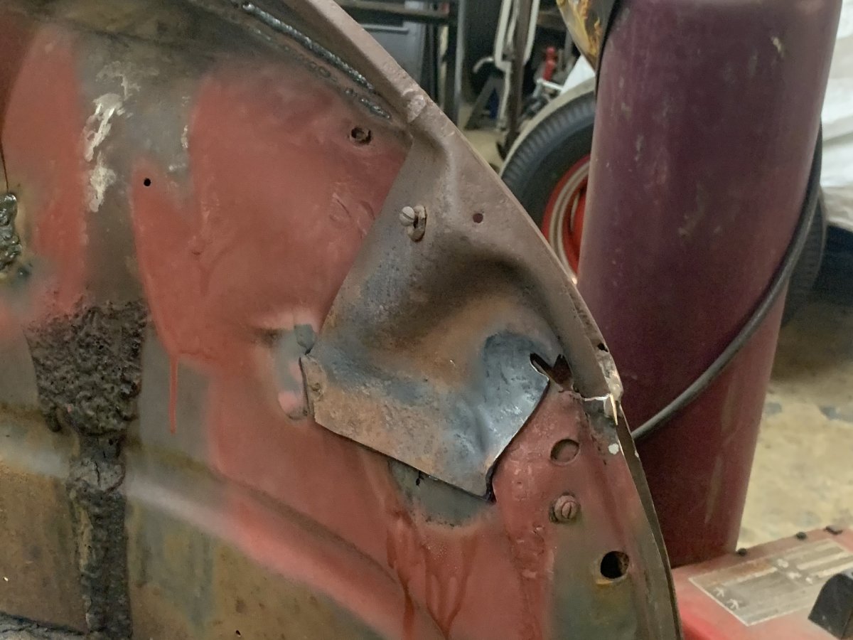

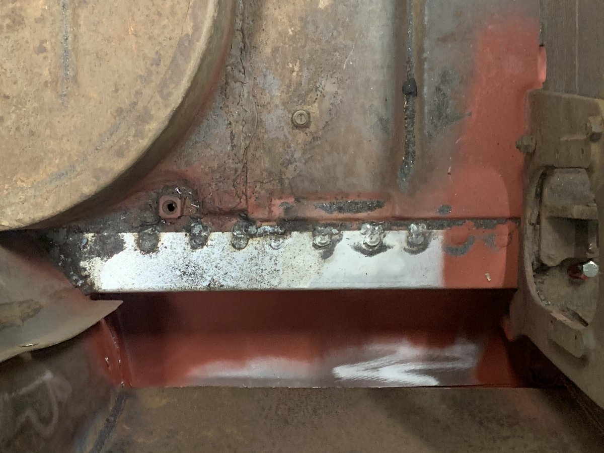

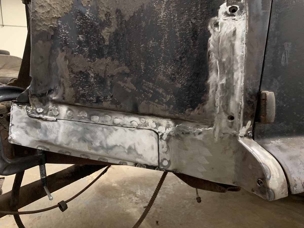

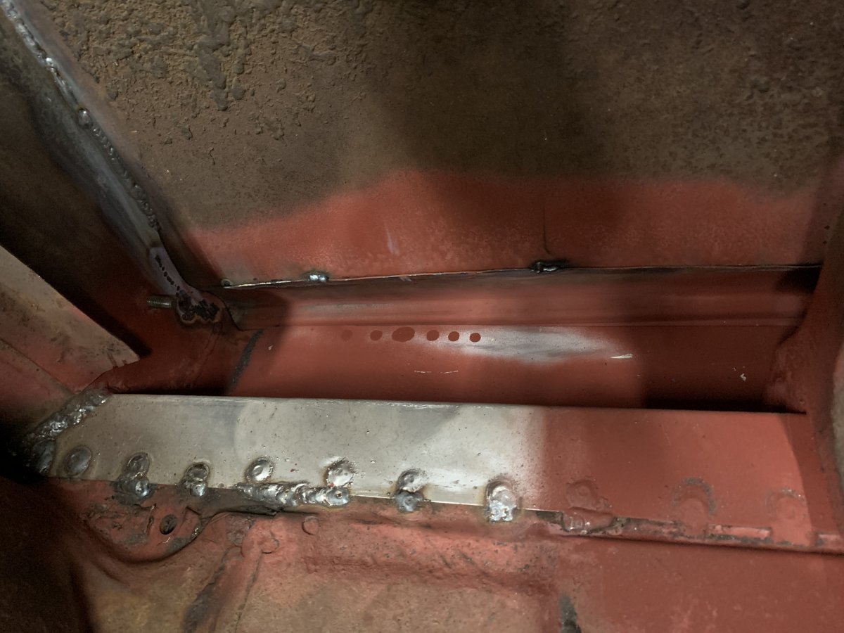

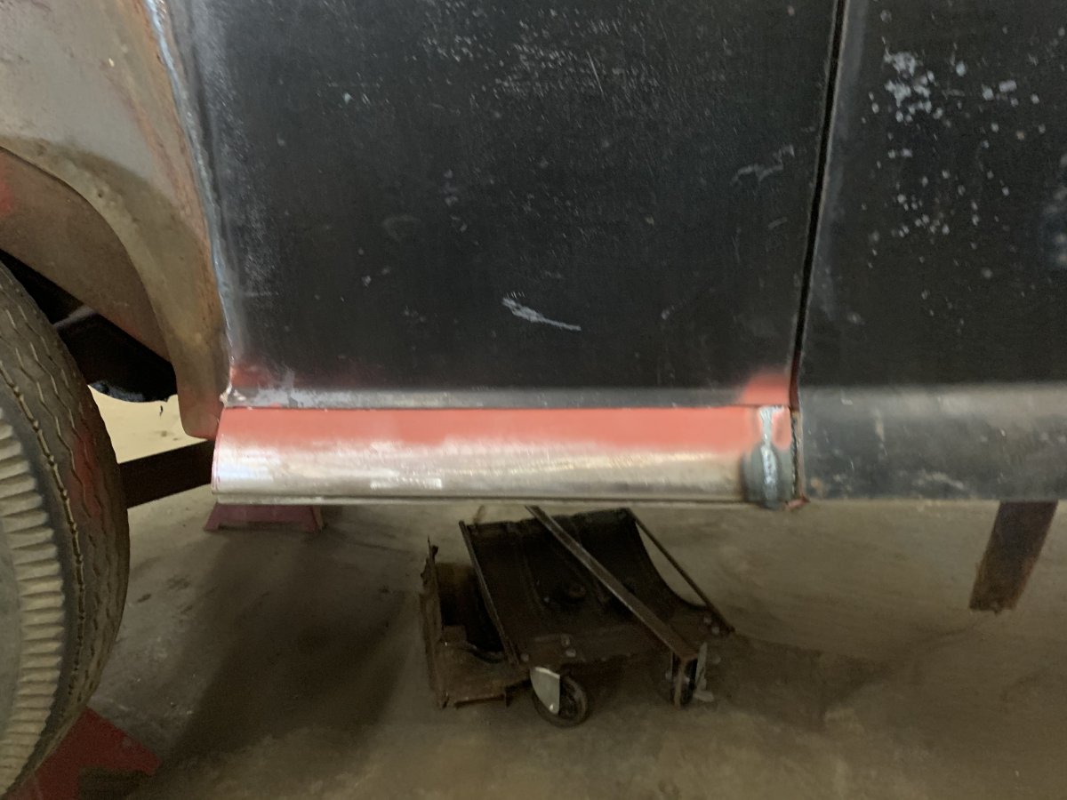

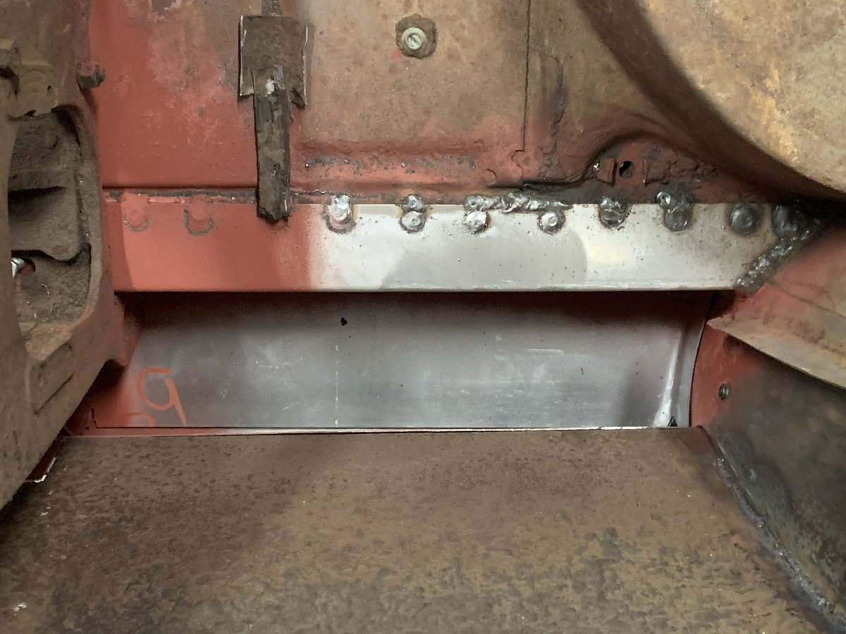

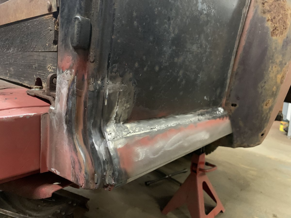

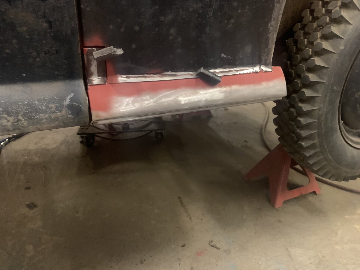

    A little bit of work accomplished this weekend. I nearly forgot about the panel that goes between the rocker and the quarter panel between the B-pillar and the inner fender. It needed to go in before the lower quarter patch.
    DC73D843-654E-4897-BC22-DEE734A52984.jpeg 23A71D18-0213-4C60-B137-C7D90BB51707.jpeg CC7560C7-4C57-497F-B0CD-6B4F0A7F8115.jpeg 9C682AD3-2633-4B3A-9AE5-6666AB9ACBCF.jpeg BA512BFB-5B12-4A53-9949-92B9A60A3F7A.jpeg 7283C219-E20D-4B93-B8FA-2381031017BC.jpeg

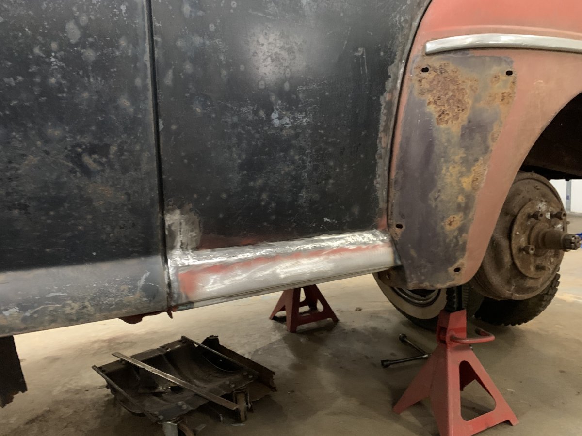

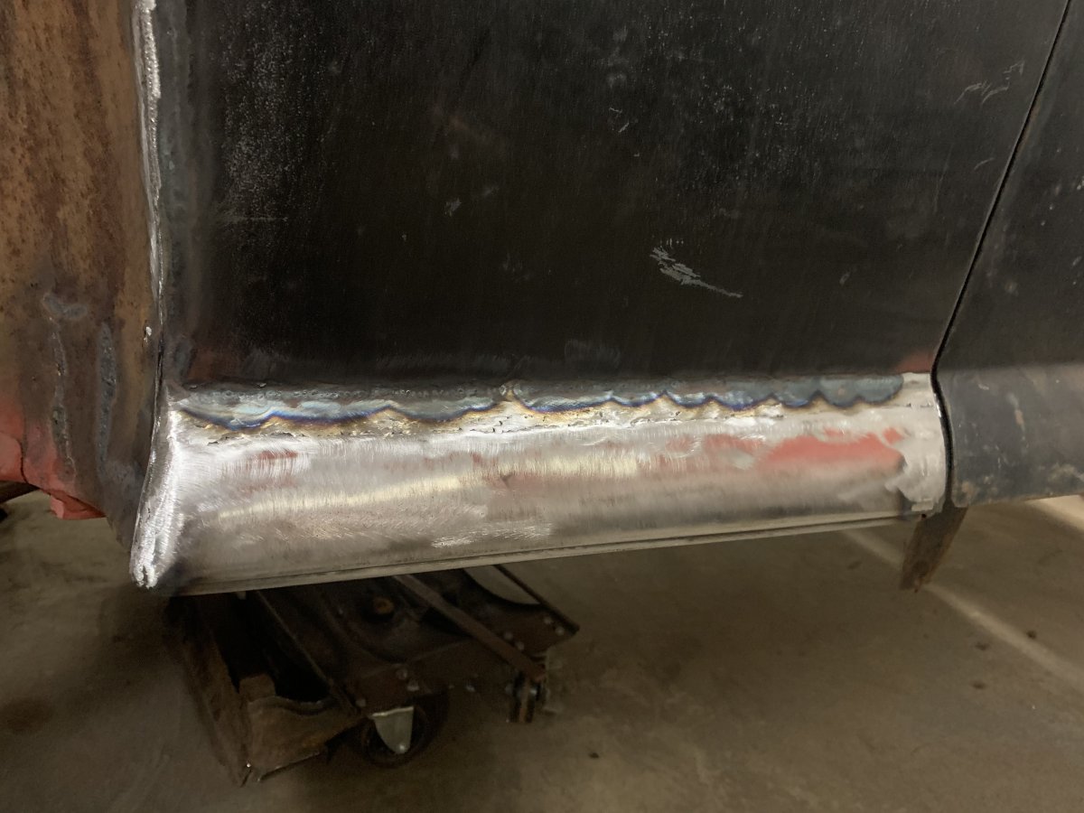

    I got some more work done today. There is more metal work needed on the drivers side but it’s close. The p***enger side is welded in on the ends but the seem needs to be finished. Both sides still need the inside welded. I am happy with the how they turned out.

    P***enger side is welded and I welded the inside lip of the panels on both sides.

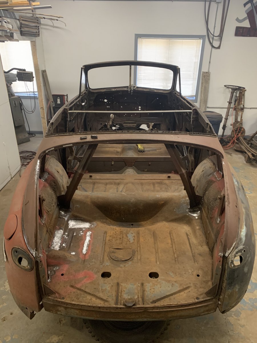

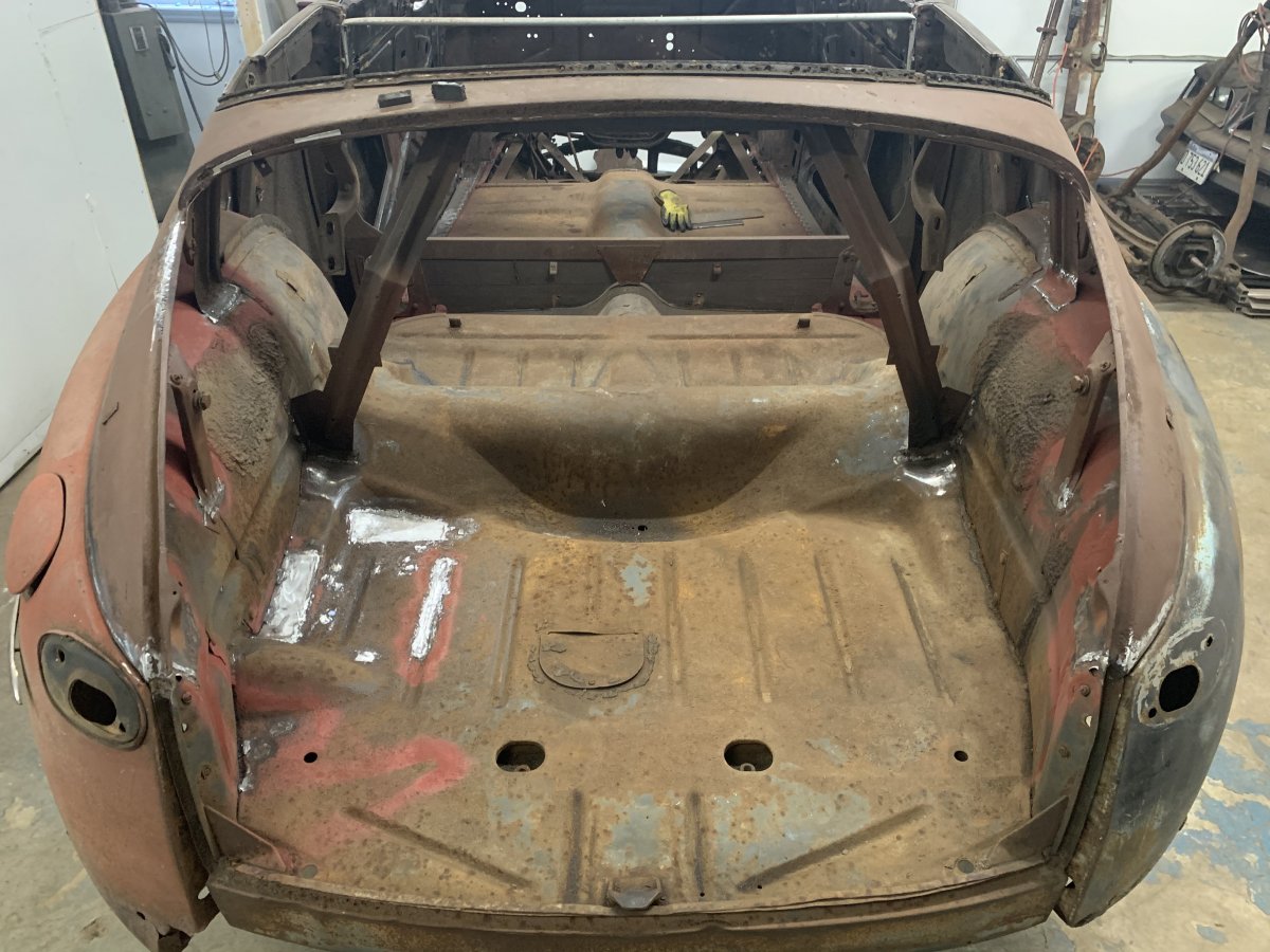

    The trunk floor is patched up.
    CA1BD38C-EDF8-42FE-B170-EBDA6579B991.jpeg 7E43AAA9-7617-41E2-B743-5CB9D57B9097.jpeg
    I need to repair or replace the panel below the trunk lid. I may use the deeper tail panel from EMS or just make my own.

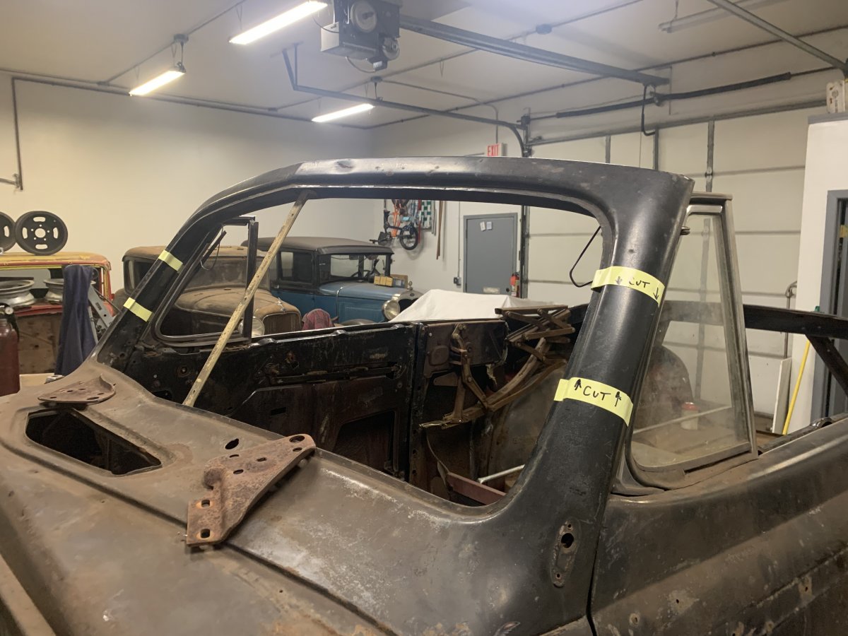

    Pretty much all of the body rust has been repaired so I’ve started to layout the cuts to chop the windshield.
    03BEC4E1-D80F-4C6D-98BA-FCEBBFF543CC.jpeg FCB86ED9-5A30-46F1-A243-60BFB3EF9439.jpeg

    Put the chopped top irons back on to measure for the windshield chop. I’m going to love the chopped look.
    59517B87-9F57-4F31-B6B2-CC74CC315C18.jpeg 09CEDA59-439C-4B45-A568-4B35B341B451.jpeg 2764D312-9F46-4563-8533-62F9EED32437.jpeg FB612761-DED3-416F-BF47-3F2A7E565E0B.jpeg

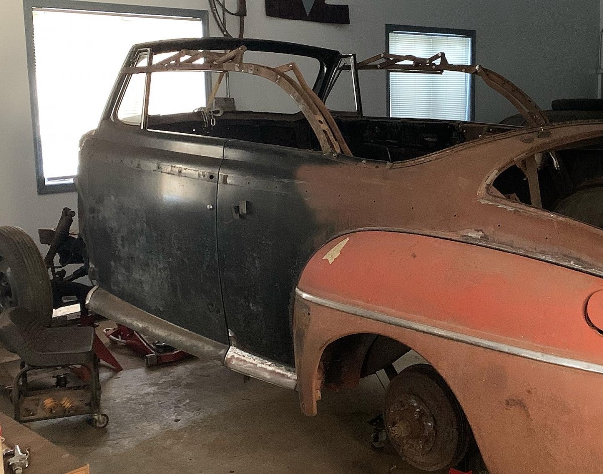

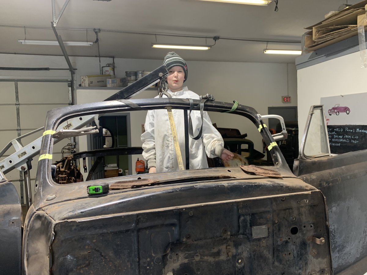

    It’s CHOPPED, or at least cut.
    I found rust in the horizontal windshield frame channel and a bunch of mice nests and nuts. I fixed the rust but didn’t get a chance to start fitting the windshield frame back.
    I had some good help today.

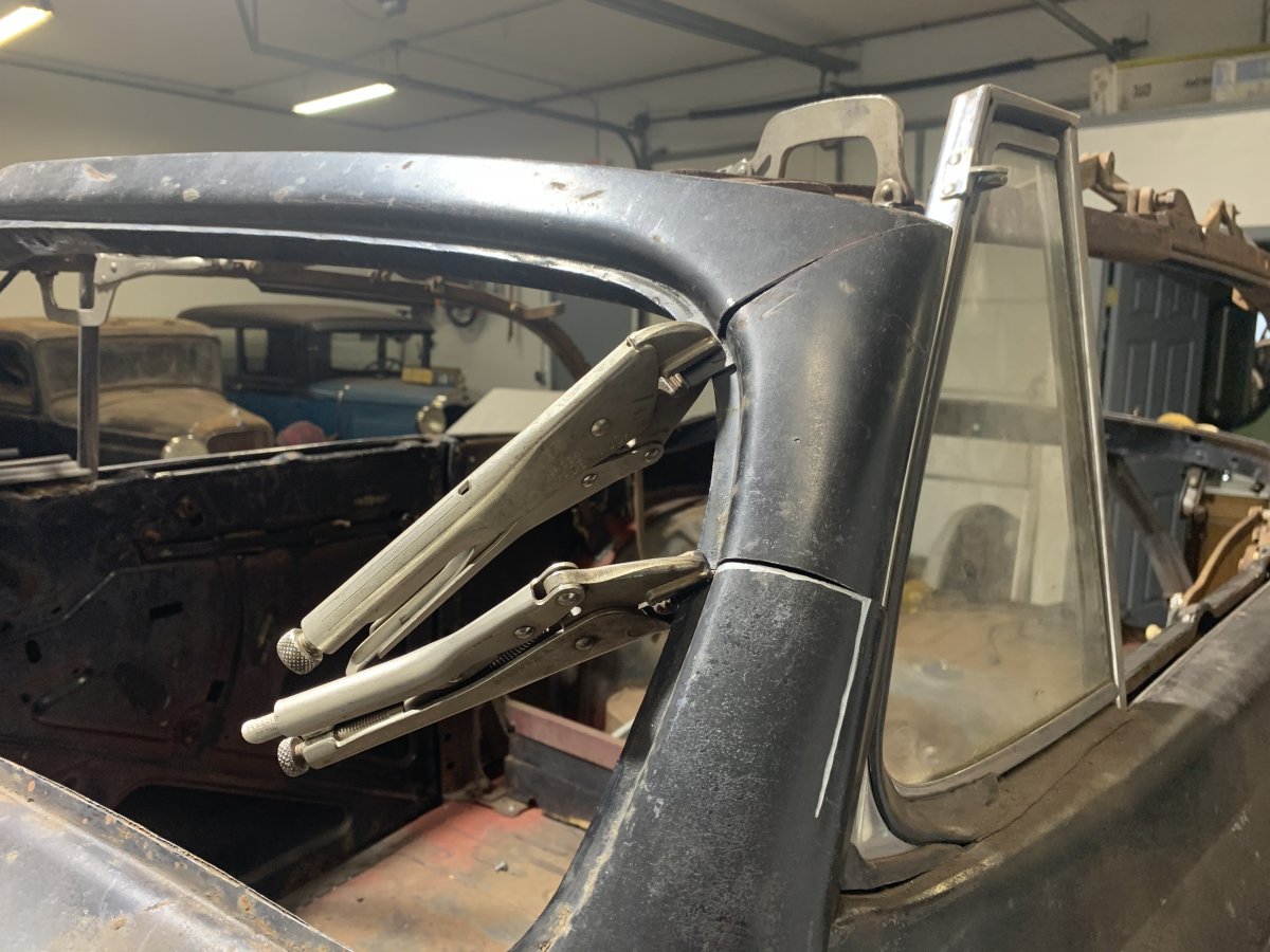

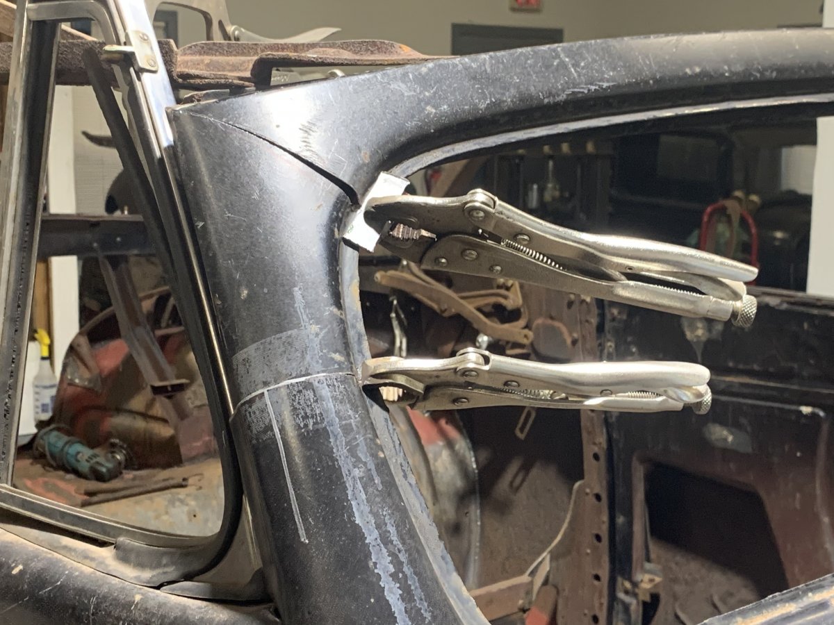

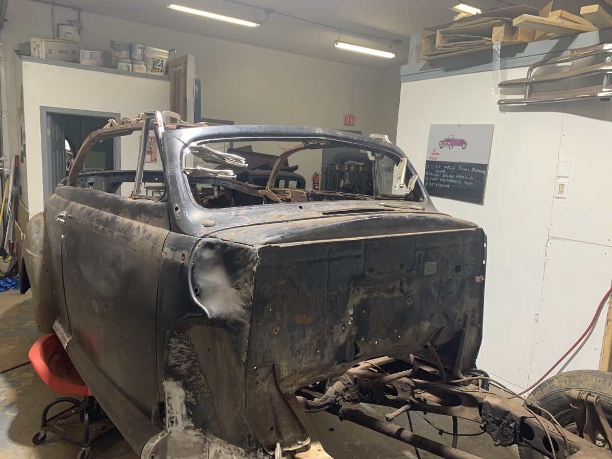

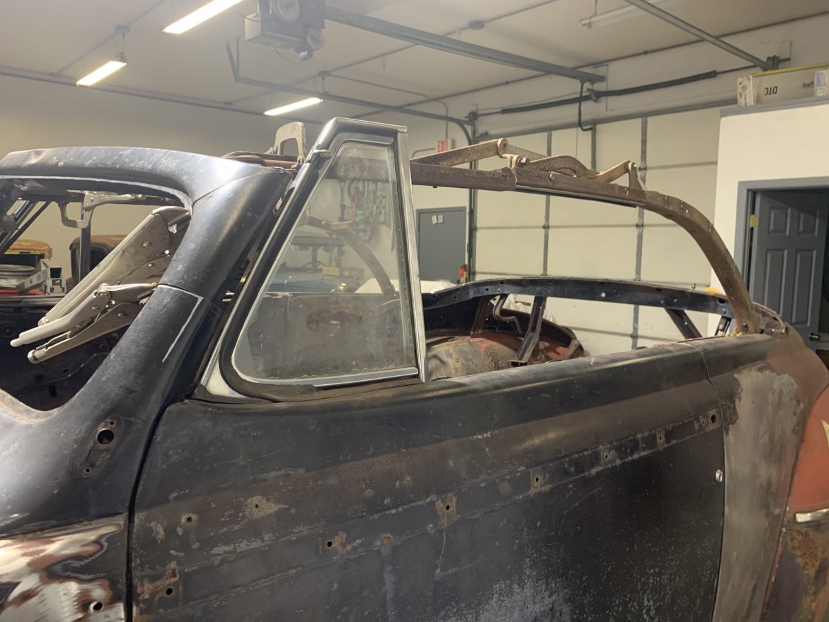

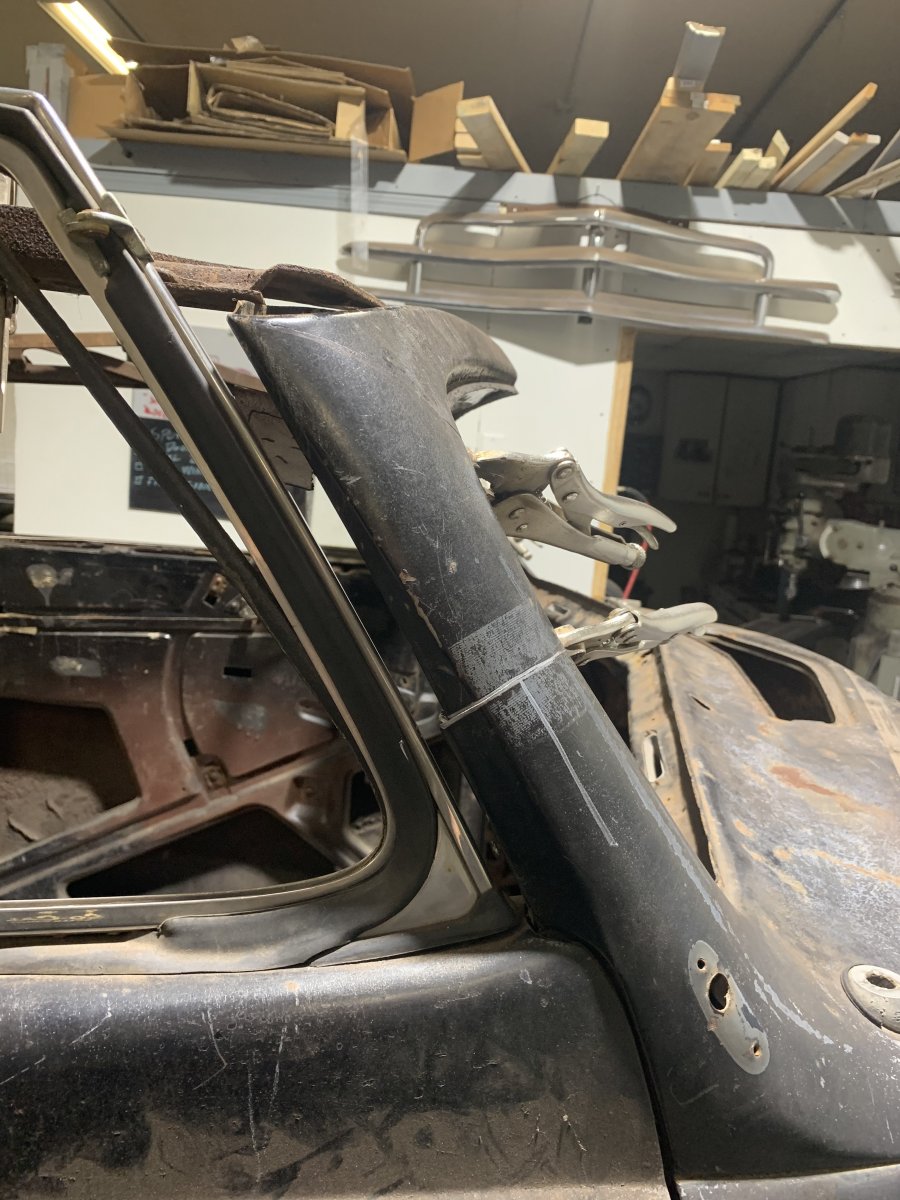

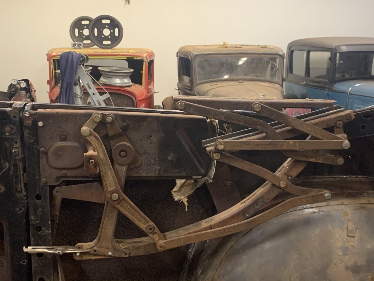

    Working on the windshield frame.
    I am planning out how to reinforce the inside of the windshield frame. There is a c-channel that run up and around. I’ll likely make another channel and plug weld above and below the cut line. I need to trim another 3/8” off of the windshield. I intentionally left it a little too long to try an initial fit.
    BD926DD0-AF5E-40B2-8294-642B2B98F6AC.jpeg A7C72192-53F4-4789-AE80-8851399002E2.jpeg 769FBE11-8422-417A-97E8-4175C9AA961C.jpeg F5E96BBA-9CC1-40A9-9BF1-49E5A1E33FDA.jpeg 85D28079-519E-43A2-B7B6-B99275702577.jpeg DBDE0D44-D263-4415-8A77-81527ADF3BD2.jpeg
  24. Peanut 1959
    Joined: Oct 11, 2008
    Posts: 2,188
    Peanut 1959
    For what it's worth, that windshield height looks spot-on to me. I would seriously consider visibility before deciding to take off any more material from the posts. Remember that you'll lose more visibility from the windshield rubber.
  25. T&A Flathead
    Joined: Apr 28, 2007
    Posts: 1,986
    T&A Flathead
    Thanks! The reason for the additional 3/8” is to get the top irons parallel with the top of the door (or close to parallel). You can see the irons at are running slightly down hill towards the rear.

    You can also raise the mechanism mount(the panel that holds the regulator) a bit to level them out. Also the large top cast arm is slightly adjustable in relation to the side panel it bolts to.

    I noticed that arm was adjustable the other day. I can’t raise it it too much or the arm will show at the back of the window. But its good to have some adjustment to fine tune it.

    Speaking of visibility, those vice grips are going to be very distracting right from the get go. Otherwise, looking great!
  30. T&A Flathead
    Posts: 1,986
    T&A Flathead
    I was thinking about leaving them but have them chromed! Haha
