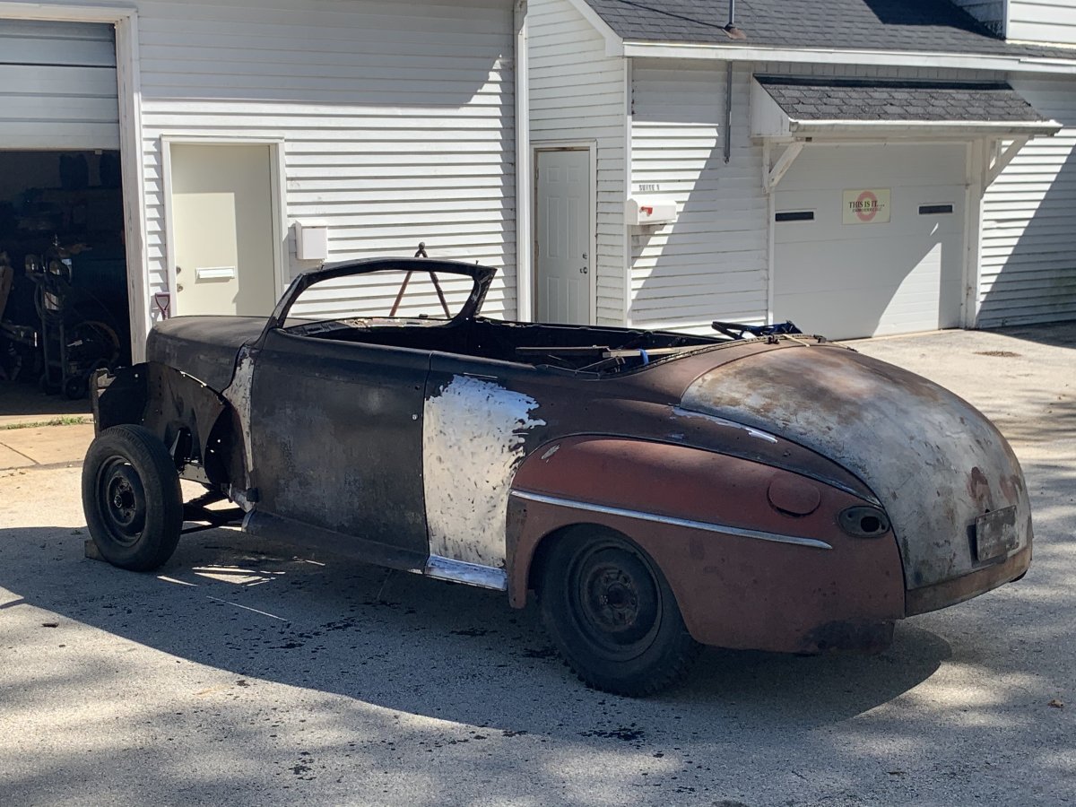

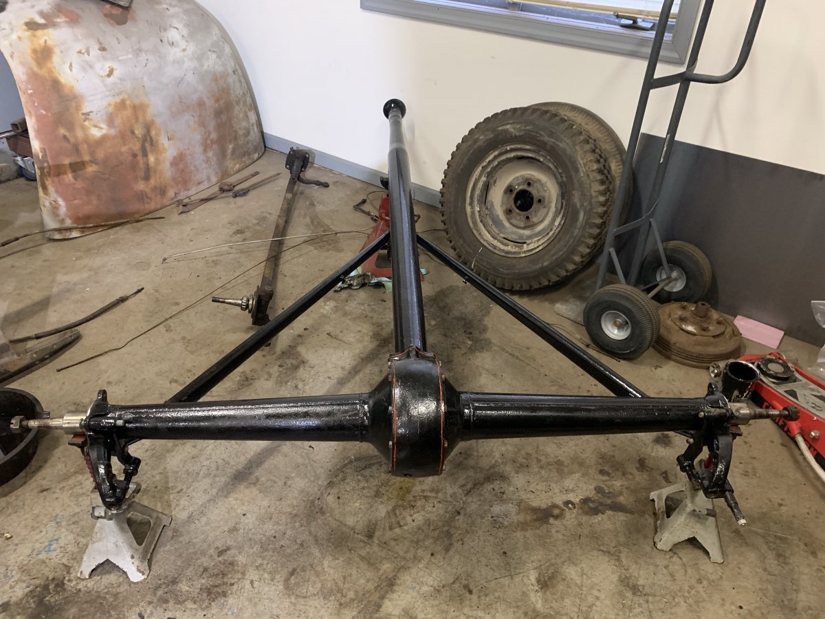

    Nothing too exciting, but I got the rearend back together and the front end rolls.
    9BFCC526-EBA6-446F-B4E6-8F325C5993A1.jpeg B26316D5-B012-45EA-9ED6-06F6B47CCBB1.jpeg

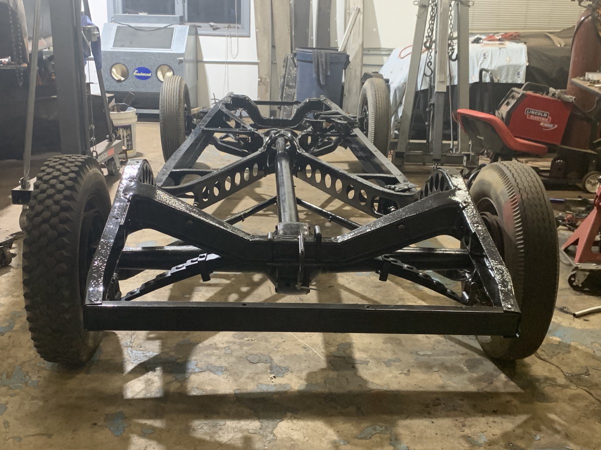

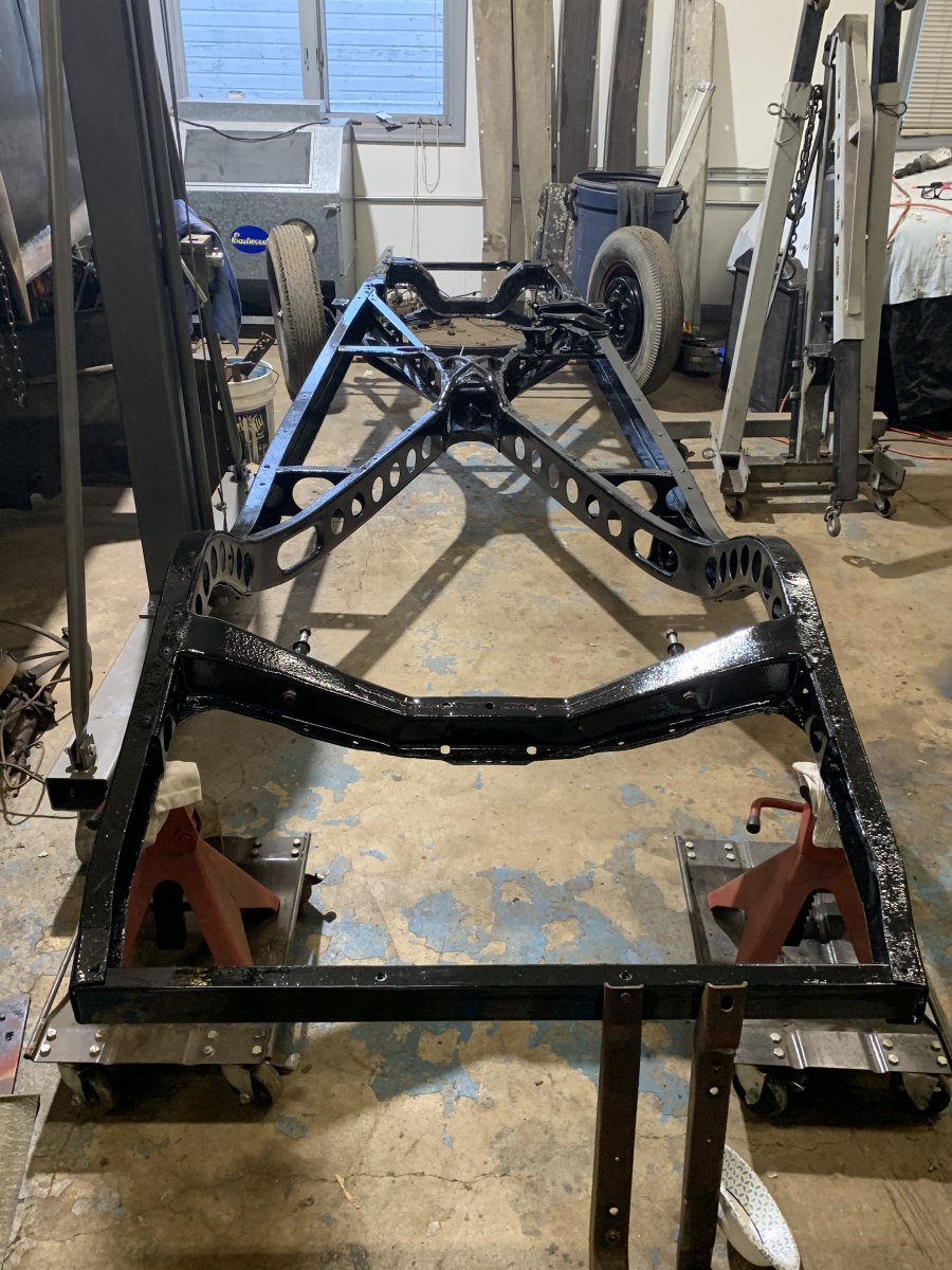

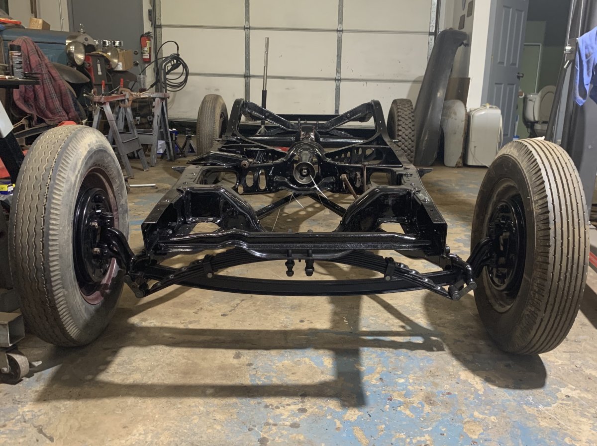

    Frame rolls. Ready for final ***embly.
    90AF09CE-732E-4AE1-9978-429A4303AA5B.jpeg 5D3E7422-A9E6-43D5-8EAD-5F47478C0DC3.jpeg 3996A193-0C6F-47D4-83C0-495CAD233447.jpeg

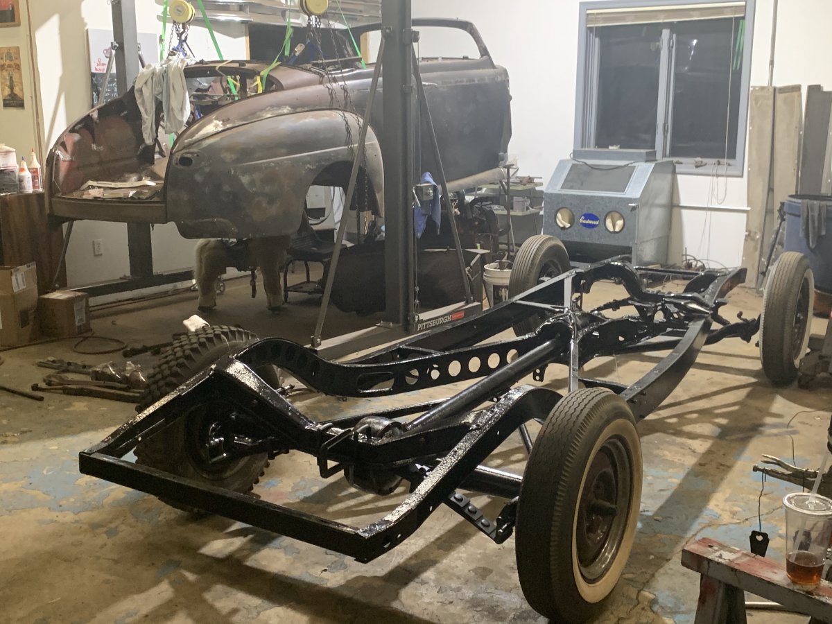

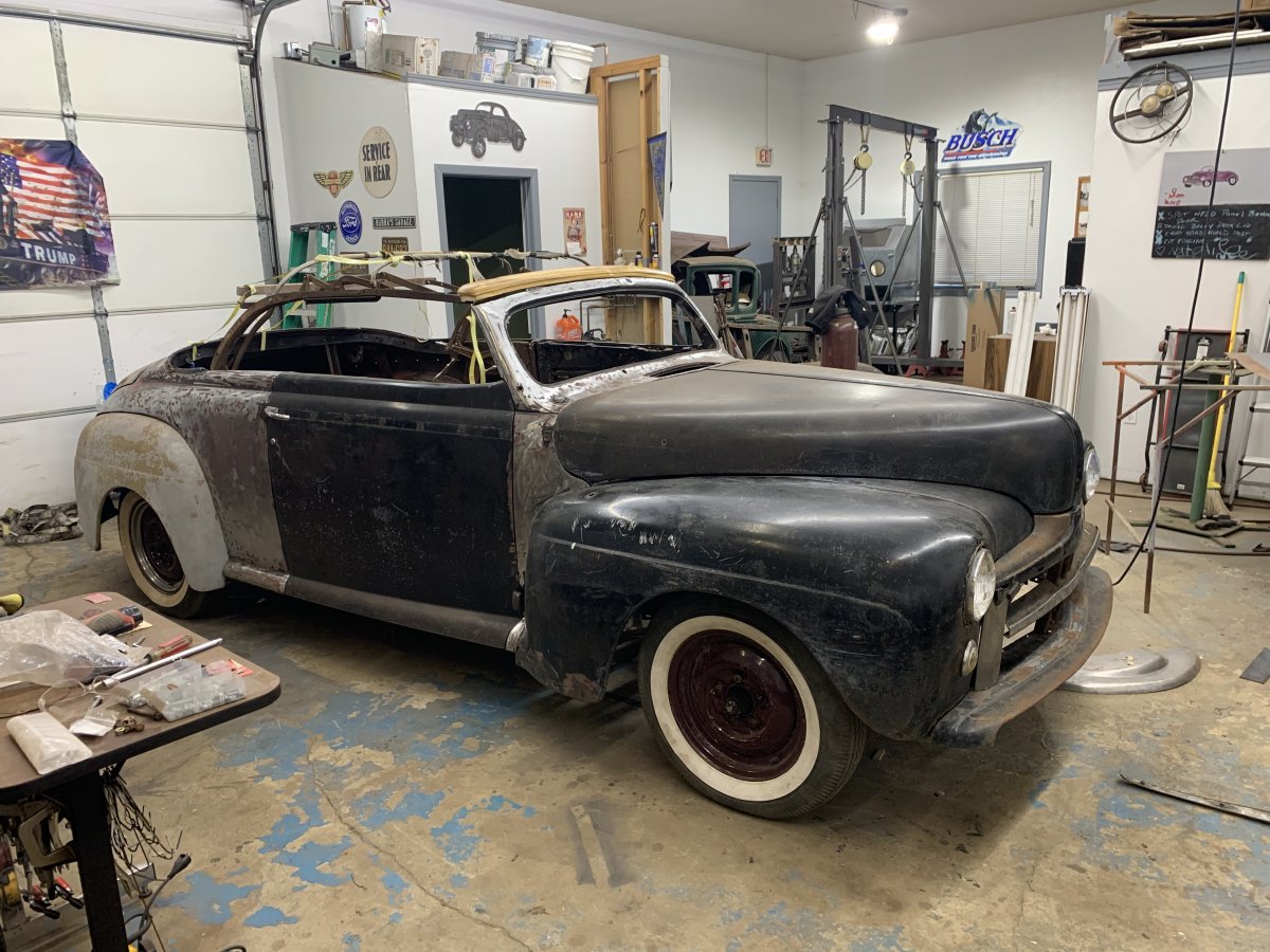

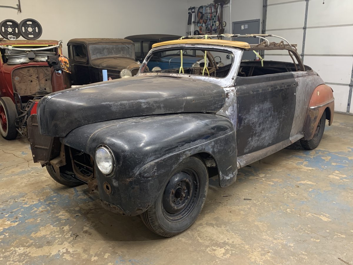

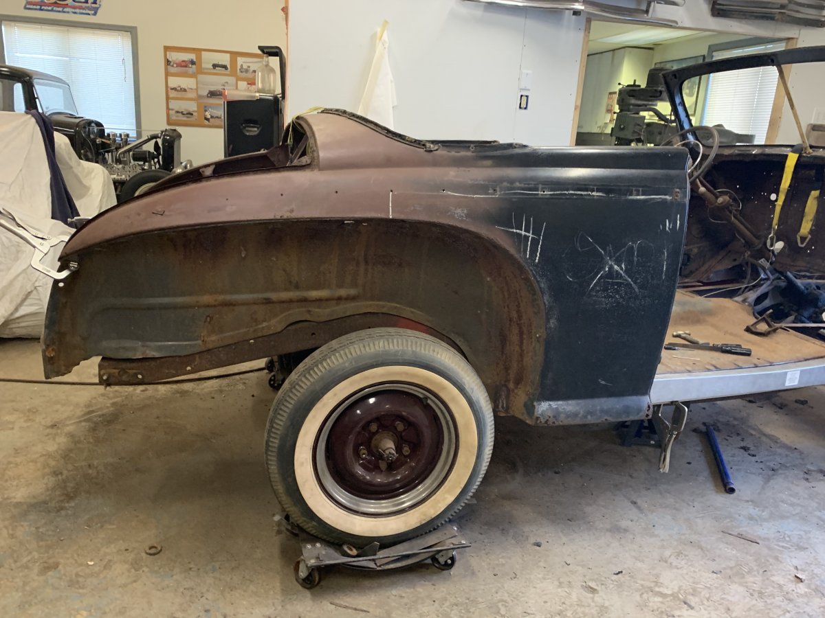

    I dropped the y-block back in, then I got really interested to see how the ch***is sits with the body weight back on it.
  9. T&A Flathead
    Joined: Apr 28, 2007
    Posts: 1,986
    T&A Flathead

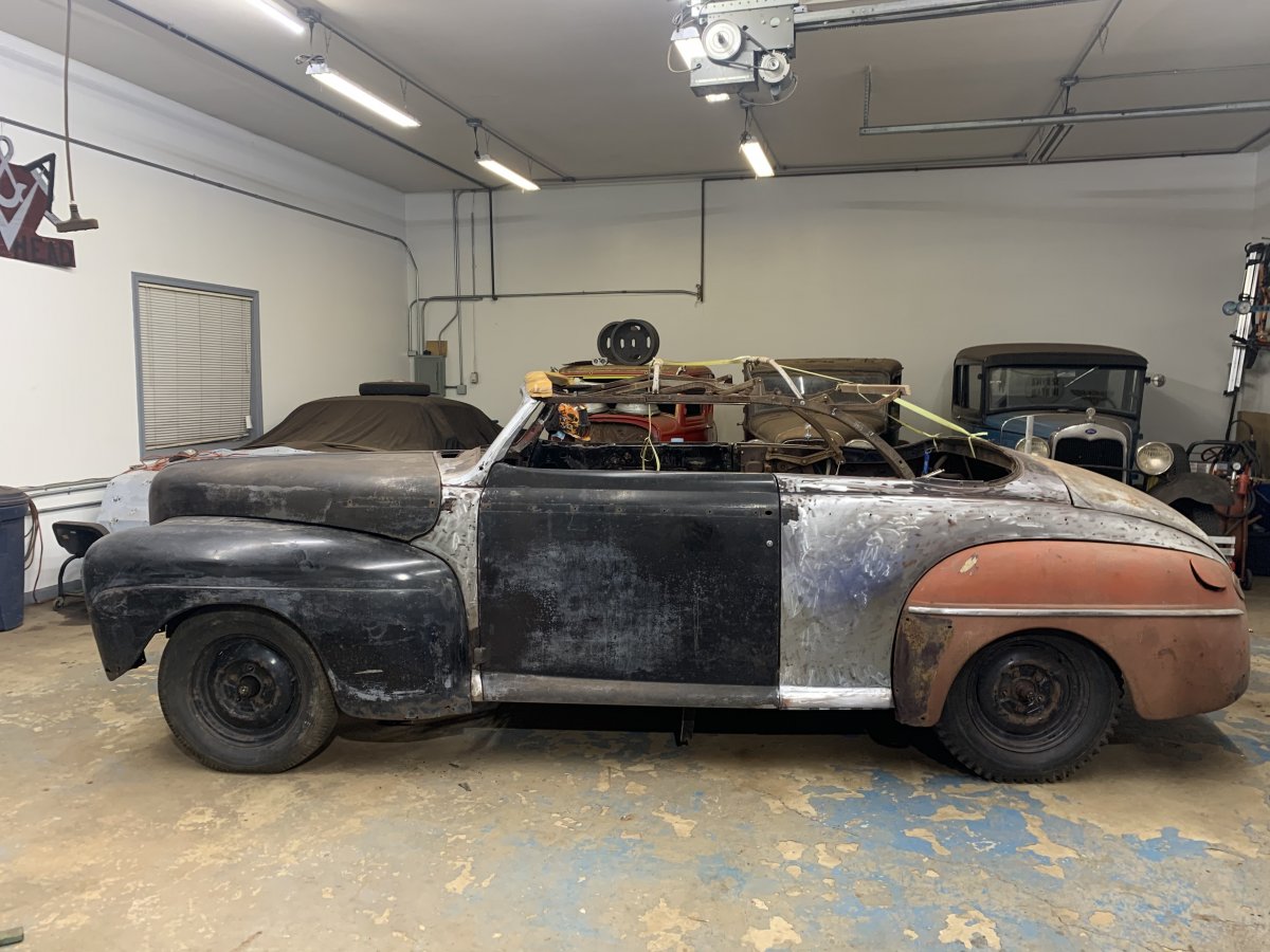

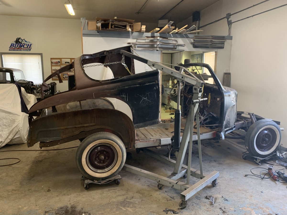

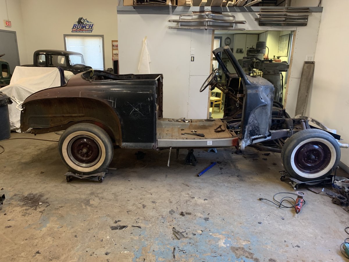

    So , I had to put the body back on the frame.
    4B9A30BD-5028-4511-B3C1-02D71C8E6CF8.jpeg 604B557C-E7C3-4679-B5AC-0C5127529ED0.jpeg D74269EE-885A-4394-AB3E-10283EF9AA7F.jpeg A558DD57-99C1-4EF8-A48C-BEAA94CA57C3.jpeg
    I think it’s going to settle out and sit just about right.

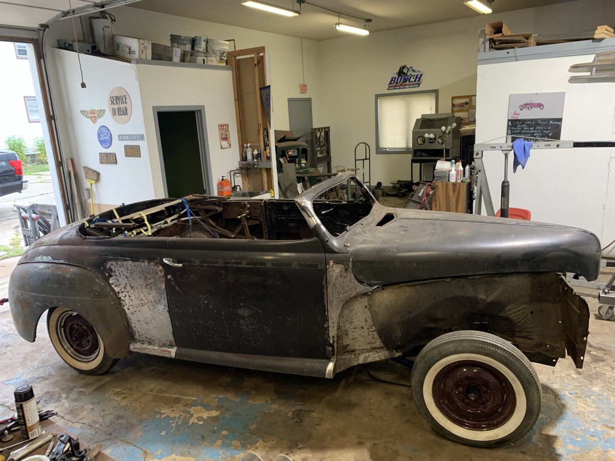

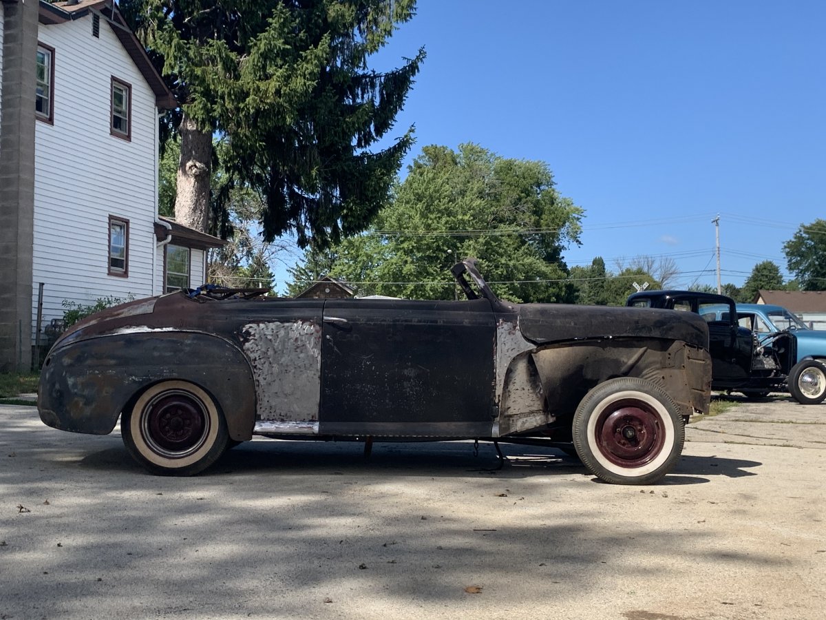

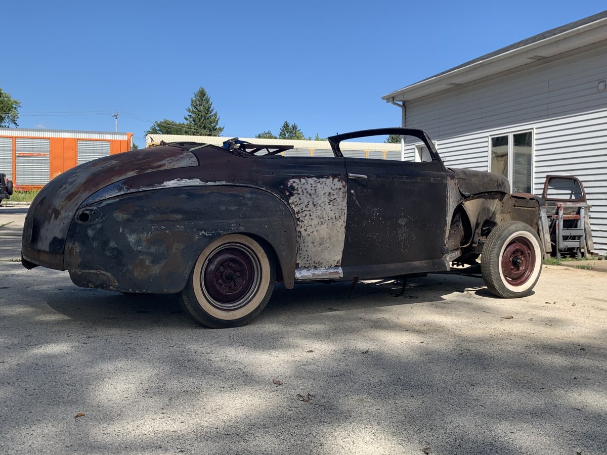

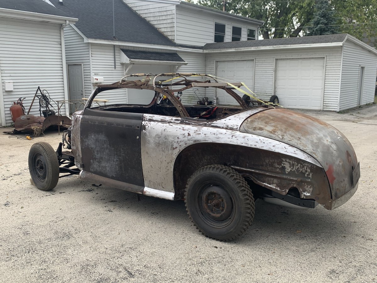

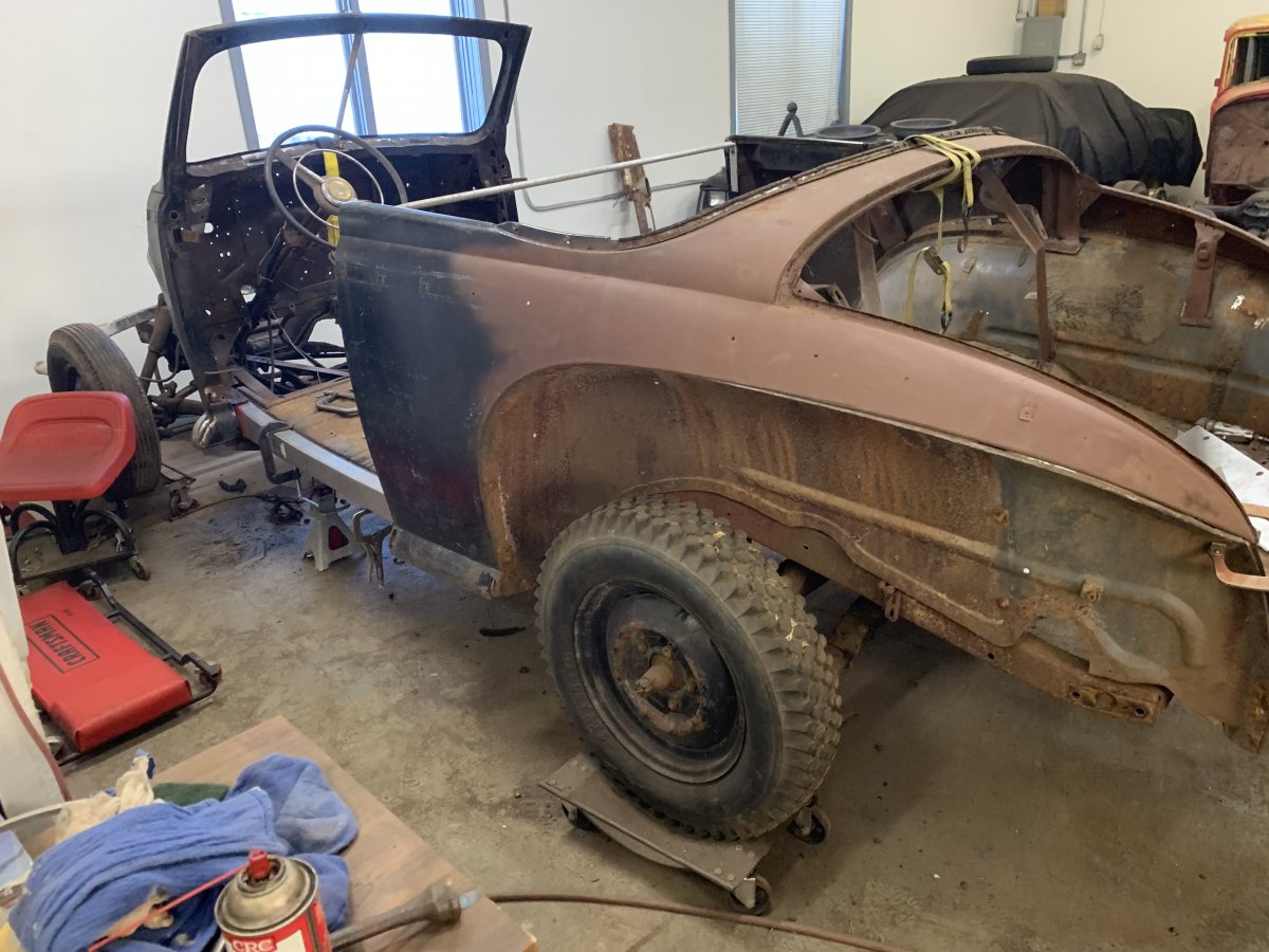

    Rolled it outside for a look. Body is already back off and I’m back to work.
    6E6D34AA-018C-4BFF-9F73-B2C1E76221CC.jpeg FF8E7524-DD95-4251-A9F3-7FFEAD76D811.jpeg CC60D227-8F55-4219-B9E8-ED9798F2494F.jpeg 0AA1C086-7367-4BF5-8ACA-F6F9ACA68F98.jpeg BADC4286-3082-4CA7-9314-88FCCED9D99D.jpeg

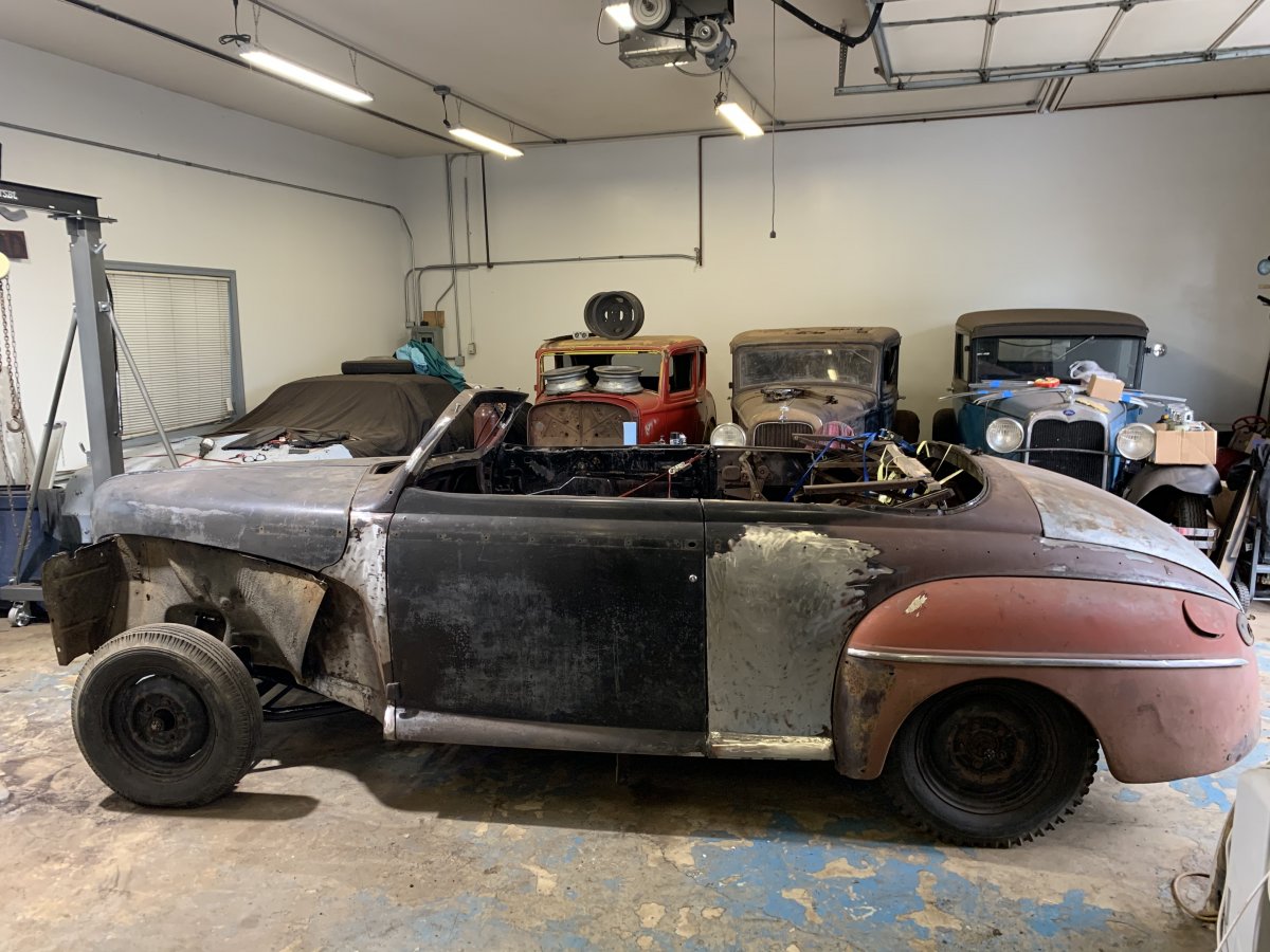

  12. T&A Flathead
    Posts: 1,986
    T&A Flathead

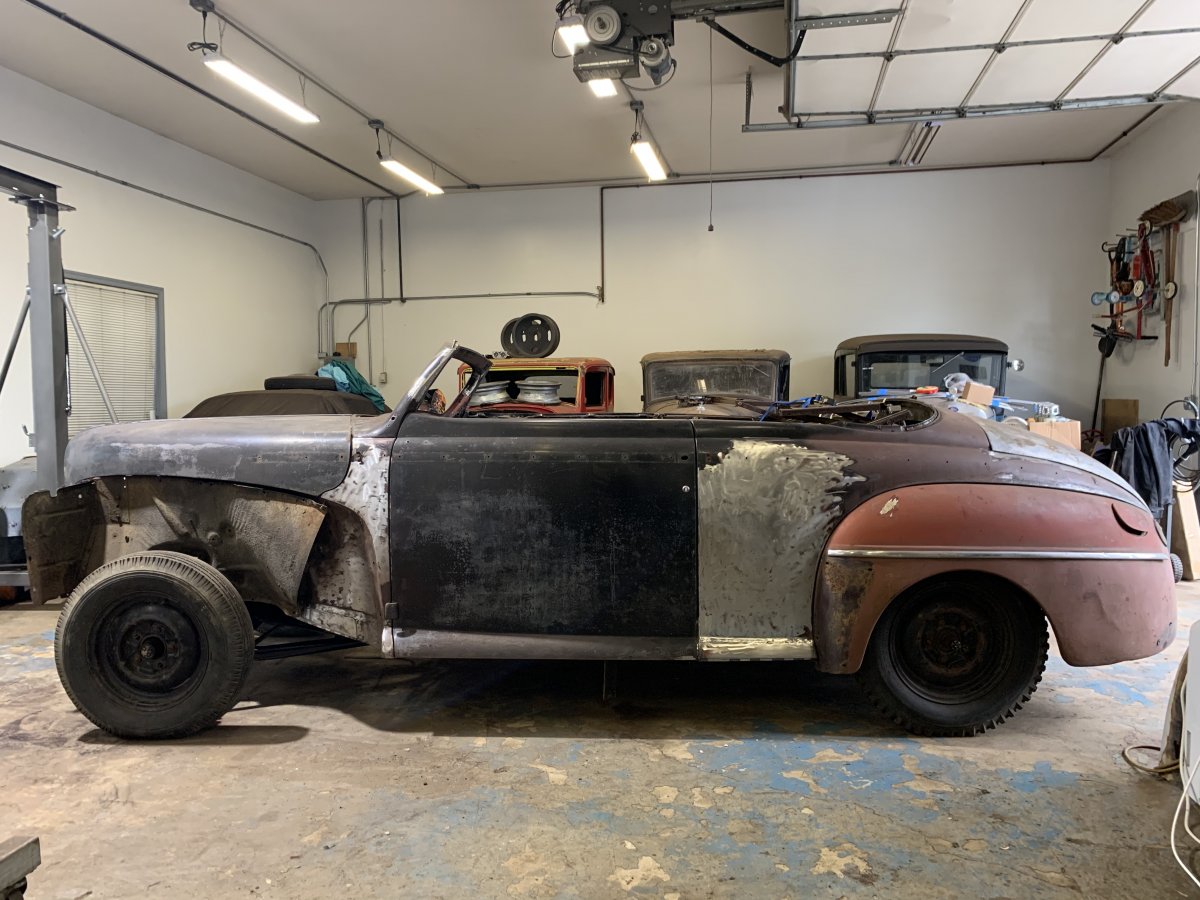

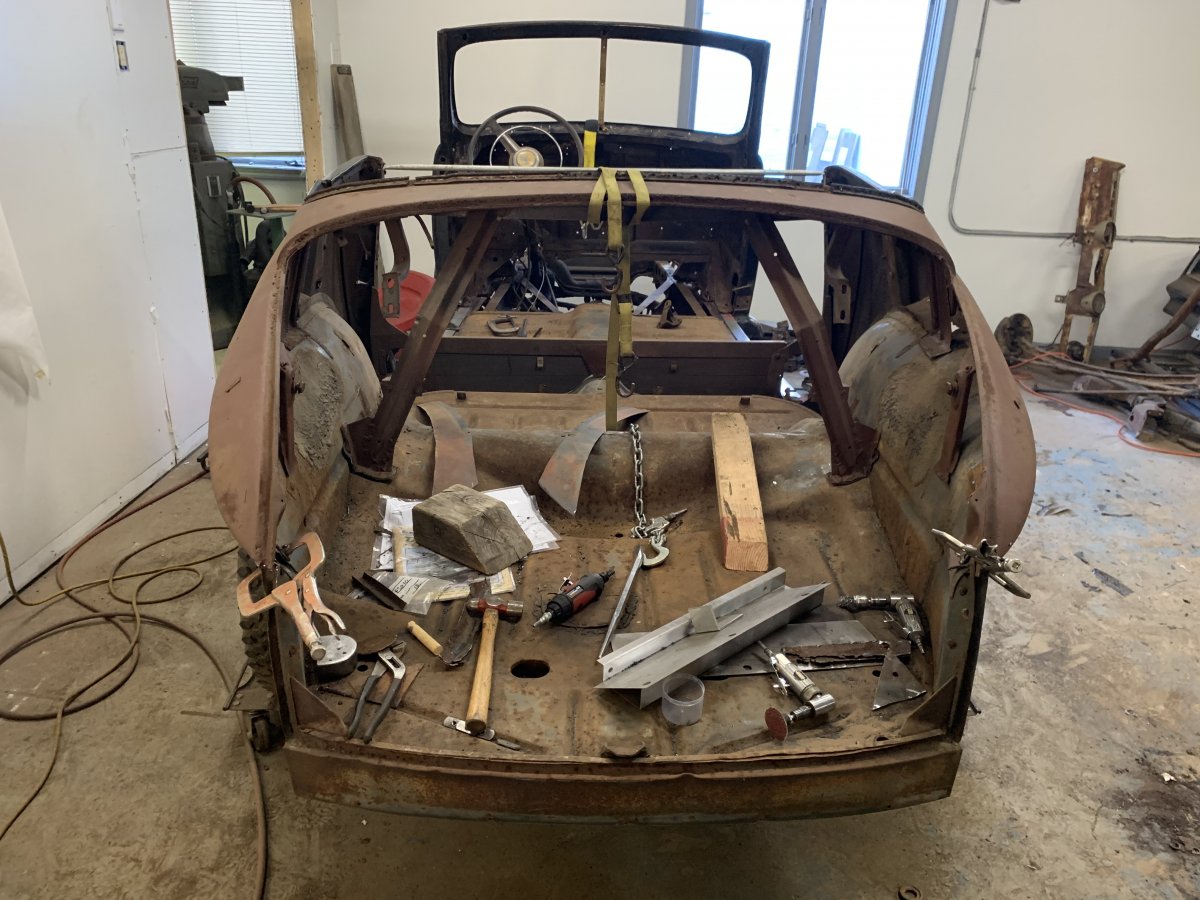

    Body has been off again and now it’s back on. Final fitment of door gap is underway. Also time to fit and radius the trunk lid.

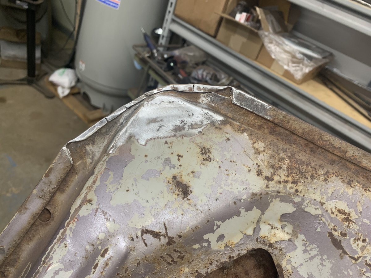

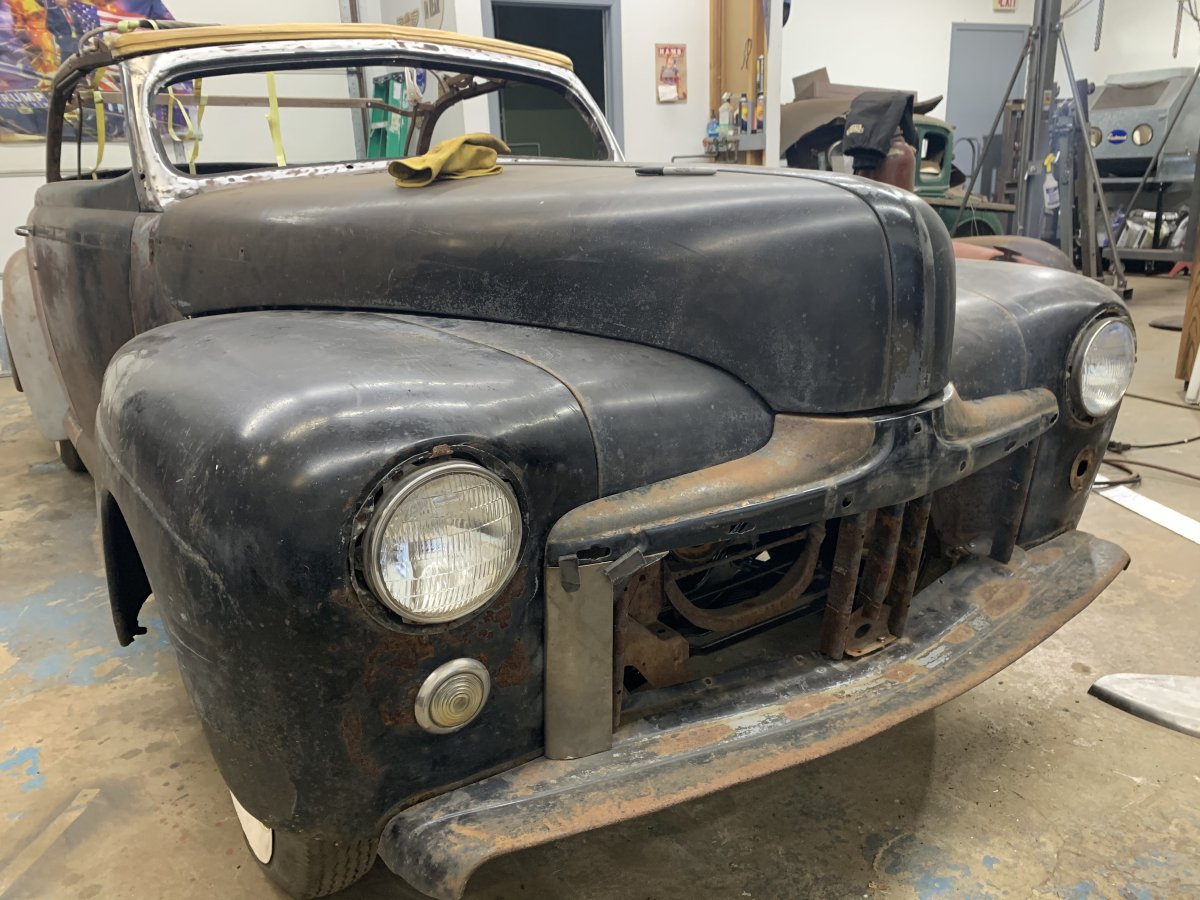

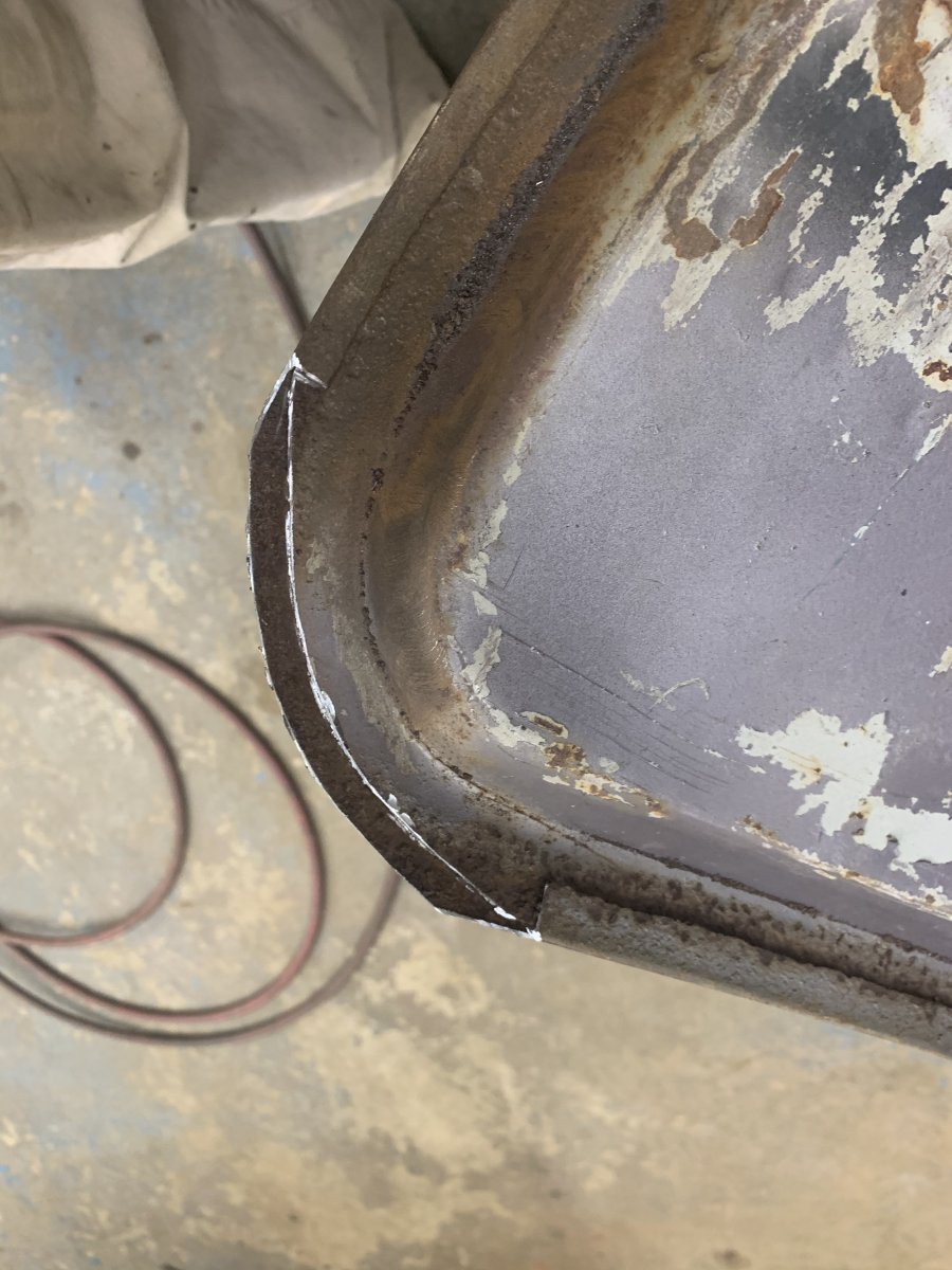

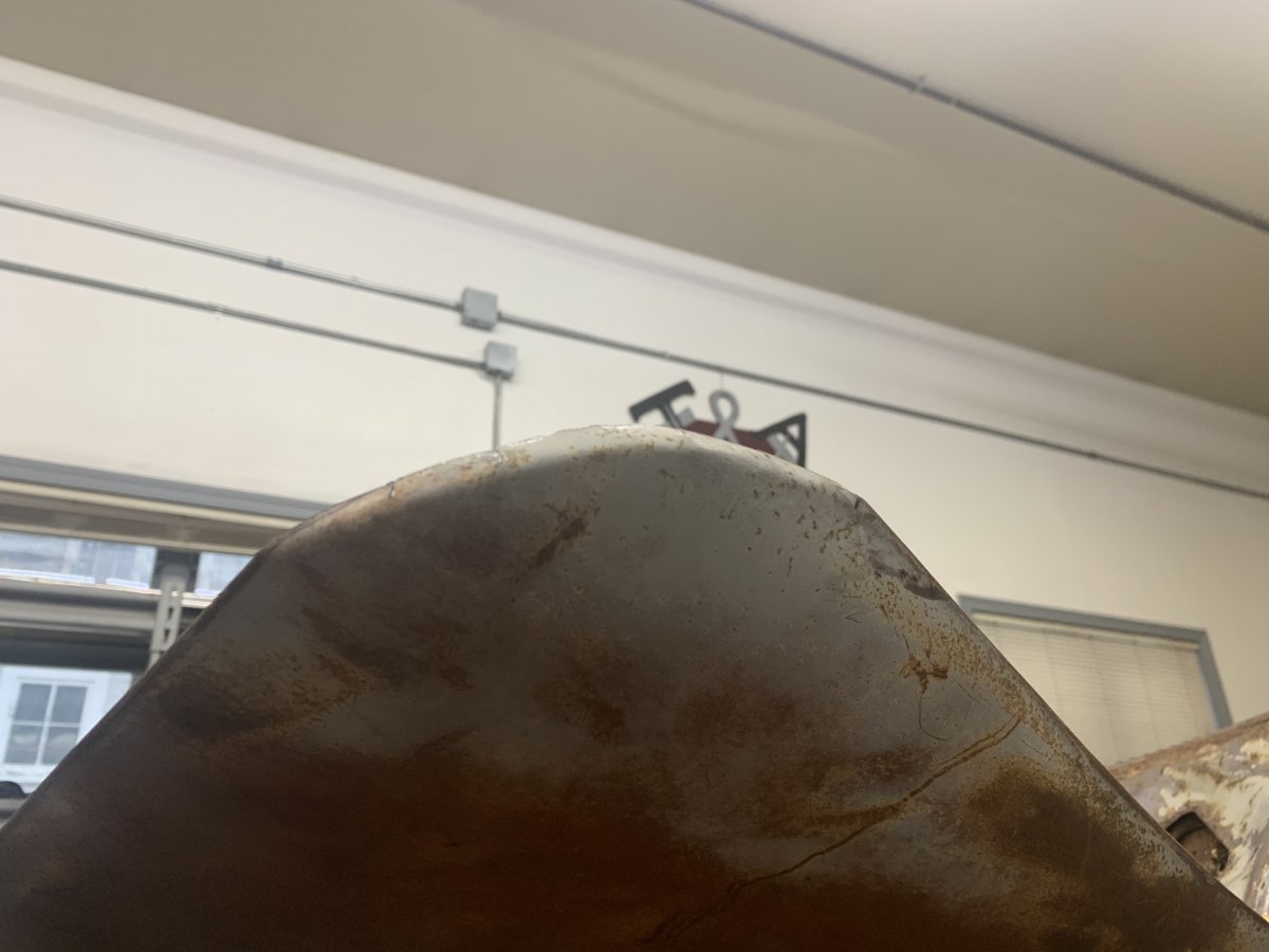

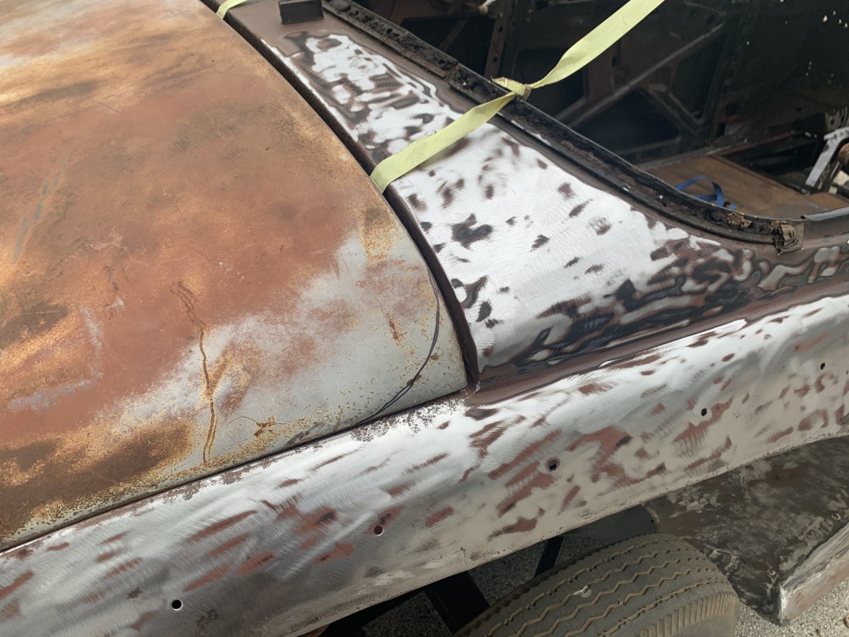

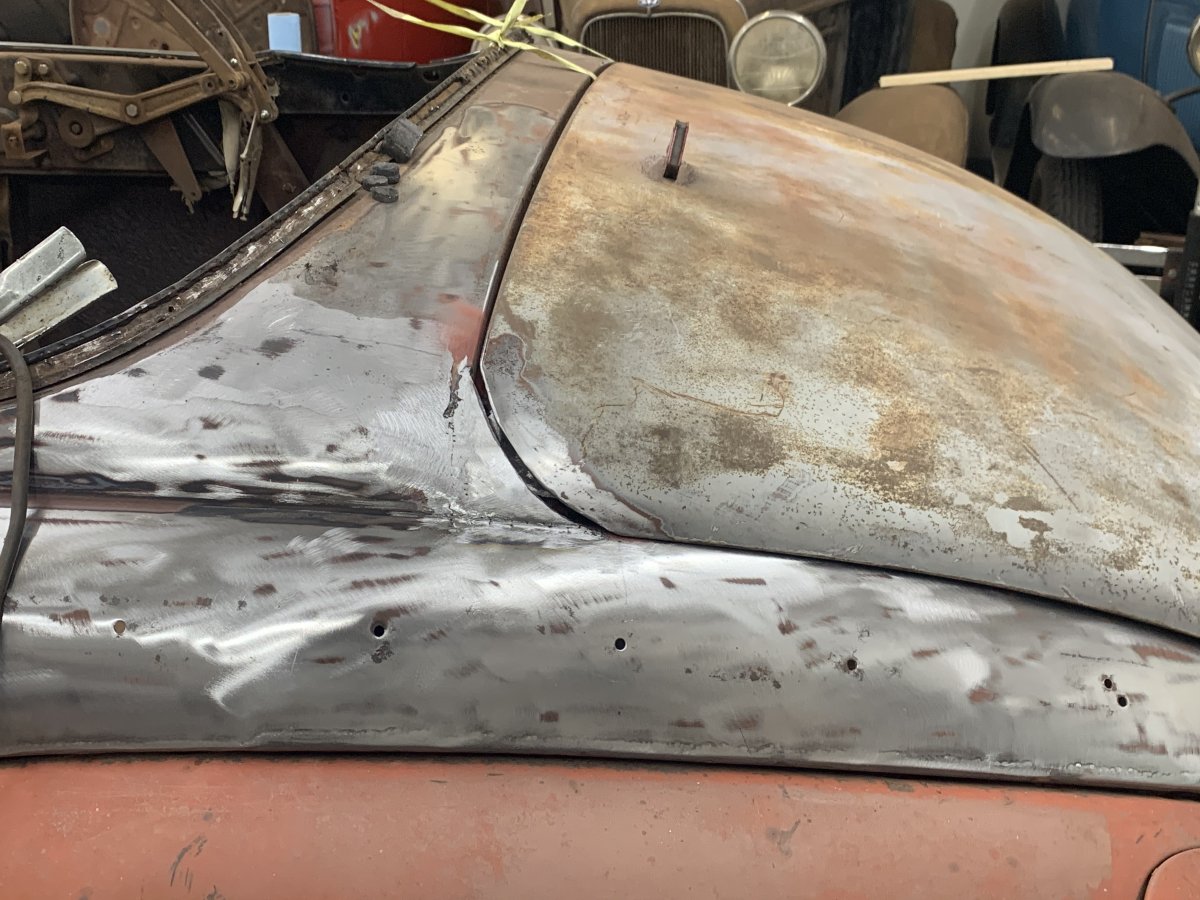

    It’s been a while since I posted because it’s been a while since I’ve been in the shop.

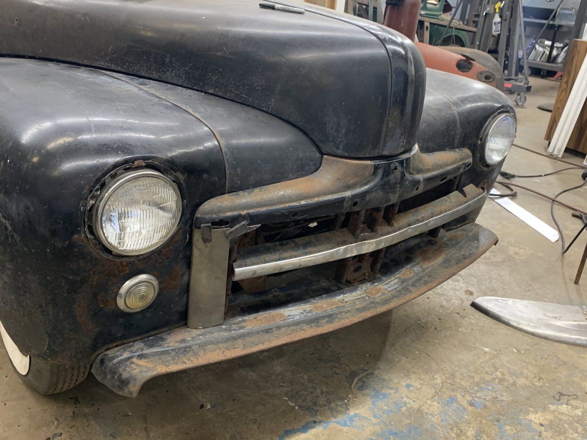

    I started to mock up the front clip and will decide what I do with the grill.
    I also started to radius the trunk lid.
    33DACC5B-DD4A-4879-9CC0-C8C71DA06899.jpeg 9F561749-9DB4-46D4-A13A-16BBD8BAE45C.jpeg F82AB009-2BF3-47DD-8600-15683F17E370.jpeg
    1DA73C07-3362-43D8-ABFA-FBF8FCD4096D.jpeg C0A9B21C-7F2F-4B56-8FBE-0EE68E3D97D1.jpeg F0A1270D-5E11-43C7-9297-4E3D18AD71EE.jpeg 1B9C91CC-DE18-4FE1-A24B-65ED961AE055.jpeg 30A2FA58-11F1-4B92-B175-A74B06712F7F.jpeg 9F83B478-4B04-4529-BC5A-20C61E4B1E03.jpeg 213B22E4-309E-41E6-8018-DE265BFD1B8A.jpeg 15056119-F0B7-4E46-AF5E-202B54582CC8.jpeg 774BDDE9-EDEA-4950-92EE-89DB65F83F97.jpeg 33D0CF21-5DC0-4978-A842-7BC14B31AD38.jpeg 5F4AD7DE-238D-43B9-8D11-C193AA9E8270.jpeg
    Top and bottom roughed in with the same radius. I need to finesse it so it is smooth and uniform on all corners.

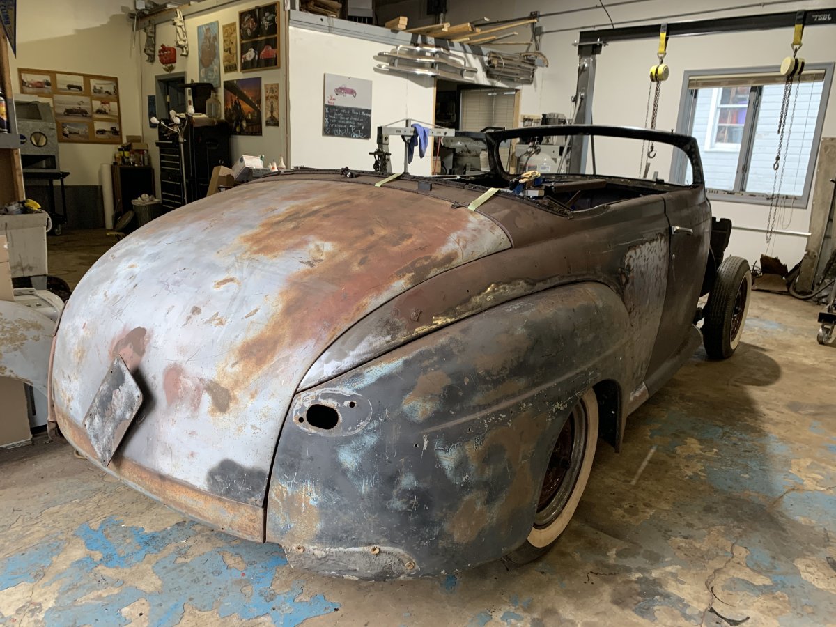

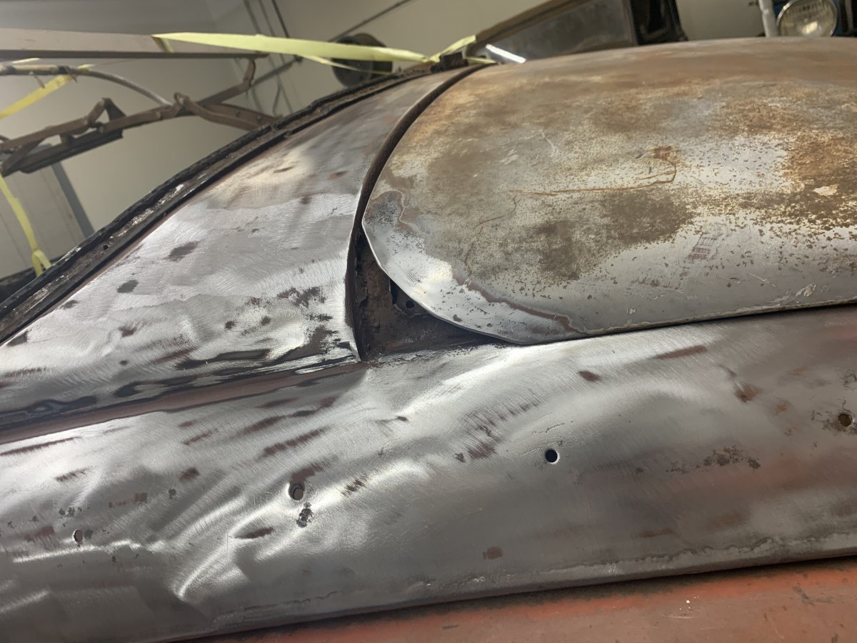

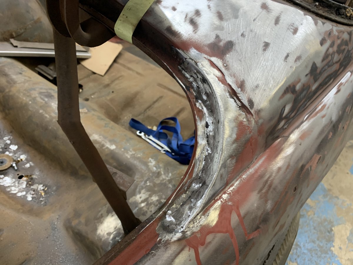

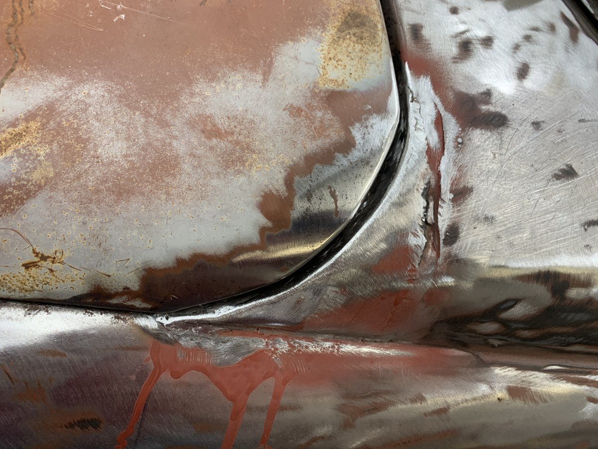

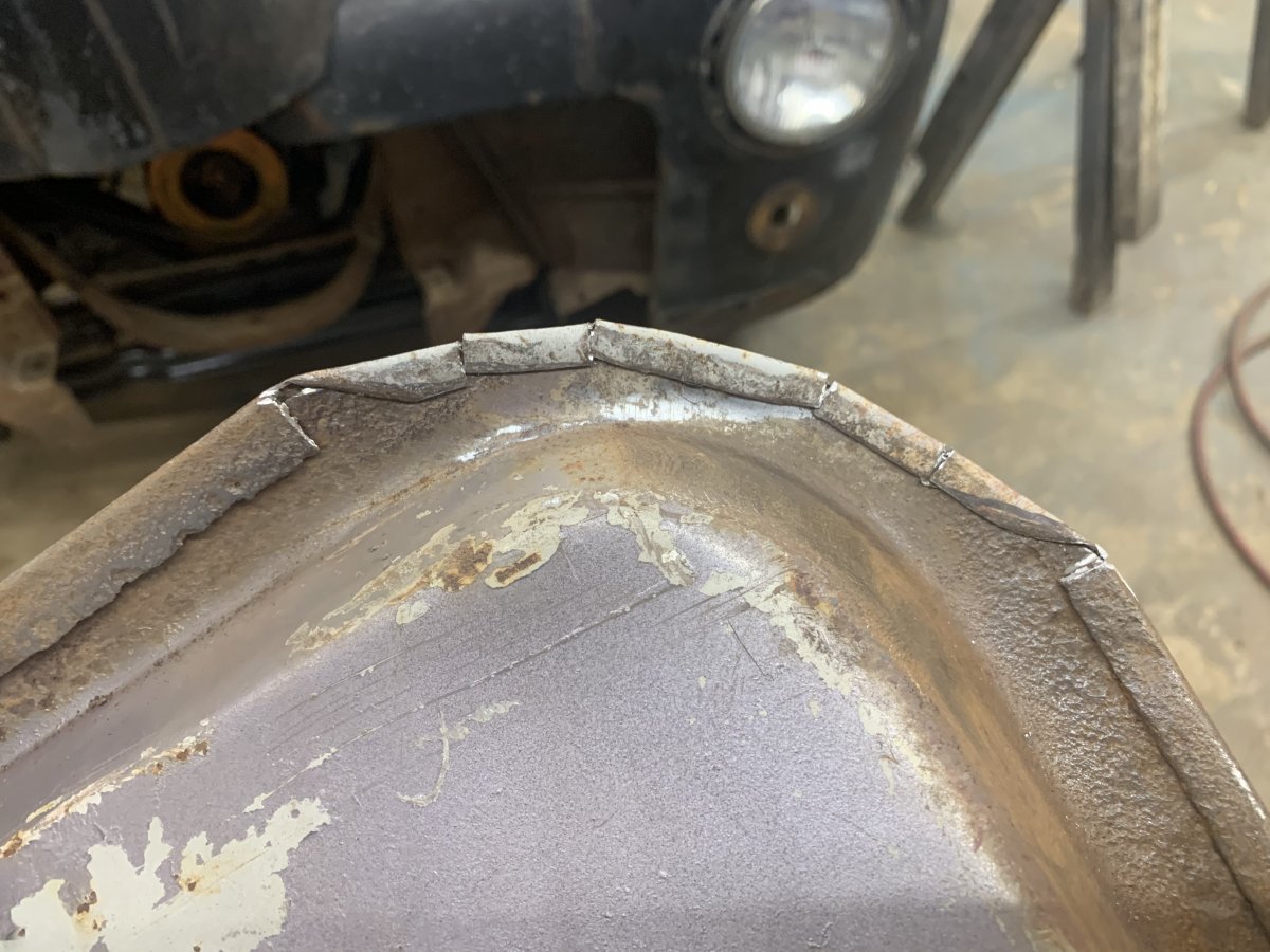

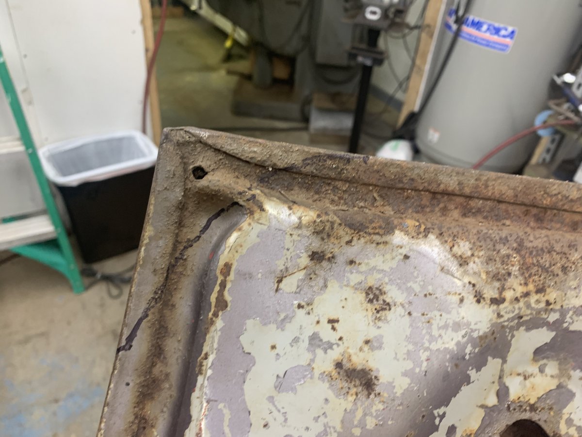

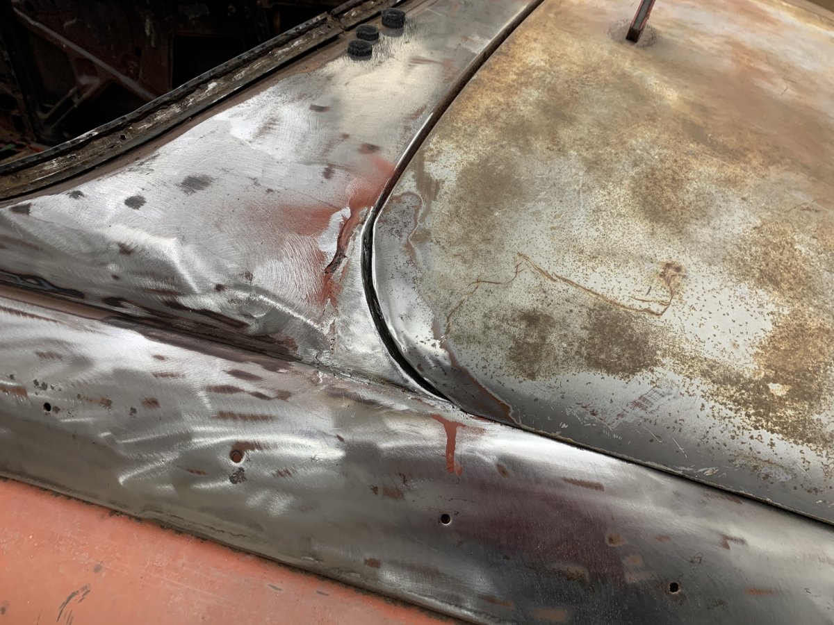

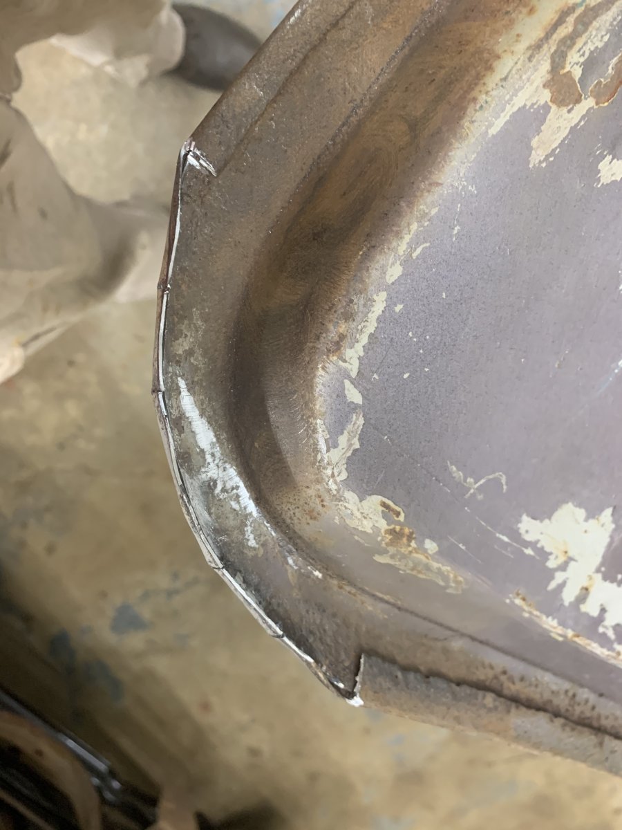

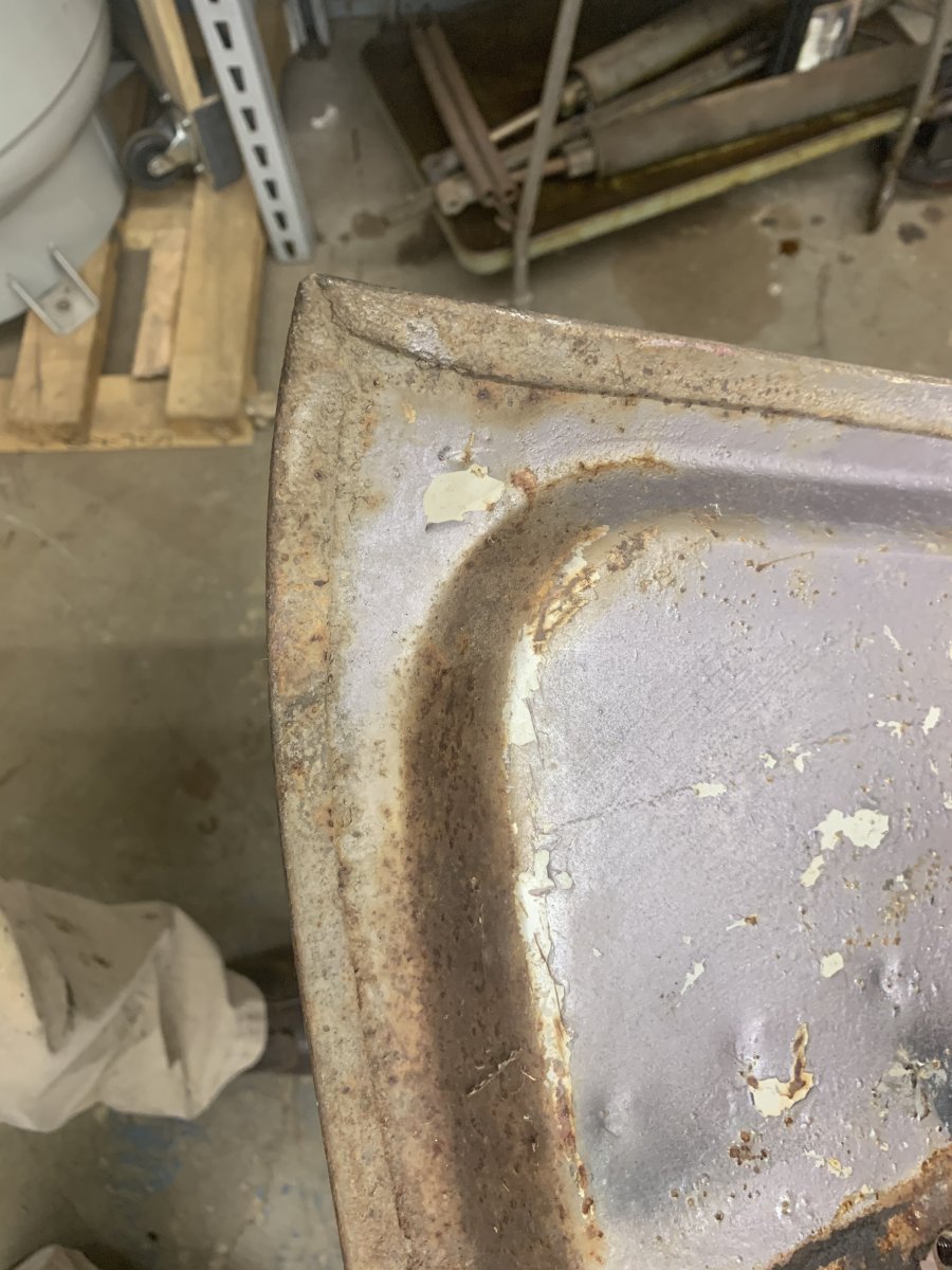

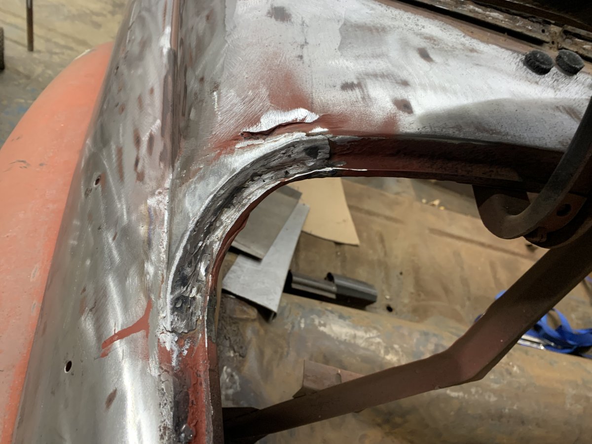

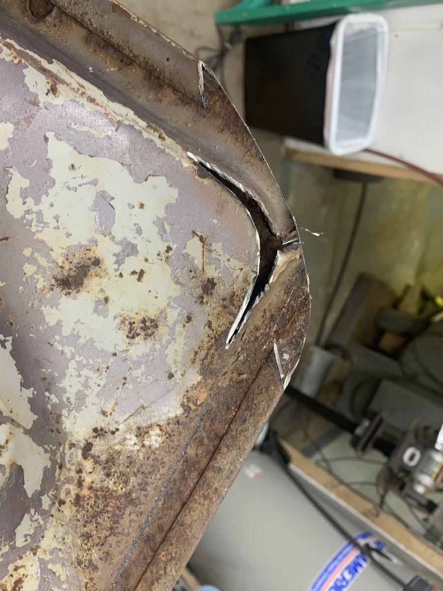

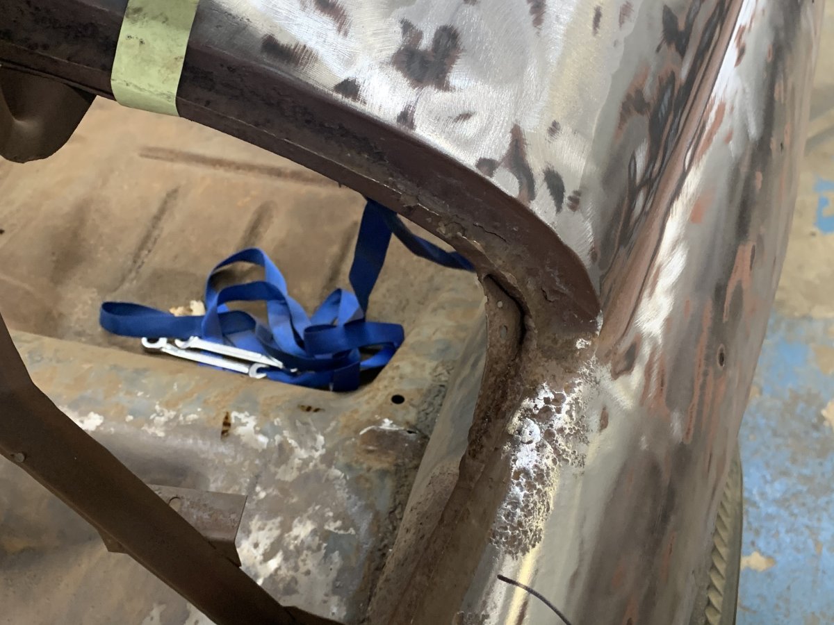

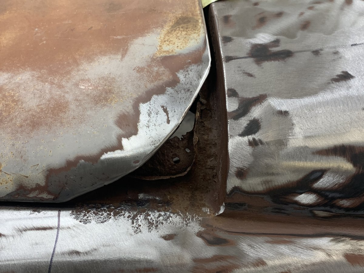

    I haven’t had much shop time lately , but I did get a couple hours on Sunday. I started to radius the upper corner around the deck lid. I didn’t realize the amount and depth of factory lead that was in the area in the body seam. I removed / disturbed as minimal as I could and will teach myself to lead and will refill/feather the area. Any lead pointers/advice appreciated.
    You can see the depth of lead in this pic.
    I also rounded the water gutter. I still have to make the vertical piece that will tie in to the gutter, it will not just be an edge, I just ran out of time.
    36 ROKIT, Okie Pete, cactus1 and 9 others like this.

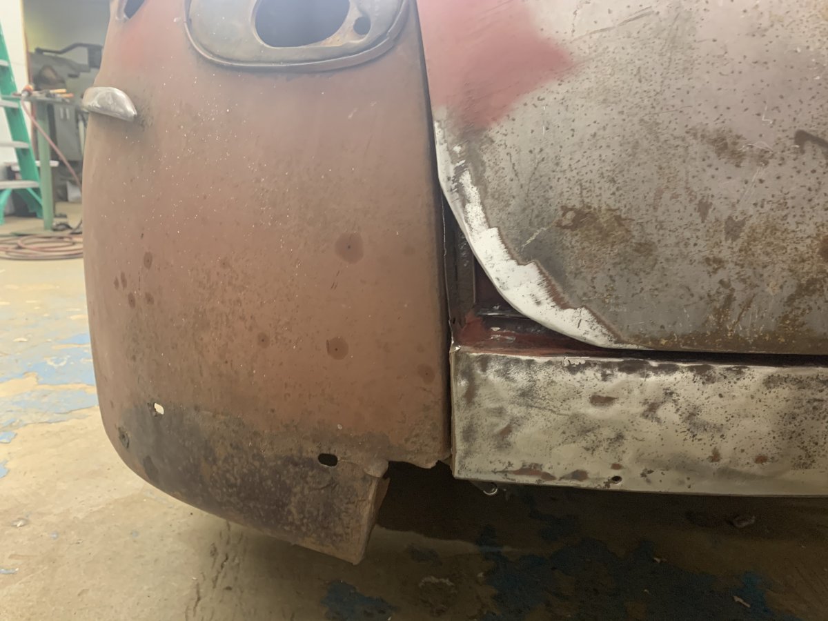

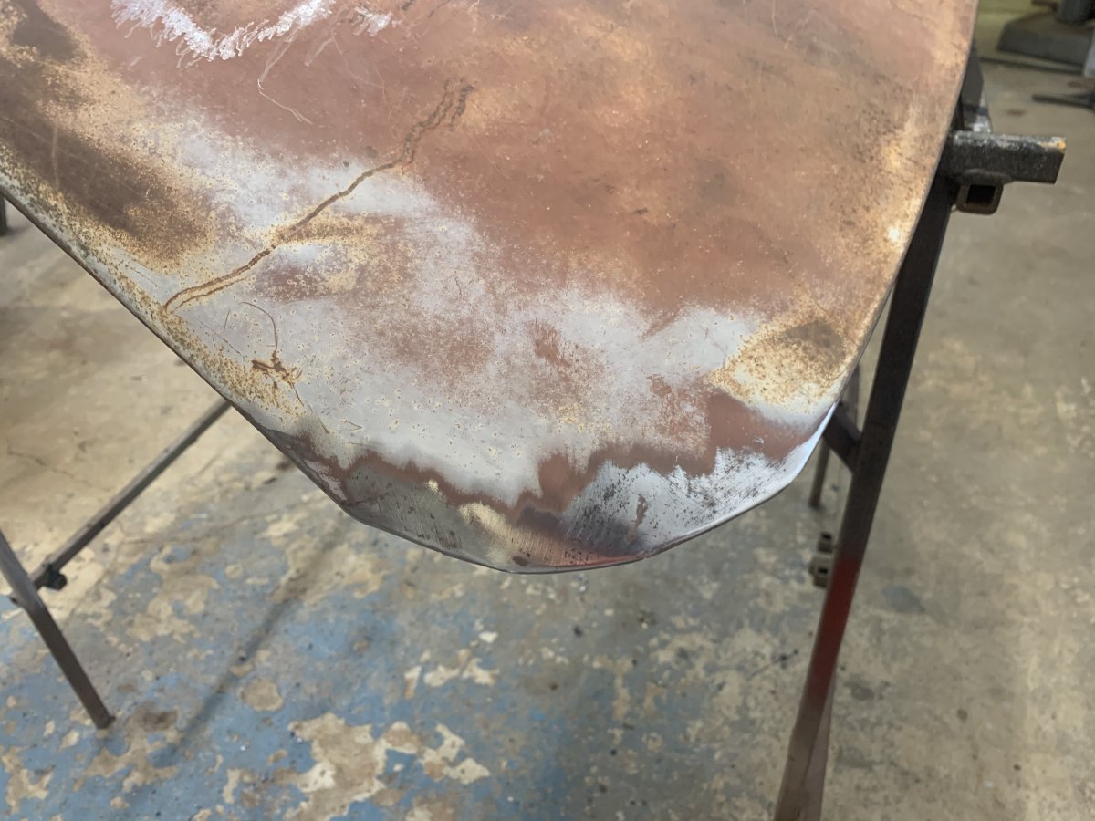

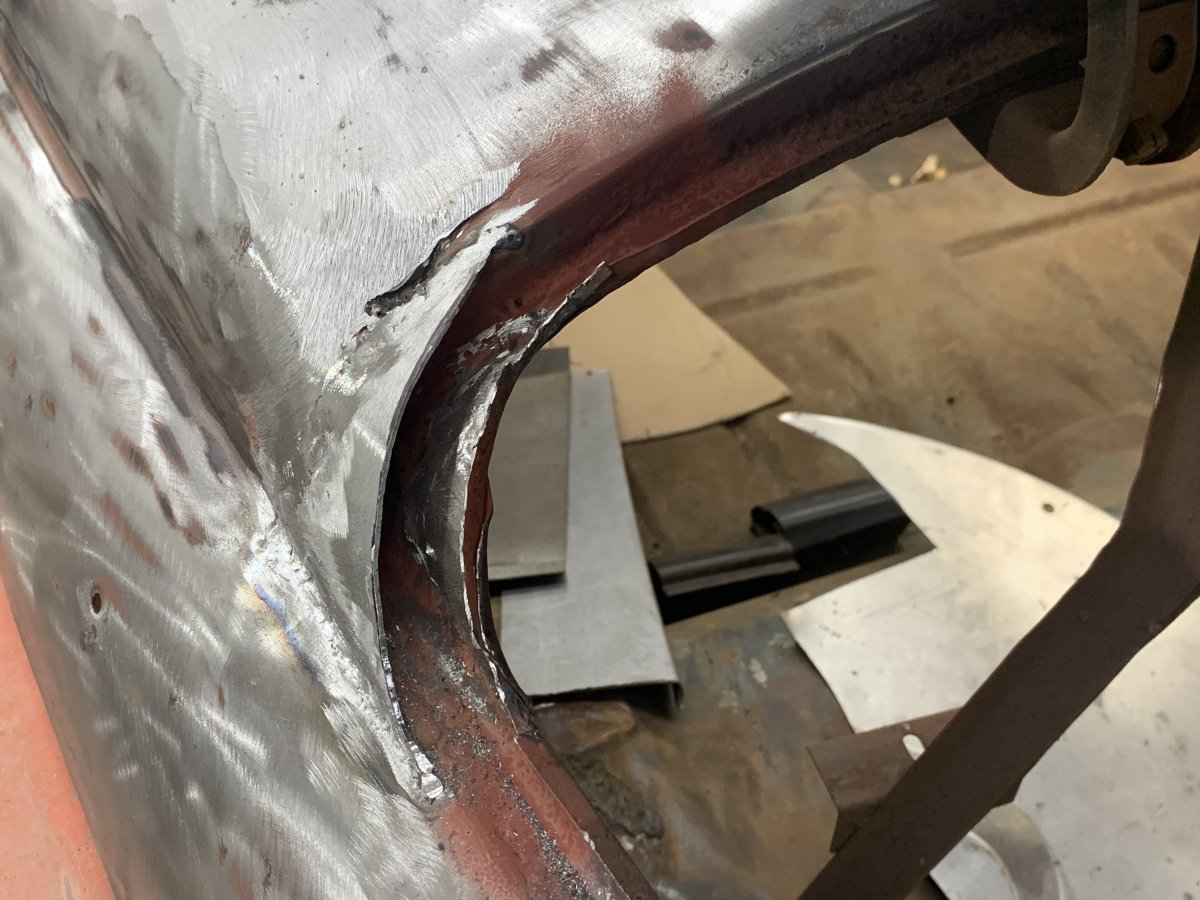

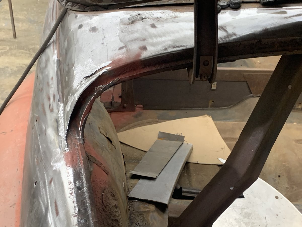

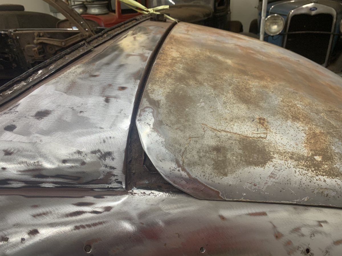

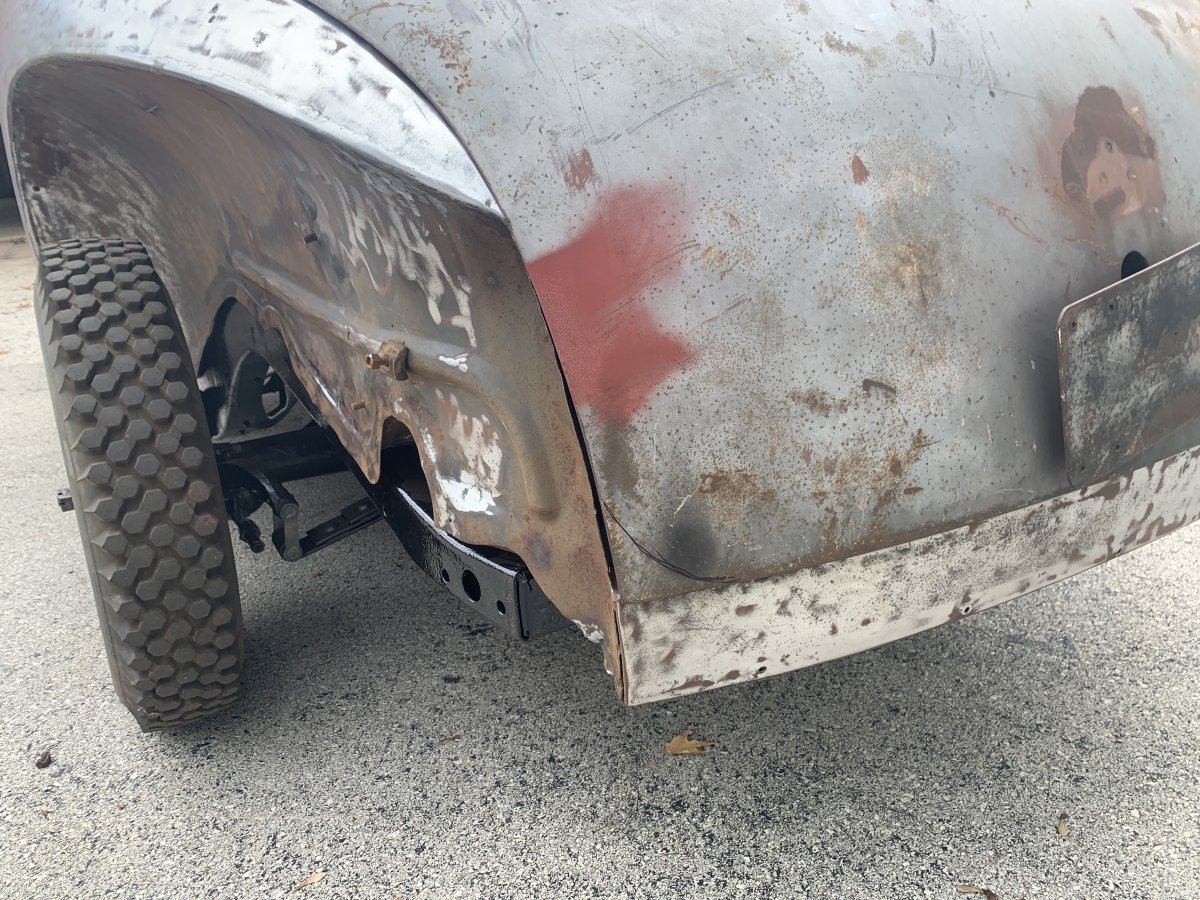

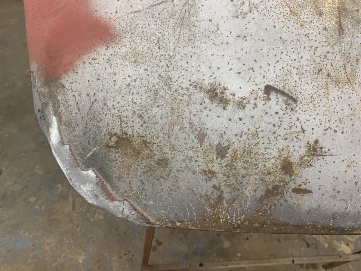

    Made a little more progress today on the rounded corners. Uppers are done until I get some lead. I need to work on the gap and radius on the edge of the lid.
    2D963F59-3153-4BED-B3C1-CF21C2A49B7A.jpeg 2D1AFDCE-C094-4F7F-941A-B1BFFDACFCF7.jpeg 9BF6BEF9-09E4-44B3-A910-3971334AA889.jpeg 50EC994F-DE59-425E-A8E2-C85C08F384E6.jpeg
    36 ROKIT, Okie Pete, cactus1 and 7 others like this.

  18. hotrod1948
    Joined: Jan 17, 2011
    Posts: 515
    hotrod1948
    from Milton, WI
    Very nice. I used tiger hair then a top coat of rage filler. Didn’t have any lead nor the tools or skills. Based on what I see in this thread you’ll master the lead work easily!
    T&A Flathead likes this.
  19. T&A Flathead
    Posts: 1,986
    T&A Flathead
    Will give it a try. I’ve watched a few videos of Gene Winfield, he definitely makes it look easy , but I know it’s not to lay it right without making a lot of “extra” work.
  20. When I melted the lead out in that area of our '38 cabriolet there was a surprizing amount of rust where the factory tinning had been poorly done. I'm glad that I dug deep enough to find it.
    Btw, I've really been enjoying following along on your build as I too have a '48 convert build in my future.

  23. louisb
    Joined: Oct 13, 2008
    Posts: 1,126
    louisb
    I played around with the Eastwood fake lead and found it easy to work with. Was very happy with the results.
    --louis
  24. T&A Flathead
    Posts: 1,986
    T&A Flathead
    i read that you can not mix Eastwood’s fake lead with the real stuff. I have one of their real lead kits headed my way. I’ve never leaded, so I’ll be practicing on some junk parts.

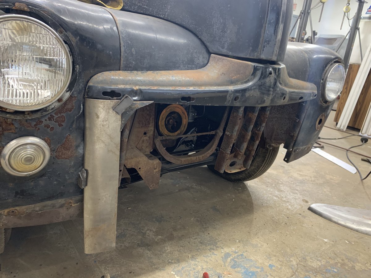

  28. T&A Flathead
    Posts: 1,986
    T&A Flathead

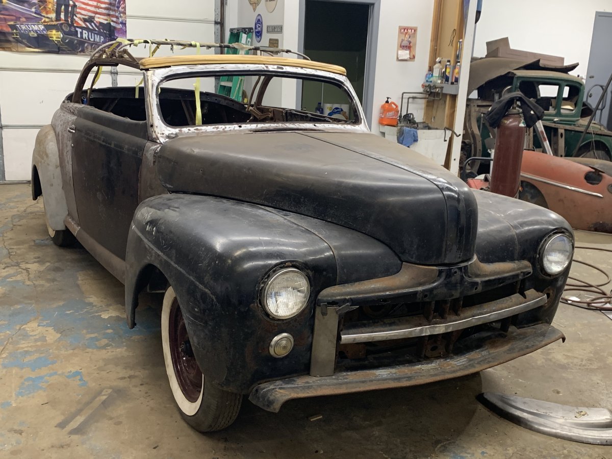

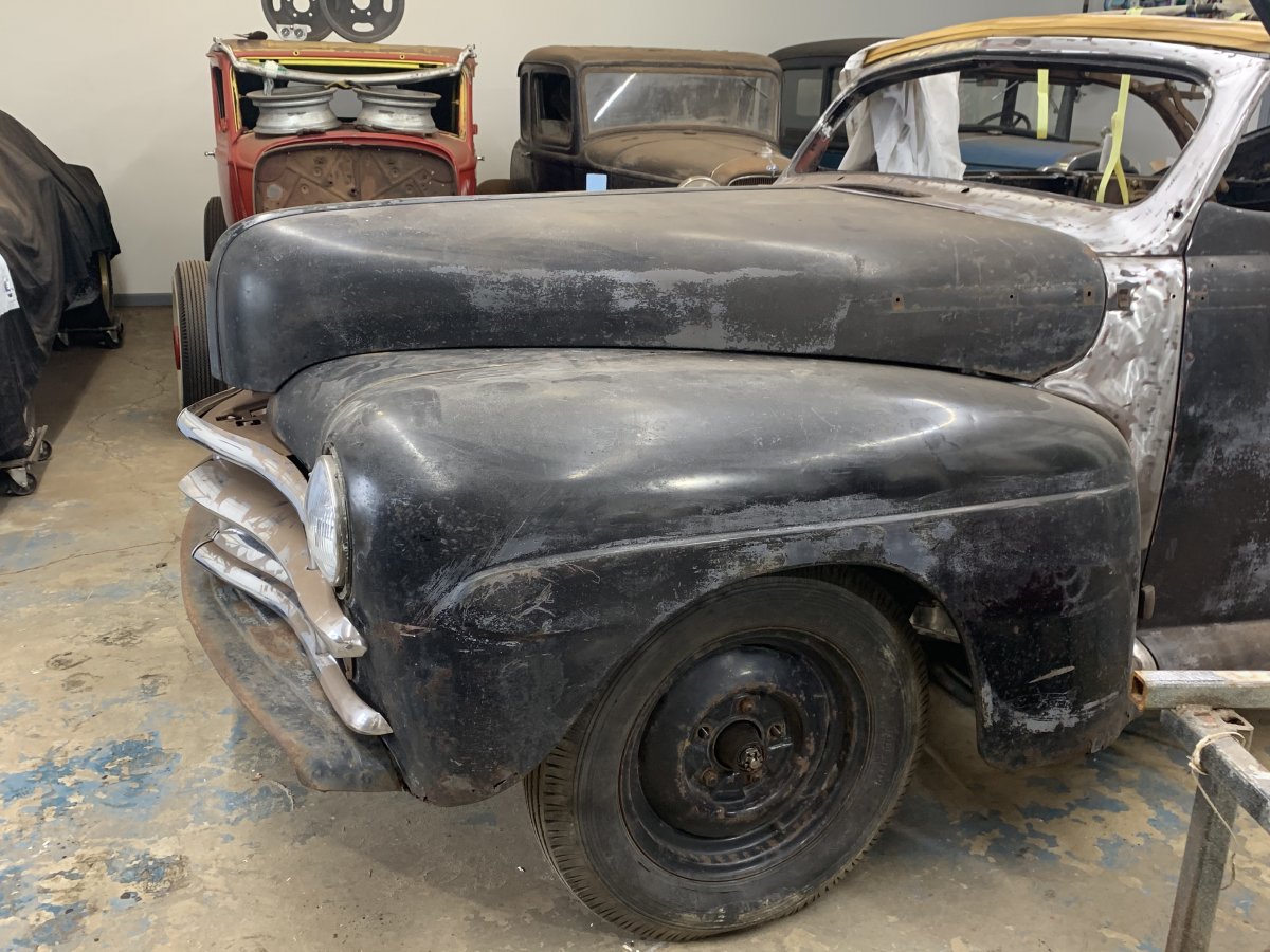

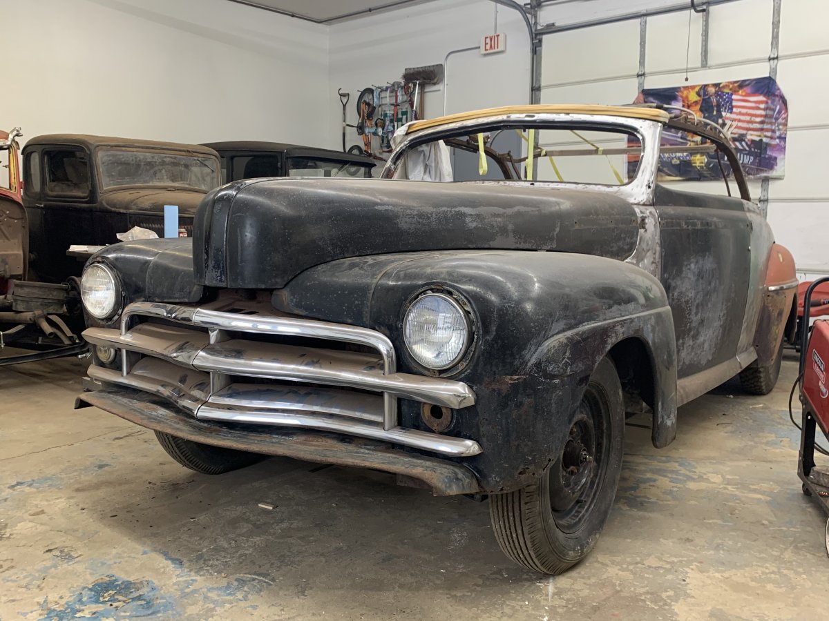

    I’ve been struggling with what grill to use. My original plan was a ‘49 Ply grill, but it’s been done before and the more I mocked it up, the less I liked it. I started mocking up another idea to retain some of the original look of the grill. Thinking of continuing the upper grill molding to wrap around the sides then have one or two floating bars. Not sold on it yet, just getting a few ideas.
    Ply grill
    5A74FE60-1585-4CCB-99AD-9489E3FD1149.jpeg BF6A6E40-1ED3-4CAA-B567-AF5ED126BCCB.jpeg
    My new idea. I shaped sheet metal to match the radius of the upper grill panel. I would also radius the opening symmetrical with with the curve/radius at the corner. Similar to a ‘42 grill surround.
    ECC7F2EA-588F-4317-B9F6-DFB9389C7A0F.jpeg 07F4E203-DB23-49CE-8F6A-57F8B2B57697.jpeg 7B3D582F-E4E7-4C6E-B1C2-82147EF5F54A.jpeg BAC5415D-D1DD-4502-94D9-9AC1CA7DA2D4.jpeg DEB74E71-5023-4C19-8A63-422447025A09.jpeg
    Surfcityrocker and nitrobrother like this.
  29. nitrobrother
    Joined: Dec 24, 2004
    Posts: 4,379
    nitrobrother
    With option 2 would you use the stock turn signals? My personal tastes fall to the "floating grill bar" style, but the esthetic choice belongs to you.
  30. T&A Flathead
    Posts: 1,986
    T&A Flathead
    Likely not. Haven’t decided on frenching / recessing the headlights yet, but I likely will.
