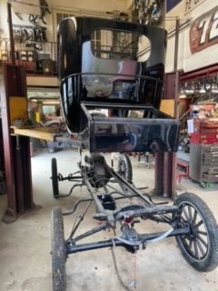

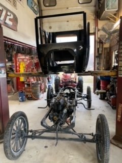

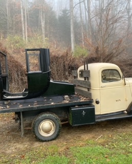

    A bunch of us old hot rodders took Ted’s near perfect T coupe body over to good friend Charlie’s garage today. Well Charlie and I are old!:rolleyes:
    The marriage of sorts will be the T coupe onto Charlie’s A frame.
    Here we go! 4C734818-4DB1-4723-8CFF-49E08184FDF7.jpeg DD9425F2-2242-4E76-B0E1-90ECB6DF4C5F.jpeg EEB8B20F-A20D-48A4-86AA-1A8EB84D5794.jpeg 3E25AA97-978A-45E6-881B-9DD92720F844.jpeg [ATTACHThis should be fun!
    I got voted down on taking at least a foot out of the top:eek:

    I bought this project for a body for Charlie's project. he had started building an A ch***is and this is what we found cheap. I plan to build a T speedster with the ch***is.

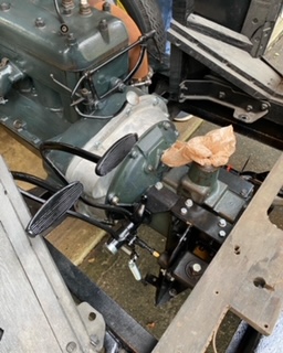

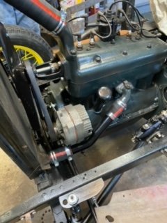

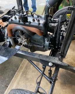

    Charlie built the ch***is using a model A engine and rear, used a "pause shift" era transmission with an adapter. he used later ford juice brakes and made the master cylinder bracket. he made his own shock mounts. all ch***is pieces were "scrounged" and restored by Charlie.

    Charlie wasted no time making stuff work. he installed the steering box, and removed the angled floorboard sills.
    Today we shifted the body around to find the best spot. it ended up almost as far forward as the rear cross member would allow. this gave us a little extra room for full pedal travel. we did have to heat and bend the pedals to clear. we put the seat in and got a comfortable position. image5.jpeg
