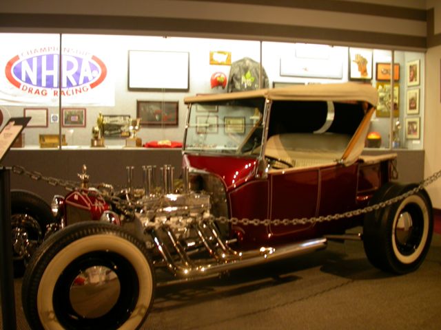

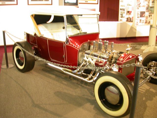

    Okey here is what I know or what I think I know. Grabowski's Lightnin Bug Black) version of his T was probably 101" w.b. Ivo told me his T had a 101" w.b. and I think Norms first black version was what Ivo copied. Both had the rear A spring mounted on top of the rear axle as in Model A's. When Norm changed his T to the Kookie Kar version he changed the differential to a later version with the spring mounted behind the axle which shortened the w.b. to 96" That is the version I copied and mine has a 96" w.b. If you want a shorter w.b. such as in Roth's Tweetie Pie (sorry don't have a picture) it makes it kinda cute (thus the name).

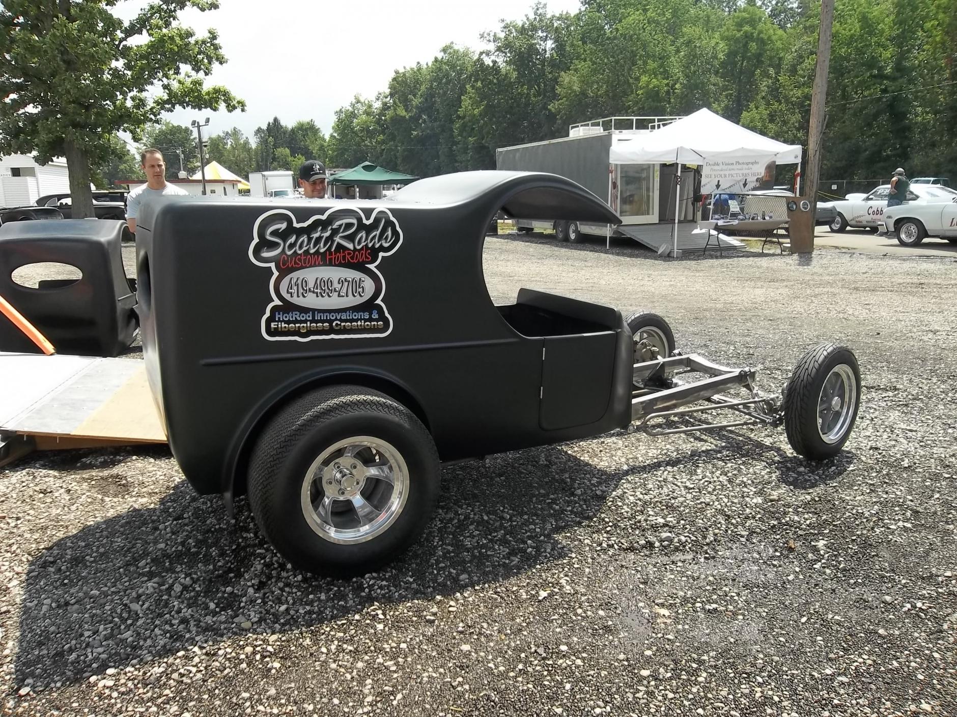

    Here's one of our C-cabs we make
    Scott
