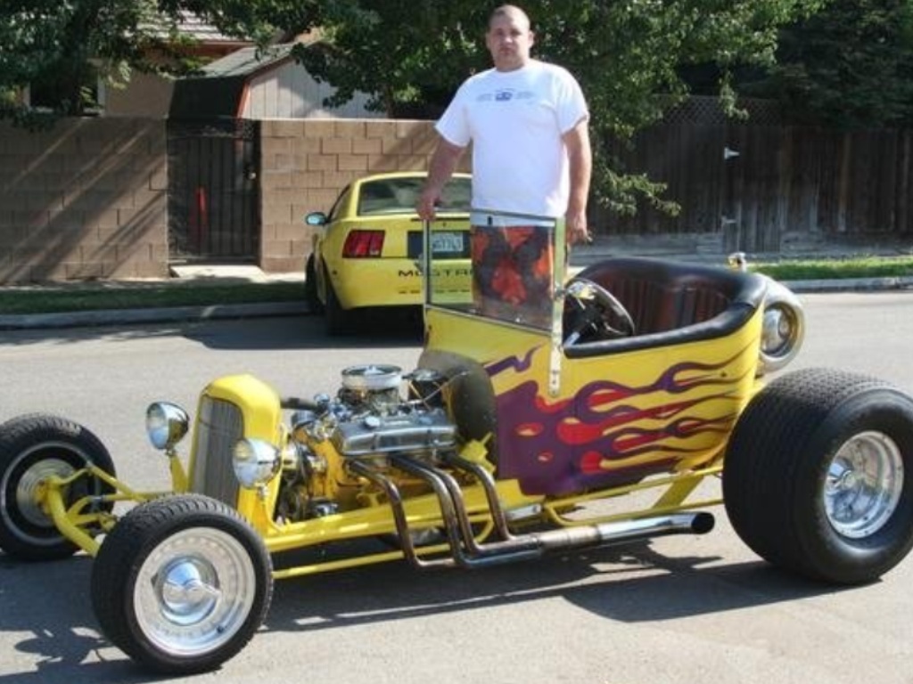

    My son and I started building his T bucket in 2001 when he was a junior in high school. We used the CCR plans and body and it worked out great!
    We finished for is Senior year! He made a lot of points with the girls, but non with the principal! He was also the cl*** president, the two never got along:D
    That was worth the build by it self:D

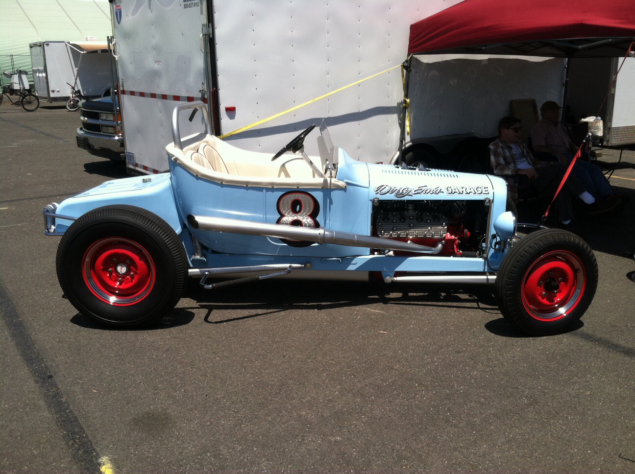

    Thats a great looking bucket. What frame? Looks to me like an A frame but I could be wrong.
    I do dig the track cars.

    The body is probably a Speedway.....the frame is a Strode special. Don't know if he is still building those frames. If not, maybe he could post some dimensions, or better yet some blueprints. I know he built a few track cars, as there is a feature article in Rodder's Journal. Some of his cars were channeled, and some the body sat on top of the frame. They both look cool, but the unchanneled ones probably have a little more interior room like this blue one.

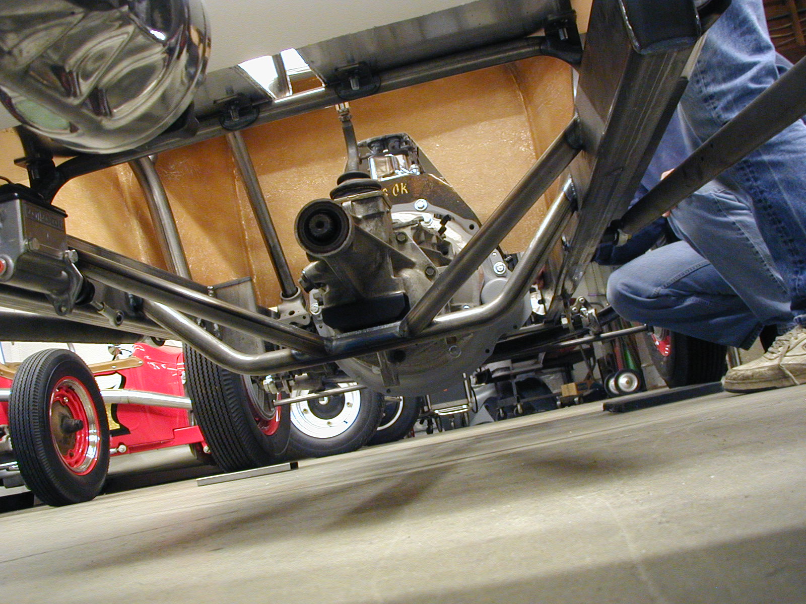

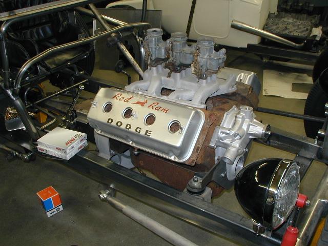

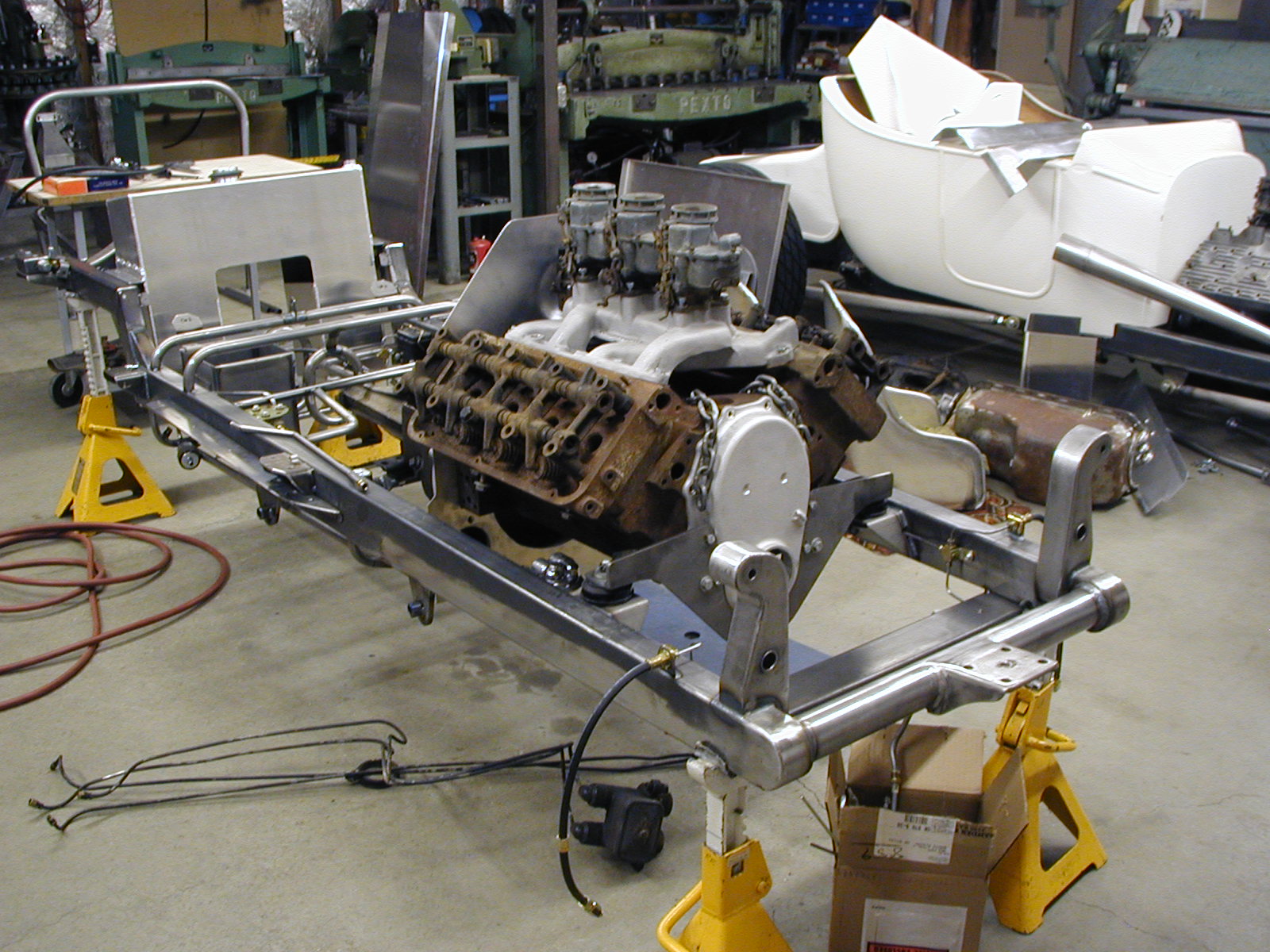

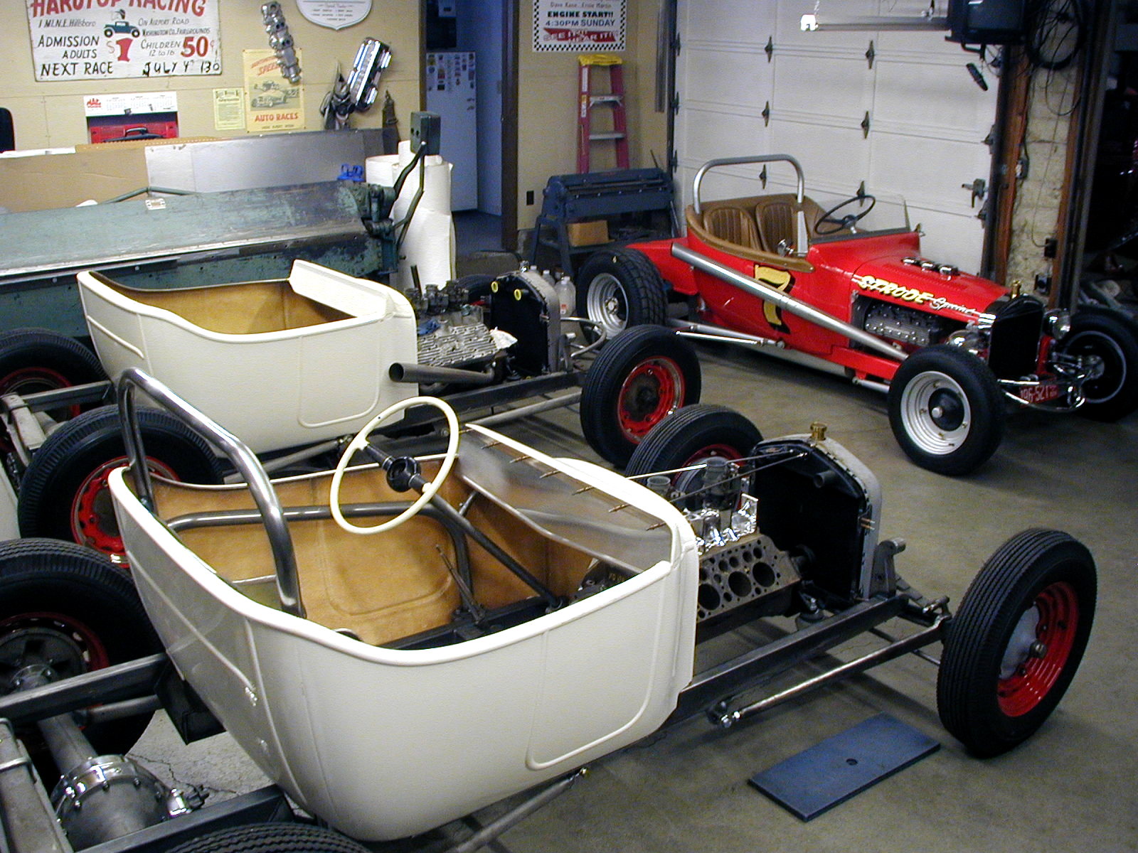

    Thanks a *****, the ch***is I built (9 roadsters and 1 touring) were 4x2 rectangular tube. Here are some construction shots. P1010103.JPG

    Wow, really cool Marty! I loved those cars back when you were doing them, and had some very serious hopes that the race series would take off and spread out down to this neck of the woods. I'm not tied to circle track stuff anymore like I was back then, but it makes me wonder what the climate today would be like to try to launch that same sort of deal.

    Marty, were you running any sort of "torque arm" type ***embly on the rear wishbones in these cars? I think I might know the answer, but there is a general anti-split rear wishbone hysteria these days that these things will kill you instantly without...

    Chip, Three of the cars had torque tubes, I used 35-36 arms on most of the rest. However there are a couple with open drive, using 42-48 arms, lots of miles, some dirt racing and they are still running without any torque arms. Here is my latest "T" project, IMG_4282.JPG IMG_4182.JPG using a Speedway body.
