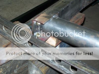

    I'm back again! Just for the record I've gotten my T frames down to a science and the dimensions I use are....
    Front, across the frame rails 24", pretty standard. This dimension takes most power plants and clears the starter and oil filter on just about all motors except the big Hemis and some Ford FE's.
    Rear 30"
    Overall frame length, 105 1/4"
    On my new one I'm using a 3" sweep in the front and a 12 1/2" Z in the rear to get the car as low as possible without cutting into the interior too bad. I don't think this much drop will work if your using a bigger trans, mine's a '39 toploader. Typical is straight front rails and about a 7" drop in the rear. The Doane Spencer type sweep and front end setup on mine allows for the undropped Model A axle that I love and mounts my 'bones, '48 Ford or Merc, with no brackets off the bottom of the frame.
    In addition I hate the way the front crossmember looks "rolled" in to the frame. The best I've seen, and my favorite for years now, is the way Norm Grabowski did the Lightning Bug, the forerunner to the Kookie car. Here's how they look..
    The tube, 2 5/8" .125 DOM is still welded into the frame, it just looks bolted.
    Just some things to think about.
