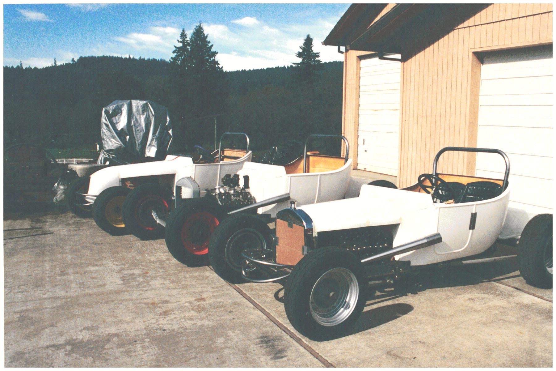

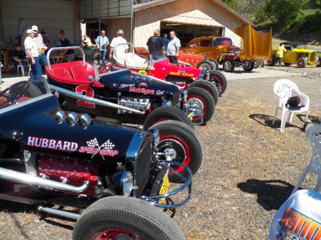

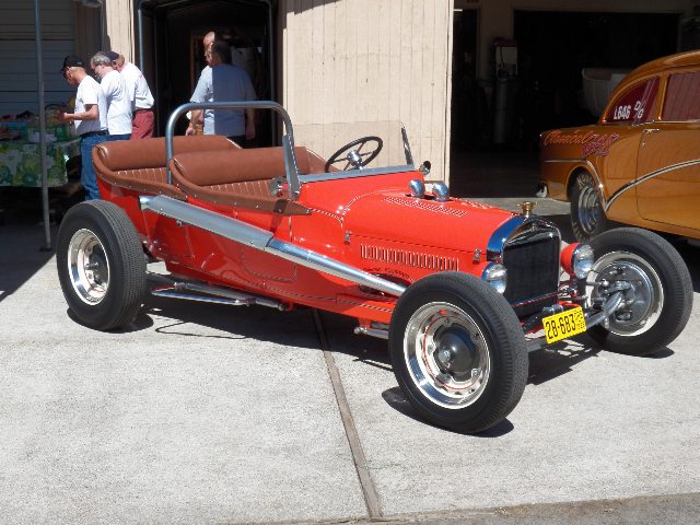

    I have used Speedway's bodies on 8 of the Track Roadsters I have built. The new turtle deck from Speedway is a great piece, the lid has an inner structure, it fits perfect. These "***embly Line" shots are from around the turn of the century!

    Thanks do you have any pics of your build? That is a lot of cars!

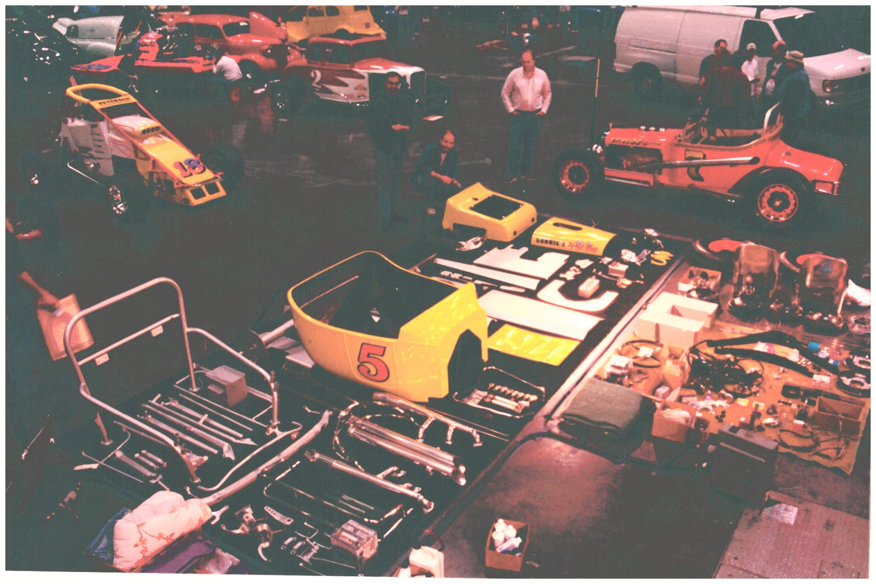

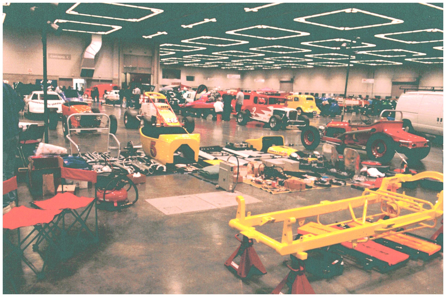

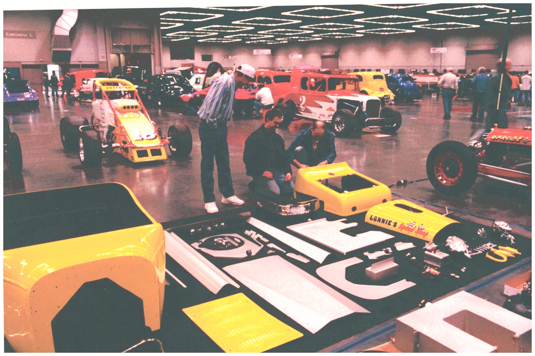

    Here are some shots taken at a car show 12 years ago, we ***embled it in 4 nights and drove it out the door. Notice all of the parts, my cars are for the "Dirt Tracks", and the street as well. The #7 in the background was the first one.

    Geezzz..Marty! You have built some well thought out T's!
    Extremely cool stuff going on there.
    Love the wide fives I see on one or two...talk about completing the look!

    That is awesome and I love that you built them at the show and drove them away! The number 7 car I have seen and I think it was when I was looking up Speedway. Great looking car.

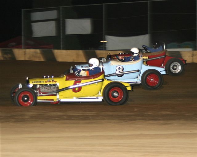

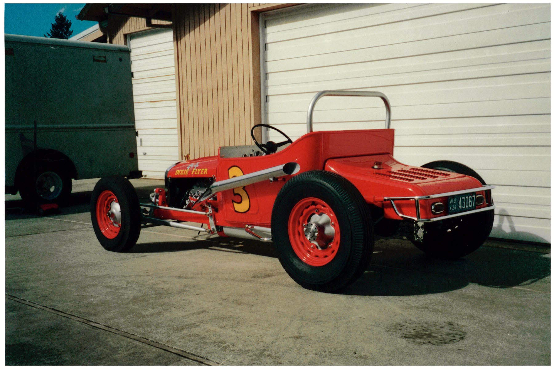

    image.jpg Here you go.

    You've gotten my attention with the body cage. Any more pics? Is it separate from the basic frame?
  21. CoronetRTguy
    Joined: Dec 26, 2012
    Posts: 826
    CoronetRTguy
    Man I dig that! That is very cool. Where do they race the track T's at?
    Would also like to know more about the cage or roll bar. I have seen a few pics from the 60s with T's having a roll bar.
    I want to use seat bealts what would be my best way of doing this?

    Here is what the roll bar and mounting looks like. The yellow #5 that a ***** posted is the one from the car show, with Indy Veteran "Len Sutton" behind the wheel. The bar clears your head, (no need for a helmet) if you are not racing. A few more shots, including my "Tub".

    Damn Marty, when you were trying to get that off the ground as a racing cl*** years ago, I was damn near foaming at the mouth for it to be commonplace countrywide... I think I actually called you at one time about it, but I can't remember.
