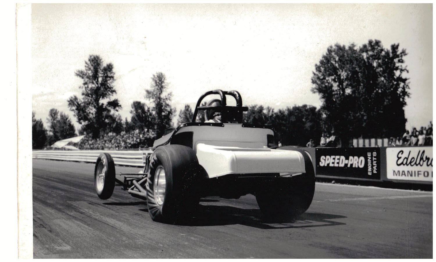

    need louvers ?
    That's Rudy Herrida's car that we were talking about a page or two back. I posted a Car Craft cover with a partial picture of the car on it.

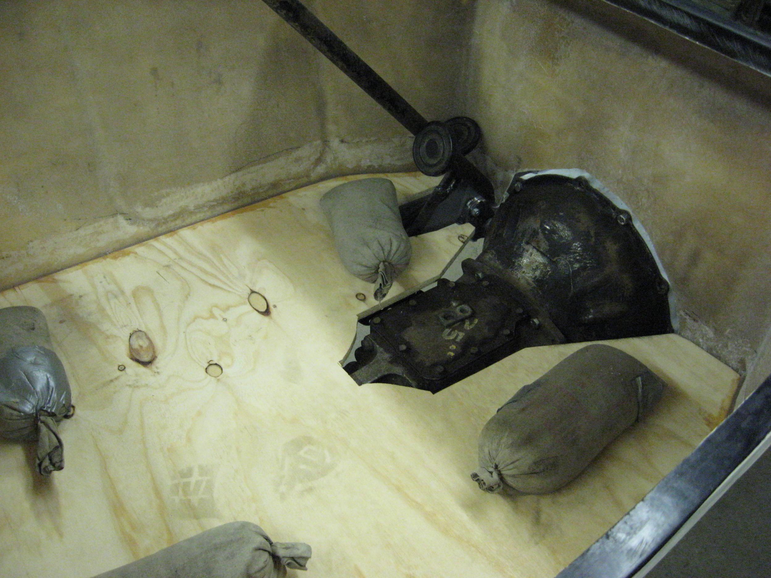

    Here is how I did mine:
    I cut strips of 3/4 plywood, cut relief cuts into the plywood to allow it bend to the shape of the body.
    I used PL Premium and glued it to the sides of the body. You will need a ton of clamps to do it this way.
    While I was cutting the wood, I went ahead and shaped out the seats.
    Once all that was complete, I trimmed the body to the edge of the wood, then gl***ed it all in.
    Further along in the next pic. I also added more wood to the p***enger side in case I wanted to cut a door later on.

  22. Keep
    Joined: May 10, 2008
    Posts: 662
    Keep
    Oh yeah I forgot to add, work in small sections, do NOT try and gl*** the floor all at once as you will fail and make a huge mess...lol
