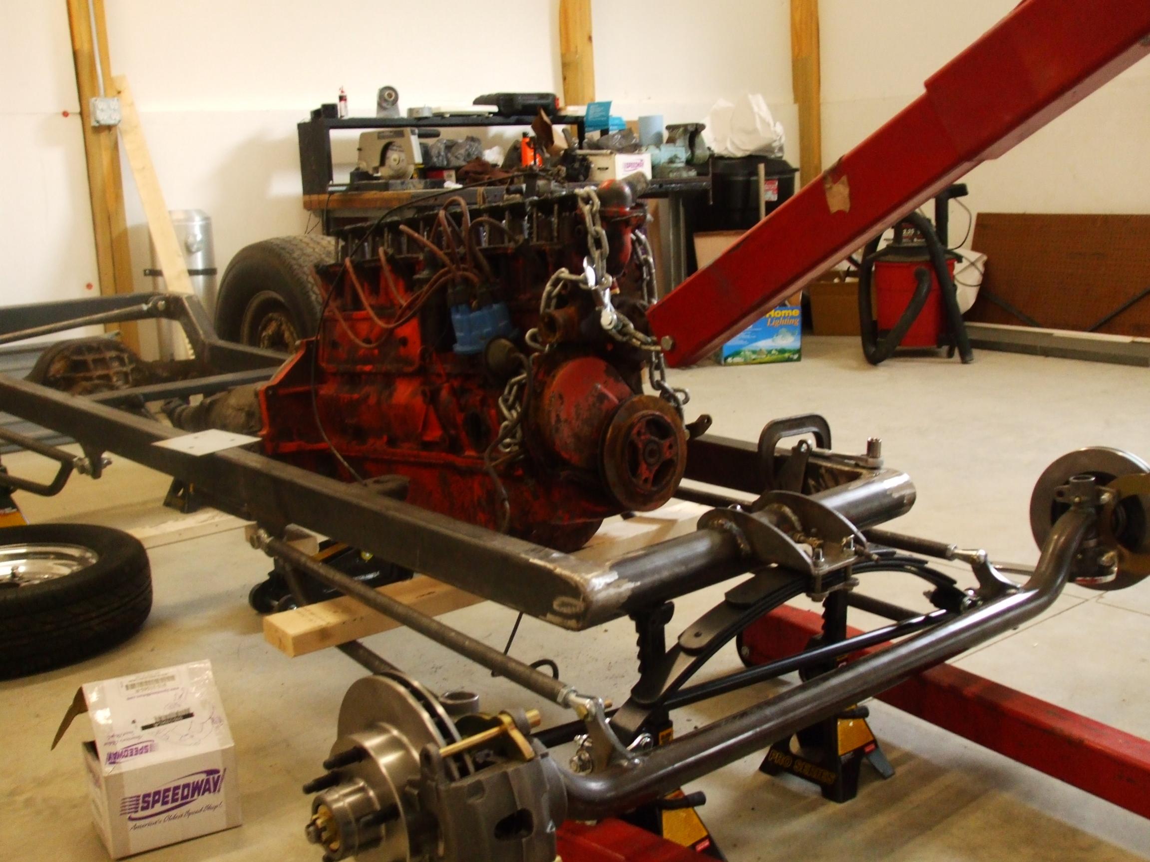

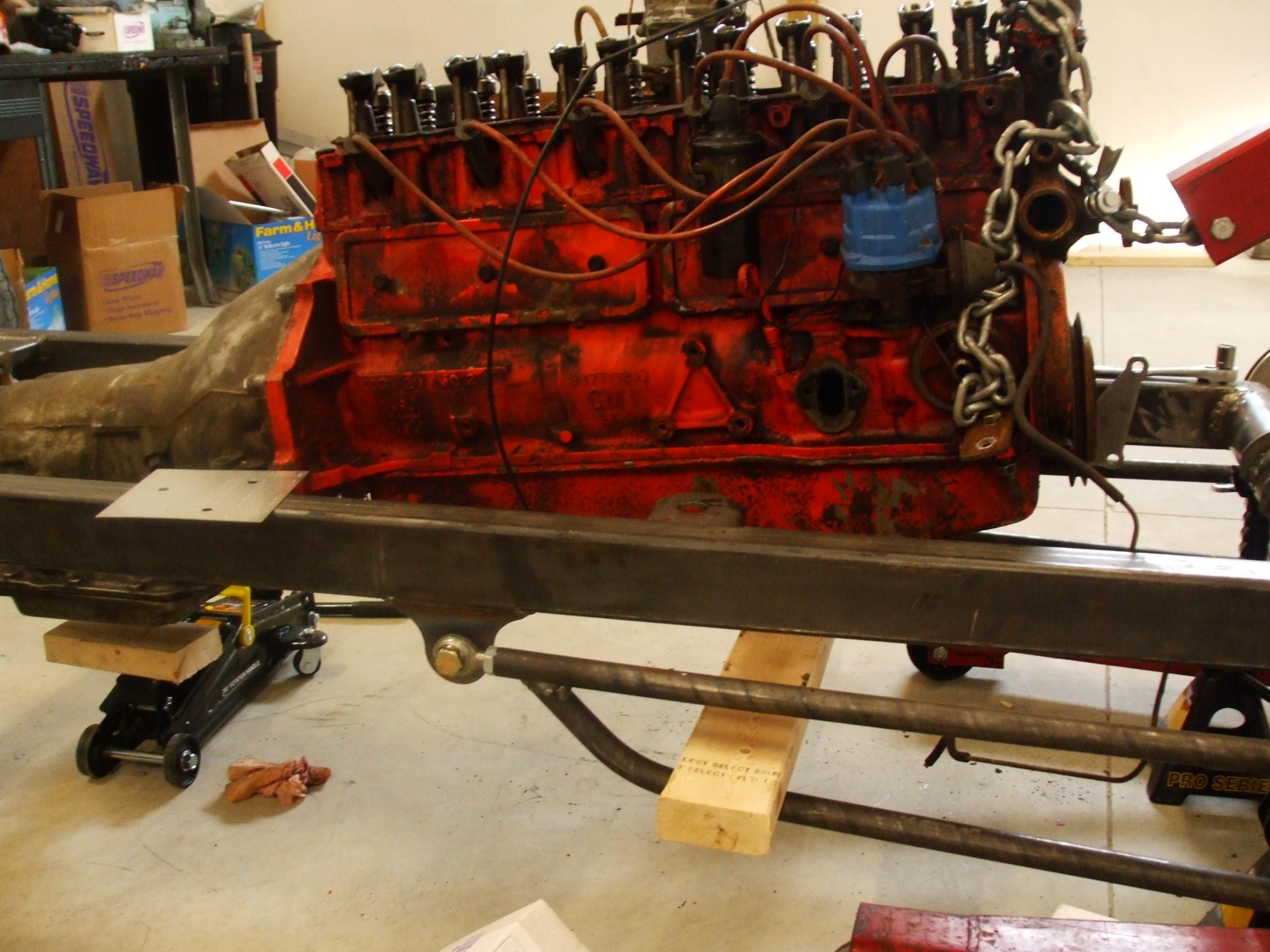

    anyone ever use a chevy inline 6 (250) in a bucket
    i need motor mounts, help.!!!!!!!

    thanks to GM interchangability, the engine and frame mounts line up. do you have the biscuits/ doughnuts/isolators that belong to the frame mounted brackets? you need those first. get some cardboard or stiff paper for patterns. with the trans yoke angle matched to the diff yoke angle (search it here) fill in the difference. two triangular gussets running between a motor mounted plate and the biscuit/isolator/doughnut mounting plate. if you dont have a welder (dont see one in the pics) take the cardboard templates to a fabricator and show him what you want. be sure to leave clearance for installing bolts and be sure the engine is centered in the frame side-to-side. the weight of the engine will compress the isolator/doughnut/biscuit, so be sure to compensate for that.
    good info here: www.TBucketPlans.com

    yes i do have the biscuits and bolts,,thanks, im doing that,will have to check yoke ,and pinion angles
    thought maybe someone out their made them

    Oh, and arrange it so that the weight of the engine is loaded to the frame and compressing the front suspension. this will give you a better idea of the angles of the driveshaft, carburetor, desired frame rake, caster angle and more.
    you can build some temporary plates across the front of the engine with jacking bolts to square things up. safer than a 2x4 too.
