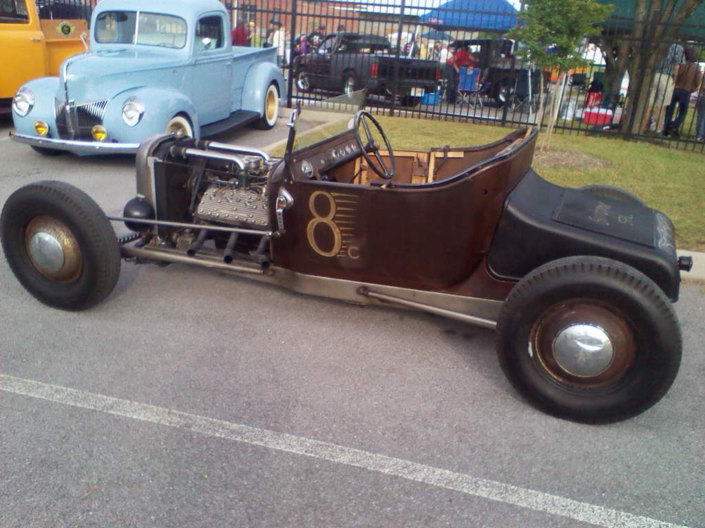

    Here is an old timer that was built using an unboxed set of Model A frame rails with no kickup.
    Here is what the bare frame looked like.

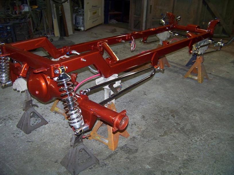

  25. I have owned my T Bucket for 25 years, but I did NOT build it. It has straight frame rails, NO Zee. and he used a straight front axle. I have to clim on the rear tire to get in & out. No doors. It sits Too high. Steep angle on engine & trans back to 9 inch. roadster headers end close to ground. I will be dropping front end. It has 4 coil springs. May bag rear end to be able to drop it. I recommend zee it enough to be able to step into & out of car.

    Here's one I'm building now.. Has a step in the rear... It will be hard to keep it low with no step up in the rear..
    Here's how it sit's..
